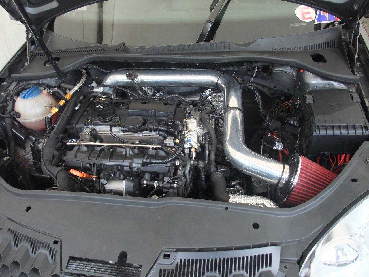

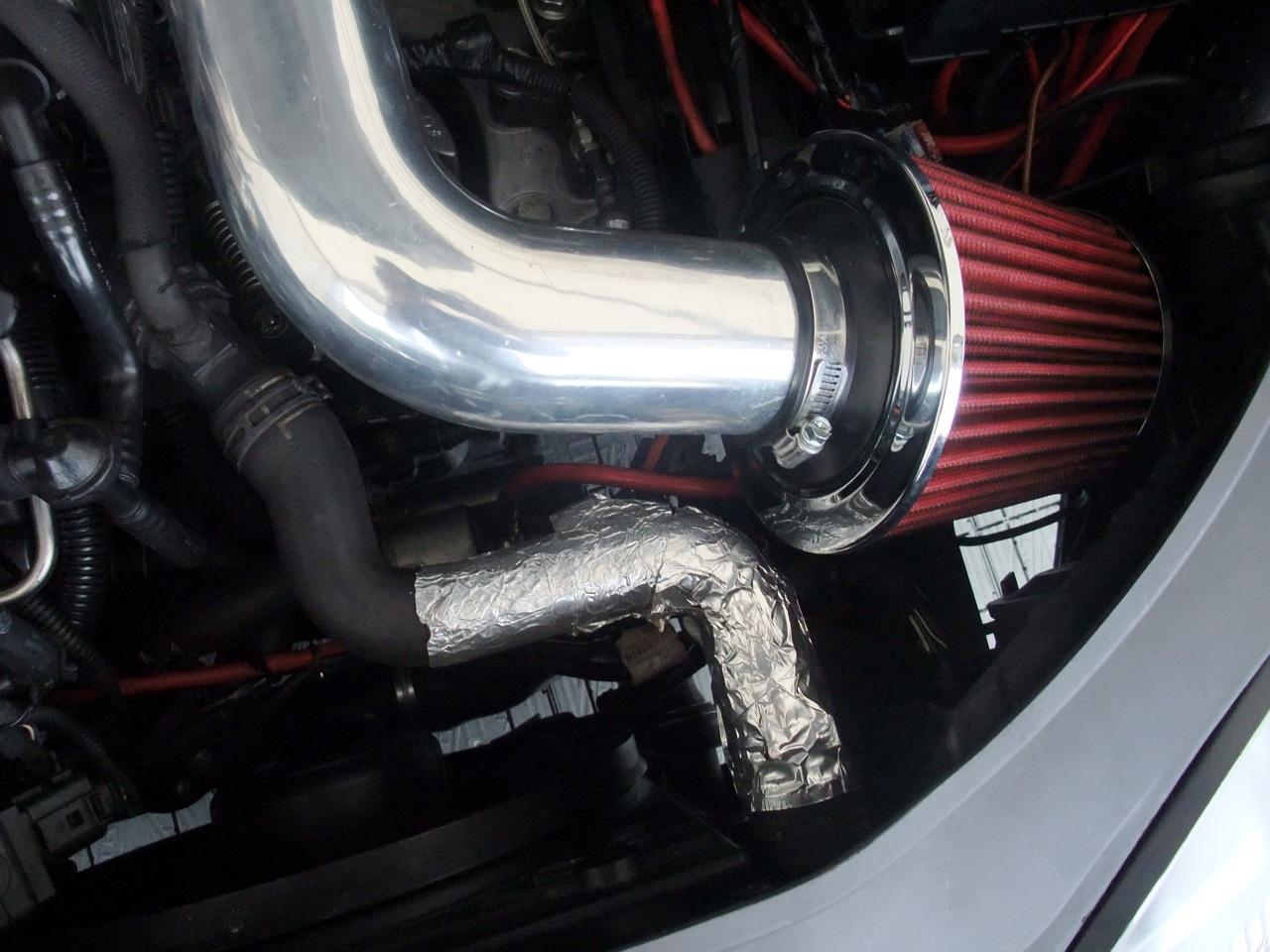

@ KeithAPR : -
Yes, Mk5 chassis. I didn't photograph all of them but you can see the floor matting through the gaps and this would normally be covered in on an oem GTI.
Quite a few race Mk5's were using an enclosed cone filter in the oem ram location but had the oem engine cover on - :confused: ?? Methinks that's a very nice and functional looking cone filter.
Notice the abundant use of plastic ties! :grin:
