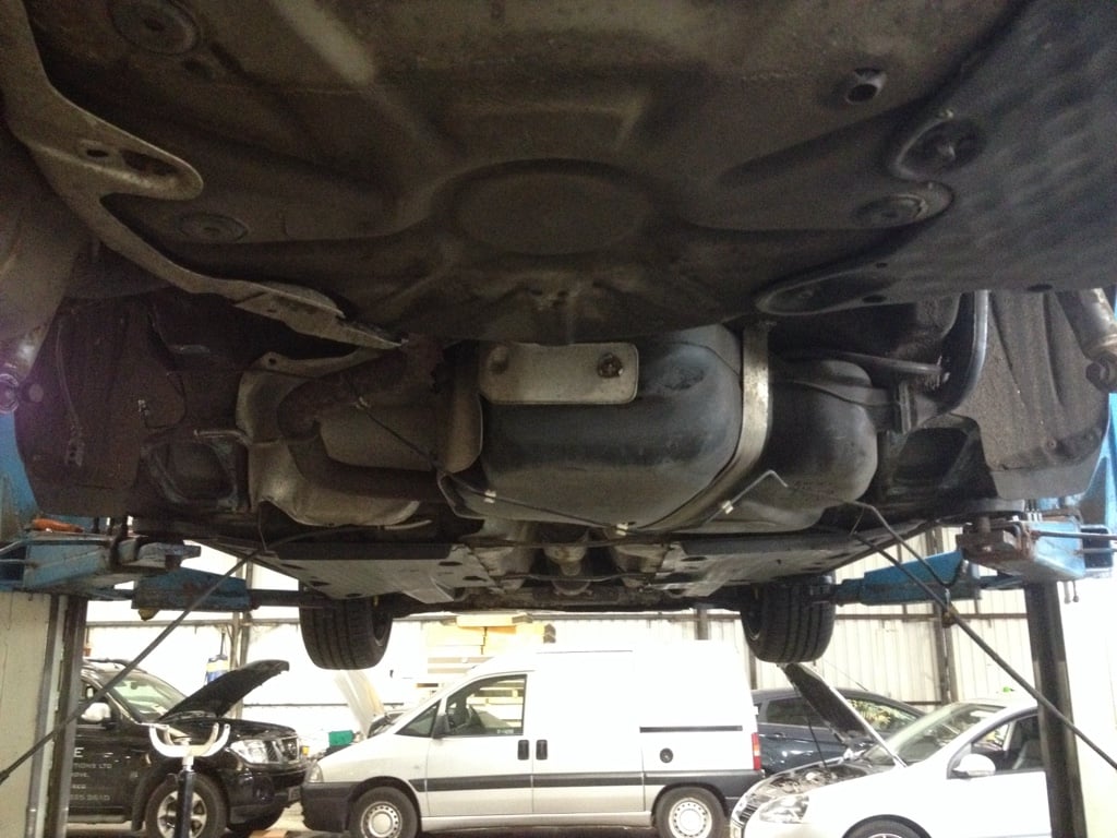

Pollybushed the entire underside of the car front and rear. ECP got me the bushes for a considerable amount less than they are available on eBay.
This is not by any shot, a nice job...... Very heavy work and extremely time consuming. With most bushes seized solid and having to be cut and chiseled out.
Obviously after refitting the subframes, the wheels were pointing at all angles! So.....
Front camber is showing -1.5 on both sides
Rear camber set to -2.0 as the cars use will now be solely for fast road/ track...
So what difference do they make,
Well the car feels more stable in higher speed corners, and much more composed over uneven surfaces which I didn't expect!
I think the mk5 platform can feel particularly floaty/jiggly when pushed at speed, the change in bushes really has made a vast improvement, making the car feel far lighter than it is.
It's a modification I would certainly recommend, but only if you intend to keep the car for a considerable time, to justify the cost and effort, neither of which being small.

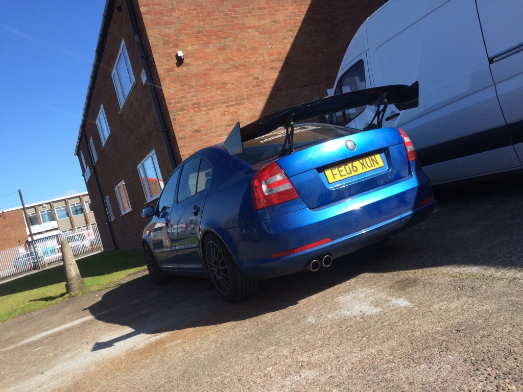

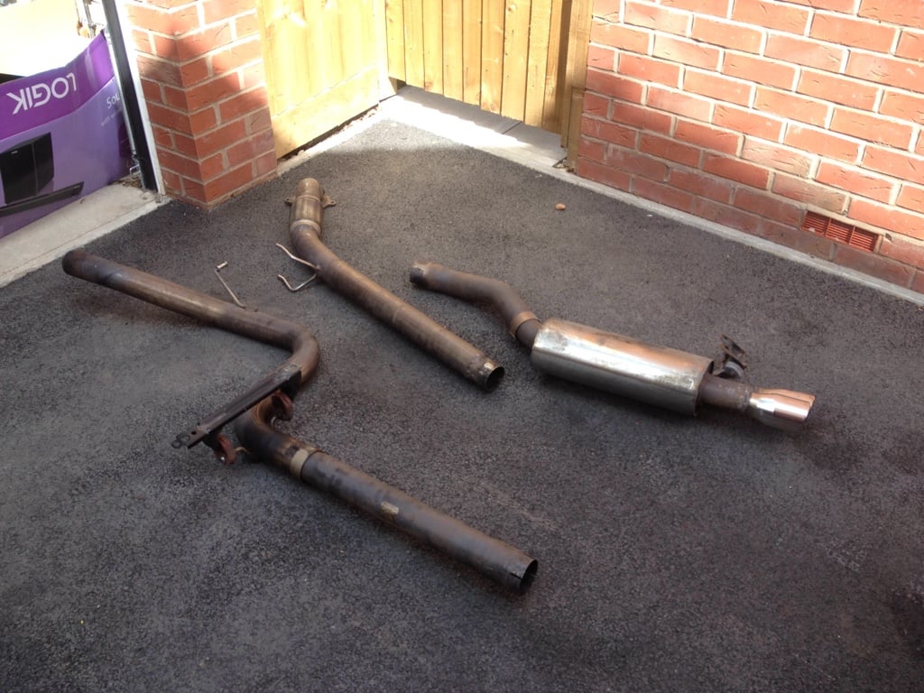

Had a great time at the ring. Killed the stock exhaust, so fitted a miltek turbo back non res. nqsbbk performed incredibly! And all other mods like bushes etc no doubt made the job of attacking the green hell far easier. Car has been sent to the body shop for some work on the arches for clearance, and some front bumper mods.
Always wondered what a mk2 Vrs would look like with full aero, so I'm going to find out......

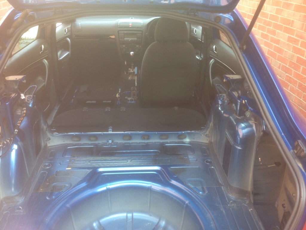

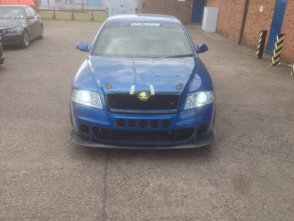

While in the bodyshop, aside from the obvious modifications, the car has had a lot of material removed from inside of the arches and the strut tower caps cut off to allow for adjustment of the coilovers that are on route.
Car is driving well and performed faultlessly at curborough today,  if a little underdamped. Over the coming weeks a lot is planned to be changed to shift the focus totally towards track use.

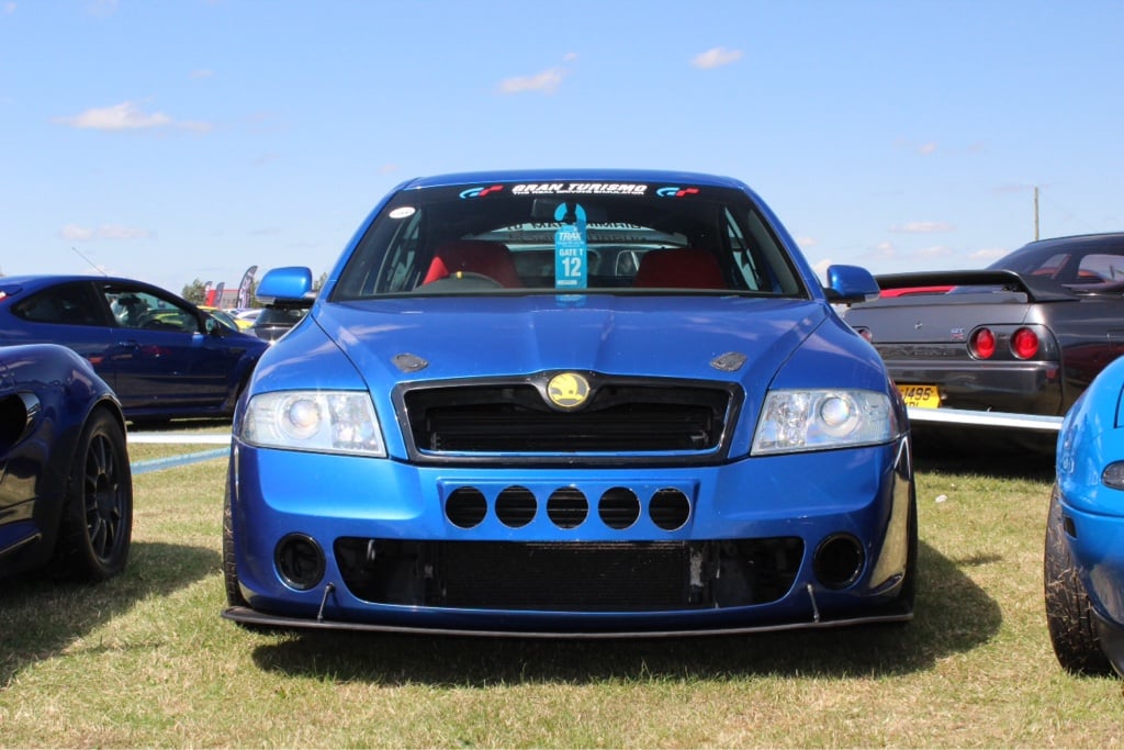

Modified scuttle and strut towers coming into their own now the new coilovers are on. Car is close to how i want it chassis wise, collected my new seats, and sizing up a few other bits to finish the interior.... Or lack of.
Carbon fixed seats. Takata 4 point harnesses. Custom seat subframes. New whiteline 24mm front roll bar arrived today, chassis is near completion!

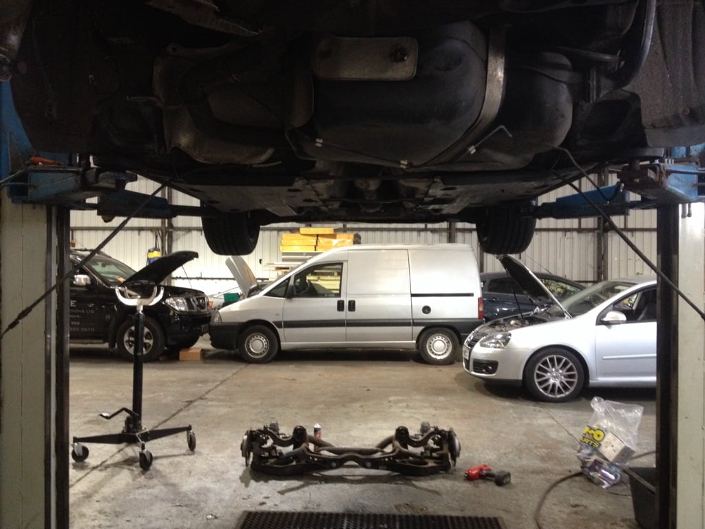

Had the front subframe off today to swap the front roll bar, only to realise whiteline have sent the wrong one!

The front subframe had been creaking for a while, so i ordered a tyrolsport locking kit for the subframe, and a pair of adjustable droplinks. Hoping this would tackle both issues at once. It didn't... And the subframe locking kit is the biggest fight I have ever had fitting aftermarket components to a car, there is absolutely zero tolerance when fitting, the subframe is literally mm perfect to centre, great when its done, but a real challenge to achieve.
So the shorter links didn't help, so i fitted some superpro roll centre correction ball joints. No more bottom arm contact, but still driveshaft issues. Booked the car in with a good friend to have the chassis notched. Before this could be done, however, the driveshaft had seen more than its lion share of abuse, and the CV joint exploded. While at it, I replaced the shaft entirely with a solid shaft from a diesel, identical length and weight, but thinner. The car could then have the notch done.

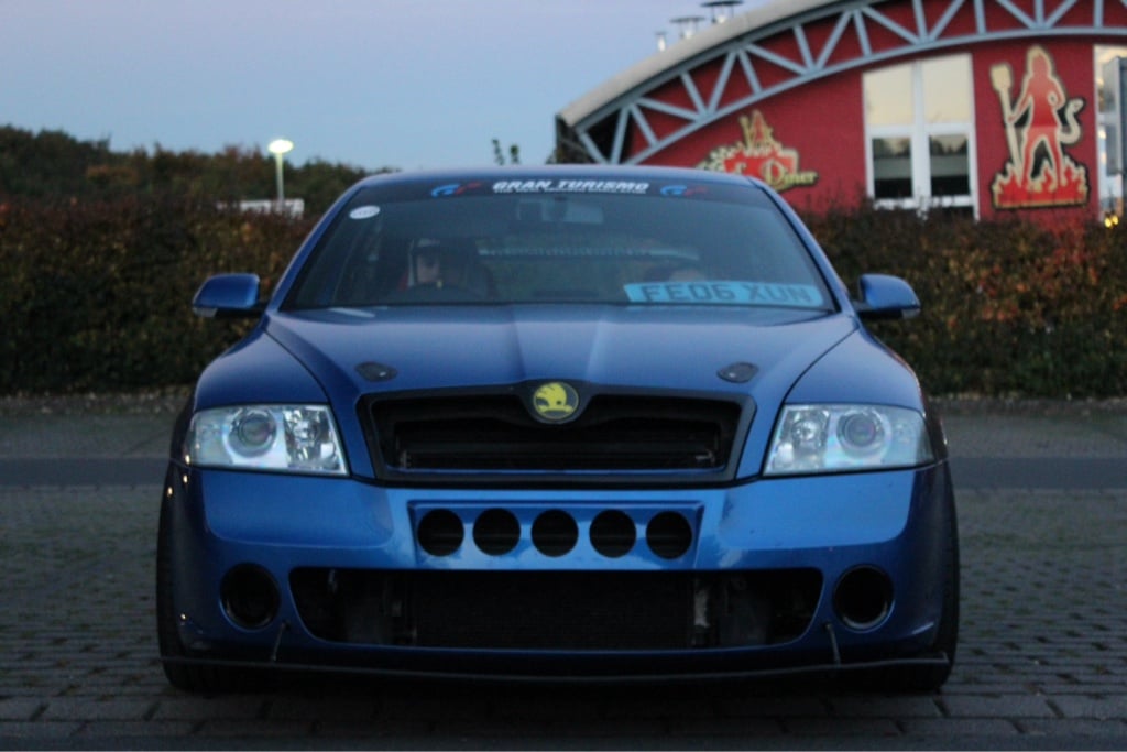

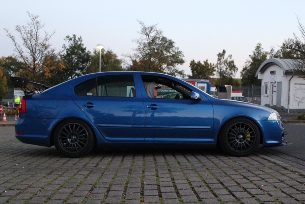

Fresh back from the Nurburgring, this is the cars second venture there, and a hell of a lot has changed chassis wise since the last trip. I had the alignment set for the 10 thousandth time prior to going and one little thing that made a great difference to turn in was being able to widen the front track. Using the superpro ball joints at maximum neg camber, and the top mounts adjusted to reduce it, effectively pushes both top and bottom of the wheel outwards, while still maintaining around -1.5 camber. The scope for adjustment from damping, roll bars and geo makes all of the heartache at least count for something! I think a few more track days are needed before I decide the suffering was worth it!
So, now the winter is approaching, I'm hoping to get one, maybe two, more track days in before the car gets rested and I finally take the plunge and get the K04 on. After that, the DTM style will be in full swing, front splitter redesign, wide arches and slicks.
In preparation for a lot more track work next year, and in keeping with my OCD over the car and spec, I've picked up another set of O.Z Superturismo's in identical specs to my current wheels. (5x112 17x8 ET35) These will be refurbished, probably remain silver, and have some track rubber fitted in the new year.
