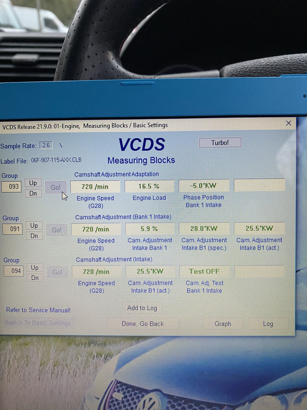

Hi guys still haven’t resolved my issues with the car decided to look at timing figures
As per the pic.
I must admit I put e10 file in the car as we had a massive shortage where I live so that all that was available.
Very sluggish on it I must say the car is mapped too.
I’m trying to get to the bottom of my boost issues.
Very little boost till 4k rpm
Anyways what is my timing saying guys ??

« Reply #1 on: April 25, 2022, 01:21:01 am »
Your reading should be like this so looks like you have timing issue.
What are the symptoms of your car?.
Boost could be divertor valve issue?.
Do you have any fault codes?.

« Reply #2 on: April 25, 2022, 07:22:04 am »
093 Phase pos bank 1 should be between 0 and -/+0.3 (yours is -0.5 indicating cam chain stretch)
091 Cam adj intake B1 actual should be matching spec or within 0.5 degrees ( yours is out by 2.5 degrees)

« Reply #3 on: April 25, 2022, 04:56:00 pm »
Agreed...the number circled should be no more than ±3°KW at operating temps.
What you have (-5°) does suggest it is time for the timing chain service.
But do not just throw in a timing chain and tensioner. Do the job proper.
Replace the three oil containment rings inside the cover (these rings go into the center bore of the phaser). Be careful when mounting the cover so rings are not damaged when initially going into the phaser bore__remove and clean the N205 pick-up screen/filter__inspect the center bore of the cam phaser unit (on the end of the exhaust cam) for grooves and replace the phaser if so grooved__use a new gasket and use no sealant.
I recommend a new cam phaser unit while doing the job...just because it is typically old when replacing a timing chain and why not do it while the cover and chain are removed. The N205 itself can be done later. Since it is mounted externally. Also, sometimes the number your data displays can be due to a faulty/inaccurate report from the cam position sensor. So it as well may need to be replaced later on. But again, it is another bit mounted externally and is easy to access. It is near the front of the head on the air intake/inlet side.

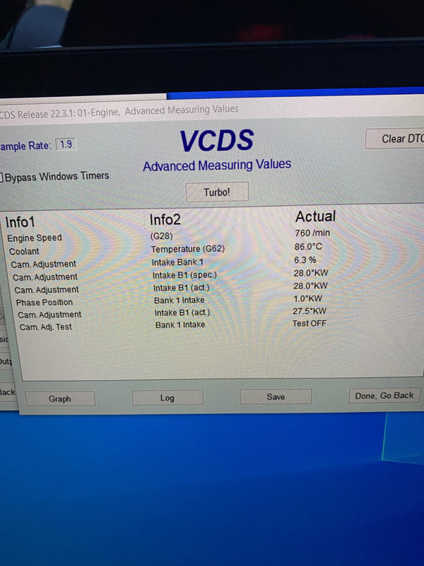

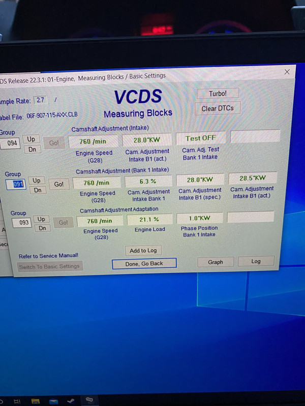

« Reply #7 on: April 30, 2022, 06:28:52 pm »
How weird I haven’t driven the car for a week now so I thought I’d start her up and put some no ultimate fuel in probably should have put v power or Tesco super unleaded but he ho.
Anyway I thought I’d check the timing again and these are the results
Wtf is going on !!!!!????

« Reply #8 on: May 04, 2022, 09:05:39 am »
That looks perfect.  I assume you took the readings once the engine was warmed up, as it all relies on the engine oil temp/pressures

« Reply #9 on: May 04, 2022, 03:49:12 pm »
As ROH suggested, it's time for chain gear/VVT inspection.  The static angle shouldn't move around from one day to the next.
