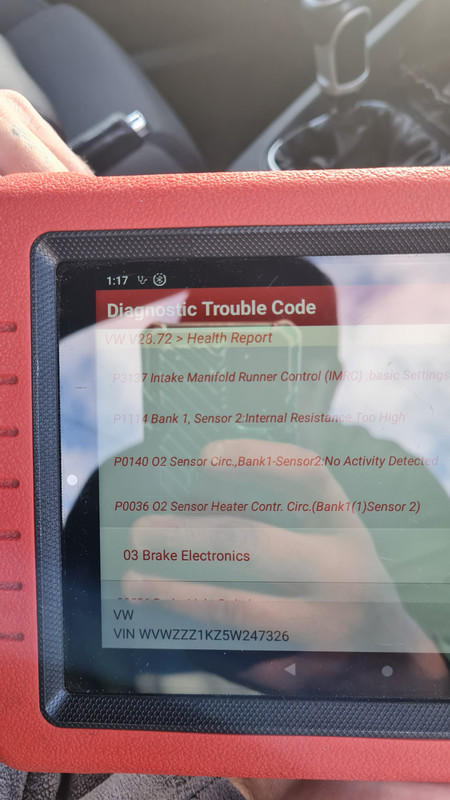

So the eml came on today car running fine plugged it in and these came up
Offline Dogg1210
  • Posts: 127
Re: New here from Scotland
« Reply #50 on: November 03, 2022, 05:34:49 pm »
Reset the light and about 1 hour after driving popped back on again is this likely to be the o2 sensor

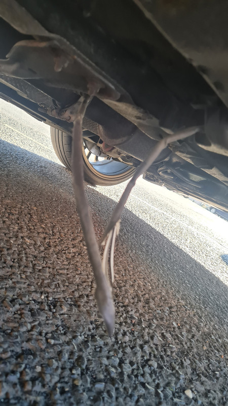

« Reply #51 on: November 05, 2022, 08:39:05 pm »
So it was defo the 02 sensor lol

« Reply #53 on: November 06, 2022, 06:30:29 pm »
That happened to my Mk4 - runner flap tends to be a sympathy error code coming on with others.

« Reply #54 on: November 06, 2022, 07:46:40 pm »
I just cut the wire and I spliced them back together. Done the trick as after about 30mins driving the light went off so happy days
