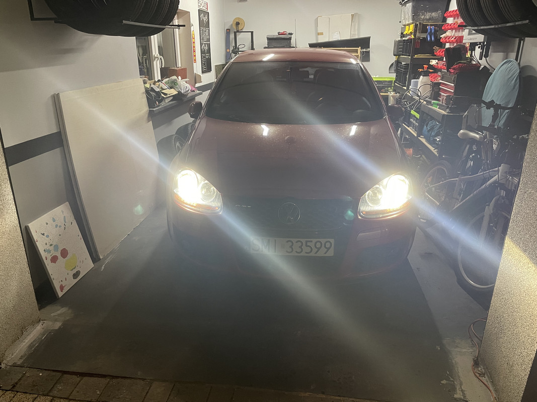

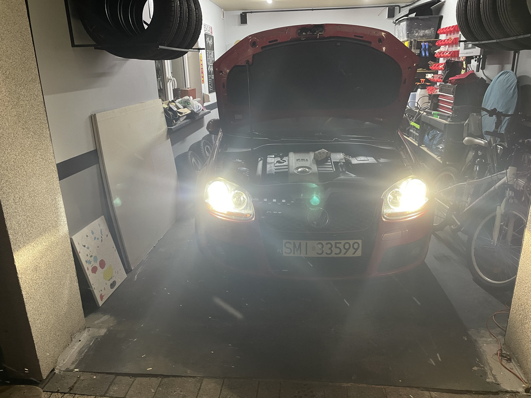

Anyway bulbs are changed i took some pics but theyre so crappy you probably wont see a difference, but to me they look much better now.
Before:
After:
More to come…

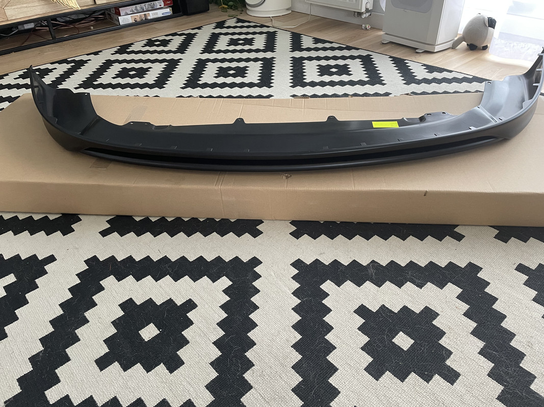

Ed30 front splitter just arrived, so visit to the bodyshop will be innorder at some point soon..

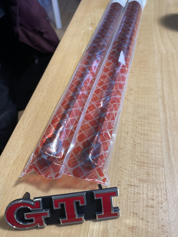

« Reply #17 on: February 01, 2023, 02:26:10 pm »
And the last of todays goodies. New boot struts, and a mk7 front gti badge.
Horray for no more concussions when im taking things from the boot! Not sure yet how im going to get the badge to fit, but ill have a play with it .

« Reply #18 on: February 01, 2023, 09:37:55 pm »
boot struts are fitted, another easy job there. Thanks VW engineers!.
Also had lots of fun with the badge, which turned into its own mini project.
Firstly i had to remove the grill from the car, and then remove the old badge from the grill.
Looking at the old and new side by side theyre exactly the same size:
Unfortunately the method of fitting them to the grill is completely different on the back:
Fortunately the letters themselves are only stuck onto the backing plate with adhesive, so a bit of work with a stanly blade gets them off:
I cleaned up the old base before putting on the new letters:
And usednsome spray adhesive on the back of the letters before clamping them to the base to dry:
Whilst i was waiting for the glue to go off i cleaned up the grill a bit and finally after a lot of clean up on the badge because spray glue is messy, i refitted the badge to the grill:
And thats it, fun little project and a nice change for an hour or so worth of work. I will eventually repaint the entire grill in gloss black and maybe change out the big vw badge as im slowly dechroming as much as i can, but for now im happy.

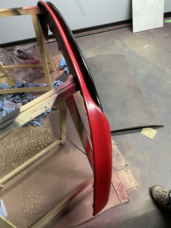

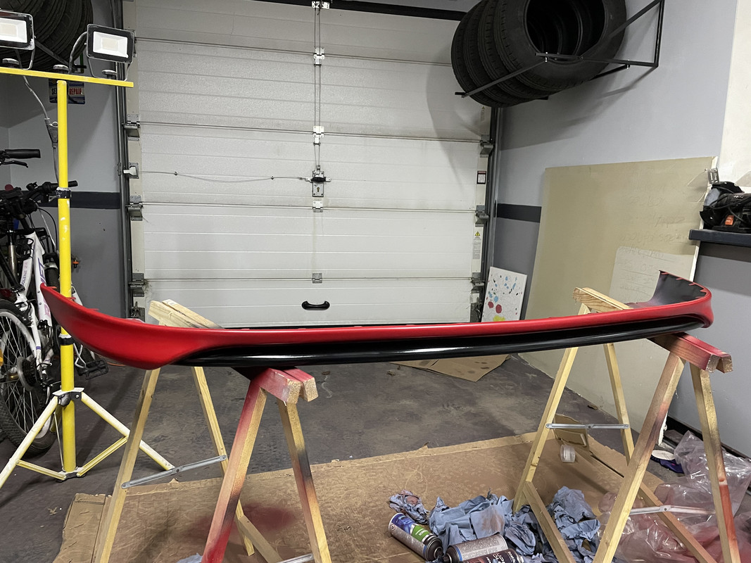

Decided to turn my frustration today into something more positive, so spent some time on the front lip.
Its not finished yet, but progress so far goes like this:
After the last update, i wet sanded everywhere with some 600 grit, and hit it with a couple of coats of the new primer.
Then once that had dried i sprayed the first coat of black, which came out far too thick and ran everywhere. So after some cleanup and another light sanding, i got the black down if not perfect at least ok.
And lastly tonight i masked off the center section and got the red down which went on easier than the black thankfully.
And thats where im leaving it tonight, tomorrow ill start the clearcoat and prayni dont make a mess of it.
Its not perfect by any means and ive now idea how good the color match will be, but i think its ok, a damn site better than the unpainted black lip thats on there now anyway

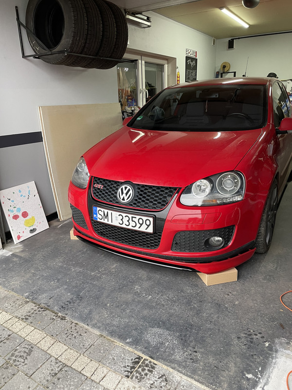

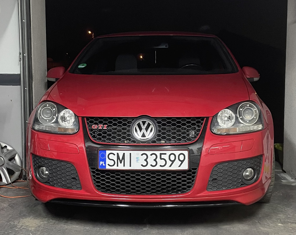

Fitted the front lip today, and as a good friend once said about his ex, its nice from afar, but far from nice.
If funds allow i may get it painted proffessionally, but it will do.

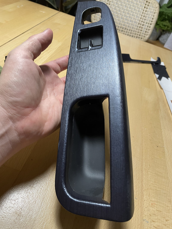

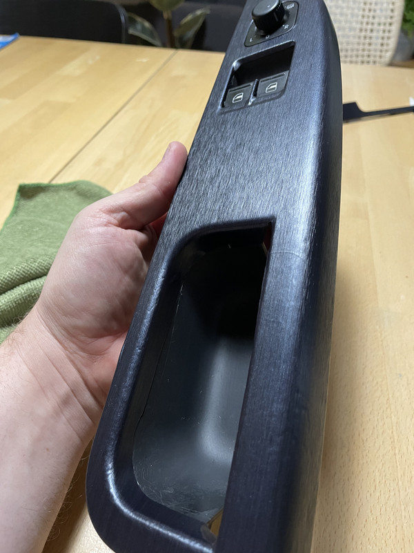

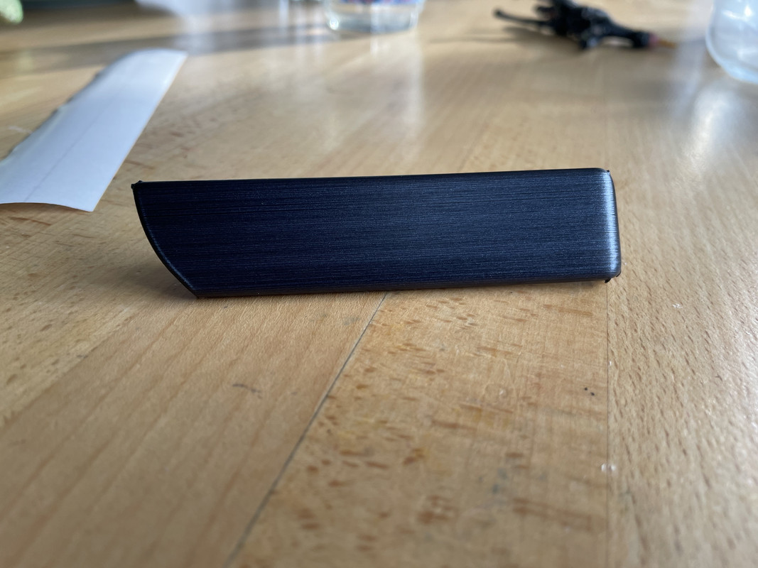

Just for some practice and a bit of fun i thought i wouldtry and wrap one of the grotty old door handle / switch consoles, this will be getting replaced anyway but it was a good way to learn what works and what doesnt.

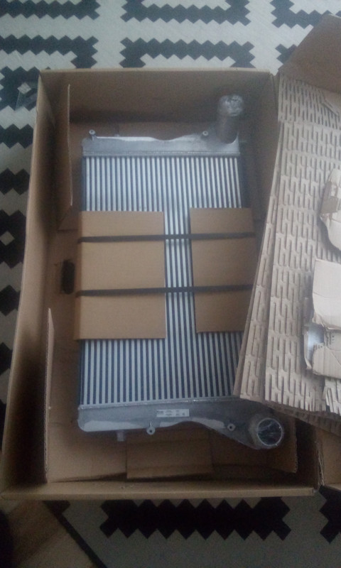

« Reply #28 on: February 24, 2023, 02:55:25 pm »
S3 intercooler arrived today, and this will probably be the last big purchase for a while,
I had planned on maybe stage 2, but repairs have eaten into that budget now, intake, intercooler, and coil overs is a good start though I think. I'm still considering options for brakes as well, as that's probably most important for track time

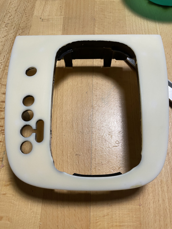

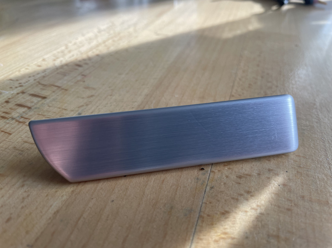

Tonights victim of wrapping was the gear shift surround.
I started this with the intention of getting rid of as much silver as possible, but when i looked at the trim and saw hiw scratched it was i decided that should be done.
And of course as soon as i started washing it, i ended up with this:
And after 20 minutes with the hairdryer and razerblade this is what im left with
Its far from perfect, there are a few bubbles and around the gear indicator letters is still a mess and will need some more work, but its an improvement.
The only question now is what to do with the silver trim that i was supposed to be getting rid of.
Maybe carbon wrap, or just matt black paint. Not sure yet, if anyone has a suggestion let me know.
