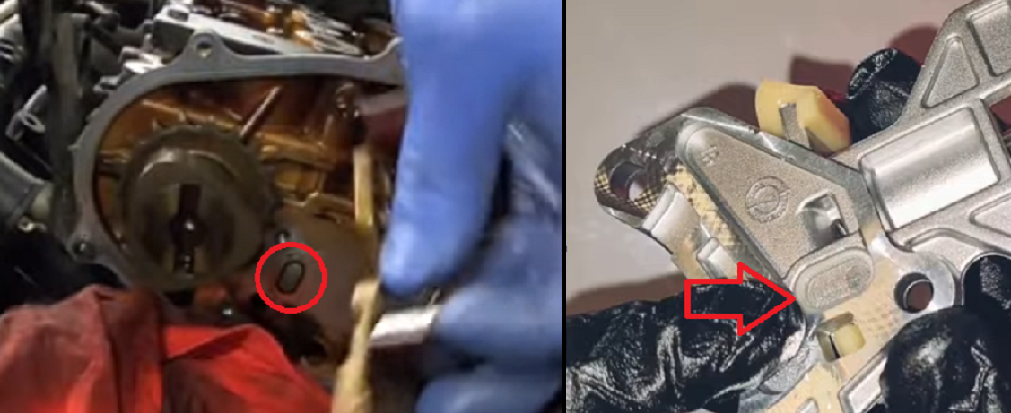

If you're talking about the 3 plastic rings inside the cam chain housing, known as oil control rings, they're fairly simple [once you've taken the cam chain housing off]. They're plastic rings that can be pried off with a pick, as they have a break in them that allows them to be stretched apart slightly. You may have to break the old ones off if they're too brittle to be stretched.
Here's a video showing multiple jobs relating to timing, go to 17:02 to see him put an oil control ring on:
If you want a guide how to get the cam chain housing off, you can follow this guide: https://www.mk5golfgti.co.uk/forum/index.php?topic=106158.0
Here's my control rings, they were all intact. Note that they're in the cam chain housing (the cover of the cam chain) rather than inside the cam chain mechanism or VVT phaser. I also recommend replacing that cam chain housing gasket while you're in there.

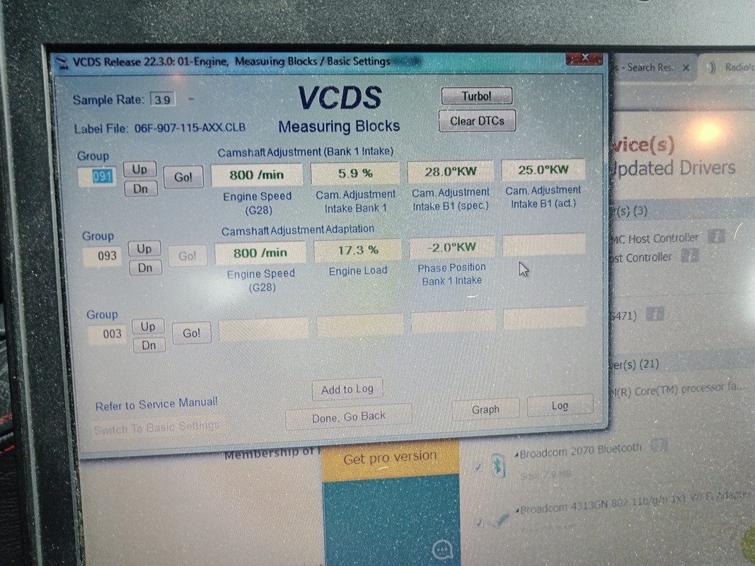

Thanks again for the reply. I really appreciate your time! I have been chasing this, on and off, for ages now. It's spoiling a brilliant car (an unmolested 80k mile Edition 30).
Attached below are the VCDS results.
Cam chain seems fine. Rock solid at -2kw.
The noise is intermittent, when the engine is warm and only at idle. Lift the rev's to just over 1,000 and it disappears.
On measuring block 91 the calculated and actual values start off at 28. Then the actual starts to fluctuate between 24 and 28. As it drops to 24/25 the noise appears. It then recovers to 28 and the noise disappears.
So I'm now on a process of elimination. Oil seals first. Then maybe a new second hand control module. Then I'm lost!

Yes Block 93 looks perfect, assuming the engine is fully up to temp. Unfortunately I don't have enough experience to say what the exact cause is, but as you said, oil control rings first, the inspect the more expensive stuff.

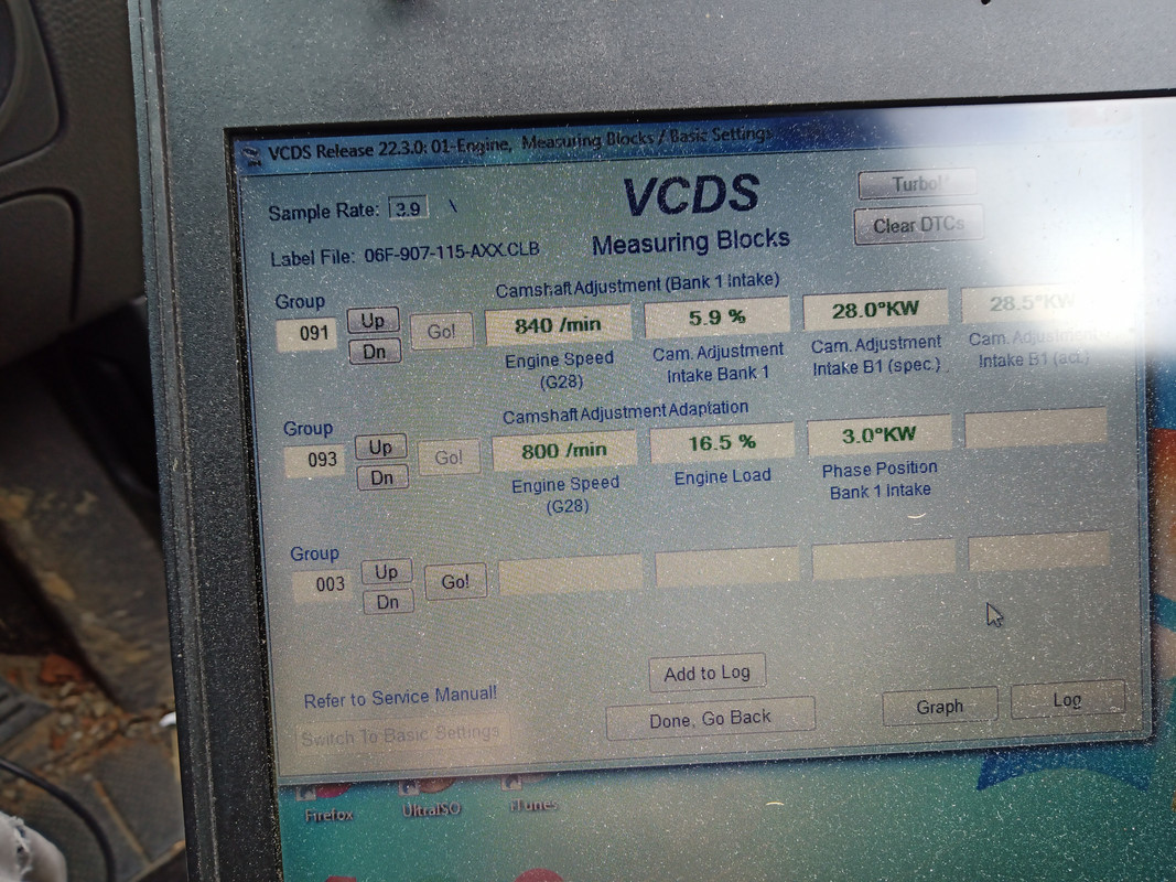

So I've been checking VCDS again and something has changed or I didn't notice it before.
After getting up to temperature 091 settled down with slight movement on actual 27.5 to 28.5 but the noise was still there.
But.
093 changed from -2 to 3. Yes positive 3!?
Should 093 alter with rev's? It doesn't move.
I'll stick with plan A of changing the seals but is this now looking like a failing valve timing control module?
Idle has always been around the 800 (I think) it has been mapped though. Note. I'm confident this  issue isn't related to the map as it was was done 7+yrs ago.

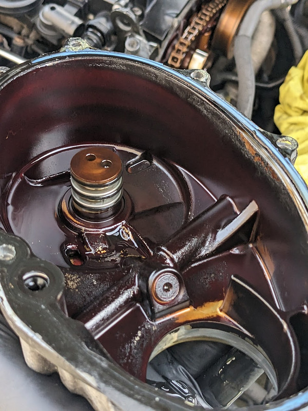

It could all be related to oil flow and containment throughout the VVT system.
Yes, always give it new oil containment rings when swapping the chain and tensioner.
Make sure the tensioner's oil inlet screen wasn't left behind; stuck to the head when you added the new tensioner. The cam phaser/adjuster can also be the cause due to internal wear. The oil flow from the sump may be the problem for having a restriction to oil flow somewhere. And remove and clean the N205's oil pickup screen from the lower lip of the chain cover.
N205 pickup screen:
Chain tensioner screen...meant to be on the tensioner, not stuck to the head:
