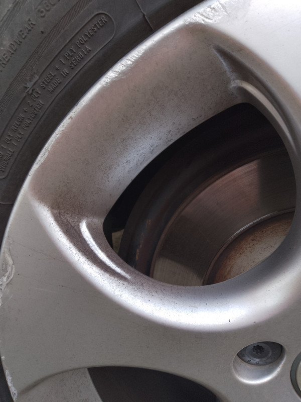

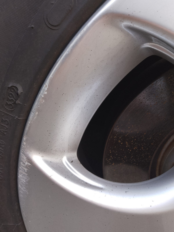

« Reply #9 on: December 15, 2024, 05:40:19 pm »
The dirty wheel is the rear with Pagid pads. That's only after about 100 miles. After another 100 it's really dirty and the front stays far cleaner. I just find it really annoying haha. It's definitely put me off Pagid.
