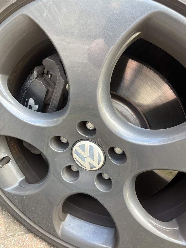

Does it look like this? I installed MK7 R calipers to my MK5 GTI and it took well over 800 miles to fully sweep the discs. Now are perfect.

I agree…. The images above were roughly 2 weeks after fitting as I sent them to my mechanic… I eventually took the car to the garage and they confirmed all was good. I researched this issue and seems common on MK7 calipers that they take a while to clear the lower portion of the disk. They have been on the car well over a year now and are perfect now.
Brakes both sides today:

Not sure what side was the faster side at going down. Afterwards they were both equal with a small ring like the second image and stayed like that for ages! Then finally cleared fully on both sides.

Can you post images of your brakes?
