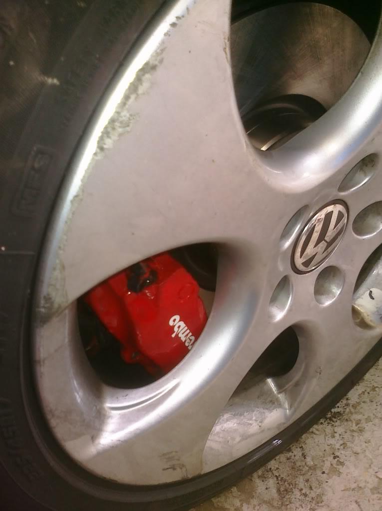

Fitted the kit today, pretty easy about 45 mins a side once you have figured out what to do, first side took me about 2 hours!
First grind back the caliper posts as per DaveB's earlier instructions, initially I fitted the calipers without and all I achieved was the new disk was locked solid.
The disk retaining bolt was siezed and the head stripped so i had to drill out both sides, no real problem, don't need the retaining bolt as the pads hold the dsik in place until you can bolt the wheel on.

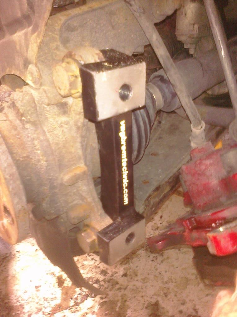

First step, once you have removed the old caliper and disk (my old caliper hanging to one side) is to bolt in the adaptors as can be seen:

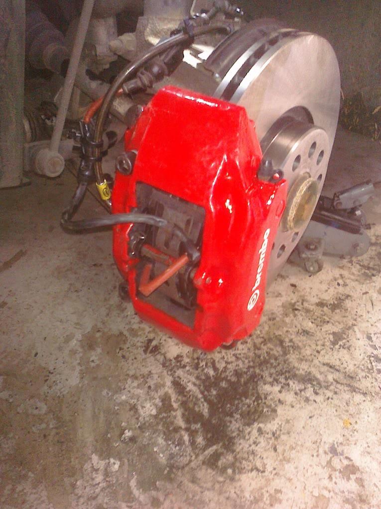

then bolt caliper on, you can see the two vertical bolts on the left side of the caliper:

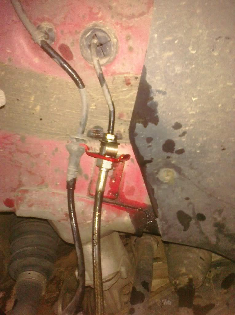

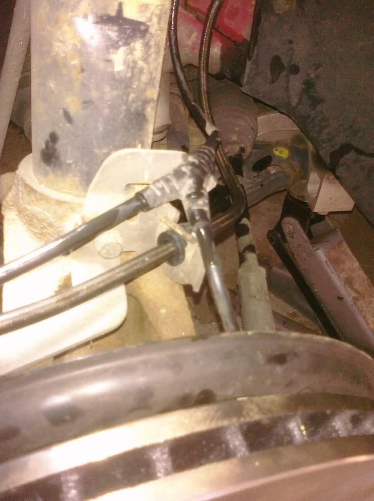

then fit pads and on the passenger side I spliced the porsche pad wear sesnor into the VW pad wear sesnor plug so i still have pad wear sensing. Then I fitted new hose: the Y piece in this pic is the cable to the pad wear sesnor and also the ESP sensor. The clearance when you put the wheels on is very tight about 1 - 2 mm max:
Curbing coutesy of my wife  :fighting:

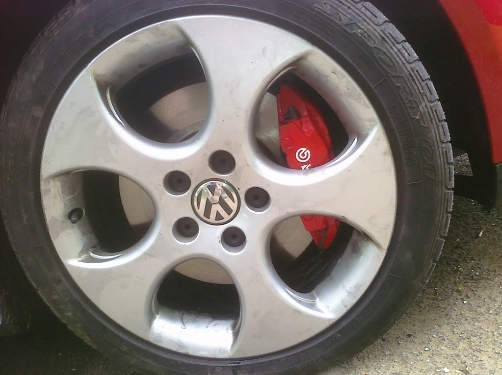

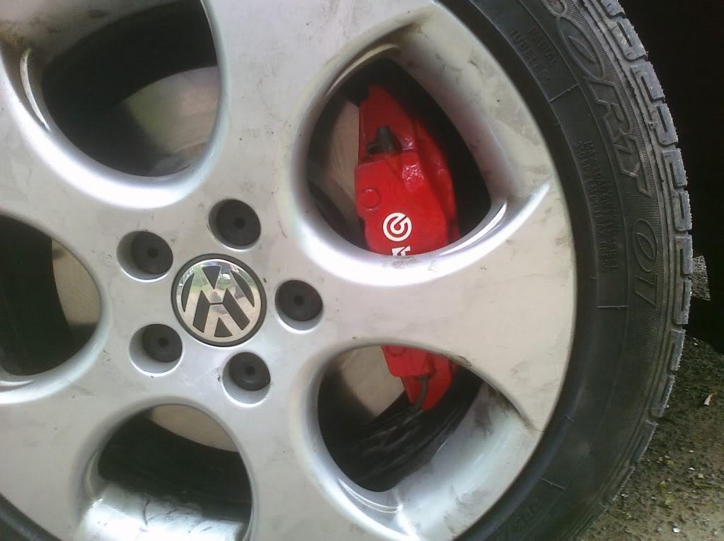

Finished job looks good (haven't cleaned the wheels yet) the pedal feel is sooooooo much beter and even though I haven't bedded the brakes in It feels so much stronger at stopping, can't wait until they are fully bedded in!
Wife in aberdeen with the ed30 at the moment this is my std (well 275HP, 315lbft) GTI with 17" Monza 2's, will try the pescara's when she gets back sometime next week and see if they fit, they are std 18"'s

Looking Good John
So just to confirm on the 17" Monza - no spacer required...but clearance is tight maybe 2-3mm??????
Looking good for the 18" Monza if thats the case
Might be worth investing in a non hubcentric 2 maybe 3mm spacer and some 30mm bolts instead of standard OEM 27mm bolts to give a little clearance for caliper/wheel flex when hooning.

« Reply #109 on: May 30, 2010, 09:51:06 am »
Hi Dave,
Exactly right, 17" std monza's, clearance is nearer the 2mm mark though.......it does look bloody tight and I am worried when it gets hot in there are 20 mins of heavy braking into quarry and it all expands. I think a slim spacer would be a good investment.
Will try with 18" pescara's later in the week and post results.

Top tips for a smooth install are:
1) Take 1mm off each peg on the caliper first, I did both sides to be sure
2) Ensure you fit the adaptor as per my pic, it can go on in different ways and I spend a while on the first side experimenting which way it should go on
3) make sure you fit the caliper with the bleed nipples at the top, sounds obvious but easy to fit the other way round and you will never successfully bleed it with the nipples at the bottom
4) Leave the union of the pipe at the caliper loose until everything bolted up, then tighten the caliper union and fit the new hose onto the car fixed pipe, I left the old caliper connected but tucked out the way until ready for this connection when the new caliper all fitted, minimises any loss of fluid and the car lines draining down.
Finally the old caliper mounting bolts are pretty tight so be prepared for serious leverage to get them loose!.
If you follow above top tips and my install pics is a surprisingly simple job!
