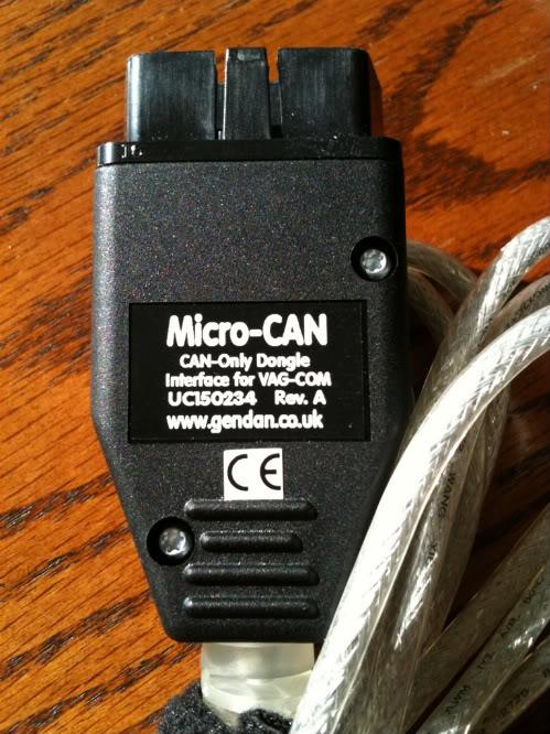

Won this on Ebay the other day  :grin:
had a quick play doing the usual stuff quick code read all ok apart from headlamp washer relay showing open or short to ground ,which turned out to be a blown fuse
also turned off Seat Belt warning chime , adjusted remote locking from unlocking only drivers door to all and turned on auto/ anti-hijack locking
Still learning how to use it but anyone in the Hull area needs anything doing drop me a PM and I'll be happy to help if I can

Blown fues on the headlight washers are common due to them freezing up in the winter  :happy2:
How much of a bargain was it then?

Got the Micro Can for £135 which I thought was a good buy
Very true mate.. Had 2 replaced on mine..

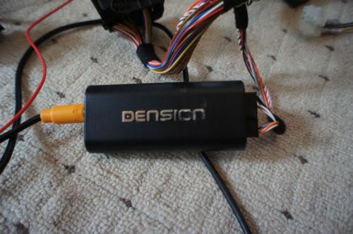

Then won this on ebay
which came with this
I've got to say I'm very impressed with SatNav and the Dension gives me full iPod control

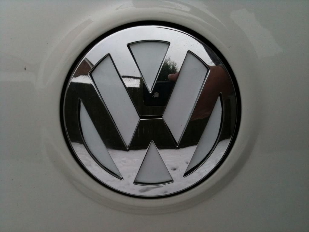

had a quick play with some white vinyl not the right shade tho

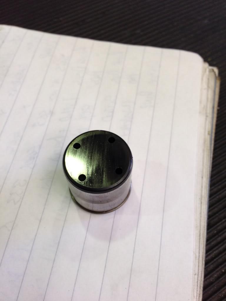

Changed Fuel pump camshaft follower this weekend looks in good condition for 53k
