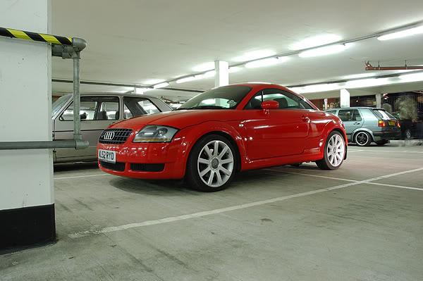

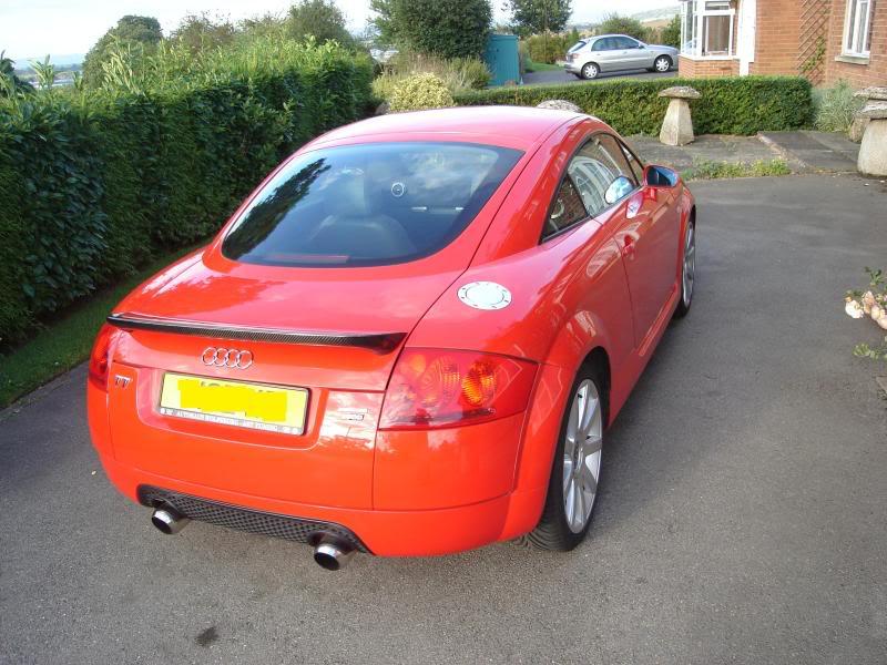

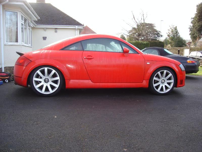

Shes a 2003 BAM Audi 225 Quatrro in Missano Red that is a really my weekend toy/track slag,brough as a standard car 2 years ago. Spec is HUGE but includes:

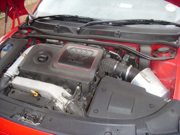

Engine:
Fully forged Eurospec engine
Forged Eurospec pistons 82.5mm
Eurospec con rods
Eurospec 14lb Billet crank with bolts
CNC big valve head. 1mm over sized valves - Flowed etc....
Raceware head kit
750cc injectors
RMR inlet manifold (Boss Racing)
80mm Throttle body - R32
Jabbasport Baffeld oil sump

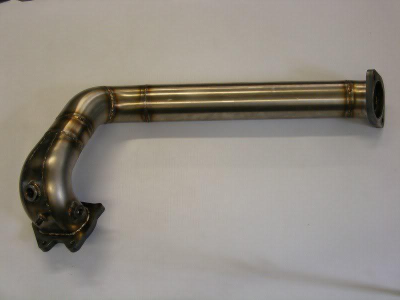

Custom Down pipe
Custon exhaust system
Mocal Oil cooler - Yet to buy

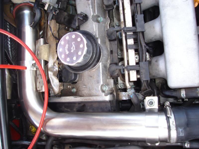

Ali charge pipes etc
Forge Supersize recirculating dump valve
GT30 Hybrid by Owens (Largest compressor wheel of the 3 and the WRC Cartridge)

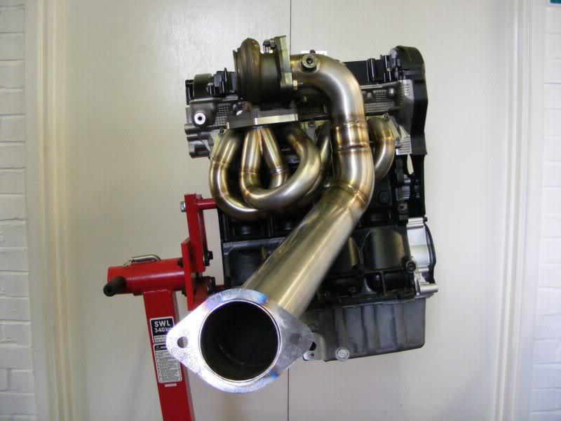

Top Mount Tubular Race Manifold
Forge hose kits (all they do + some they dont!)
Dynatwist intake (added 9bhp dyno back to back over stock drilled box with pipercross filter)
Pro Alloy FMIC with 70mm pipework
Water Methanol to be installed
NGK plugs (2 stage cooler)
Forge Supersize DV
Custom 3" turbo back exhuast system
It makes about 545bhp

Garret Top mount manifold
GTX30R76 (Havent ordered yet)

This will probally make less peak power but should be far more reliable (larger flange will reduce EGT and allow less boost for same power)

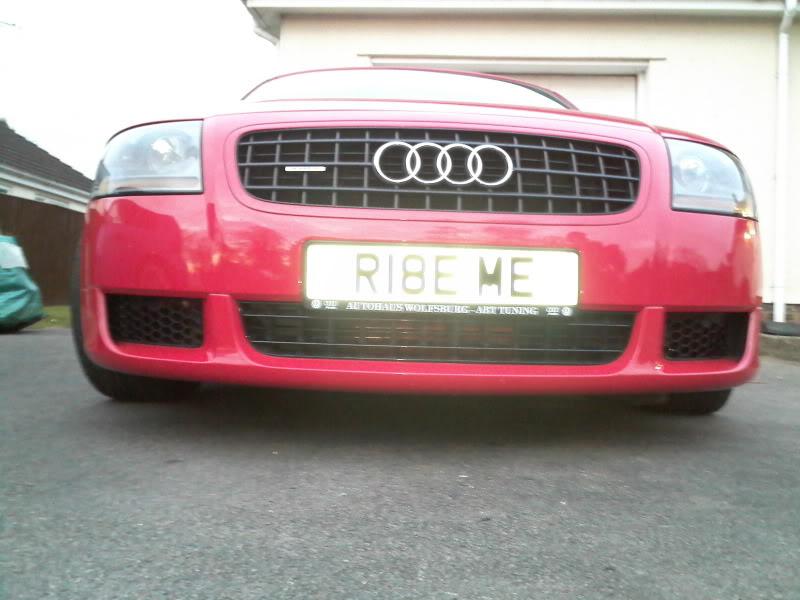

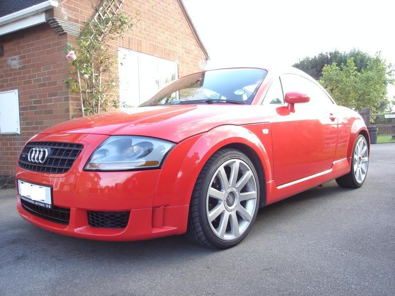

QS Front bumper and grills
Oris carbon rear diffuser
Oris Carbon Spoiler

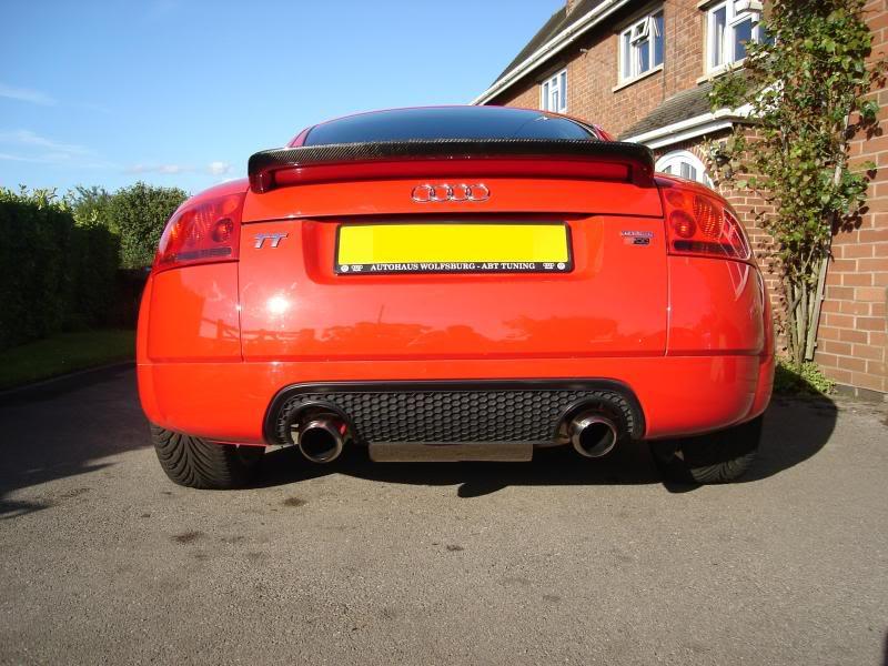

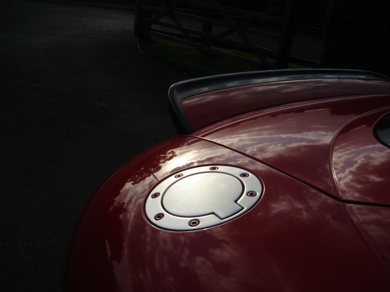

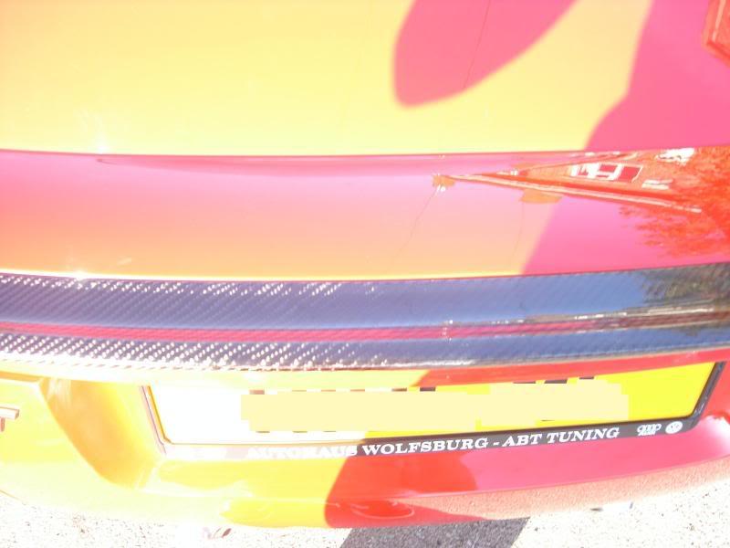

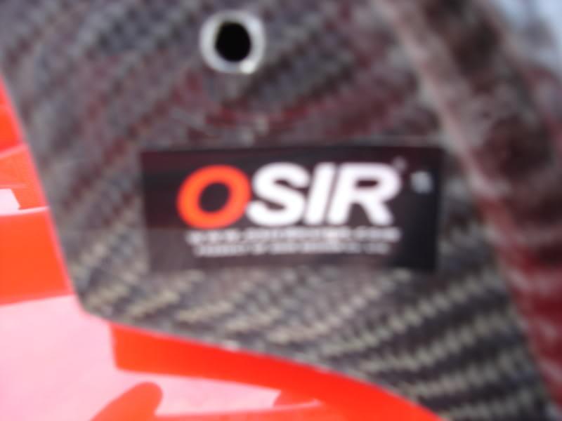

Real Carbon ORIS spoiler! Yes they are a fotune, but sooo worth it!

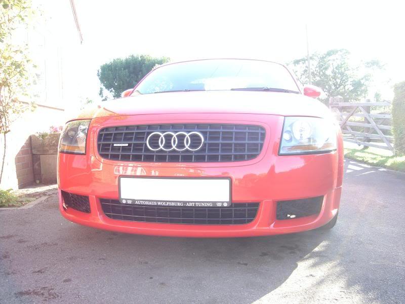

Got my QS front end on (Bumper and the 3 grills from the LTD edition TT Quattro Sport) TT QS

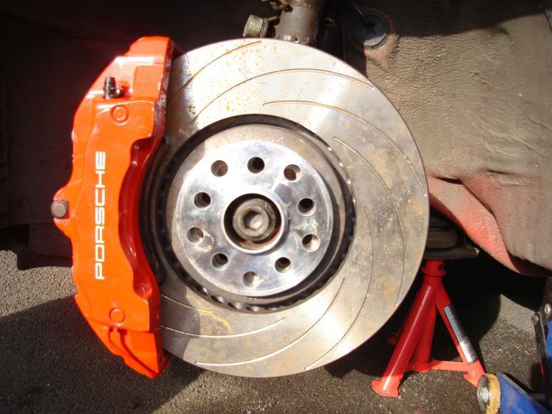

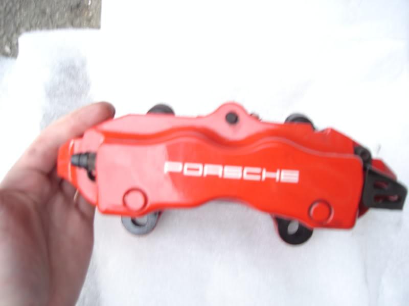

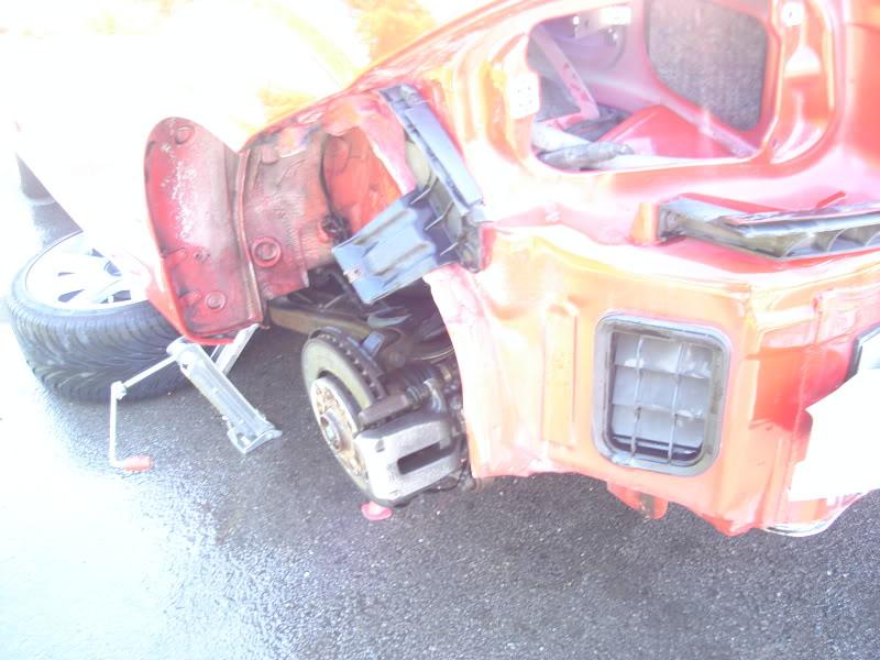

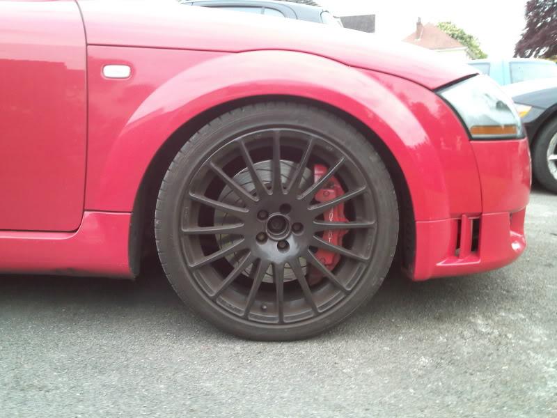

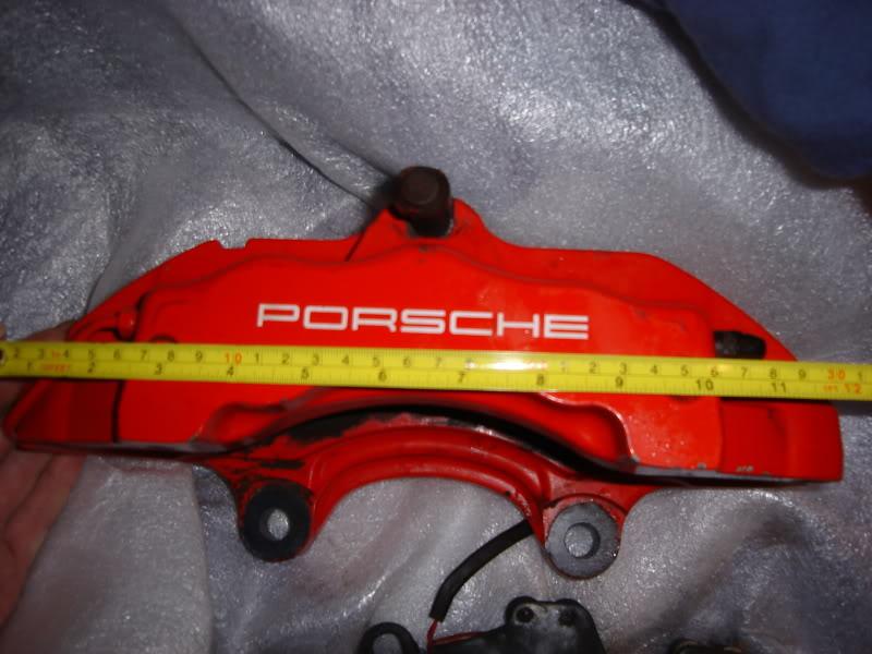

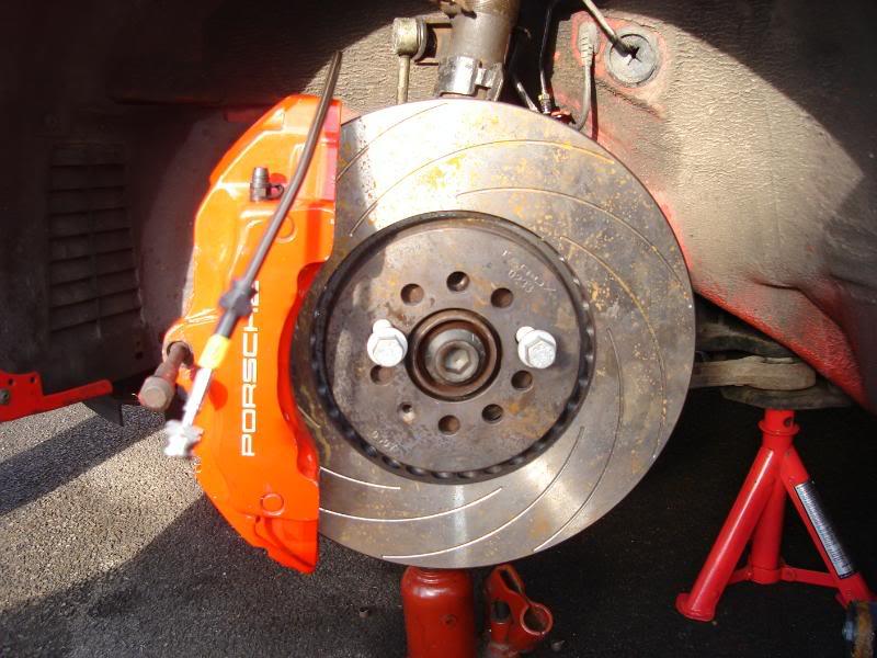

Next was brakes. I was lucky enough to find a 500 mile GT2 smashed up at a breakers and brought:
These are 4 pots off the rear of a GT2 or GT3 996 911. They were going to be for the rear of the TT, but things have changed and I never fitted, so let me know if you fancy buying.
I also got the 6 pots for the front of the TT. These are now fitted and AMAZING! At a rescent trackday I was outbraking race TVR's on slicks (God knows how, as its all about tyres on the track really). They were amazed and came over after a few sessions to see what I was all about. I was coming in as I was overheating engine, and they were coming in as overheating brakes. he he
6 pot brembo calipers.
334mm Tarox disks (Yes they are small for a reason, getting 17" wheels over them)
HEL lines
Tarox Pads (Pricey as you like)

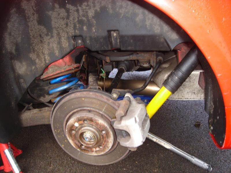

FK coilovers now. I brought these along with some KW adjustable tie bars. Anyone that knows about the mk1 quattro platform cars (R32, S3, TT) will know you need these when lowering to get rear camber back in as standard items allow so little adjustment.
FK go low for maximum scene points  (needed them when you cant afford big power insurance yet  )
Bollox, still to high
Adjustable Tie bars were added too

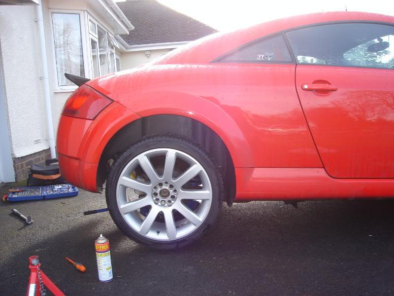

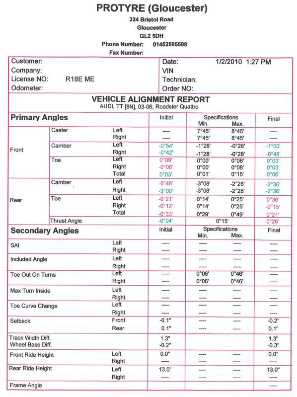

And what do we all do after a good lowering? ALLIGNMENT TIME

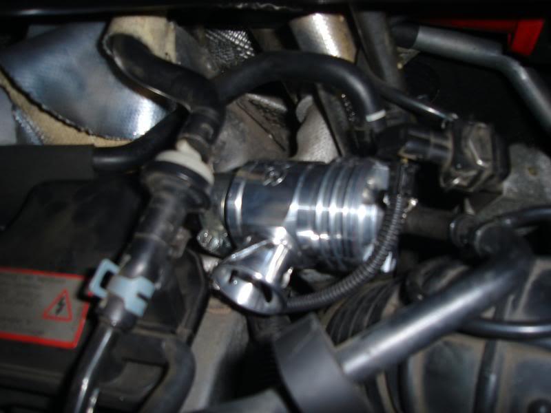

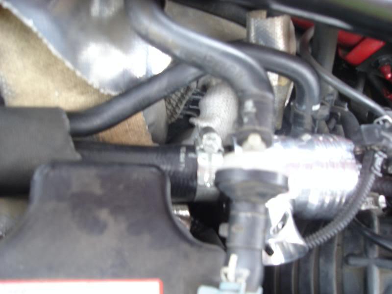

No 1.8T motor is complete without a 007 Forge Re-Circ Valve

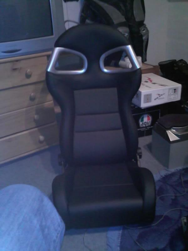

GT3 seats - Didnt like and now have been sold
The reason for them comming out is this!

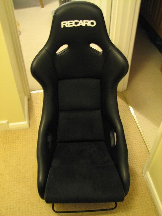

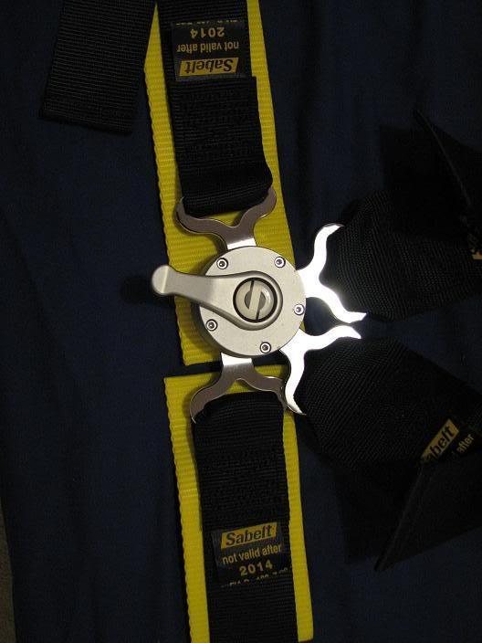

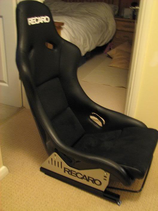

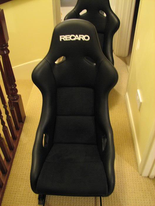

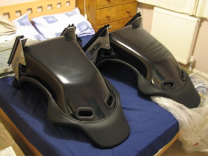

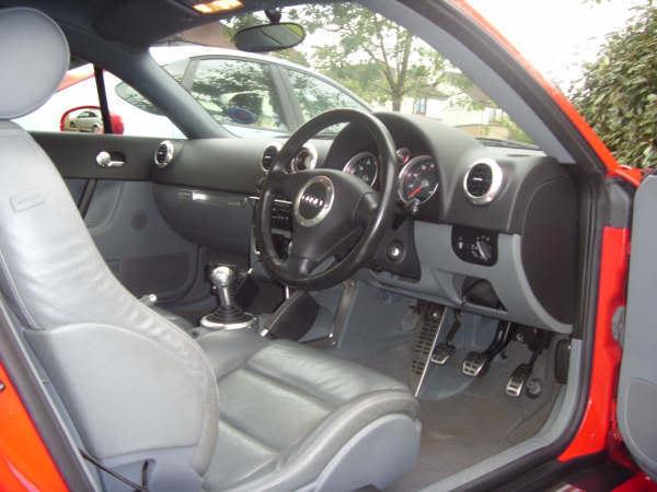

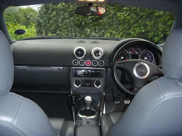

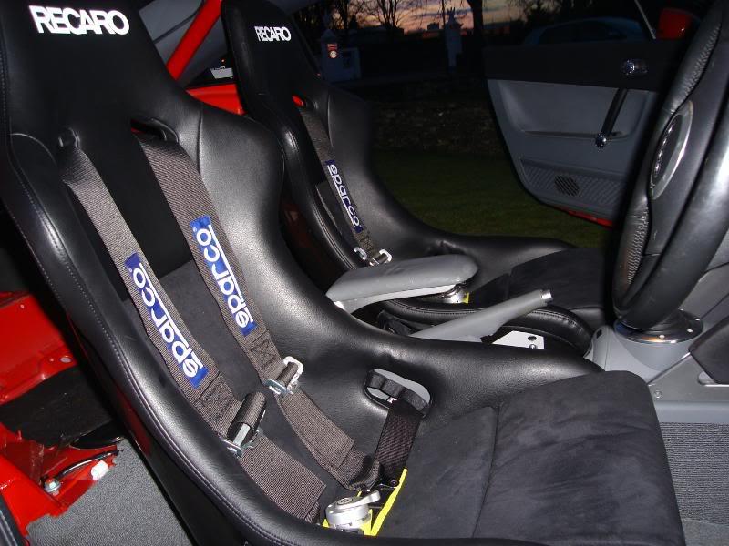

Recearo Pole Positions in Black leather and Black backs, along with ali Recearo runners. PERFECT! These came in the TT QS and are the best part of that car! They are supportive allow harnesses and weight only 7kg each with the runners (I have the light runners). The stock TT headted leather seats are 27kg each, so seats alone have saved me 40kg and seatbelts removed and harnesses have saved me a few more! I had a very back motorbike accident when I was younger and my back is *****, these seats are sooo much better for my back (belive it or not) so much so I dont think I will ever sell and will just move them from car to car! The seats and belts are in date stamp till 2014 (not that it bothers me)
They went in along with these:

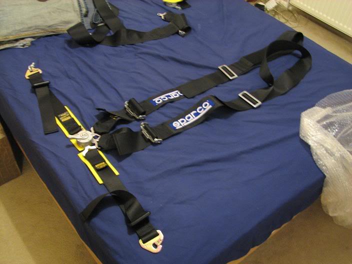

Sparco Buddy Club 3" Harnesses
Money shot as they say

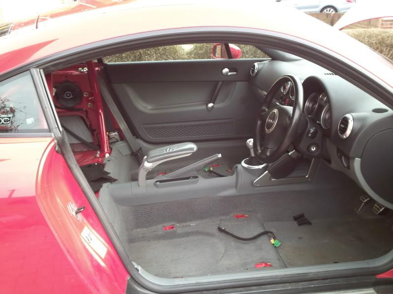

yes the arm rest was needed as I was on the way to the ring soon after
Those of you that are still reading and not just picture looking  will notice A part stripped interior, well she was going through a change (less weight)
There we are, less weight, told you I was good!
Driving was a little awkward
Oh no wait there we are, I can drive like this

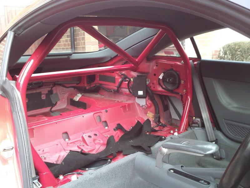

This is the reason for all this!
Saftey devices FIA approved cage! These came fitted by Audi on their TT QS track cars (if you brought a QS brand new you got a free day racing around in one on a track with this cage fitted. Its not that intrusive, just makes the car look the part. Its 27kg extra added, however its very noticable how much it has stiffened car up (infact unbelivibley how much it has). All TT owners that have got in have noticed this so cant just be me! Makes it easier to get rear end out thats for sure!

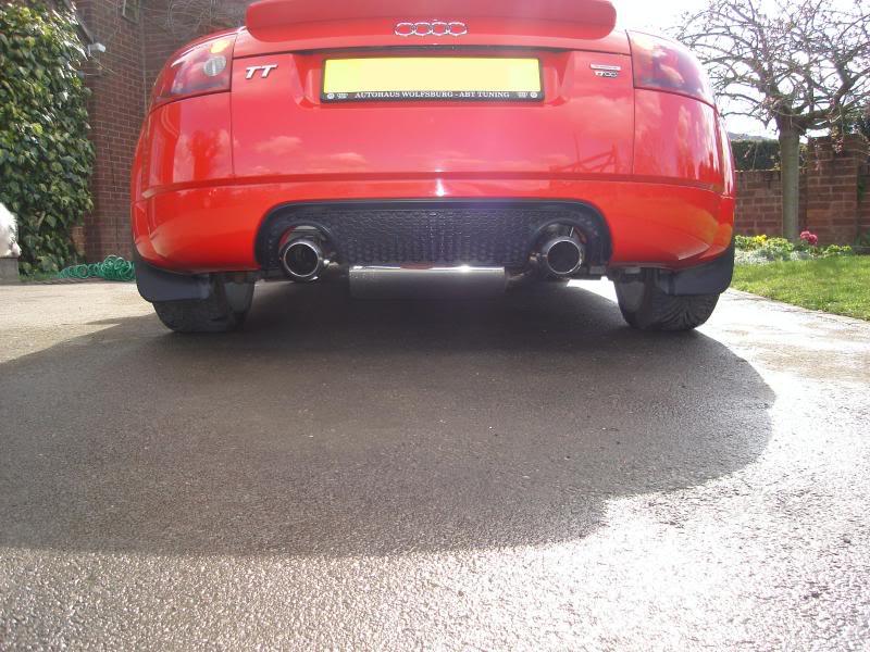

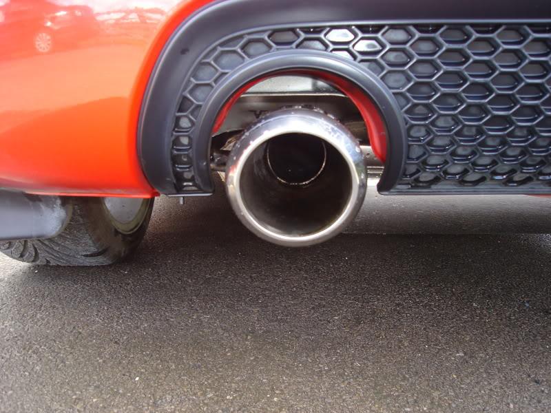

3" Tip

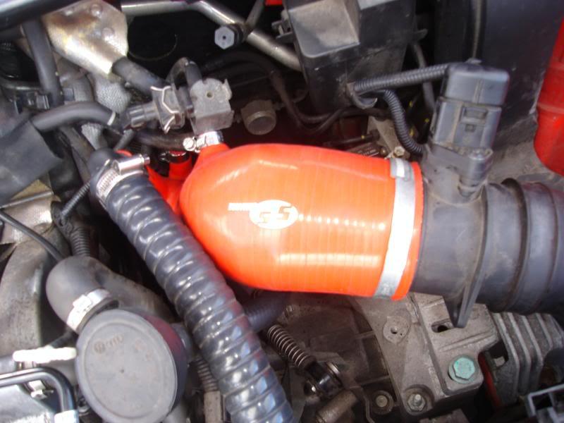

Dedaffled intake pipe & some blimg

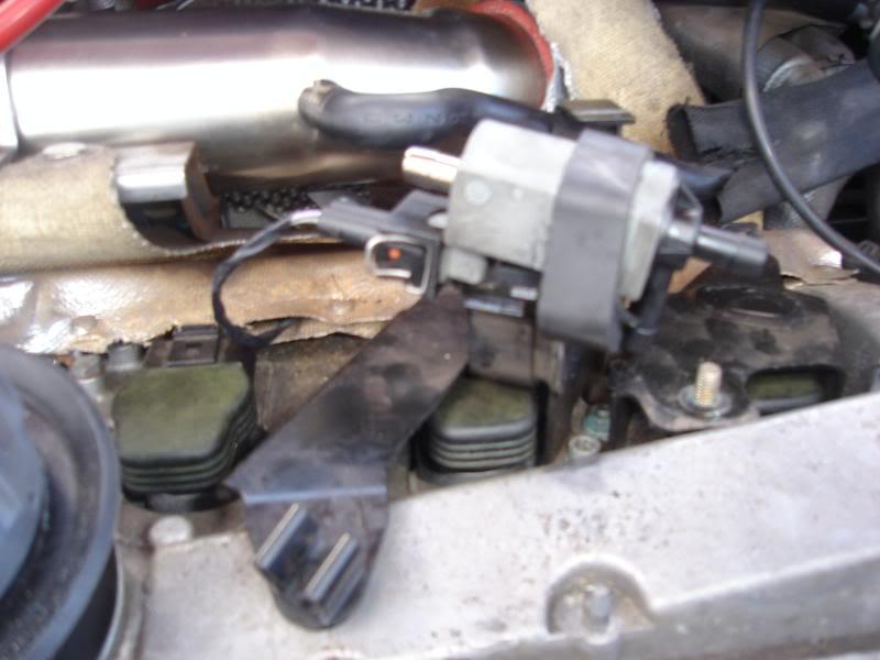

N249 removed

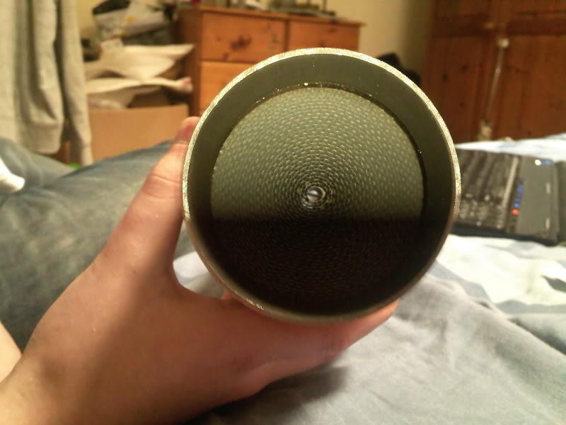

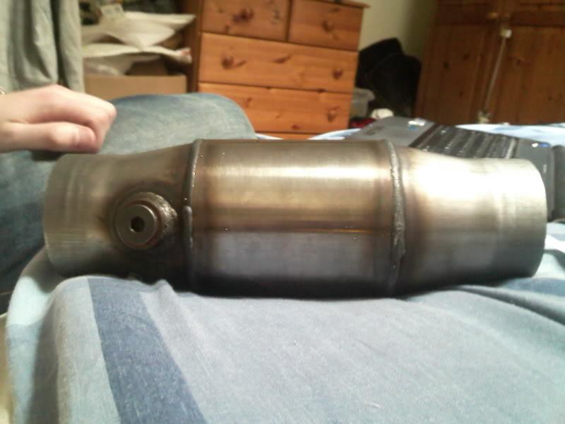

I then got a 3" DP and Pipewerx sports cat (This is no longer on the car)

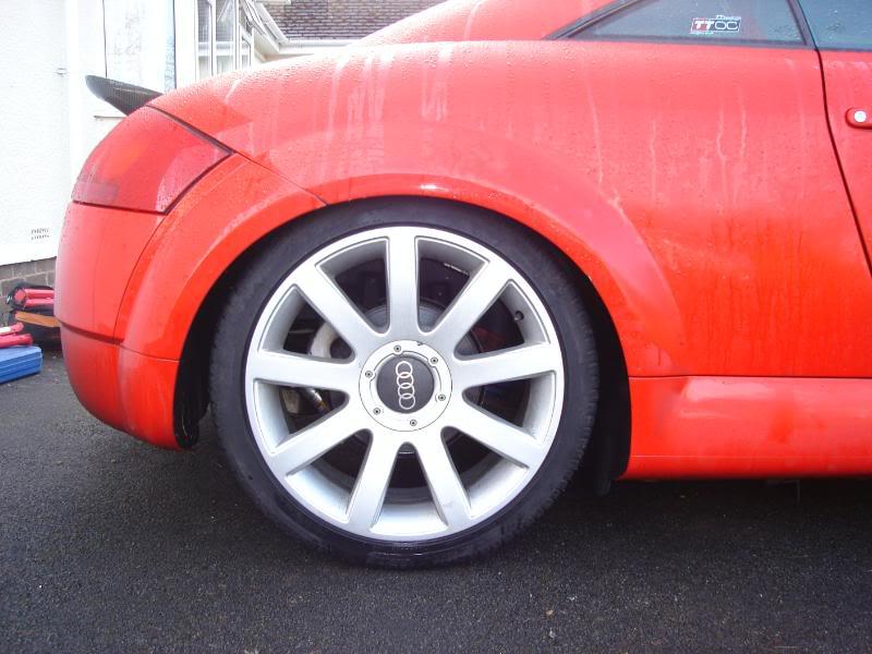

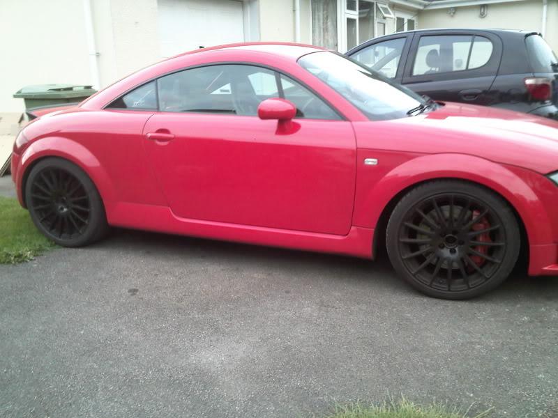

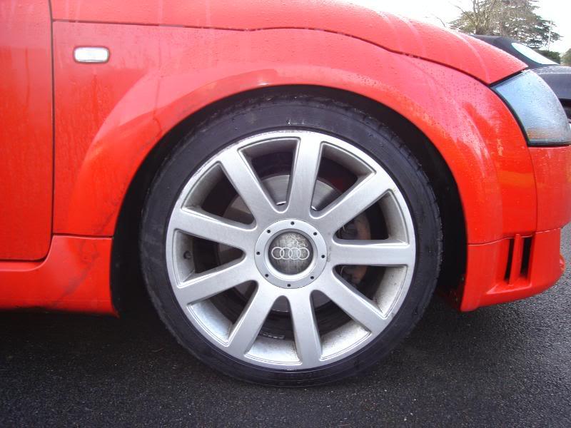

Some OZ 18" x 8" Superturismos in black were added along with uprated Haldex controler (sends more power to the back)
Take a look at eth state of my black wheels! Brake dust!

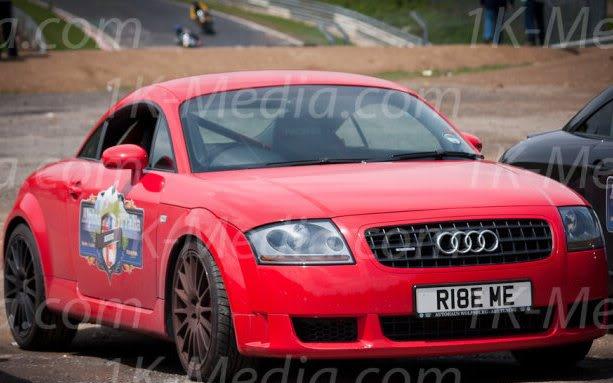

Then for her 1st track day at Colerne. Open pit lane full day £125!
I loved it, I didnt go mad as it was my 1st but it shows you were you need to make imporvmnts to the car..... OIL COOLER!
Most were overheating brakes but this was deffinatley never my concern, mine was oil and intake temps, so good places to start with the next round of mods. I need a open faced helmet! £400 Arai that I have for the bike gets rather hot!
It wasnt the cars weak point but reaised I should stop messing around with stupidley low suspension and put somthing more track orintated on her so should could be driven harder!
