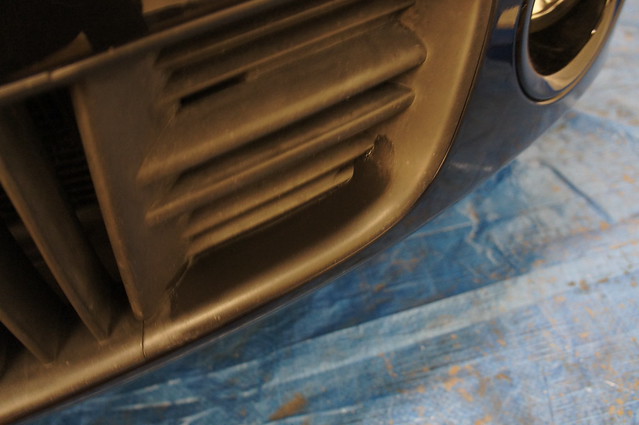

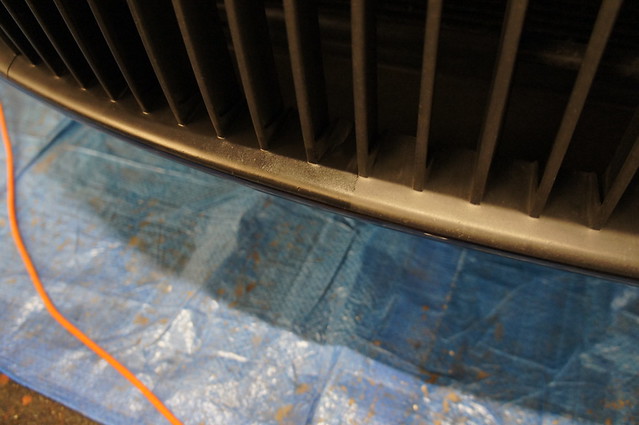

It has seen paint during its life though, an accident saw to the whole front end and front doors being replaced and painted (its not the greatest paint job in the world close up but its passable from 3 feet away)... orange peel in keeping with the rest of the BMW factory finish :thumb:

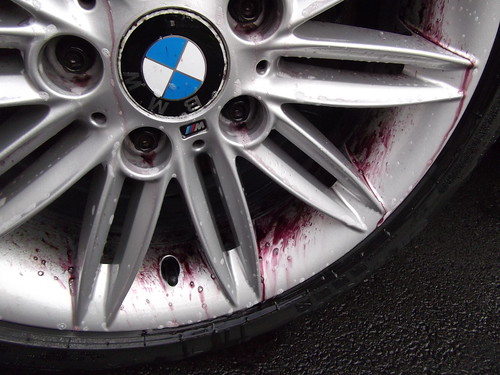

This was left to dwell while the wheels were cleaned using Megs Wheel Brightener and various brushes.
Before:
DSCF1117 by n_d_fox, on Flickr
After:
DSCF1125 by n_d_fox, on Flickr

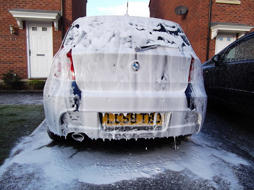

Car was then rinsed (zero sheeting or beading during this stage) and foamed with a strong and thick Megs APC mix
DSCF1119 by n_d_fox, on Flickr
DSCF1121 by n_d_fox, on Flickr
This was left to dwell for a good 10 minutes then rinsed.

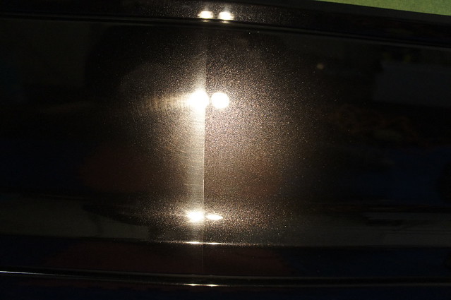

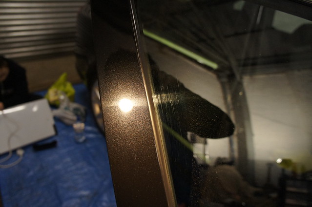

Machining time now... we decided as there were 2 of us working on the car that we could tag team it and have time for a 2 stage correction. Steve therefore went over the car with Megs 105 on a Lake Country cutting pad to cut out all the defects and I followed with DoDo Juice Lime Prime on a Megs polishing pad which refined the finish nicely and added some much needed gloss to the paint.
DSCF1141 by n_d_fox, on Flickr
DSCF1140 by n_d_fox, on Flickr

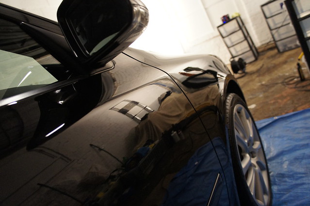

So, after to layers and a final wipe down here are the finished shots

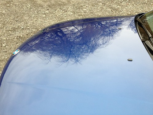

Bonnet:
DSCF1142 by n_d_fox, on Flickr

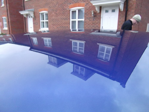

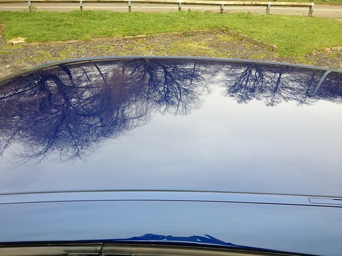

Roof:
DSCF1145 by n_d_fox, on Flickr

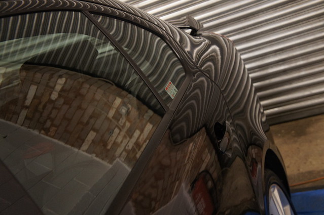

Various afters:
photo 1 (2) by n_d_fox, on Flickr
photo 3 by n_d_fox, on Flickr
photo 4 by n_d_fox, on Flickr
photo 6 by n_d_fox, on Flickr
photo 7 by n_d_fox, on Flickr
photo 8 by n_d_fox, on Flickr
photo 9 by n_d_fox, on Flickr
photo 10 by n_d_fox, on Flickr
photo 11 by n_d_fox, on Flickr
