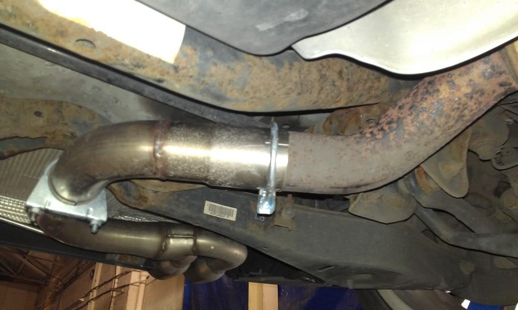

yes you can, you just need a reducer to connect the two.  I had the pipewerx downpipe which didnt even need the reducer as it was built into the pipe already.
This isnt the one i had but you can see the reducer builtinto it
