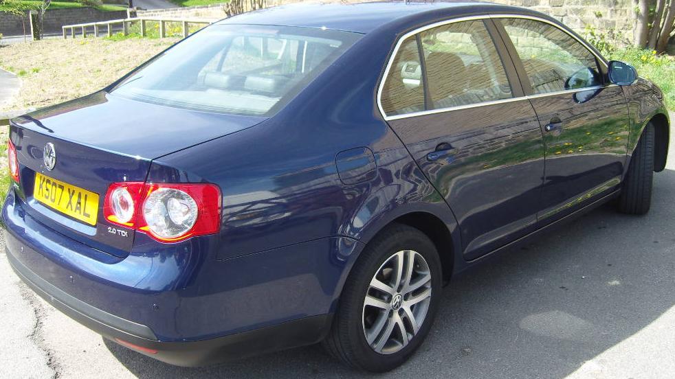

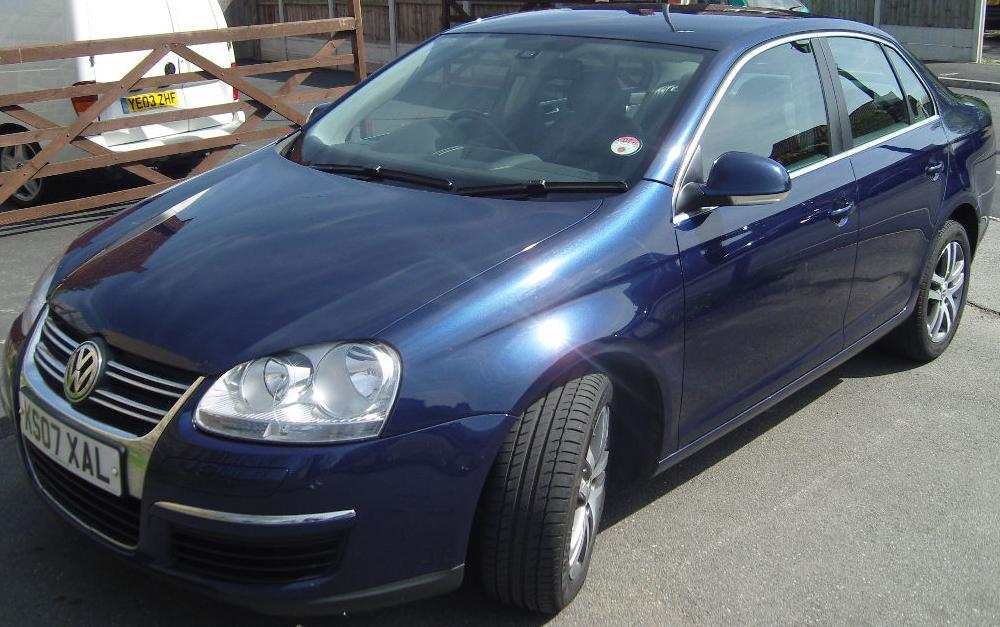

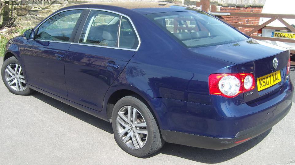

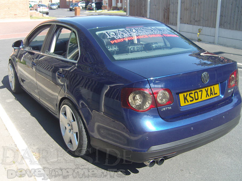

Back in March I bought a 2007 Jetta 2.0 TDI (BKD Engine). Here are some pics of it when I got it:

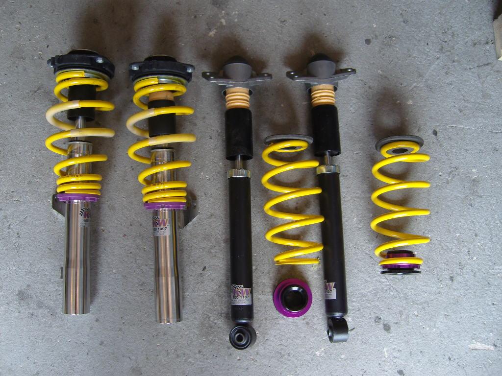

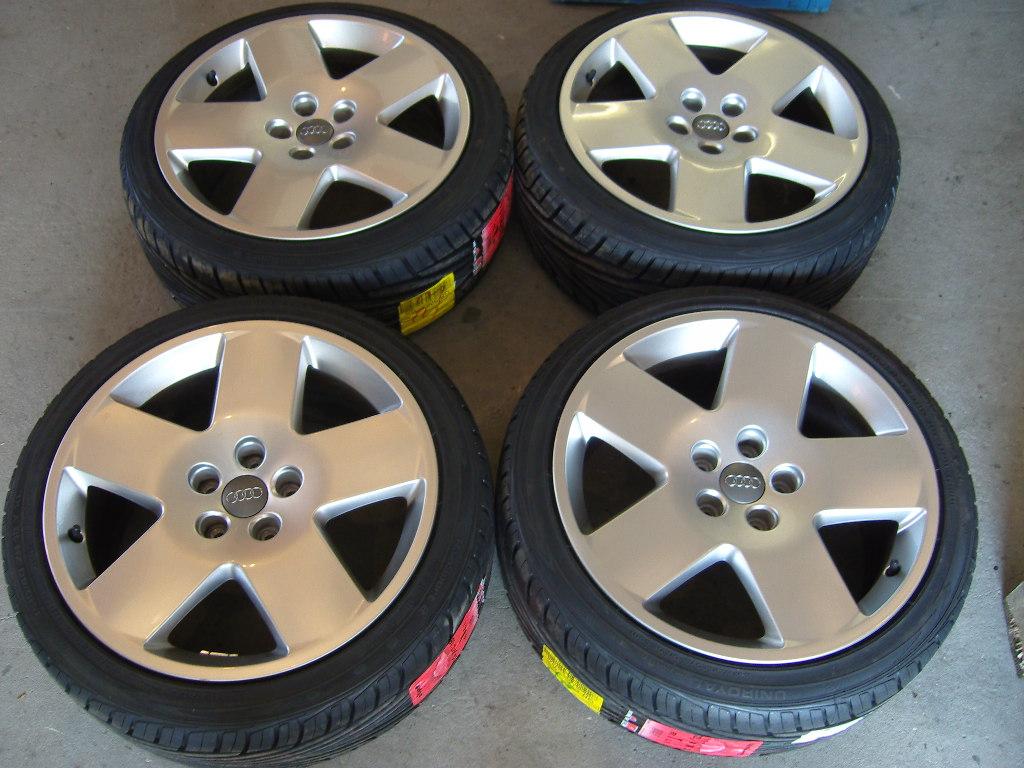

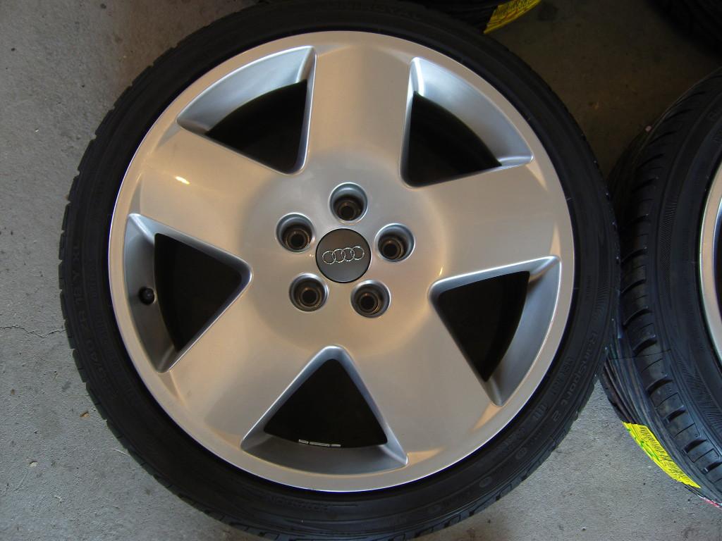

Audi 18" x 8.5" Fat Fives with 225/40/18 Uniroyal Rainsports
KW V1 Inoxline

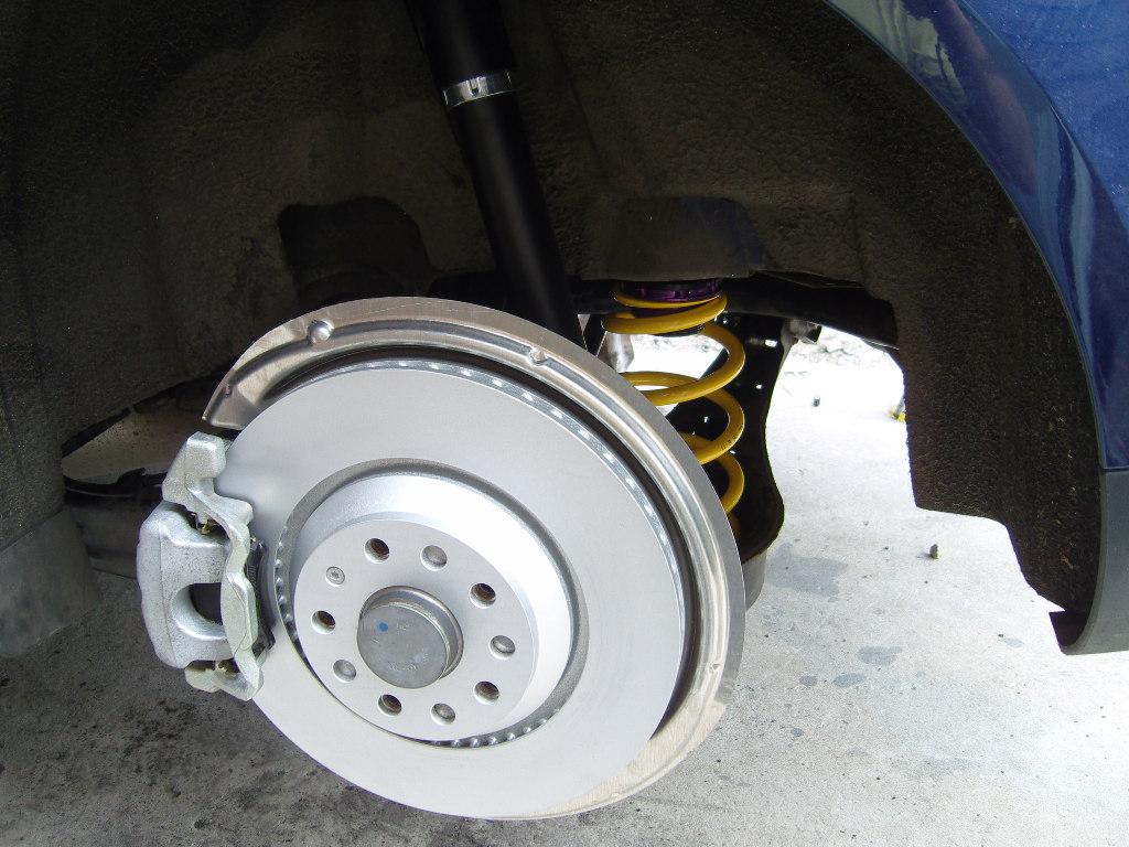

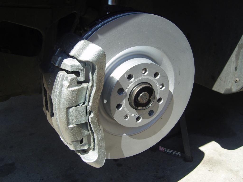

We also fitted an Audi TT 2.0 TFSI Rear Axle and Alloy Hubs that gave us 26mm more width and TT Front Alloy Hubs and Cast Wishbones, which give an extra 30mm and more camber. I have loads of pics, but didn't upload them. Everything is much beefier and lighter.
R32 345mm Front and 310mm Rear Discs. The front calipers have a TyrolSport Caliper Stiffening kit, which I would recommend it to anyone. Google it and see what I mean.

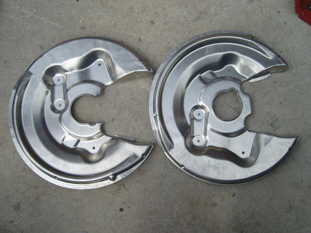

We used Eos 3.2 FWD Splash Guards with fit perfectly with a slight modification

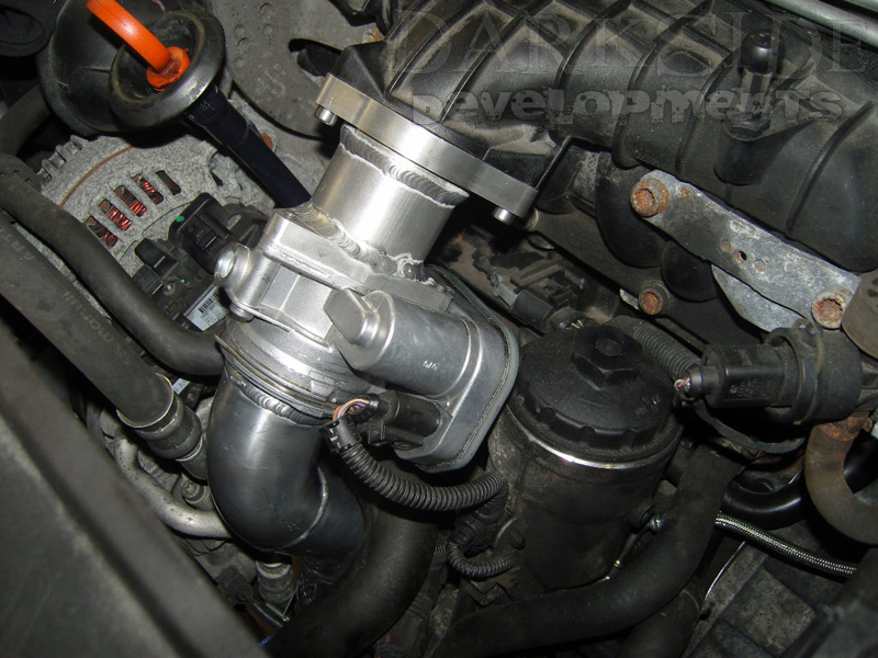

We then fitted a Darkside Developments EGR Delete and removed the EGR cooler completely:

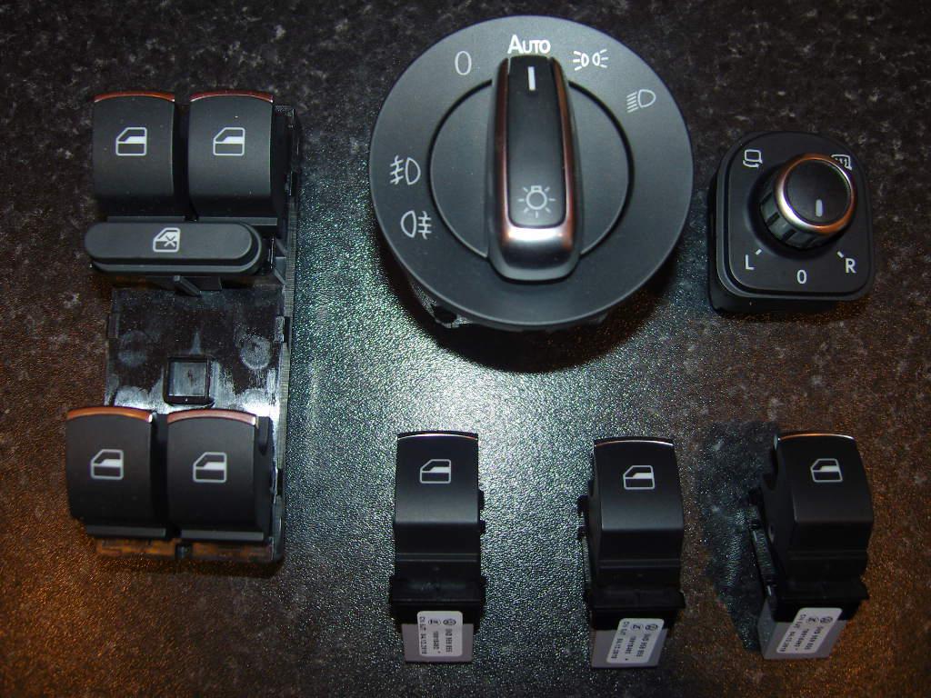

Some little interior mods -

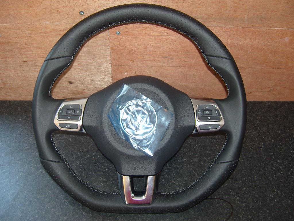

Scirocco Flat Bottom MFSW
Passatt CC Switches

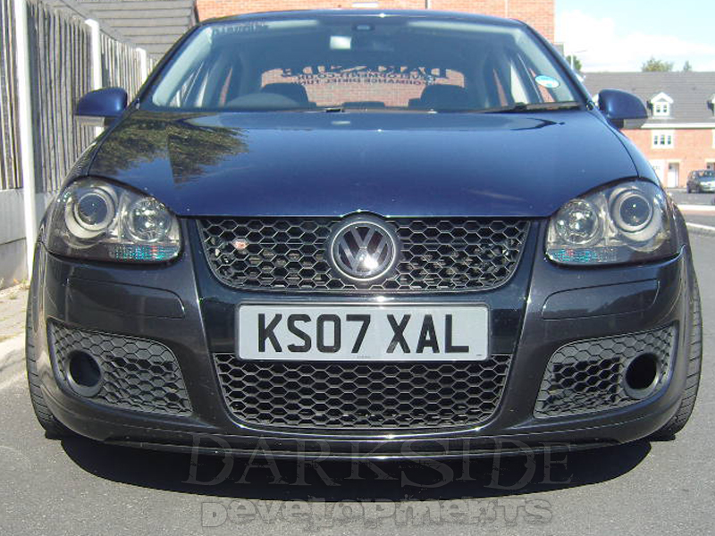

We then concentrated on the body mods, we did the following:
Golf GTi Front bumper with Summer grills
Jetta GLI Rear Valance

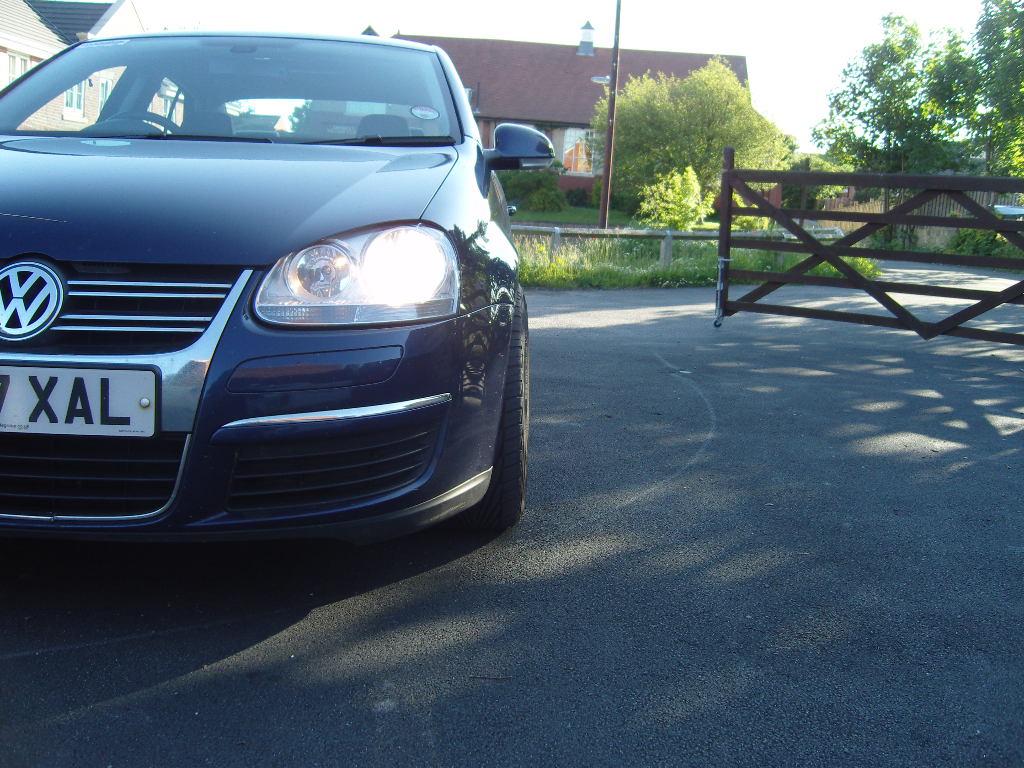

Hella Projectors with Lamin-X Gun Smoke Tint and Osram Nightbreaker Bulbs
Smoked Rear Lights
Smoked Reflectors
Smoked Indicator Lenses
Smoked Numberplates
Rolled and Flared arches
Black VW Emblems
Here is how it looked:

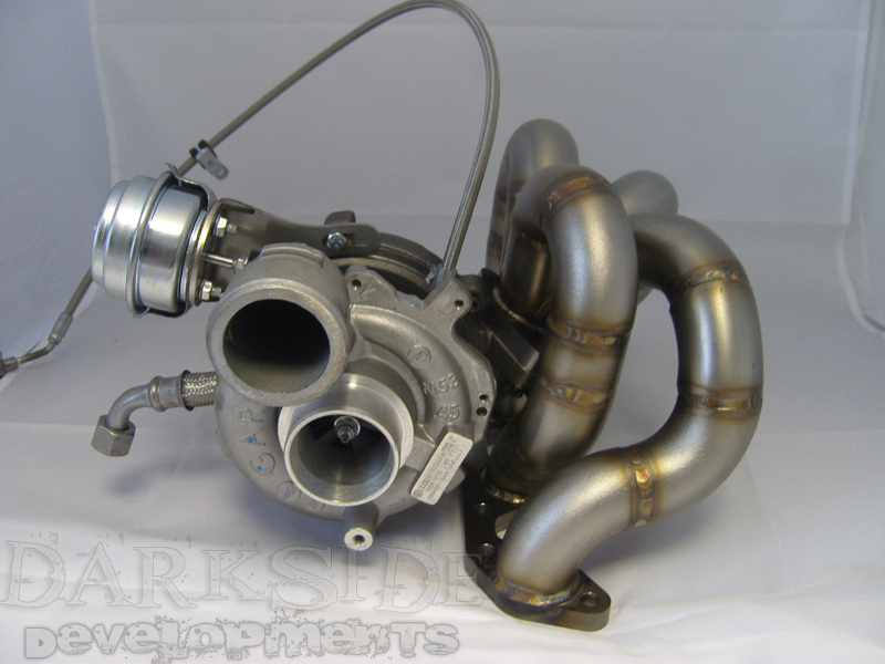

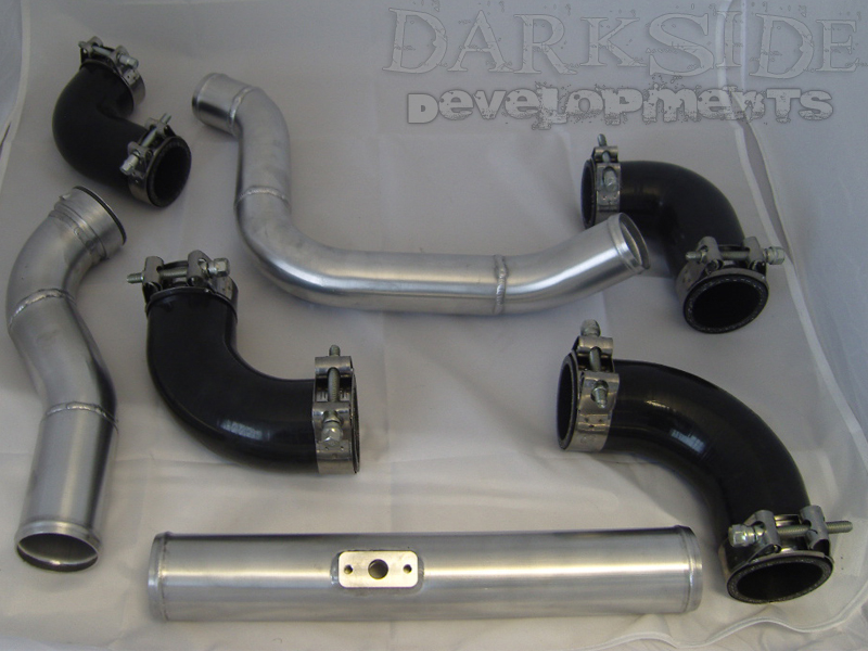

Next was to fit the Darkside Developments 2.0 16v TDI Turbo kit with a GTB2260VK Turbo from a 3.0 v6 Audi:
Along with an S3 Intercooler and hard pipe kit (I didn't get a pic of the cooler before we fitted it, but it is all alloy with welded end tanks and no clip connectors):

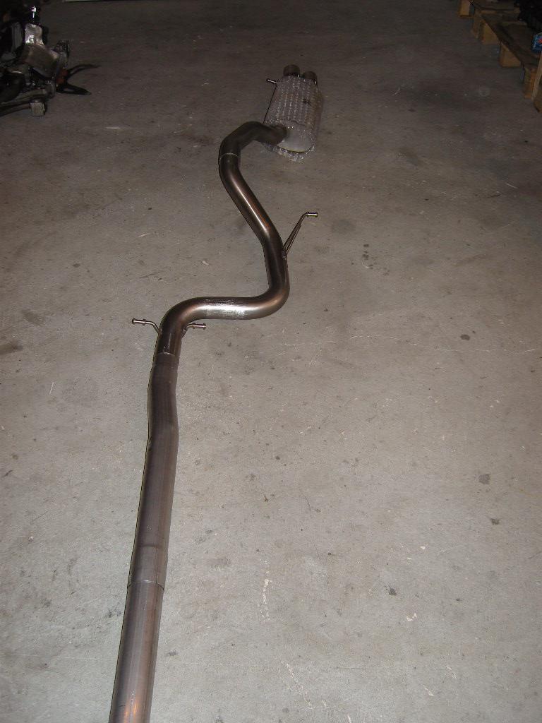

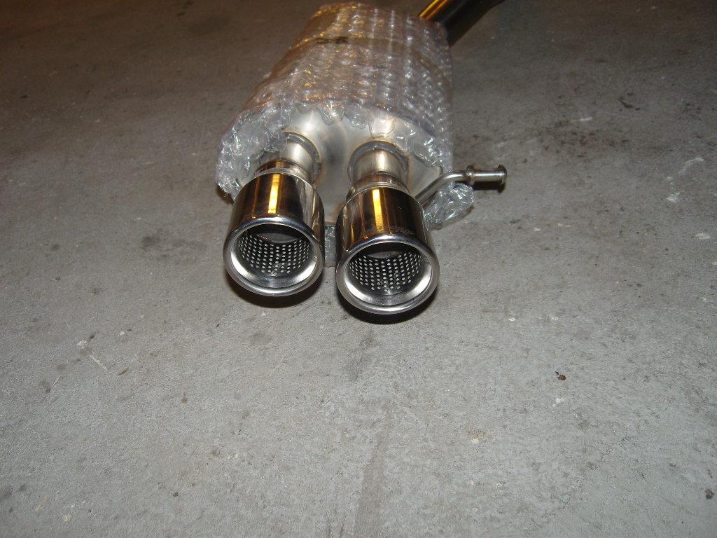

Milltek 3" System (made for a US Jetta GLI):

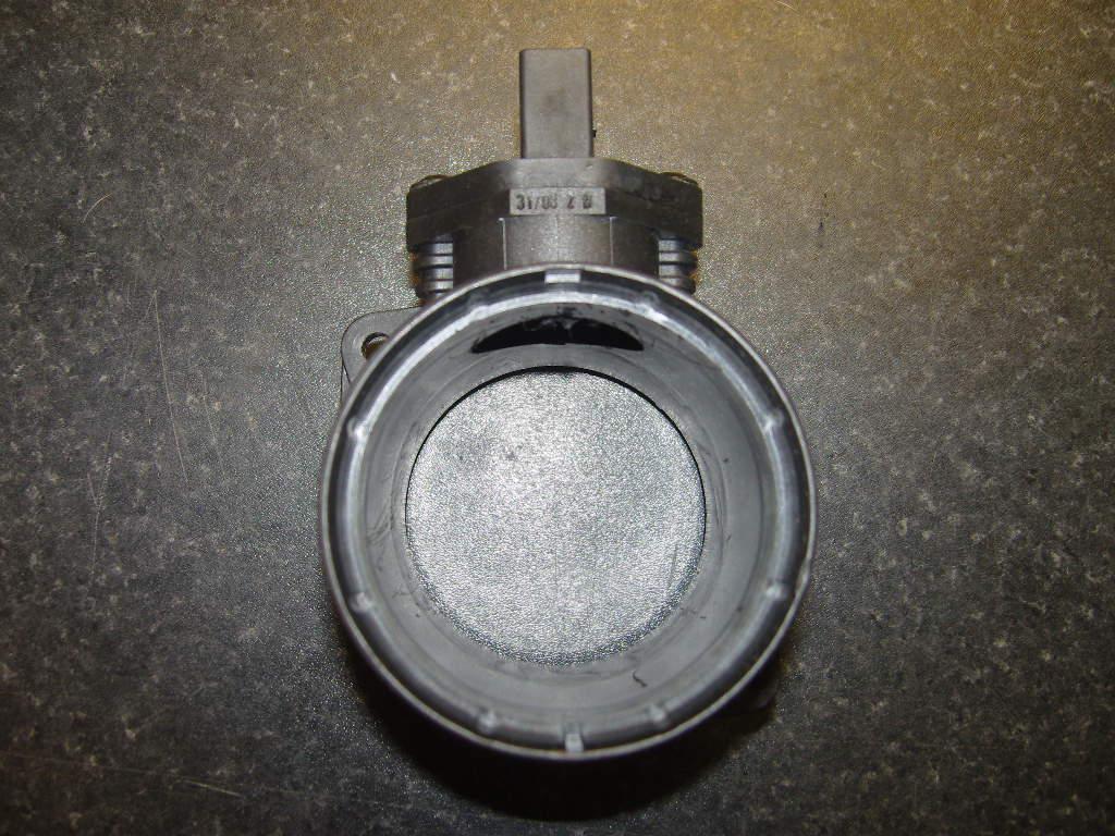

We also modified the MAF, as it was deleted from the map:

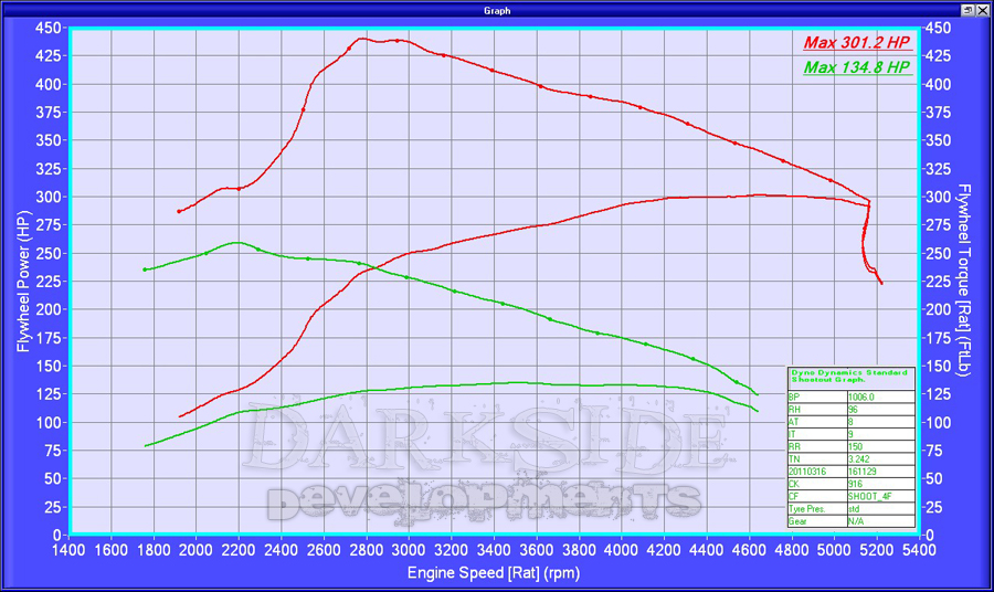

Then we took it to the same dyno so see what we were making
235.3BHP and 330Ft/Lbs. This is on a very conservative dyno (the operator calls it the 'heartbreaker') with ZERO smoke and a very road friendly tune. 3 days after fitting the turbo I drove 1500 miles to, from and around Cornwall and averaged 57mpg for the whole trip. It didn't skip a beat.
We still have some adjustment in the stop screw to get the boost to come in a little earlier, but it still pulls very well from low RPMs. What you lose at the bottom end is nothing compared to what you gain at the top end, it pulls like crazy to the 5000rpm fuel cut we have in the tune and pulls 130mph in 5th easily. I have found the 140mph electronic limit though, which we are working on removing ASAP!

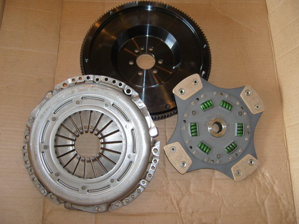

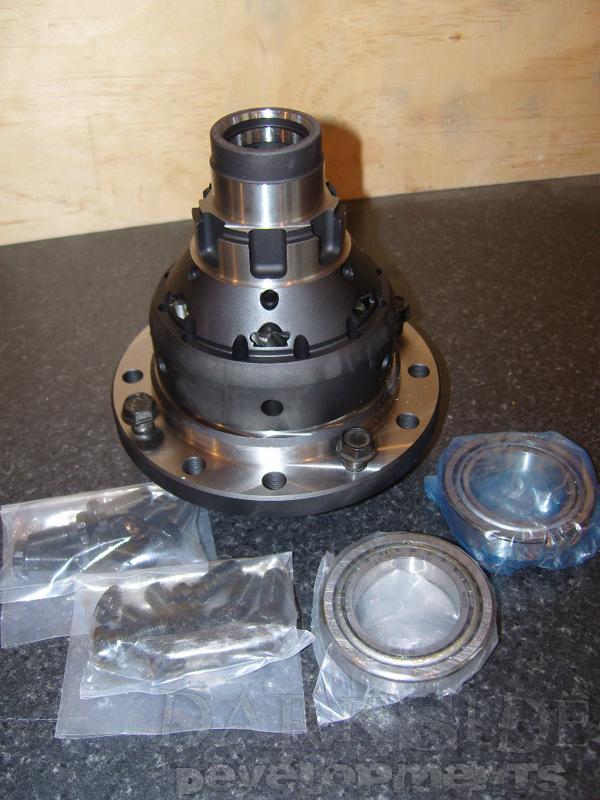

Next on the agenda are a Sachs SRE Single Mass Flywheel and Sintered Paddle Clutch, Peloquin Limited Slip Differential, fitted to a low mileage PD170 Long Ratio Gearbox
Someone on the Edition 38 forum posted up a pic of the Jetta at their show:
We then fitted the Sachs SRE Single Mass Flywheel and Clutch and a PD170 Long Ratio Gearbox with a Peloquin LSD Installed. We also strengthened the shifter forks so we can do some fast changes. Once the clutch was run in, a set of Race PD Injectors was dropped in.

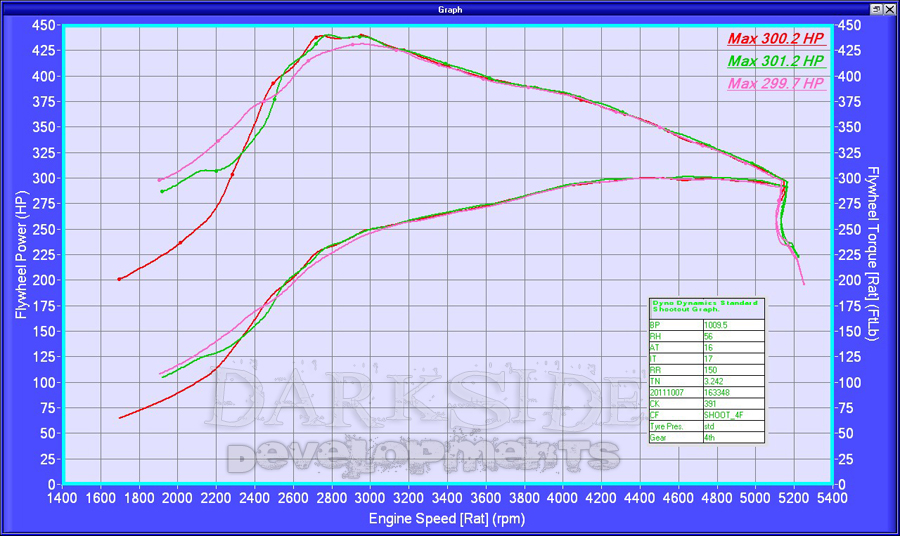

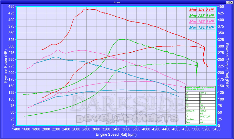

Here are the results from this afternoon:
We did 3 pulls and they were all pretty close together, the best run was 301hp and 440Ft/Lbs.
And here is a graph comparing the stock power to now, we have made pretty good progress!

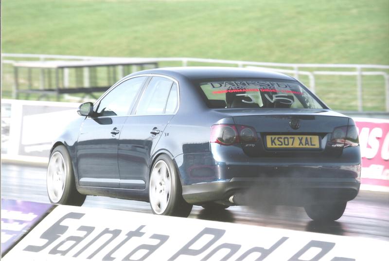

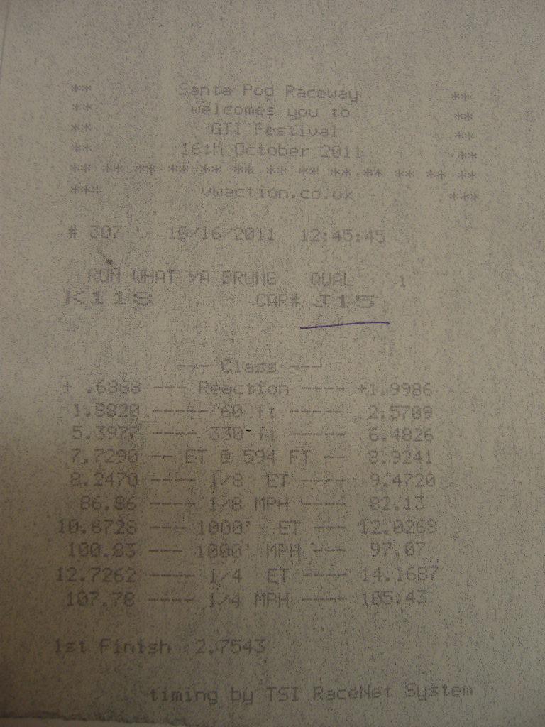

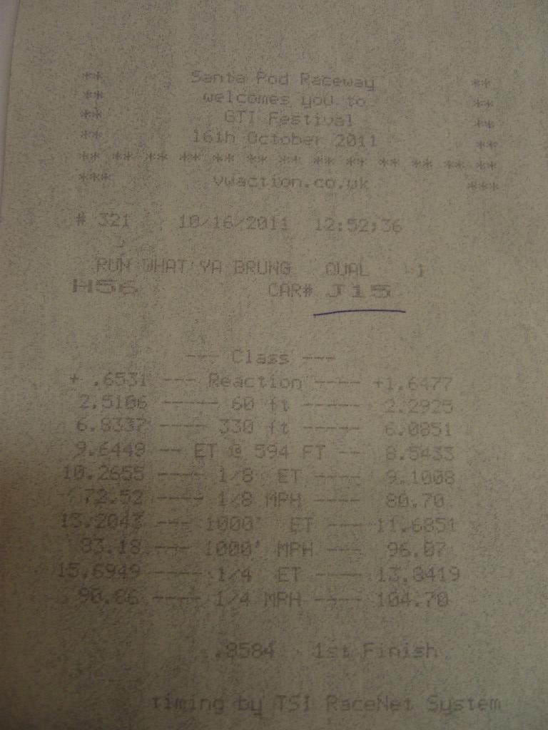

The results from GTI Festival at Santa Pod last year:
We had been down at Santa Pod all day today taking the Jetta up the strip. I managed to put in exactly 20 runs back to back without even a hiccup! All the runs had a terminal speed of over 100mph even when I selected reverse or had the odd missed gear!! As this was my first time out drag racing launching was the main issue so there are still a few tenths to gain and a less corner friendly suspension setting might help too but I’m happy as it’s exactly as it drives on the road!
The best run was a 13.8419 and the best terminal speed was 105.43mph. AFAIK the Fastest FWD TDI of the day.
We missed the fastest TDI trophy by 0.4 sec. That went to a nice guy with a homebrew Mk2 Golf Synchro/Haldex sporting a PD150 Lump, Hybrid Turbo and 150bhp shot of Nitrous!!
Here are two slips:
YouTube of the Jetta:
That was a 14.4 @ 103mph.

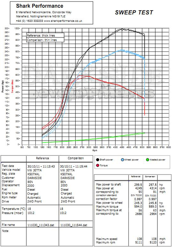

We took the Jetta to Shark Performance in Mansfield yesterday to an Open Dyno Session.
They use a BaPro Dyno so we thought it would be good to compare how the Jetta performed against the DynoDynamics we use on a regular basis.
301.2bhp and 440Ft/Lbs - DynoDynamics @ John Sleath
299.5bhp and 438Ft/Lbs – BaPro @ Shark Performance
Difference is ~0.5% overall so I would say our results are accurate :)
