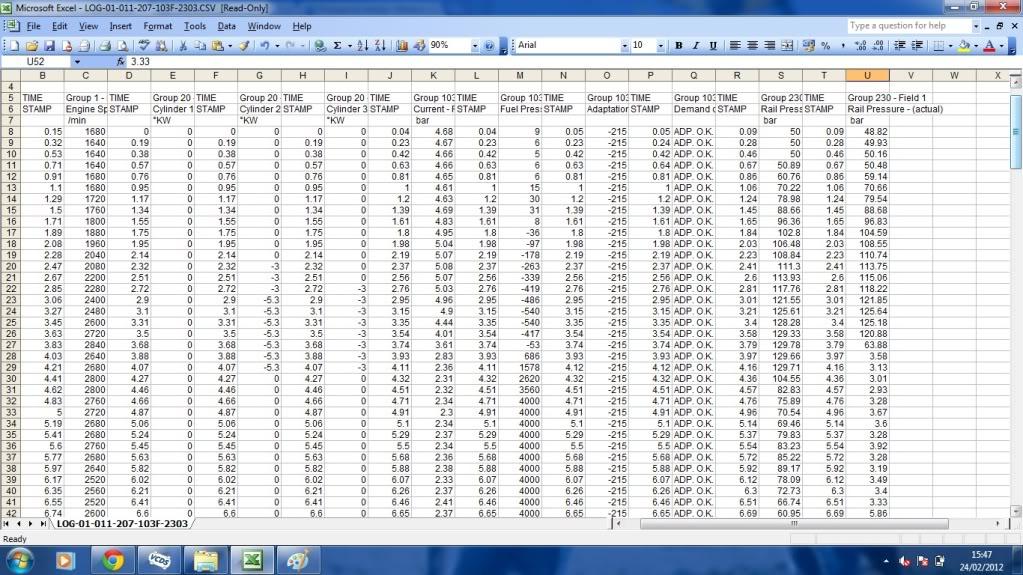

Changed the sensor and still happens. What could i try next ?

No I did notice engine power dying, but only with In tank pump and nothing noticed off the faulty sensor I meant. Maybe blocked fuel filter?

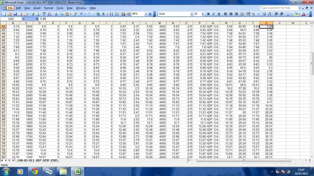

Offline ktlstar
  • Posts: 434
Re: Engine power is getting cut
« Reply #34 on: February 24, 2012, 03:54:00 pm »

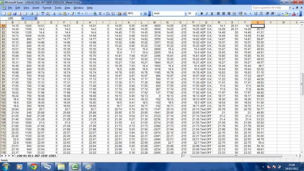

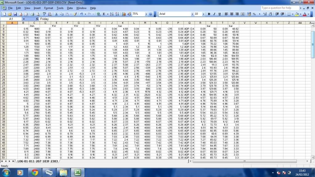

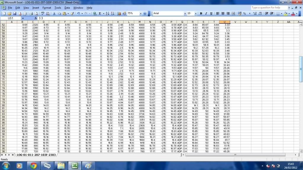

A better picture of it, you can see the fuel drops dramatically when the power holds back.
How are the values on the Low pressure pump ? Not to sure on the values.
I think i may of screwed something when i was cranking the engine over to get it started.
- #1240 ED30 Revo STAGE2+
- Southeast - Vag Com owner

« Reply #35 on: February 24, 2012, 04:15:36 pm »
Looks like the in tank pump? but I'm no expert, my method is replace everything until I get there in the end :signLOL:
The low pressure pump shouldnt really be going below 4 bar.

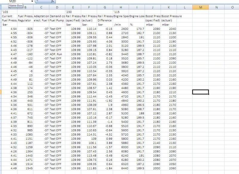

Heres a log after I changed the pump, notice pressire and adaptation values. yours maxes out trying to get the pressure up. you might have damaged some pipework oir something, good luck getting uit sorted

« Reply #37 on: February 24, 2012, 04:49:13 pm »
your low pressure level is around 2 bar when you are getting problems. As you can see in the logs mine doesnt go below 4 bar, even on idle.
Theres got to be some reason for it? wait for an expert to come along is your best bet, maybe VRS alex or PDT can give you some better advice, might be worth gving them a PM.
Pump was less than £200 from what I can remember

Offline ktlstar
  • Posts: 434
« Reply #41 on: February 25, 2012, 04:36:38 pm »

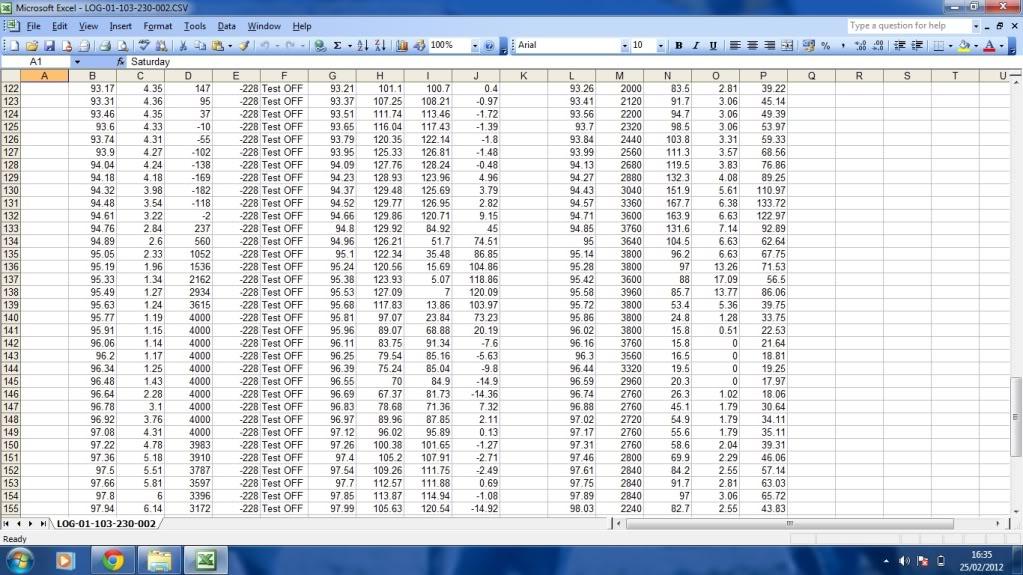

Another 2nd gear pull, pretty much full throttle even though it does it without boost.
2nd coloumn of values is the fuel regulator, 7/8 is high fuel rail actual/specified.

« Reply #42 on: February 25, 2012, 07:02:04 pm »
I still think its the pump. the high pressure pump isnt getting enough fuel, so cant be that.
You can see in the 4th column, when the pressure drops, the fuel pressure regulator value is going to 4000 to try and get the fuel through.
Looks like you might have to spend teh money on a new pump if no one else is going to give you any ideas, unless you have a mate who will let you borrow his pump for 10mins.
Its only a  20 minute job to swap the in tank pump over, hardest part is getting the seats out

I do think when i was cranking the engine over caused the failure.
So does 4000 mean its working 100% ?
These log are sent back to PDT @ Dave. Touch wood he can pinpoint the problem/
« Reply #44 on: February 25, 2012, 07:19:21 pm »
The value shouldn't get to 4000, like it is until it goes iffy. I didn't buy a regulator for mine.
