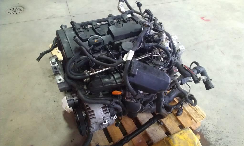

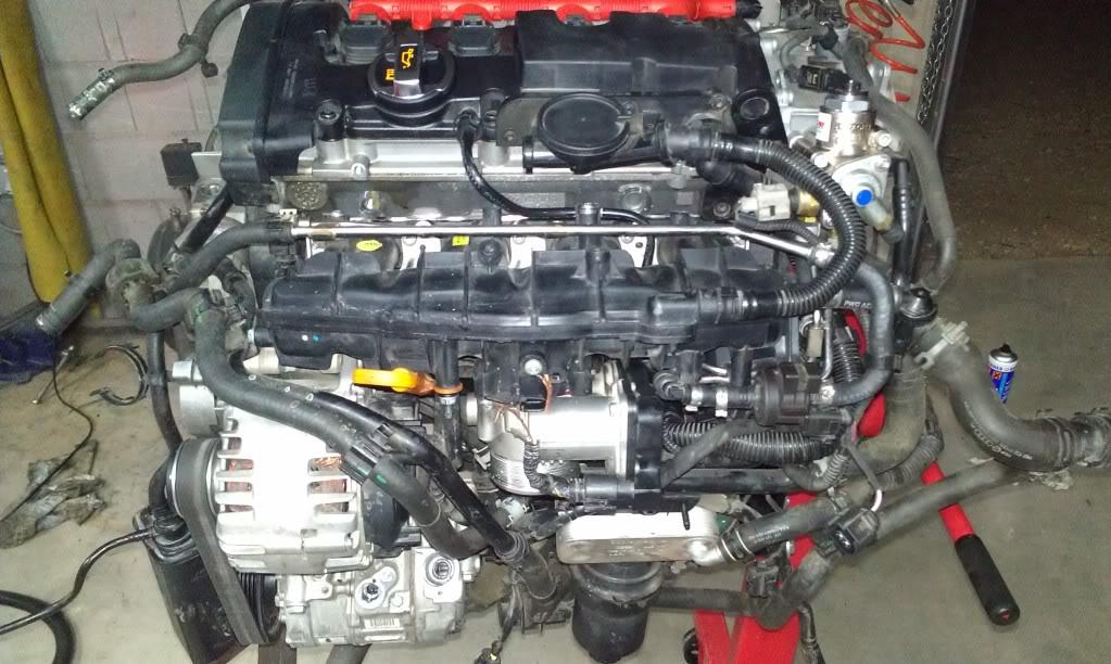

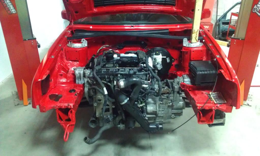

I own a Golf Rallye and I'm  starting a engine swap. I have my eyes on an 2.5 tfsi engine from an  Audi TT RS witch I haven't found yet but I will.

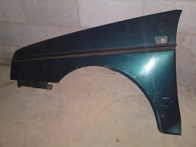

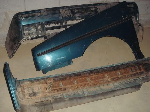

This are the parts that I already bought. Because my Rallye had a bit of rust on the front wing I had to find a new one
and I bought spare front and back fender

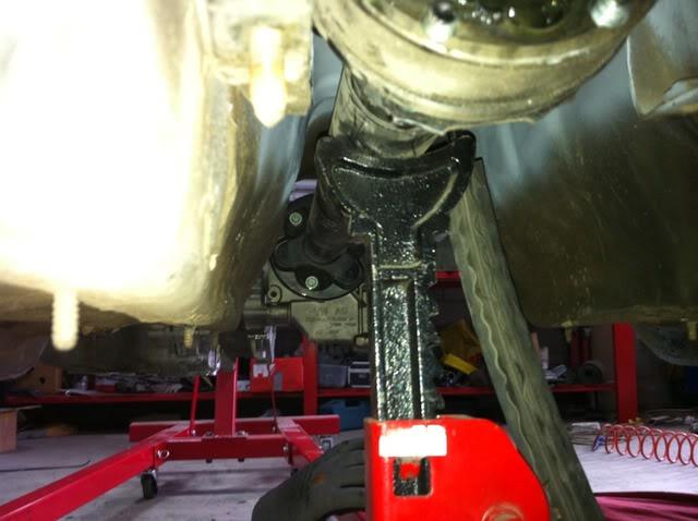

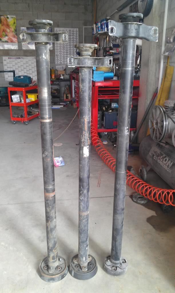

Prop shafts:
one from Audi TT and another from a Golf 5 R32

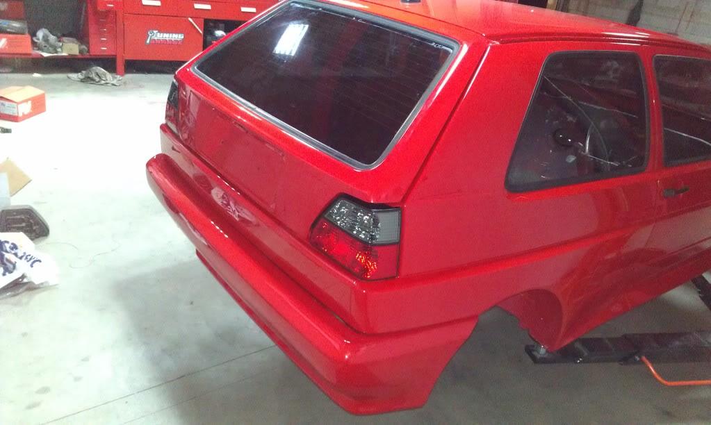

tail lights:

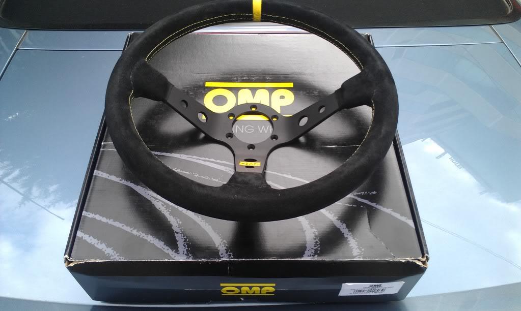

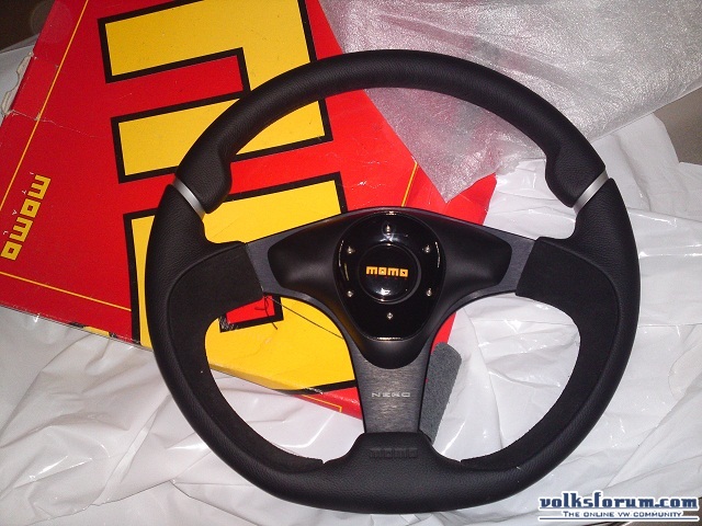

and the steering wheel

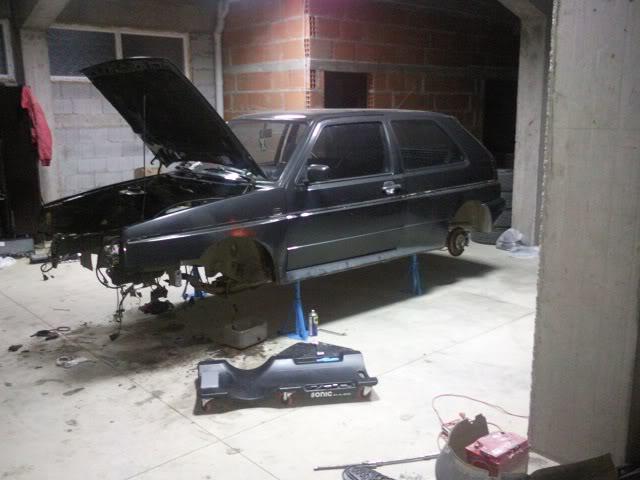

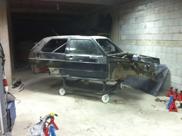

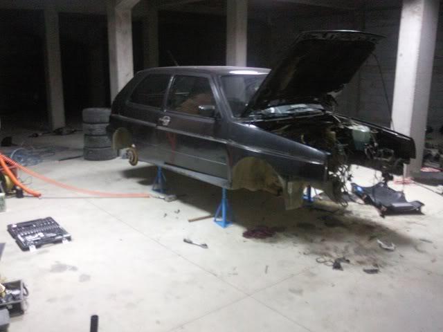

Going on with the dis assembly
I am removing the paint because I'm looking for rust and I was thinking to be repainting the body in tornado red or maybe...

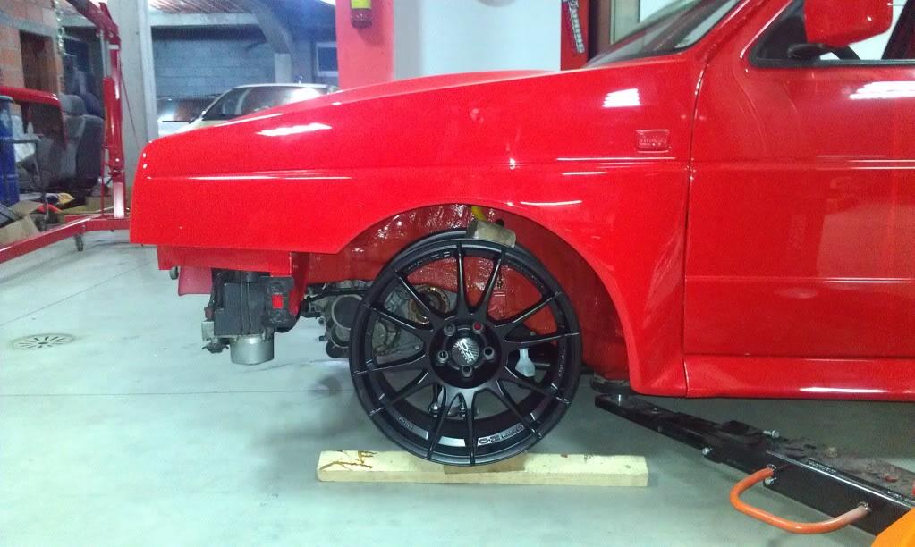

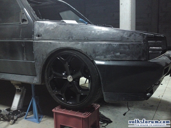

I bought these wheels
But I figured that those wheels are too big so I bought the OZ ultralegera 17x8 5x100
I thought these are the wheels for my project
What do you think?

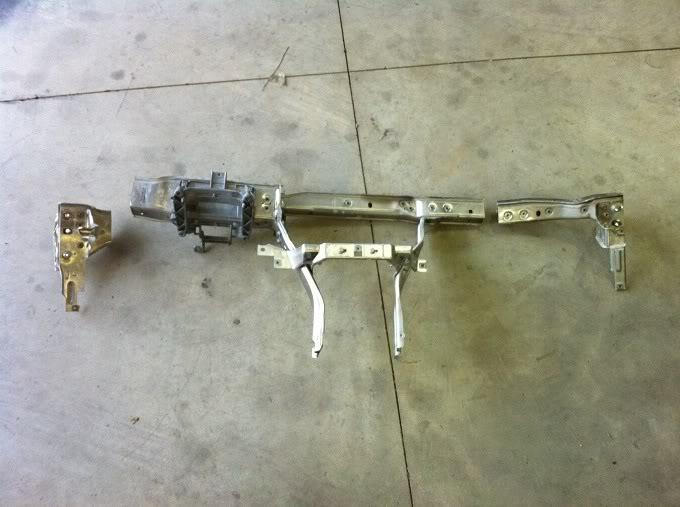

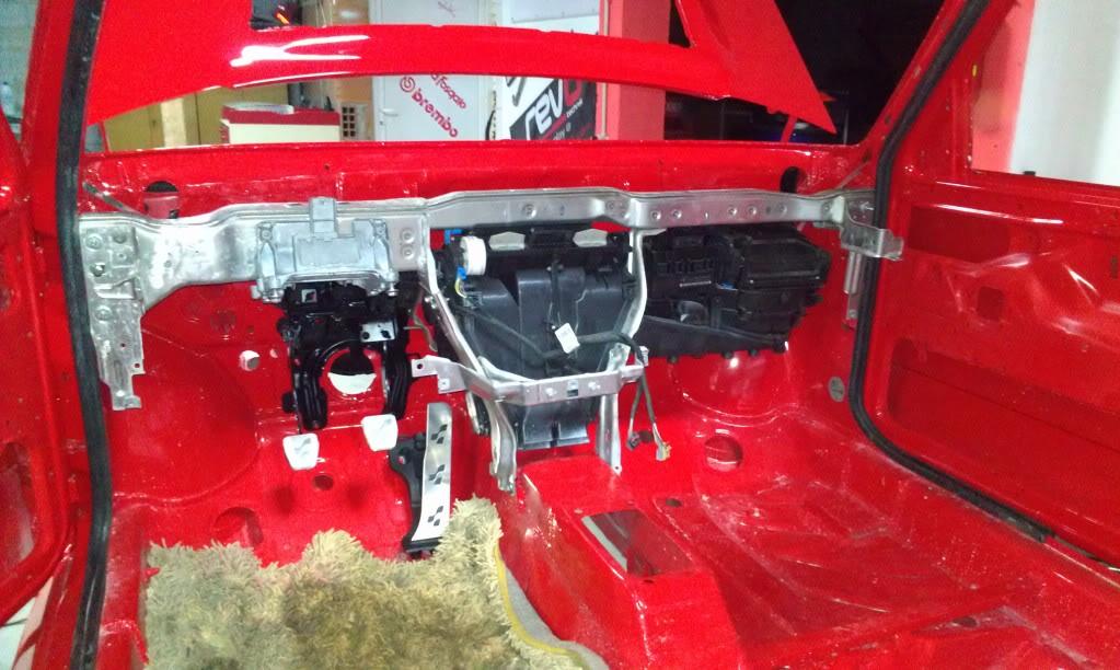

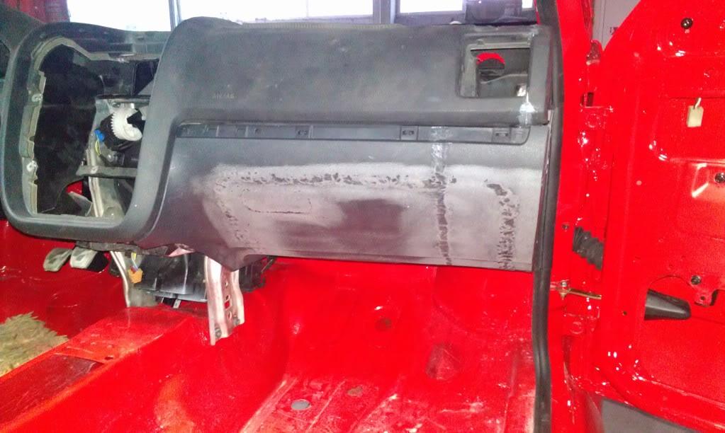

And started fitting the MK5 dash

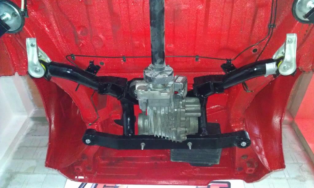

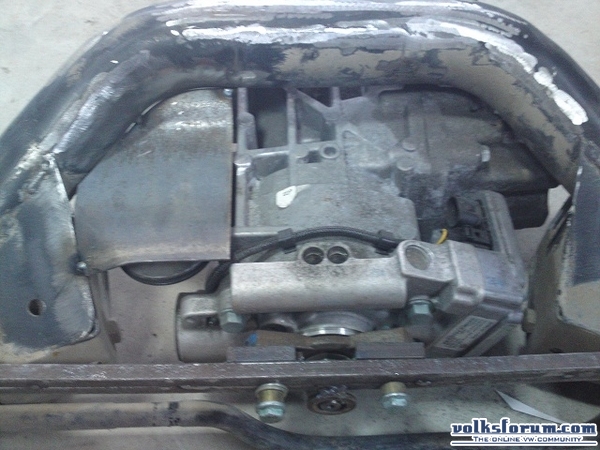

and modifying the rear axle to except the Haldex 2nd generation
first taking measures
then cutting and starting the fitting
the first holder
and bought a pair of front and rear Brembo brakes from a Touareg
here is to see how much space is the gen.2 haldex is going to take
and the work that has been done around the fitting of the dash

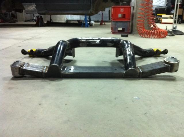

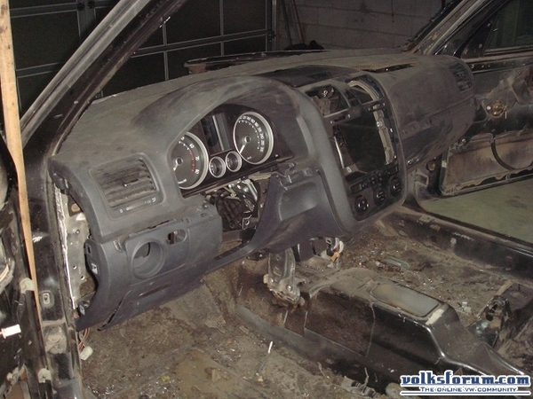

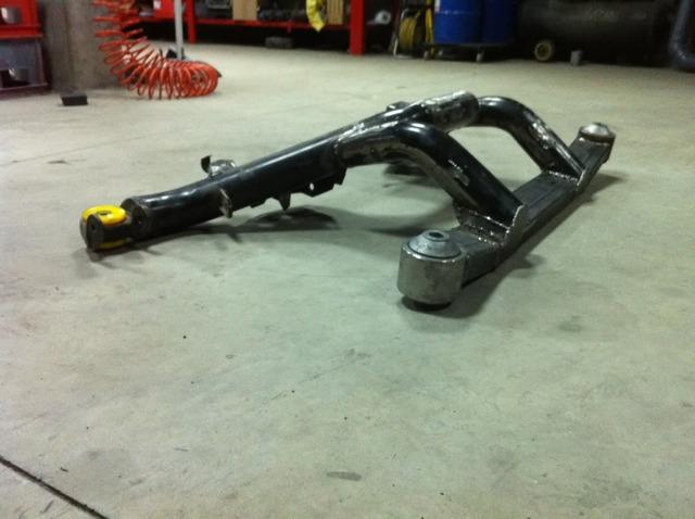

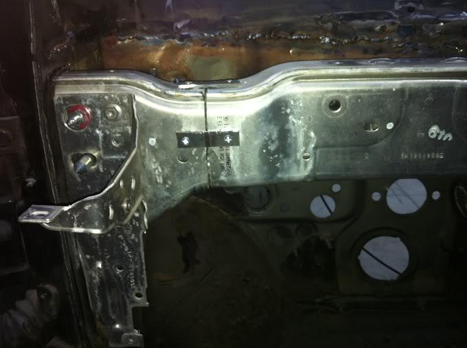

first of all I bought a new subframe
and the original Golf 5 holders that the sub frame is tighten to and cut them to fit
then more cutting

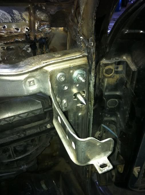

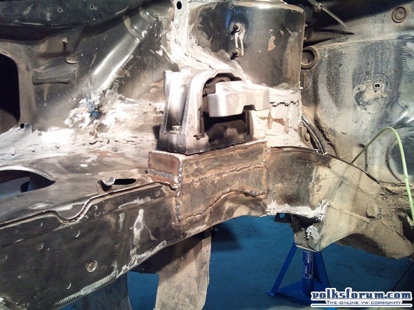

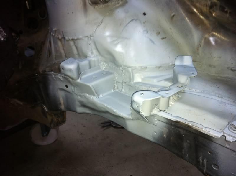

and then started making some pieces to weld on the chassis that would except the holders for the sub frame
after I welded the holders I cut the rest of the sub frame to fit between the pieces
took the sub frame to be welded and here are the results:
and...

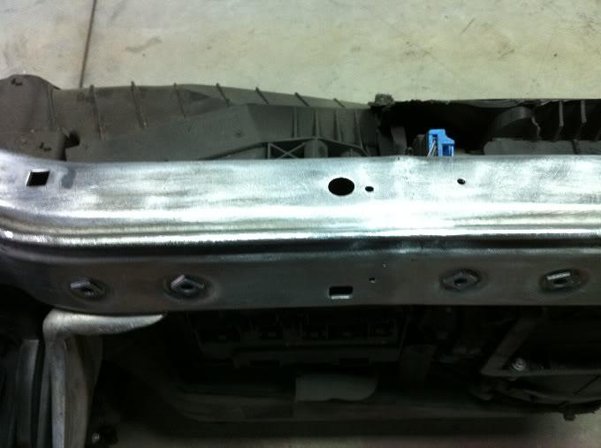

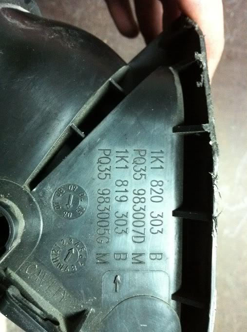

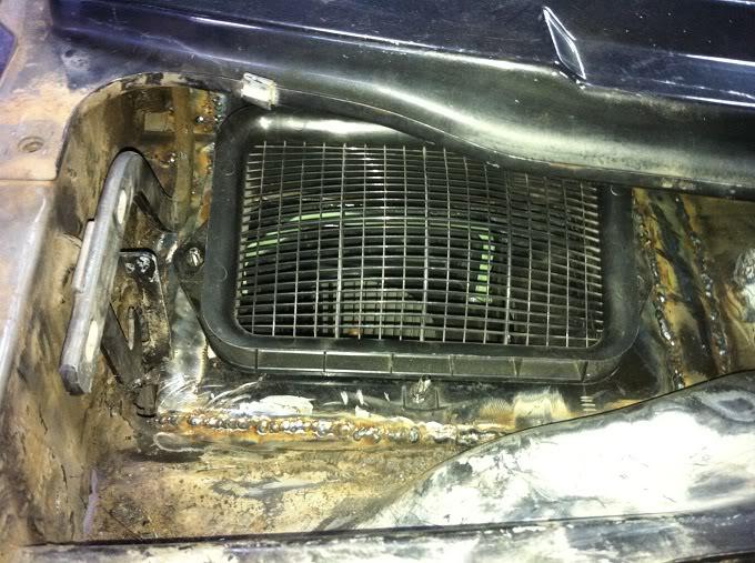

after the sub frame was fitted next was the intake for the air conditioning
first I took a part of the air conditioning to be a little modified
and then everything could be welded

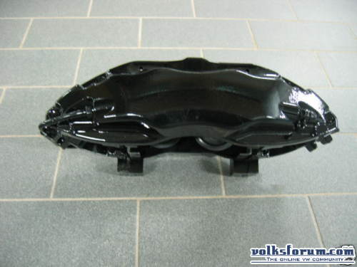

Then bought these Brembo 4 pot calipers because I've mounted the other ones that I had on the Audi S2 project that I've been working on so the Rallye gets them brand NEW.

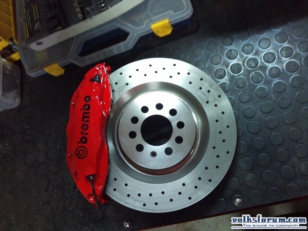

finished painting the Brembo's and this is how they look now.

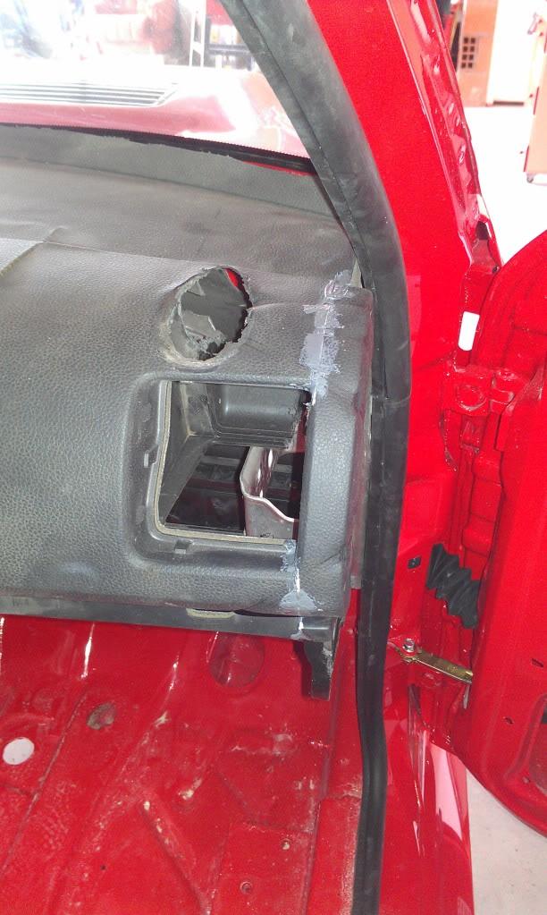

opened the hole for the MK5 Heating

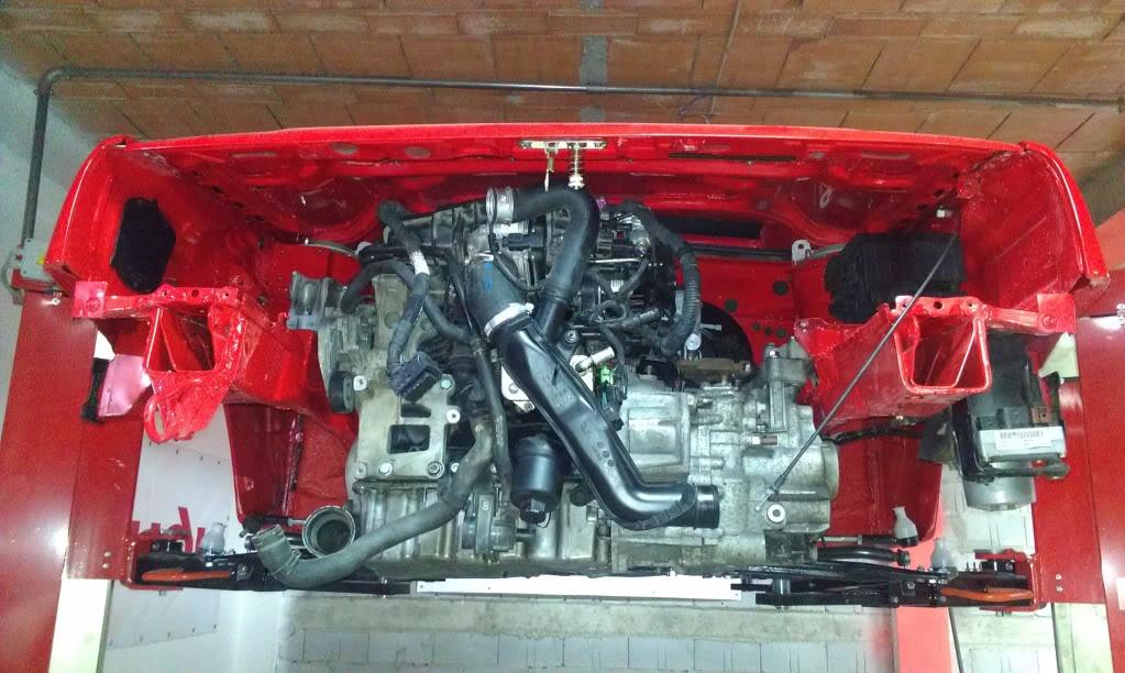

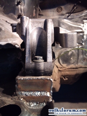

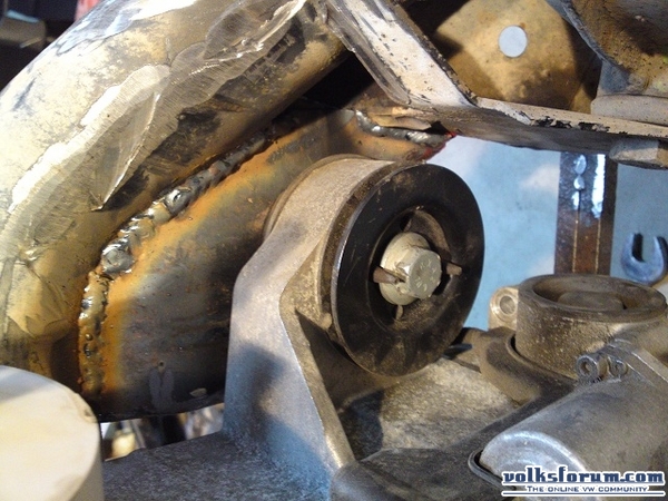

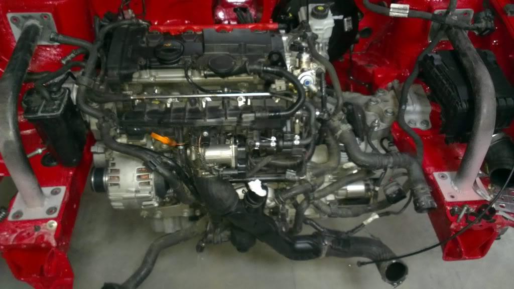

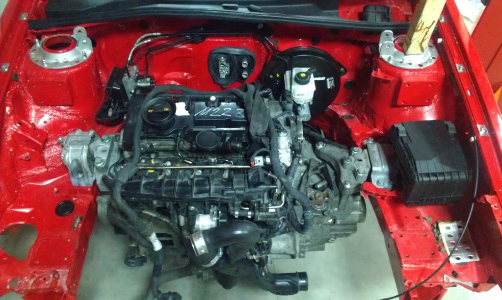

and done the engine mount

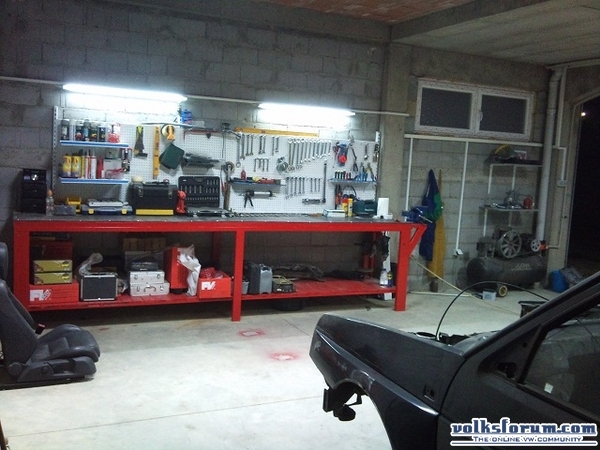

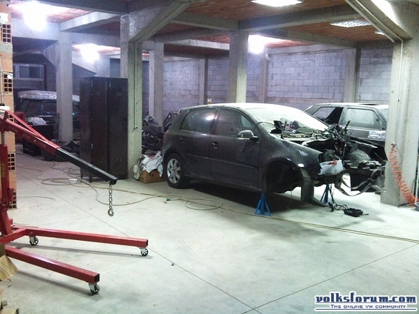

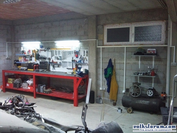

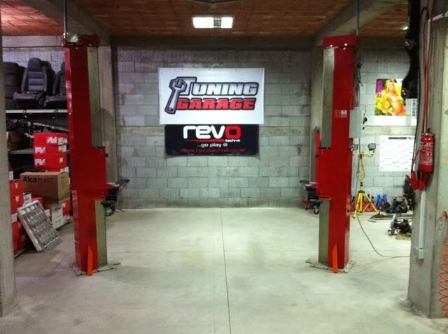

and  something very important to me is that finaly I finished my garage.  When I started mu project I got some comments saying "that's a creepy  garage"
Well lets see how you like it now

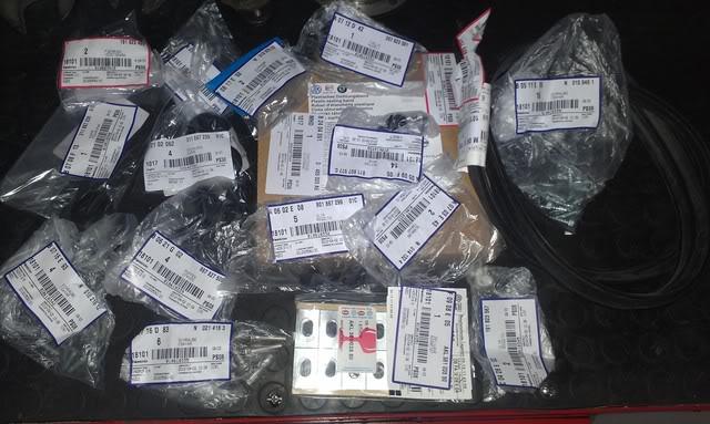

Then some parts (of the many that I ordered) arrived so here they are:

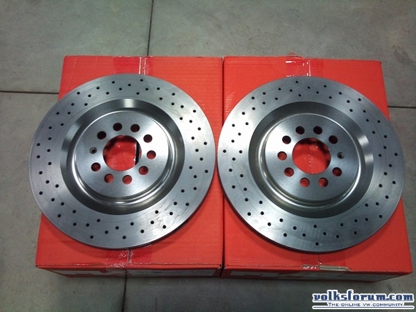

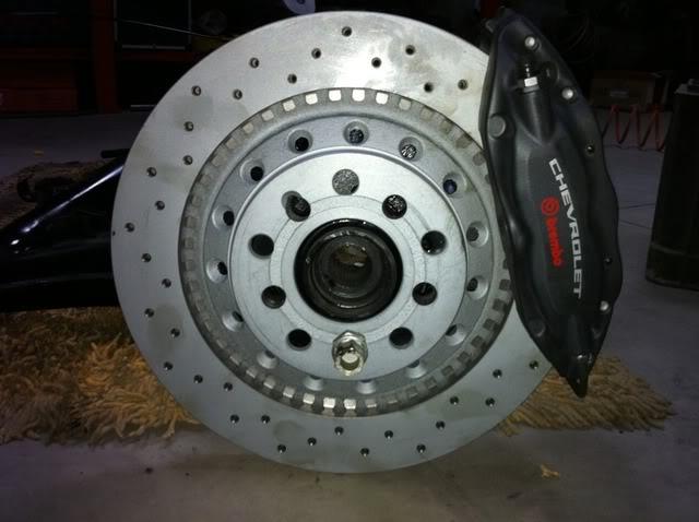

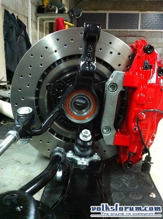

The front disc 323x28 punched from Seat leon Cupra
and here they are with the BREMBO's

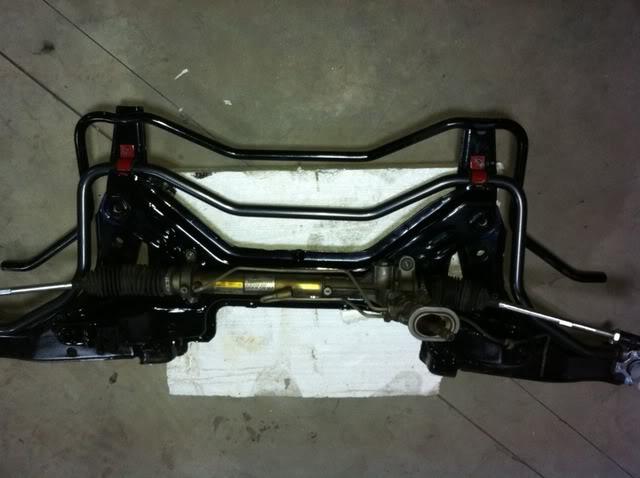

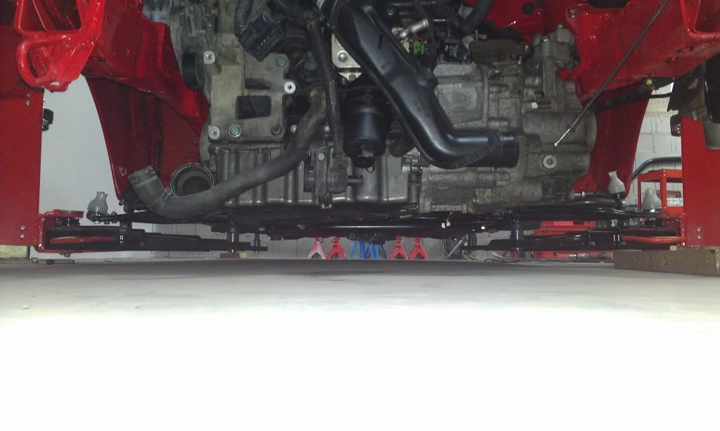

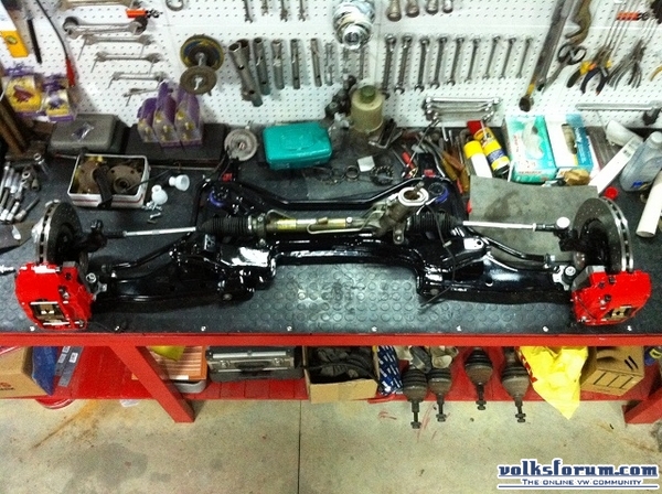

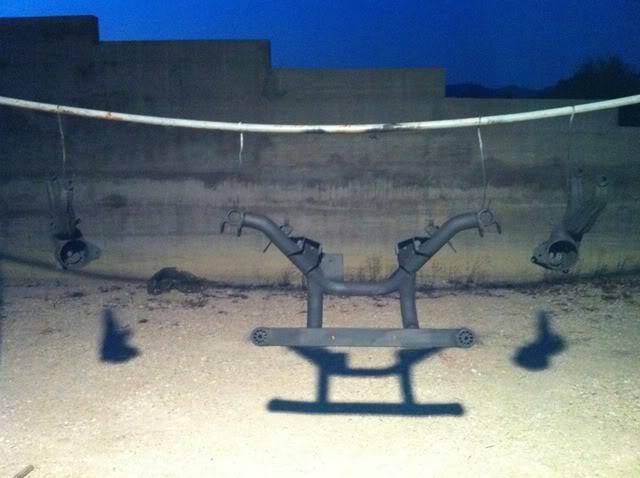

The front axle was sandblasted covered with primer, painted and finally assembled

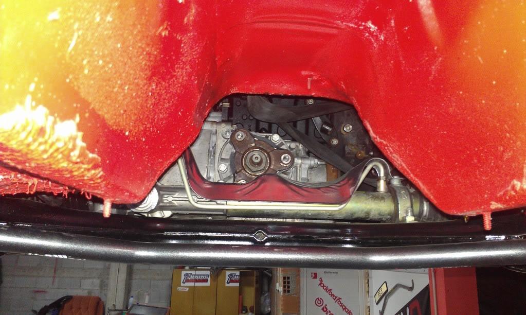

bought a steering rack from VW Polo 9N and the servo motor

and after I had all the parts in one place everything started to come together as it should

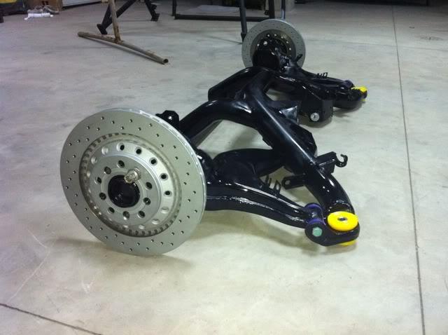

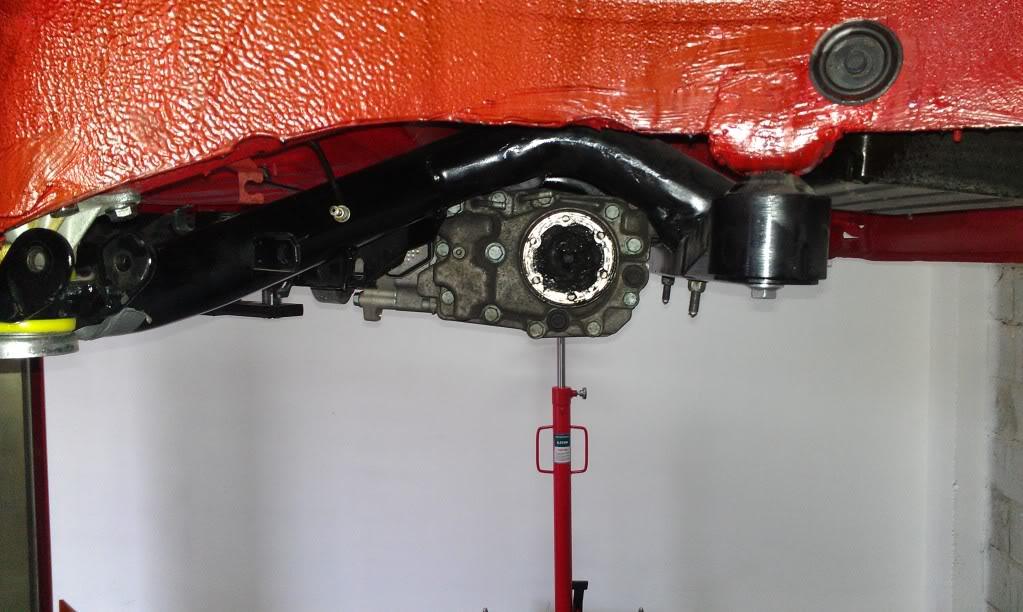

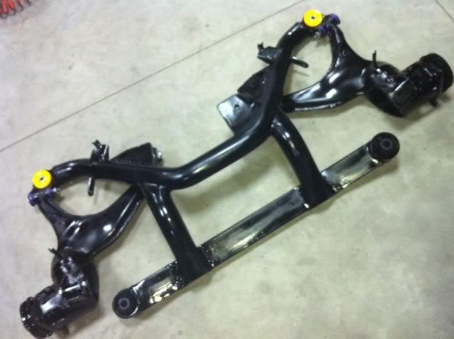

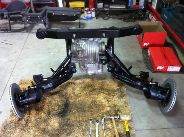

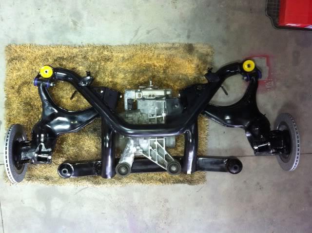

I'm just about to finish up the rear axle
This is how the rear axle looks:

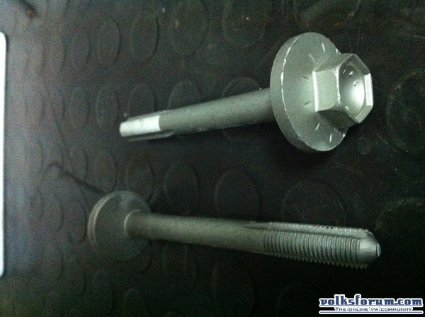

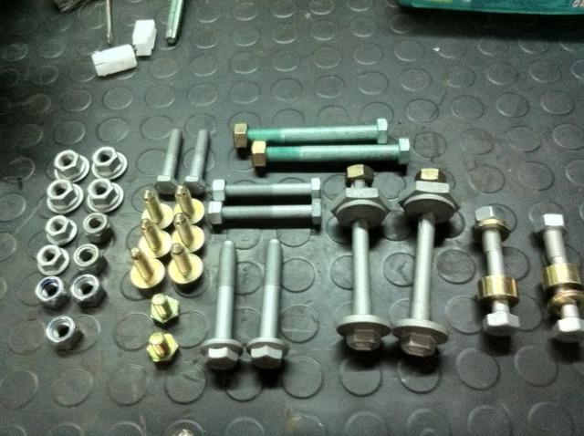

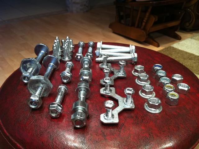

one of the things I need to finish are these for Camber/toe adjustments
I bought these from my local VW dealer they are from Audi RS6 rear axle, you can find them on the ETKA as part number:WHT001682   that is if anybody needs them. All i need to do now is to make  camber/toe plates. If you want these all done you can find them on this  site:
http://www.dutchbuild.com/index.php?page=shop.product_details&flypage=flypage.tpl&product_id=87&category_id=15&option=com_virtuemart&Itemid=104&lang=en&vmcchk=1&Itemid=104

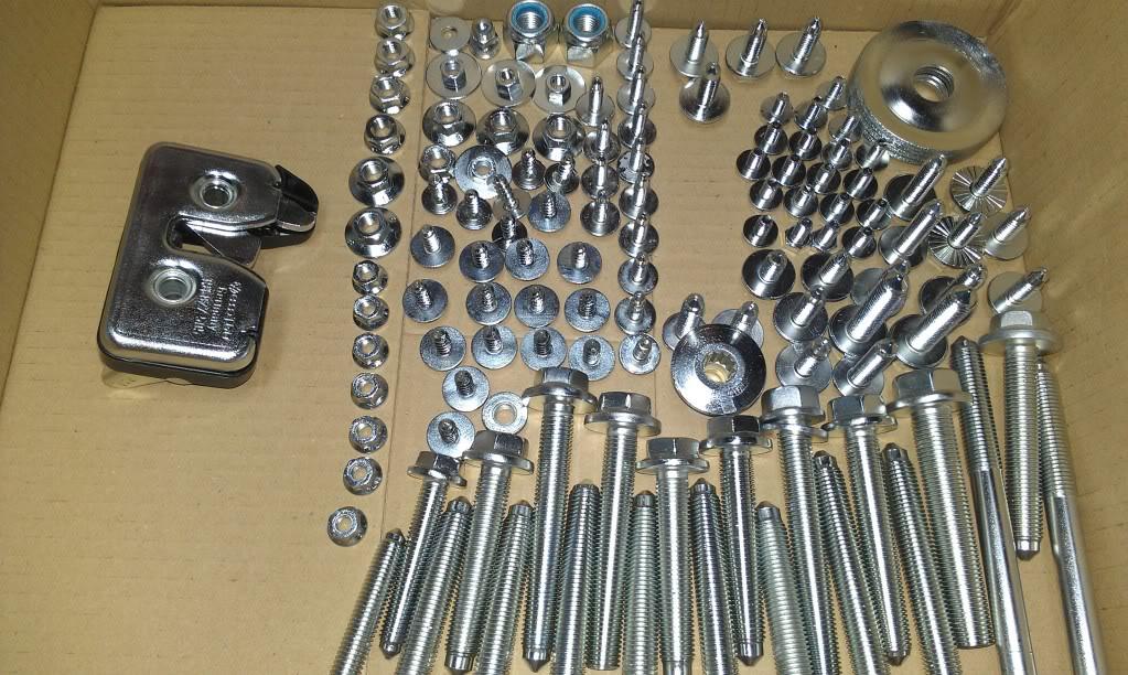

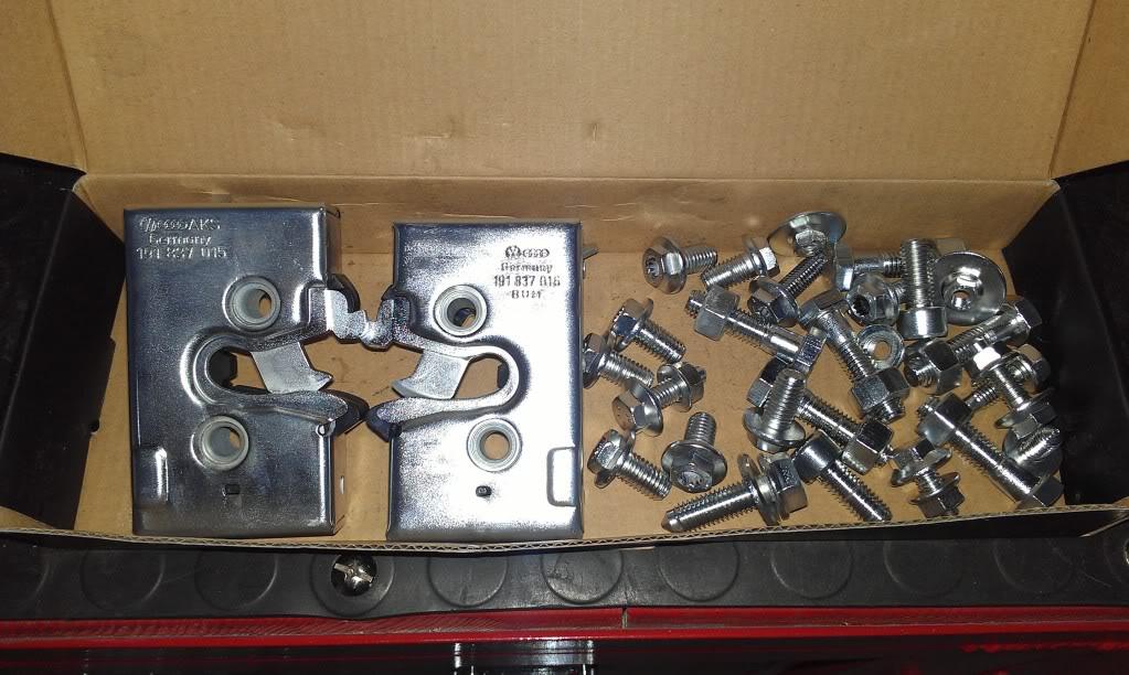

gathered all the screws and nuts including the ones needed for the chamber adjustment and took them to be chromed.
and how they turned out
not perfect but OK
OK finally came the last parts that I needed to finish the rear axle.

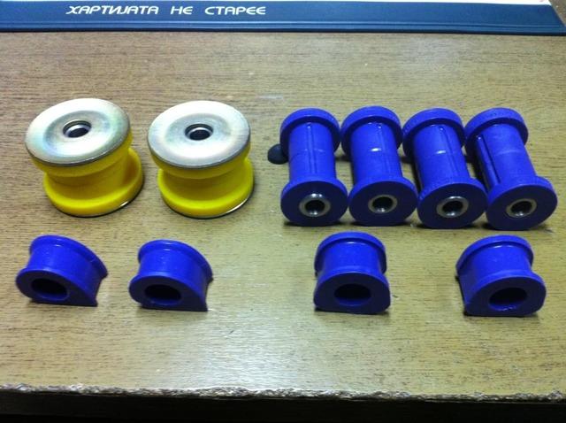

Powerflex

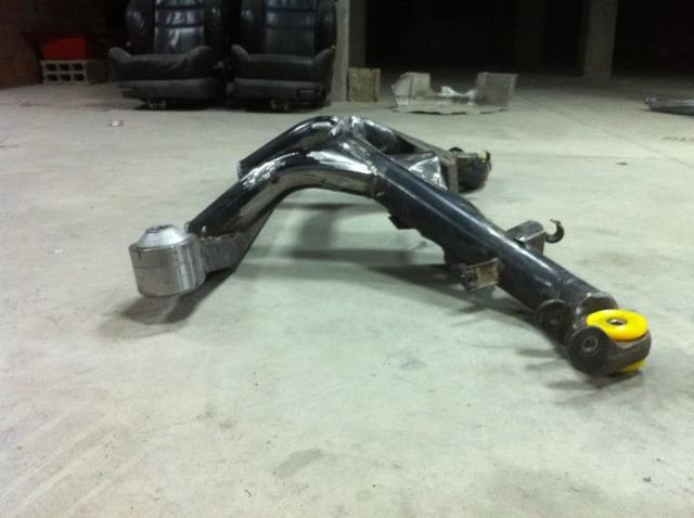

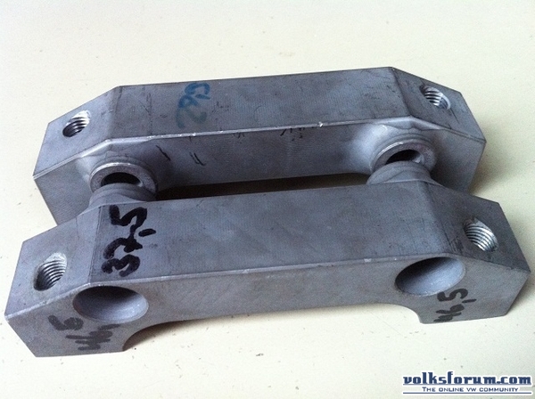

And  these are the rings and the bonded aluminum bush that I need to finish  the mounting points on the axle. There are going to be 4 mounting points  something similar to the factory rear axle from golf Mk5 4 motion
and  the piece between the rings is an adapter that I need to combine the  Golf Mk5 brake master cylinder and the 94 Passat VR6 brake and clutch  pedals. And when these piece is welded it should look like this:
I also took the rear axle holder to be chromed

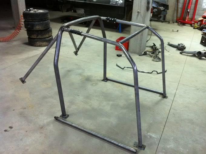

the Roll Cage from OMP arrived :

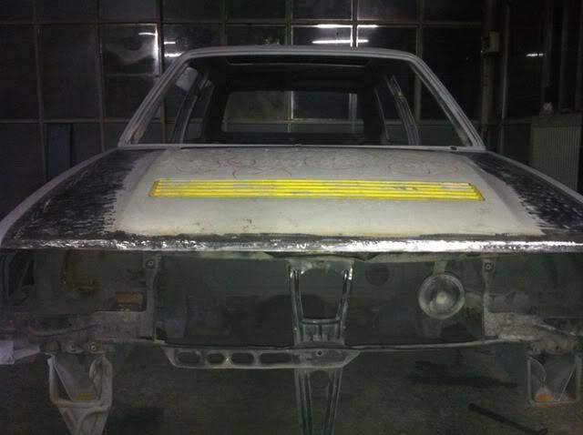

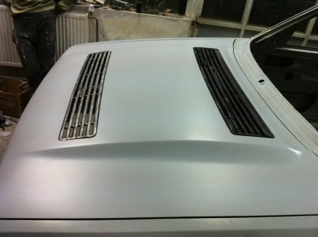

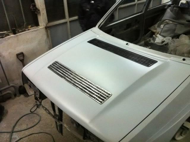

I finally found a Lancia delta Integrale hood
Here are some pictures
I was looking foe these hood for a ling time and finally found one :peace:

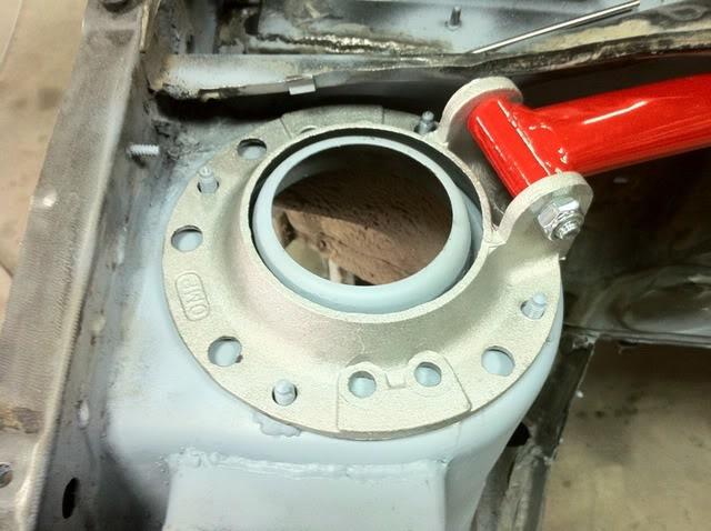

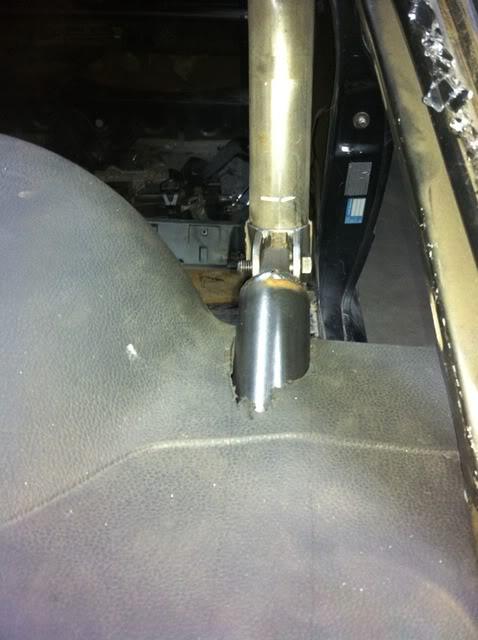

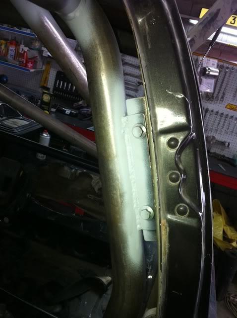

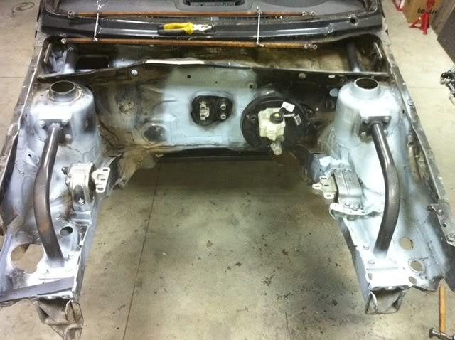

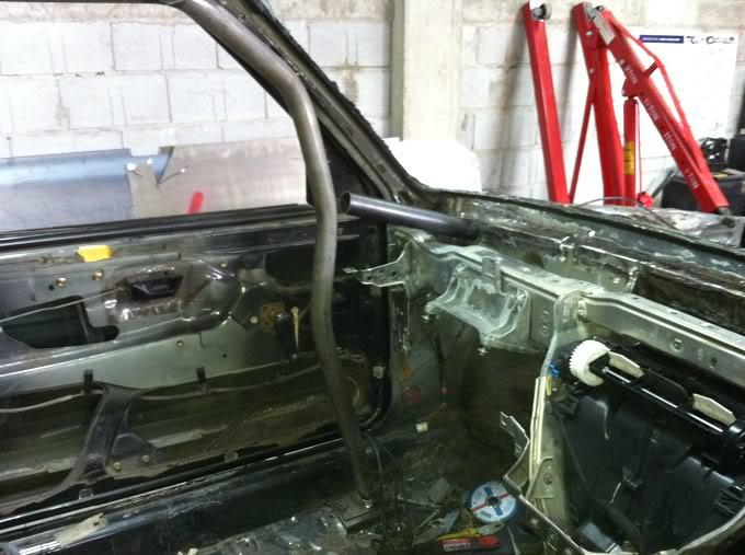

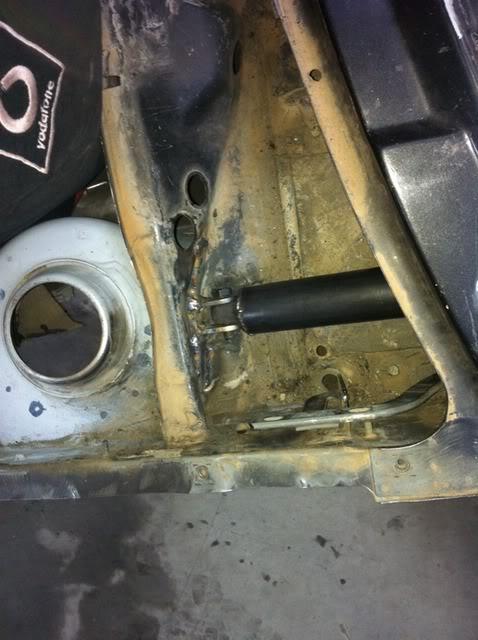

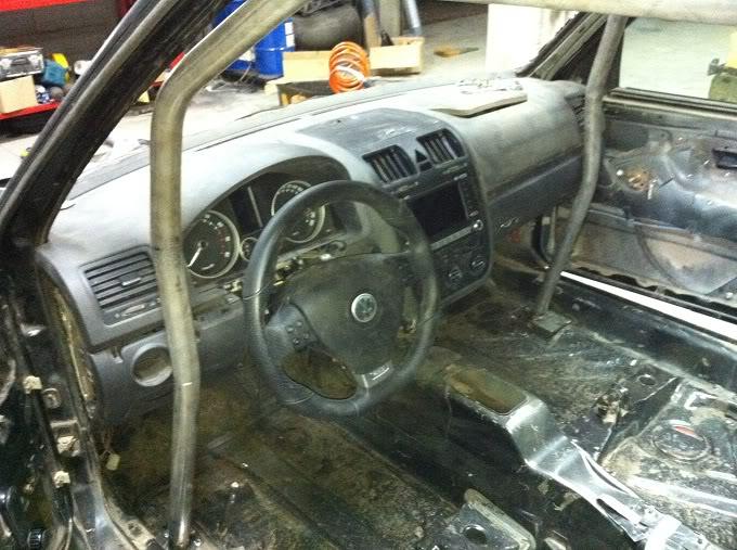

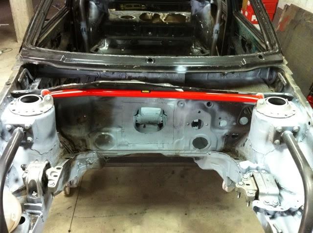

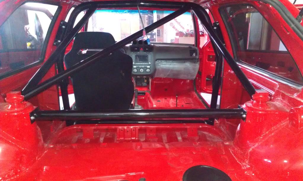

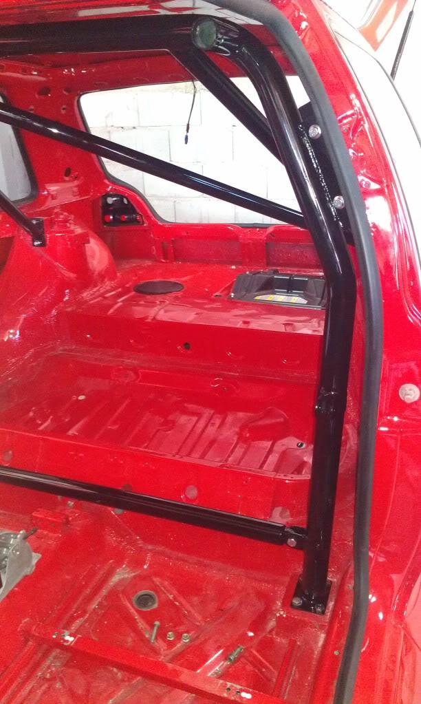

finished installing the roll cage . The roll cage needed some modifications to accept the Golf 5 dash but finally it's done Here are some pictures:

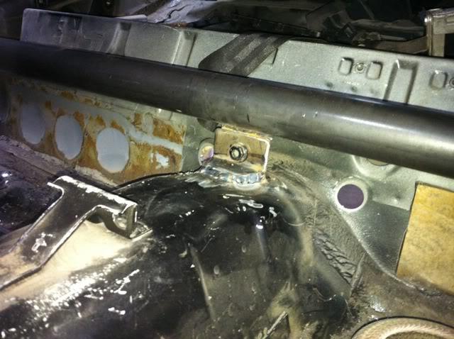

And here is the support to the suspension housing from the roll cage that I planed on doing :confused:
What do you think?

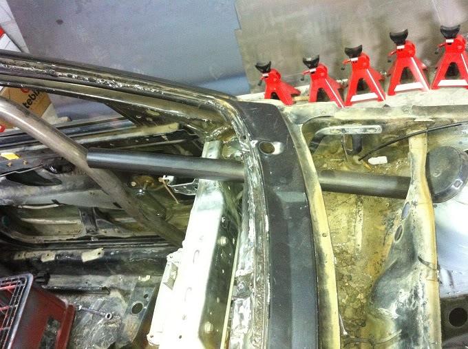

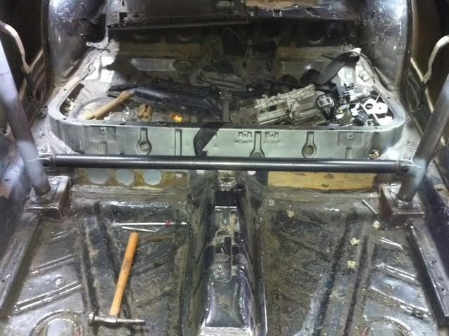

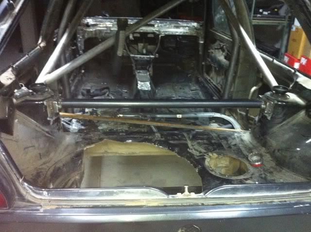

finished the rear reinforcement
also finished the front reinforcement from the suspension housing to the roll cage

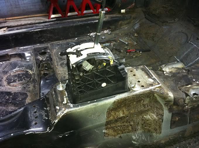

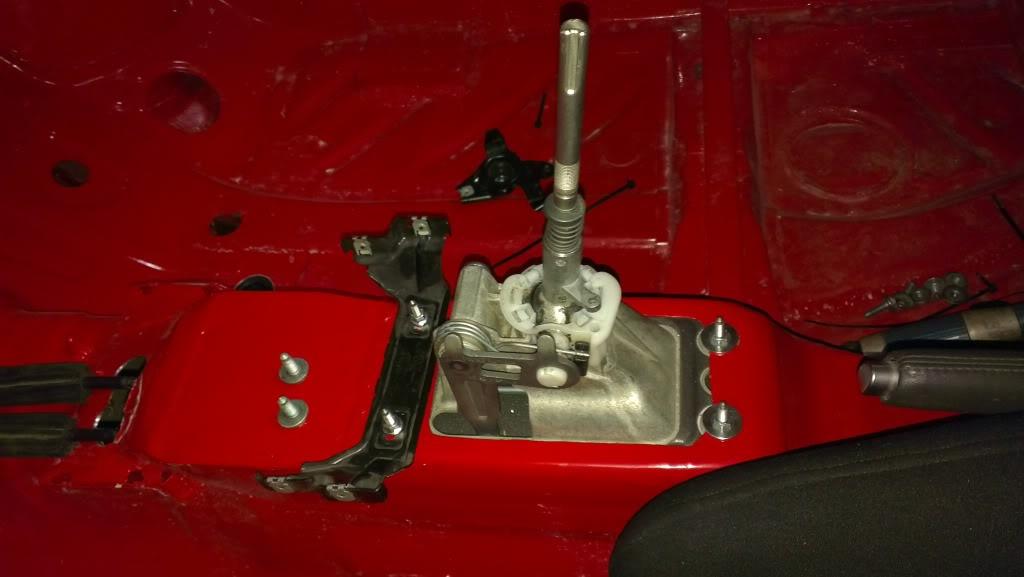

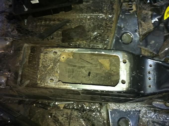

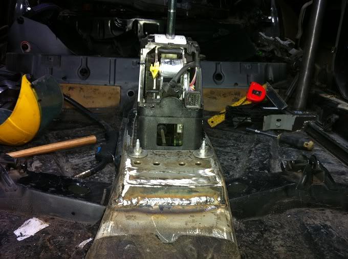

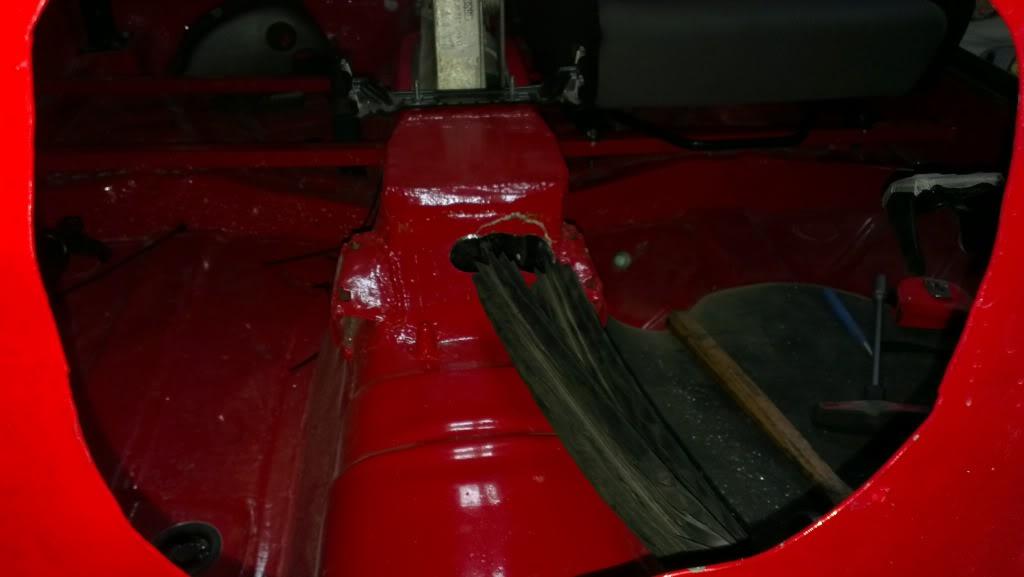

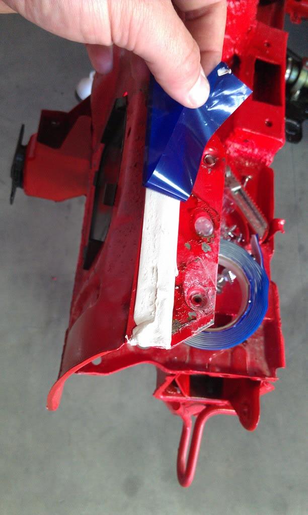

Today I finished modifying the tunnel to receive the Golf MK5 selector mechanism .
Started by cutting a bigger hole for the selector mechanism and drilling holes to get it fixed:
the small holes were made to remove the MK2 selector mechanism mounts
did some modifications on the tunnel to fit the MK5 selector mechanism
and here is how it came out:

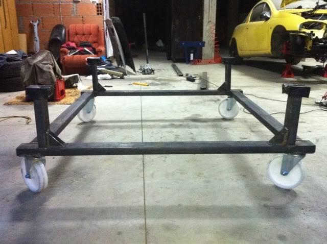

in the mean time I mange to find time to build this :

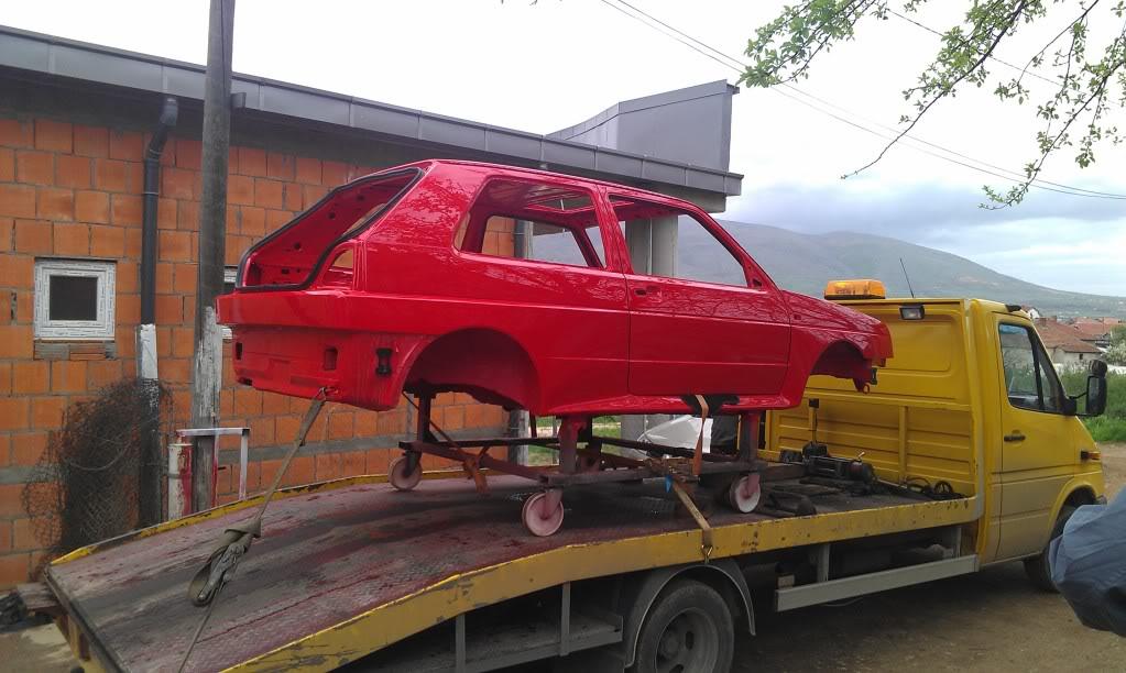

so I can move the shell in mu garage :laugh:

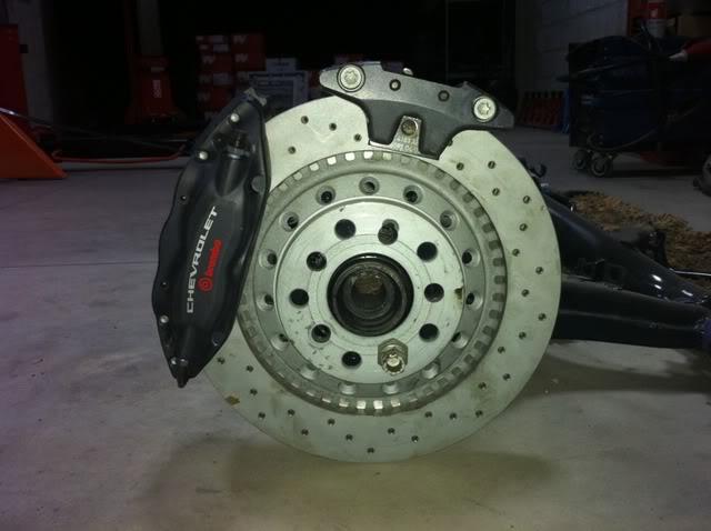

Rear 4 piston calipers from Shevrolet Camaro SS 2010+ for the rear axle
brake disc for the rear :

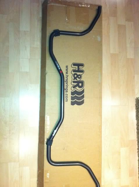

also bought H&R FRONT SWAY BAR VW GOLF 3 VR6 25MM

Finally finished the roll cage

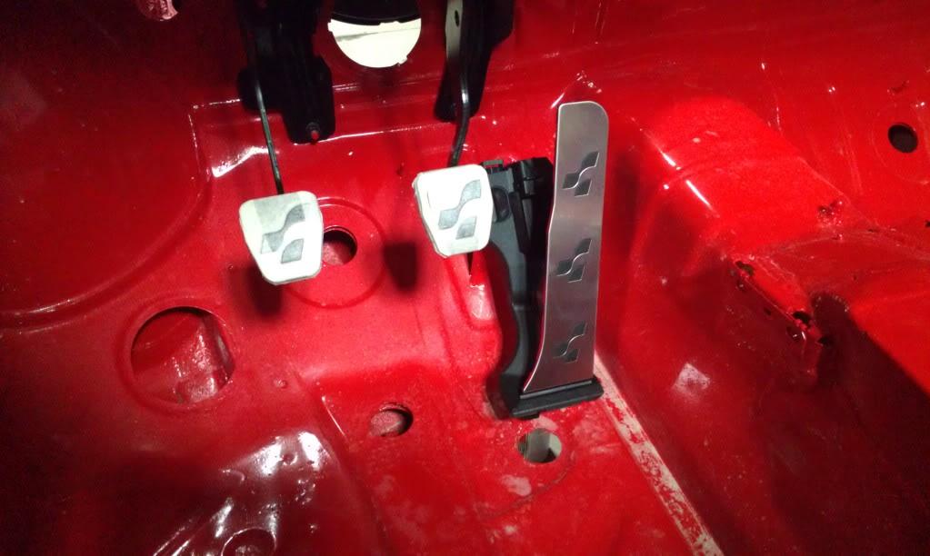

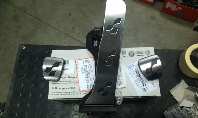

also sorted out the pedals

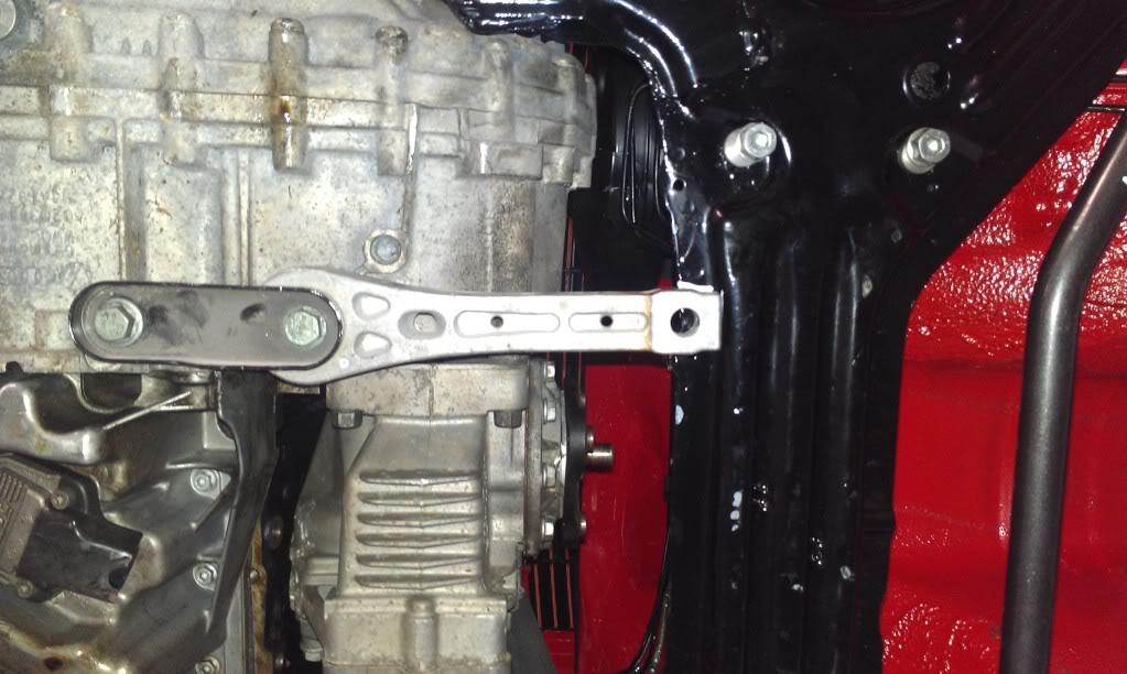

and the most important thing for me, the gearbox mount
still some minor things to be done and then... off to the paint shop

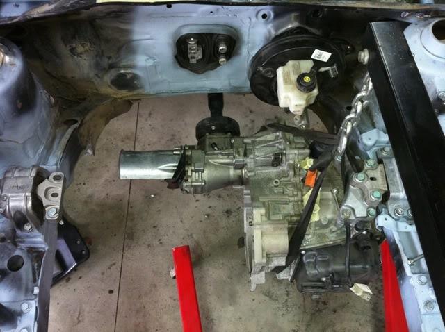

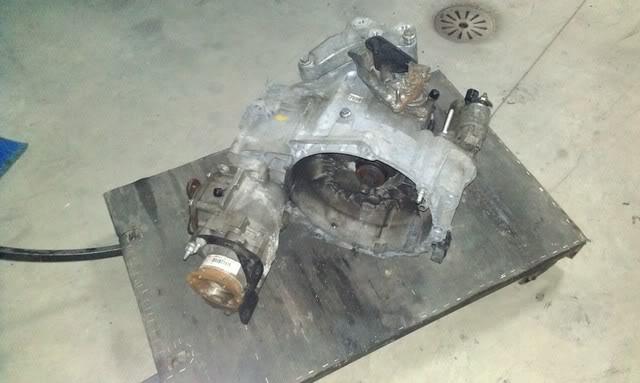

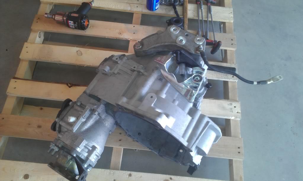

Then I remembered that I have something that could help me... a 4 motion DSG gearbox
from the looks of it everything should be OK but will see.

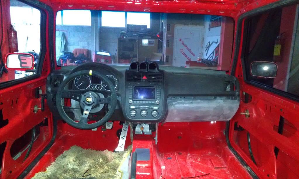

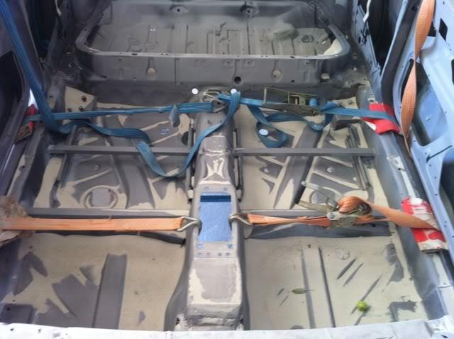

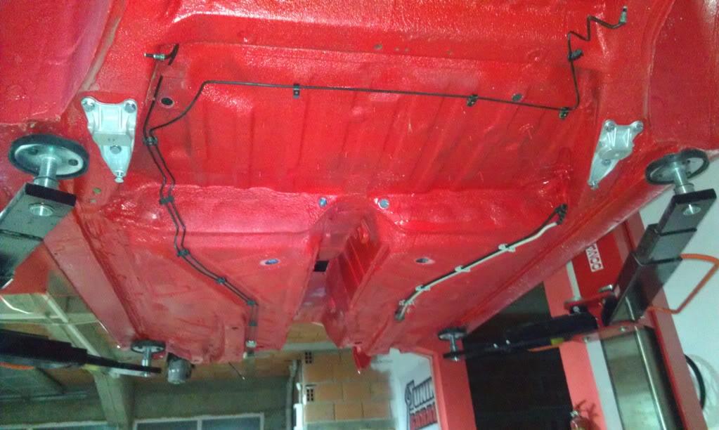

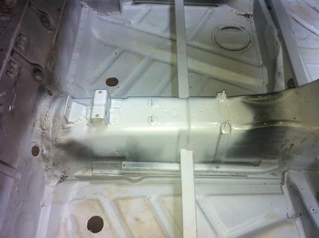

the interior has been cleaned of the isolation and primed
the gas pedal has been installed

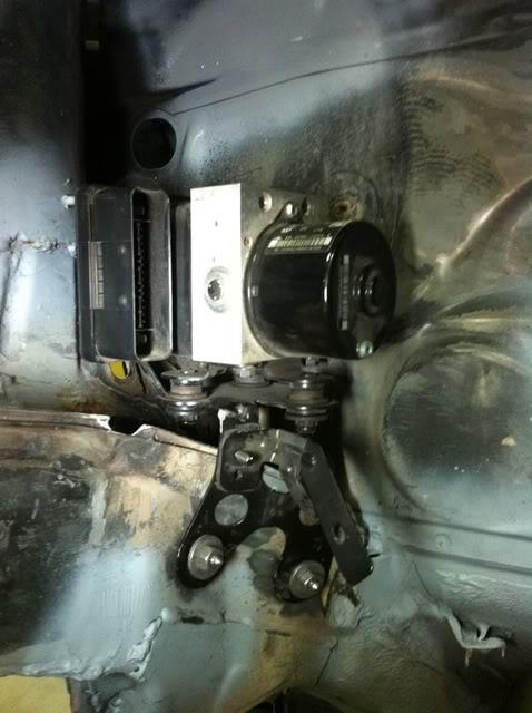

the ABS pump was also installed
installed the handbrake
and the upper reinforcement fixing screws

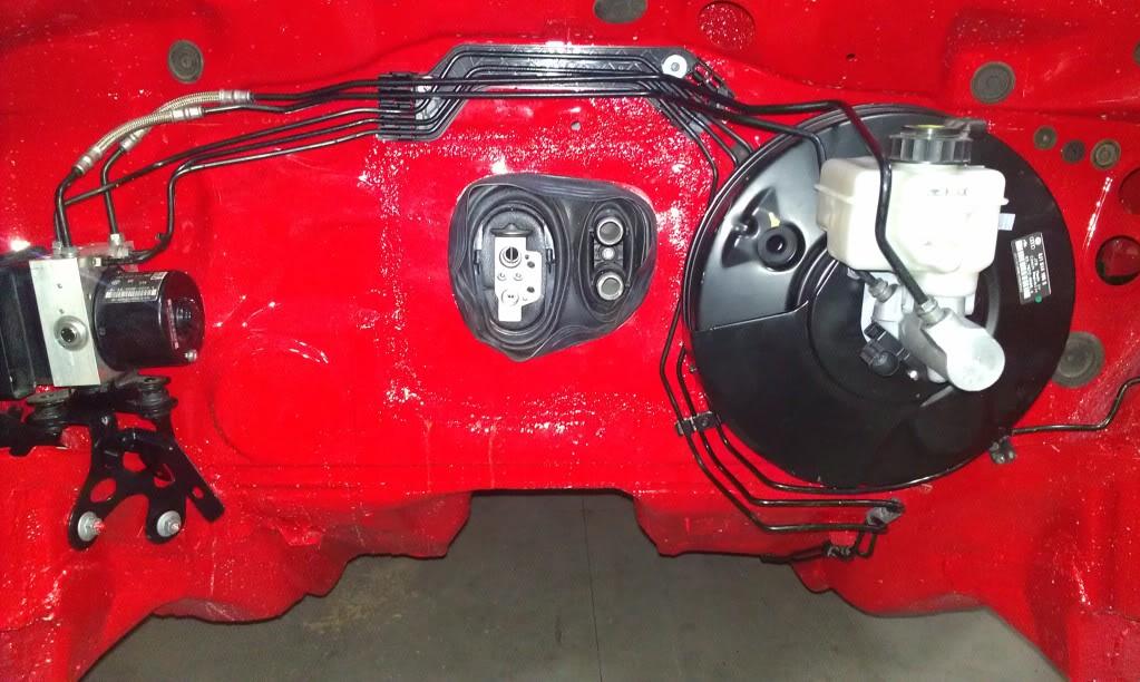

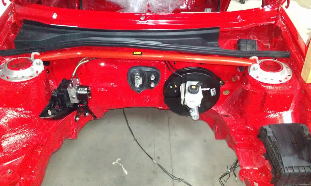

finished the fuse box:

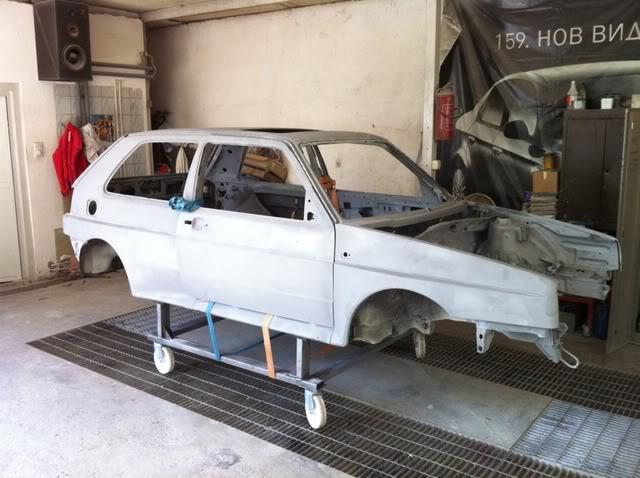

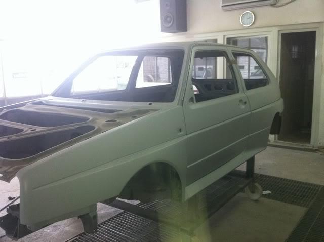

there are only 2 things to finish now and off to sandblasting and then directly to painting

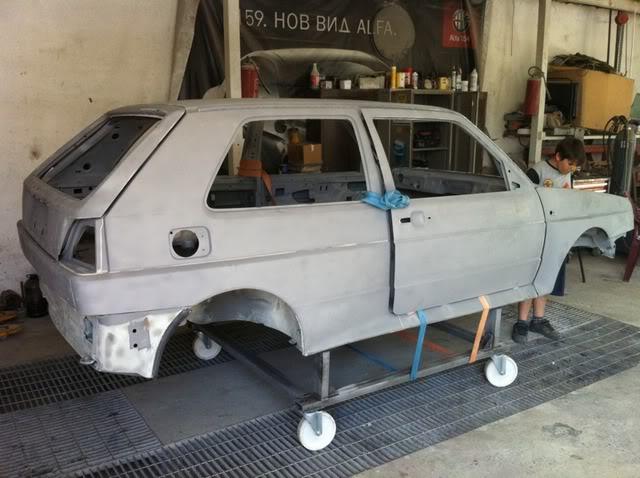

Sand blasting done and off to the Paint shop

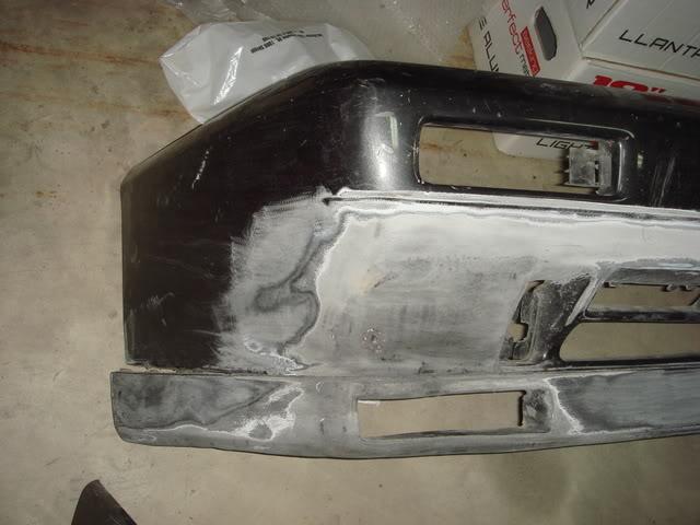

I took the bumpers to be fixed. I closed the holes for the fog lights and filed in some bumps and cracks
Finally something done on the car
Closed the gas tank cap

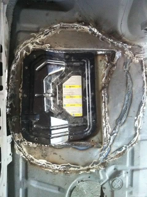

The place for the battery
and the rear lower reinforcement
something more coming up !!!

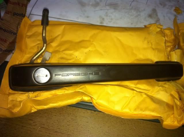

Today arrived some new parts that I ordered:

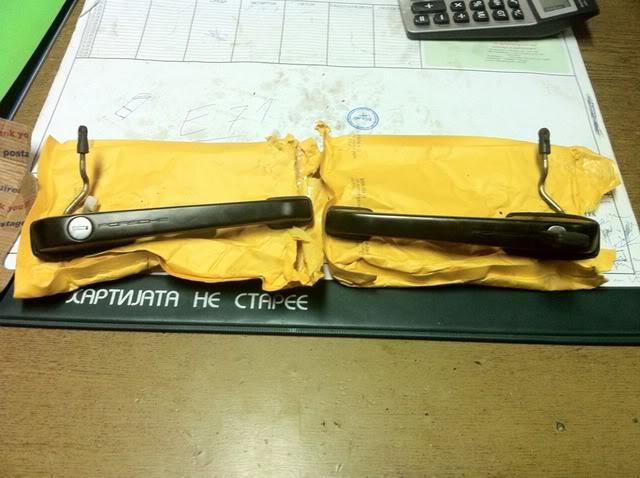

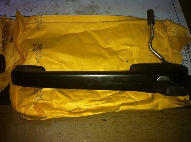

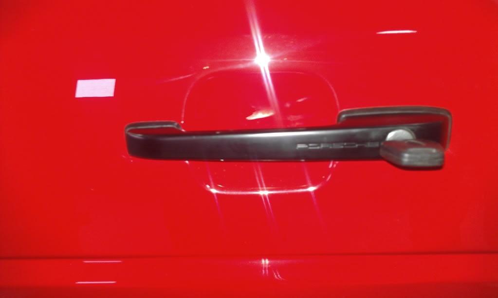

Porsche 944 door handles

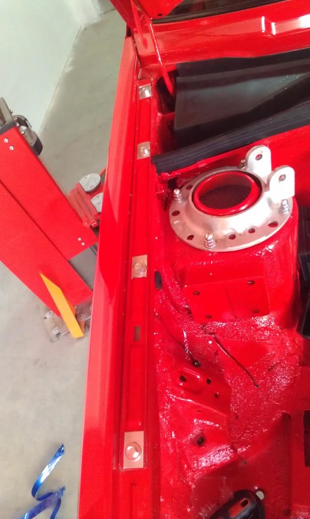

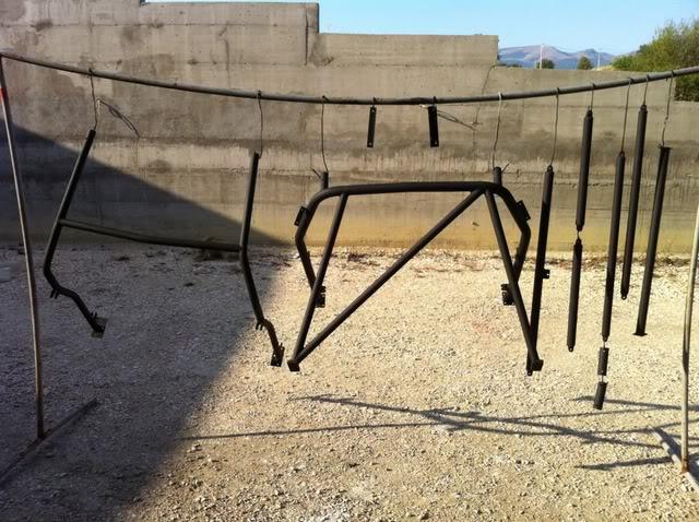

The roll cage and the rear axle were put in filler and after that the rear axle was painted:

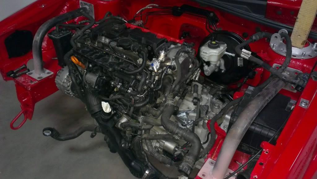

Installed the Haldex
and one of the drive shafts

Because my car is at the paint shop I havent done no progress. But I have upgraded mu garage "TUNING GARAGE" as I like to call it ;)
A new ELECTROMECHANICAL 2-POST AUTOLIFT from WURTH (OMCN)

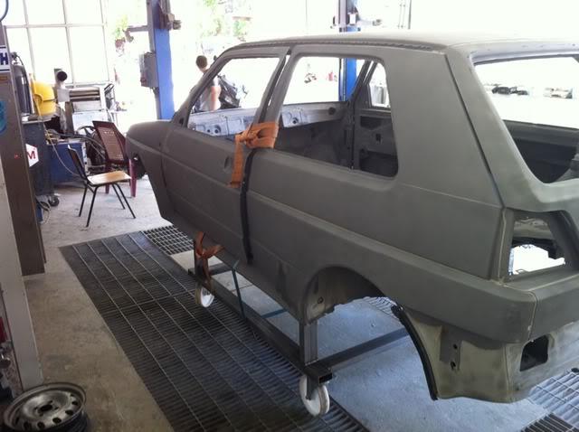

Finally the car has been put in first hand filer... and looks nice :p

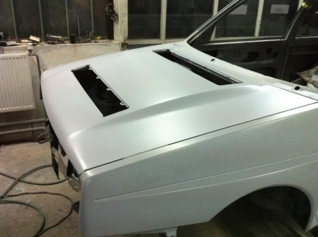

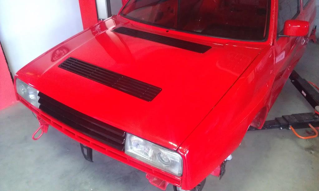

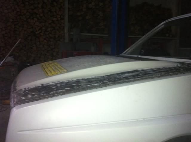

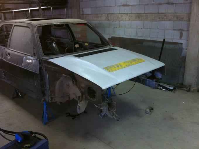

The hood is almost finished. It took a lot of thinking and work but it's almost done :D
and the parts that I bought 3 months ago from U.S finally arrived
the rear calipers
and the H&R sway bar
And finally the hood is finished :)
everything fits as stock. All the lines are aligned :D
Audi R8 Calipers
now to figure out how to make the brackets  :banghead:

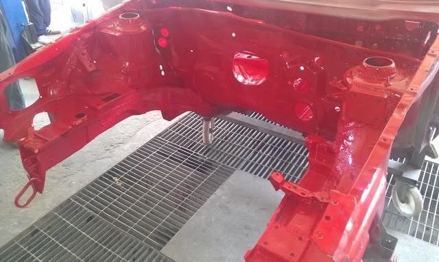

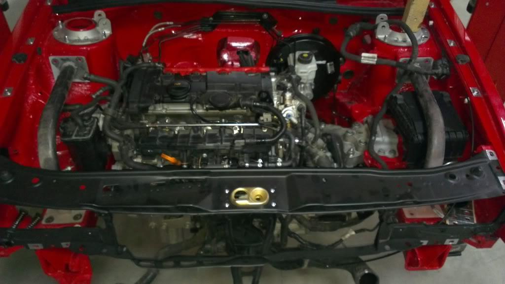

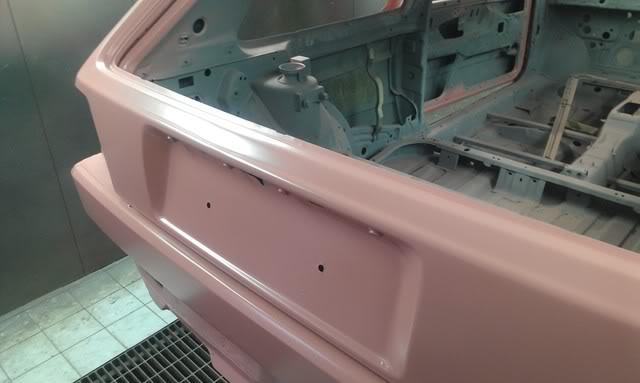

Also the front end of the Rallye got together and now its time to correct every line that needs correcting and realigning ;)
The car was sanded and put in second hand filler
the bumpers:
closed one of the holes for the front wind screen wipers and the rear one also

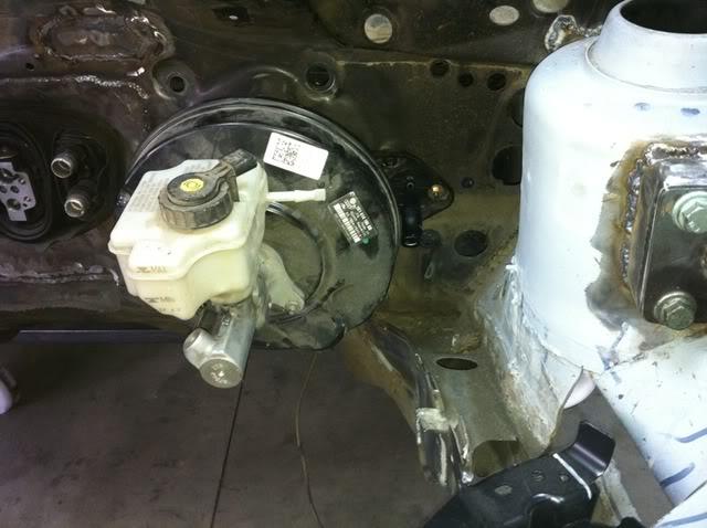

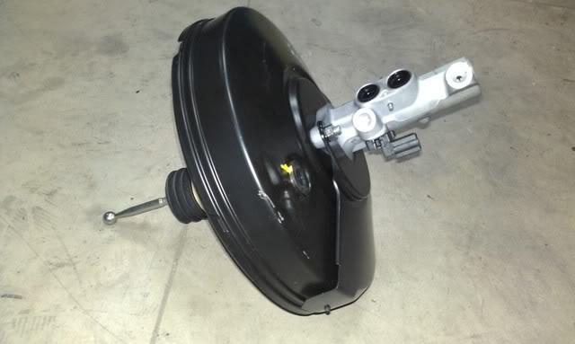

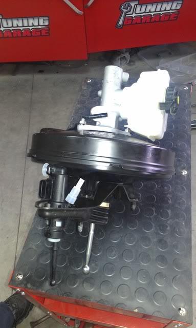

and an MC from Audi TT RS 25.4 mm clip
Moore new parts
I was thinking for a very long time what to use for my gearstick and this is the answer
R pedals
Clutch cylinder
Front Audi TT RS brake lines :banghead: I tough they were steel braided but I guess I will be buying Braided ones :(

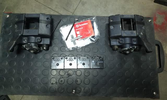

the pads for Brembo handbrake calipers

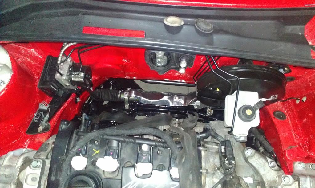

finally the MC with the brake fluid tank and the Clutch pump

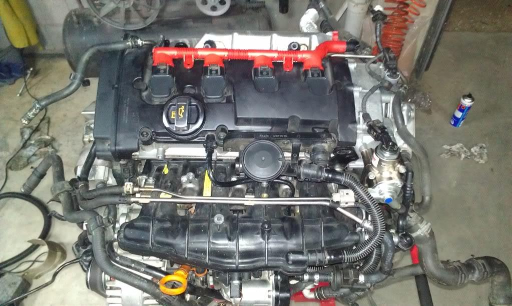

I also bought a set of 4 Audi RS4 injectors which I will use with the stage 3 or 4 ;D when I buy an engine of course   :D
I also got my garage a little fixed up and cleaned ;)

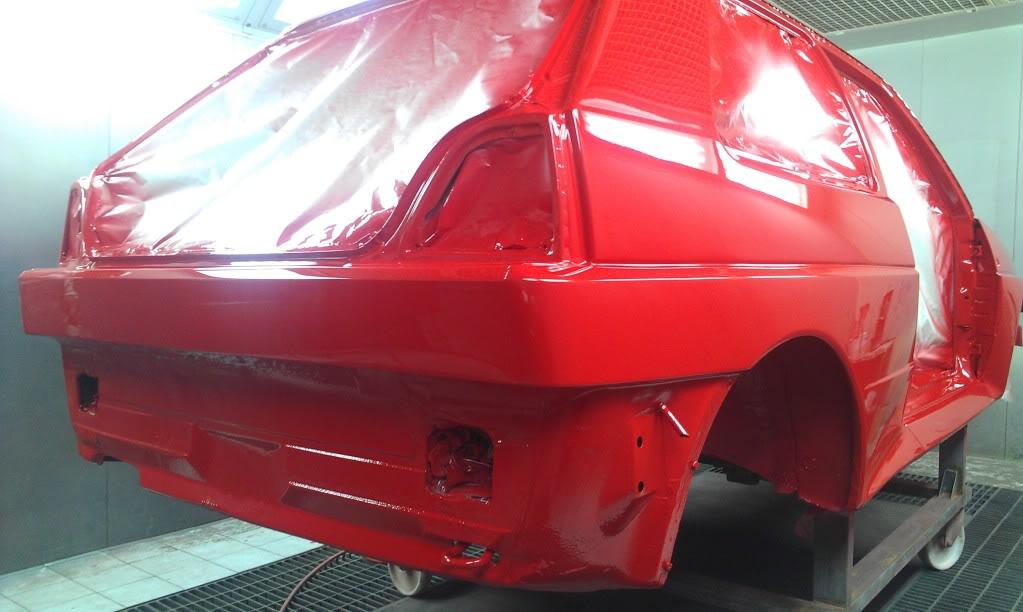

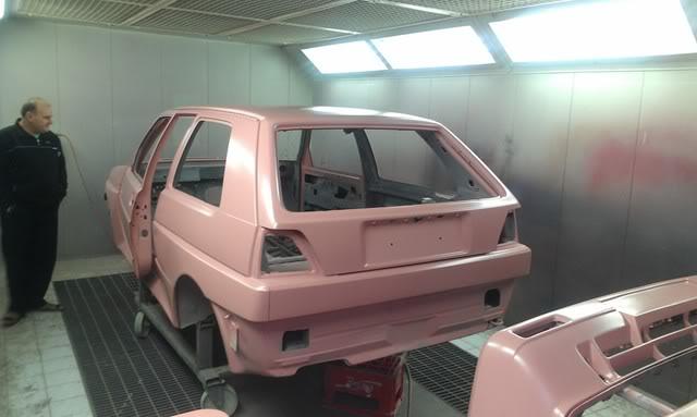

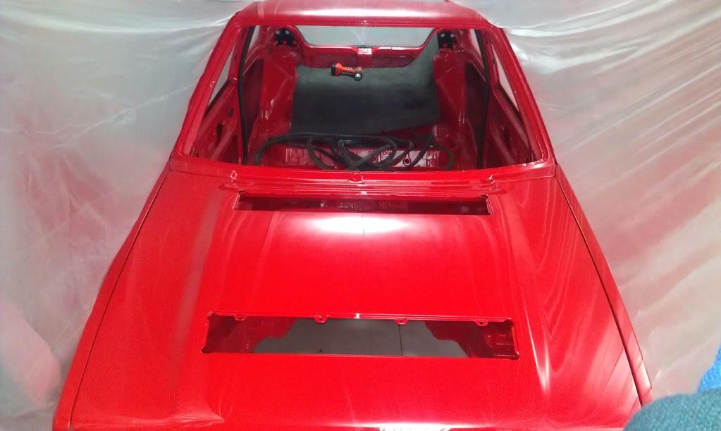

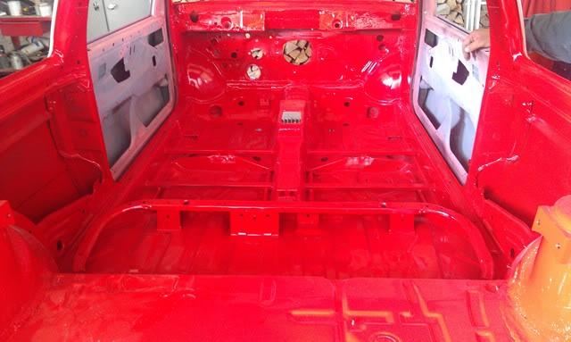

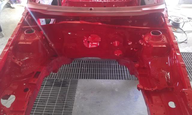

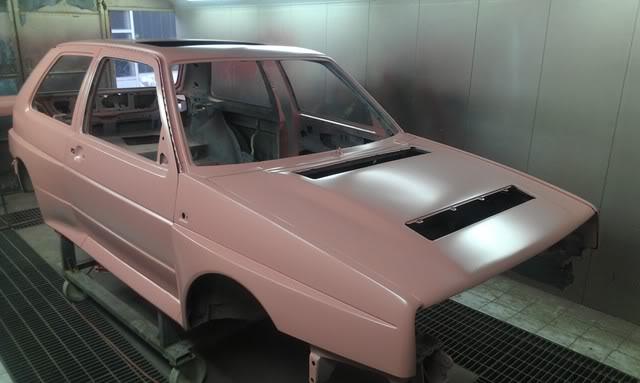

OK so here is some work done. Finally we started painting :facepalm: The interior and the engine bay have been painted and in the next few days so should the outside ;)
And some more parts:

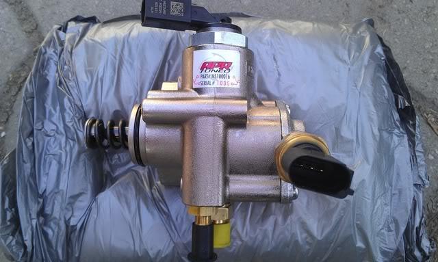

APR HPFP
Audi S3 IC

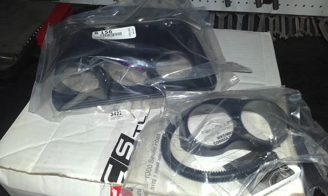

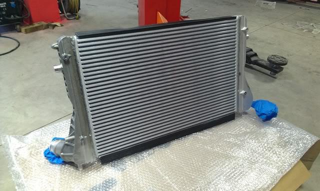

and a NS MKV Offset Dashpod from ECS

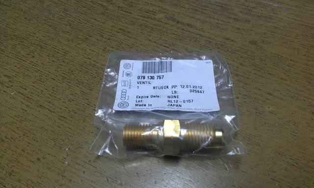

Audi R8 fuel pressure valve

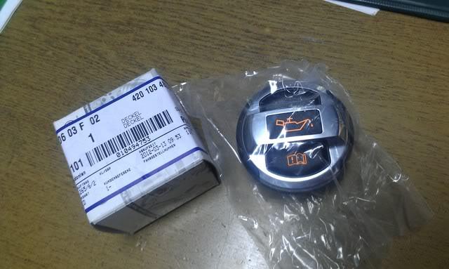

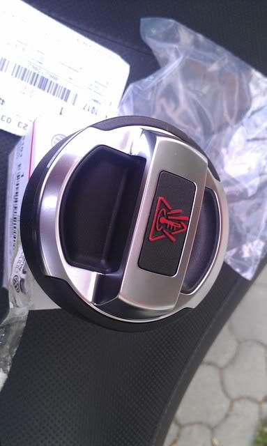

Audi Oil Cap :P
and the first thing I will change on my 2.0 TFSI
also updated mu garage with looks and some tools ;)
The only thing that wories me is the size of the IC. It's a bit taller then the Rallye IC ?
but I think I'll find a solution :dontknow:

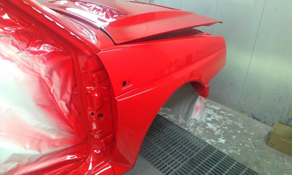

Finally :D Some paint and clear coat :P
Only one thing I have to say:
Just the naked eye can see the real beauty of the finish :cool:

I bought NEW all possible screws

Finally after 10 months the Rallye is back in my garage;)
I didn't know where to start :rolleyes: I was all over mu garage taking out the parts stashed for the Rallye :laugh:
Well the assembly has started :)

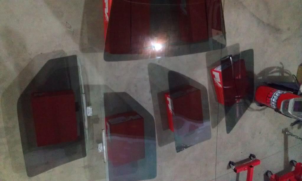

And tinted the windows :wink:

OMP Steering wheel
My racing shoes Alpinestars
Carbone Lorraine brake pads for my rear Camaro SS Brembo Calipers
and some more parts from the VW dealership
The bumpers, rear view mirrors, front grill came back from painting :cool:
I decided to chrome all mu nuts and bolt so here are some of that:

then started cutting the MK5 dashboard ;)
and at the end I finally installed the brake lines  :thumbup:
I painted the front lock carrier, lower cross member and completed the front end and the bonnet because I couldn't wait to see how will the car look at the end :P
I got the bolts and nuts from the roll cage and the door locks chromed :)
bought some cardan  shafts (Golf Mk5,Golf mk4,Audi TT 8n)

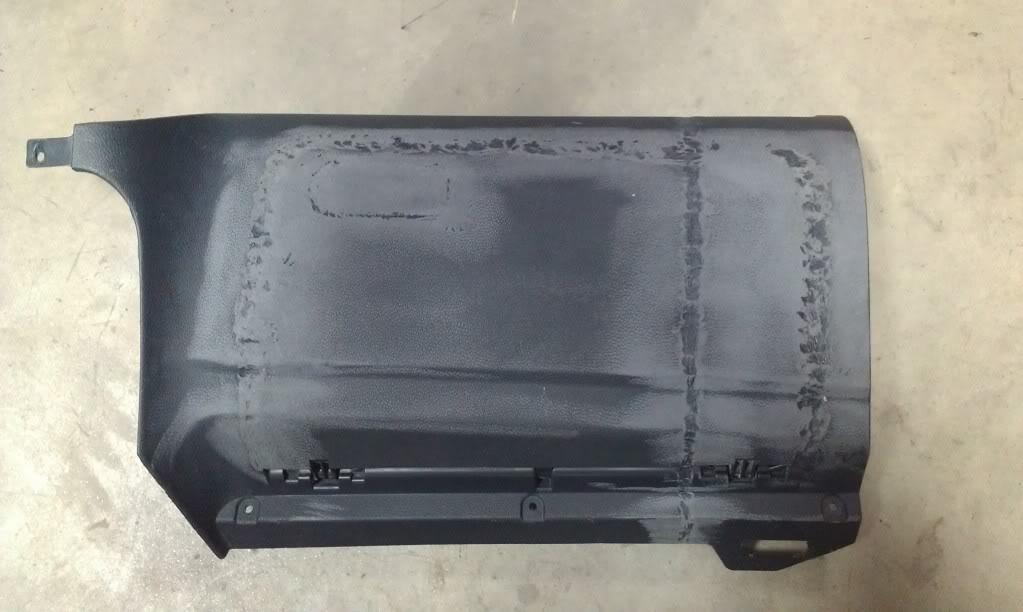

and glued the dash back together
and then cut and glued the other parts that needed fitting

and at the end how should the interior look like
only maybe without the navigation ;)
Well finally I received the last batch if nuts and bolts that went to chroming
and so the work can continue
mounted the front and rear axle, and started on the measuring the propshaft
so everything looking good :rock:
Made the propshaft bolt on the original Rallye propshaft holders ;)
I also did a little intervention on the rear axle because the propshaft was a bit off center :banghead:
then unscrewed the fenders and put a special plastic sealant strip that I bought from the dealer
and then screwed them back on with the new screws and special intermediate zinc plates (they are used so you don't scratch the color ;) )

after all of that I assembled an BWA engine that I had in mu garage with the quattro gearbox and fitted that on the Rallye :P
there is enough space for a GT3076 I think :laugh:
and from under the car
there is one problem that will need to be solved :rolleyes:
the gearbox as fitted is very close and will hit the front axle
and when the car will be on its wheels ...should look something like this:
then the oil pan will be around 11sm from the ground :confused: Dont know if it will be a problem :confused:
as you can see its almost the same height as the front axle :confused:
The lower engine mount finished
and the roll cage painted and half mounted :D
Still waiting for the big update :banghead:

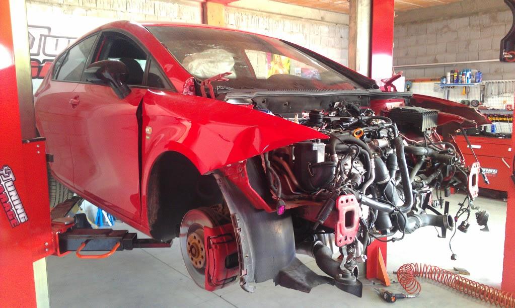

a 2010 Seat Leon Cupra R :laugh:
and the hart for the Rallye
Today I did little work on the engine, because he had same damage:(
Changed the intake manifold mounted the APR HPFP and valve ....

I tried to clean the gearbox but couldnt so I sandblasted it ;)
installed a new hydraulic clutch pump
then installed the gearbox on the engine and in the car it goes
I started conecting the water hoses and other stuff to see what needs to be modified :confused: and when I came to the gear selector :P
I had to drill some nasty holes to get that thing in the right position and length. I used the Audi TTs gear selector because as far as I know it has the longest cables :confused:
and it will be tight on the front end but I think I will manage to get the S3 IC and water cooler in there. If the MK5 GTI water cooler fits in there I was thinking of ordering the Mishimoto one and the Mishimoto fans :confused:
