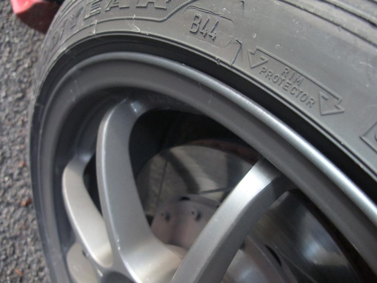

Yes, ME!  I got one axle set of 225, and the other axle is 235.  They don't foul on anythhing, they certainly dont degrade the handling, and they dont look odd either!
....235 on the front or rear?
Any particular reason you are riding this way?
I changed to 235s because I'm fed up with not having any protection to the rim.  235s give a marginal, but still worthwhile extra bit of protection to the alloys from kerb rash. :ashamed:
And by keeping the same 40 profile, the everso slightly larger rolling radius helps eliminate the inbuilt error in the speedo.  Above about 90mph (on German Autobahns  :wink:), the GTI speedo gets wildly optimistic, and these 235s help rein in some of that over-reading error.
And the reason they are on the rear - new tyres on the rear axle (but only after scrubbing them in for a couple of hundred miles on the fronts).  The 225s still on the front are nearly worn out now, and they havn't interfered with either the flat tyre warning, nor the ASR or ESP.
....My Goodyear F1 Assymetrics have excellent rim protection - Something I've noticed since changing from Monza 18's to OZ Alleggerita 18x8's.
Thoses F1s are identical to the 'stretched' PS2s on the RS4 - but due to the stretching, they are as useful as a Dairy Milk fireguard!
....Well, fortunately having kerbed my Monza 17's within the first fortnight of ownership (distracted by a pretty female passenger talking to me) I always need a taxi to the kerb. So I've no occasion to test the chocolate rim protector (Ooops! That sounds a bit naughty!).

TT you got any snaps of your tyres on the rims to compare and contrast?
