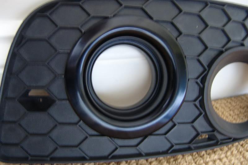

Just thought I would neaten up the cold air feed that I had on my car.. I did it in a bit of a rush before the 1st Feb Santa Pod event just to make sure it was on there but im not just getting round to sorting things out to how I want them to be. Very OEM looking, nice and neat etc..
From this..
To this..
Took a bit of time to do it but its well worth it I think.. Looks a little neater and the venturi should work as its supposed to now with the duct on the outside edge of the passenger side fog grill.

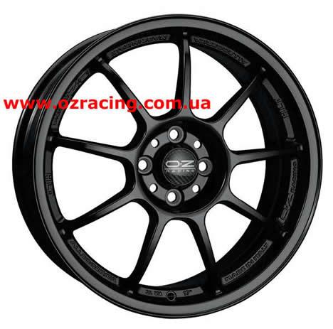

Decided on new wheels..
Oz Alleggerita - 18x8 ET48 5X112.. A couple of reasons for this..
The Compomotive wheels weight 11kg each!! I know there strong but jeez! The OZ are going to be saving me around 6kg over the weight of the Team Dynamics wheels that are currently on the car where as I would have gained 4kg fitting the Compomotives, certainly not what im after.. Remember that is all rotational mass so its worth between 4 and 5 times static weight loss!!
This does mean however that I wont be able to run the 255/35 tyre that I was planning. After giving it some though a lighter wheel with a smaller tyre I think is going to give me more of an advantage than a larger wheel/tyre combo with more mechanical grip..

I knew you wouldn't be able to resist the Alleggerita's Jonny :laugh:
Why did you go for the 8x18's and not the 8 x 17's?
Brakes, it would have been touch and go if they would have fit or not, and a lot of money to spend if they didnt!!!
