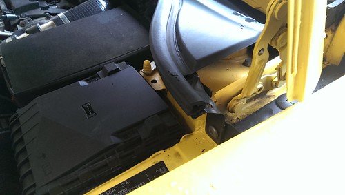

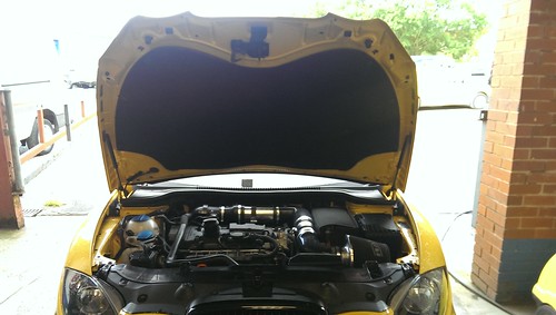

how to make your own 90mm custom intake
before I even got the k1 I had been looking at the tuning aspect, and realising these cars are bloody expensive, im not the type to pay £400 for an intake, no matter how nice it looks,
so heres your shopping list:
1x70>90mm silicone hose
2x90mm 90degree silicone hoses
1xmetre 90mm alloy pipe
5x80>100 jubilee clips
1x60>80 jubilee clips
Metal rod
Air filter of choice
Tools:
Air saw
Dremel/air grinder
Sanding wheel
Heres how to do it:
The scary bit is cutting your engine cover, once you have this in hand you’ll see how and were to cut, you basically need the maf pipe, don’t forget take the maf sensor out before doing any cutting as they are fragile!!!! You have been warned
You want to get the oval maf pipe to the stage were the coupler fits on,
Next you need a piece of alloy pipe 10.5” long, fit this into the coupler and then onto one of the elbows,
The next pipe is 6.5” long and has the other elbow and filter on it (I chose a ramair filter which can flow over 400bhp)
I then made a couple of brackets out of the steel bar, to hold everything in place, and cut my engine cover to suit,
Heres how it all looks now
DSC_3199 by cuprajake1, on Flickr
DSC_3191 by cuprajake1, on Flickr
IMAG0154 by cuprajake1, on Flickr
DSC_3189 by cuprajake1, on Flickr
Jake

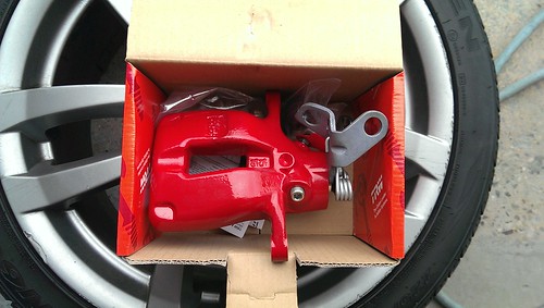

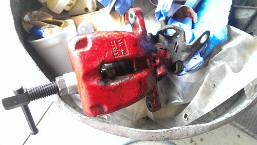

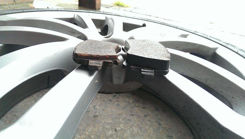

got the car on the ramp at dinner to have a look at the caliper, it was seized, very seized :(
exchange unit ordered with pads :)

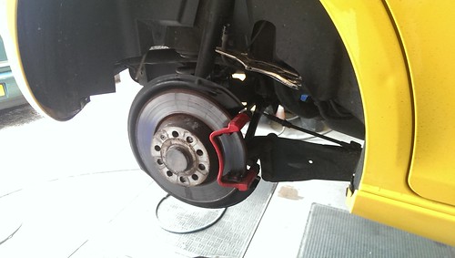

caliper taken off and cleaned the area, here you can see my tricky dent
IMAG0162 by cuprajake1, on Flickr
this shows you how hot the caliper has been, the paint is destroyed, the rest of the calipers look like new
IMAG0165 by cuprajake1, on Flickr
the pads on the good side did have alot of meat left, but the seized side were down quite a bit,
old vs new
IMAG0172 by cuprajake1, on Flickr
and the shiney new caliper
IMAG0167 by cuprajake1, on Flickr
job done

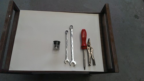

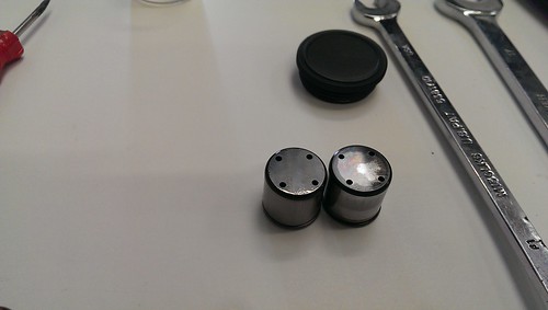

next thing was maintenance
cam follower changing
tools
IMAG0176 by cuprajake1, on Flickr
and the parts note the wear
IMAG0179 by cuprajake1, on Flickr
jake
Tornado red ed30 #0728

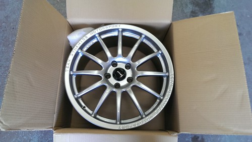

Re: Crono yellow k1
« Reply #24 on: September 18, 2013, 04:51:14 pm »
18x8 et40
jake

Re: Crono yellow k1
« Reply #25 on: September 18, 2013, 05:18:29 pm »
 How come you went for ET40 and not the usual ET45?
Offline cuprajake
  • Posts: 585
  • My Ride: http://www.mk5golfgti.co.uk/forum/index.php/topic,72567.0.html
Re: Crono yellow k1
« Reply #26 on: September 18, 2013, 05:19:09 pm »
sorry they are et45 lol  :rolleye:

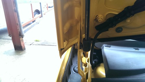

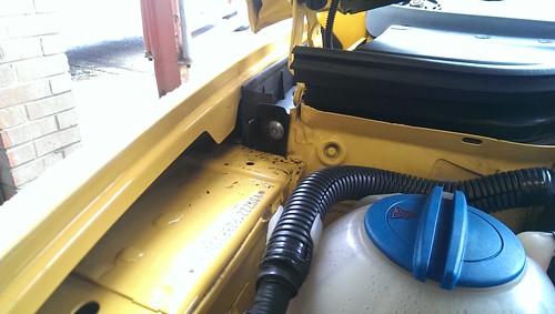

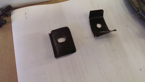

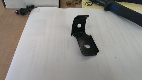

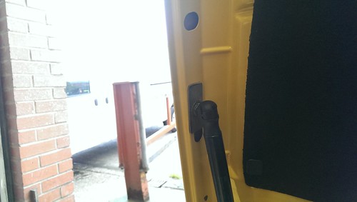

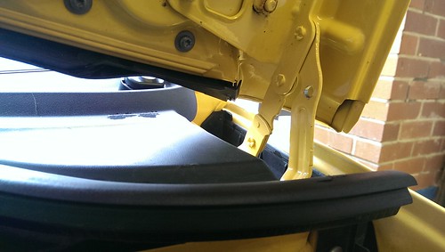

tried this today, and kind of failed,
the strut has to fix into the ball but its on too much of an angle for this to work so i modified the way its works and went the oem solution
i still used the plates, 20x50mm, welded the nut on the back,
how ever i went through the hinge
heres the hole
IMAG0223 by cuprajake1, on Flickr
after that to allow the strut to come down you have to trim this piece
IMAG0225 by cuprajake1, on Flickr
remove it
IMAG0227 by cuprajake1, on Flickr
cut in half
IMAG0228 by cuprajake1, on Flickr
install upside down
IMAG0218 by cuprajake1, on Flickr
i also trimmed the rubber 1/2"
this is it fitted up, no more bonnet stay :D
IMAG0215 by cuprajake1, on Flickr
IMAG0232 by cuprajake1, on Flickr
IMAG0220 by cuprajake1, on Flickr
IMAG0221 by cuprajake1, on Flickr
the struts are off an audi a4 13" long, while they hold the bonnet they dont lift it, so i need something stronger which i can have made by a company :)
