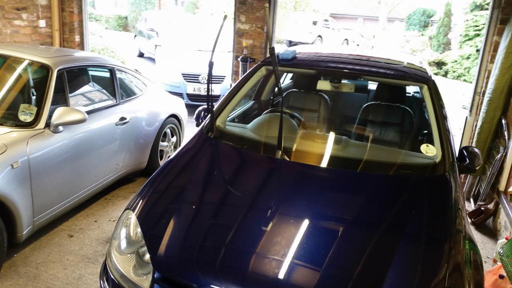

While I can't really do anything major to the car until the weather gets a bit warmer (and I get some more ££ for the bits I need), I decided to get myself some Rain-X to make it a little safer for the rainy days and nights driving. I was originally going to get some Gtechniq G1 ClearVision Smart Glass stuff but my dad convinced me to try Rain-X first as it's cheaper and also the stuff they recommend on his Porsche forum, so I figured why not!
A few goodies from Halfords
In my parents garage applying the Rain-X
I put 2 layers of Rain-X on the outside and when I tested with a spray bottle the water just runs straight off, very impressive! As I had the anti-fog stuff too I put 1 layer of that on inside to see if it will actually work, I'm a little dubious but we shall see.

Well after the drive back from my parents place I can safely say I will not be putting any more of the Rain-X Anti Fog rubbish on again, it didn't fog on the windscreen but caused a film of liquid to slowly run down which then blurred the entire window, which was fun! Luckily I wasn't far from my normal service station stop so I could wipe it off but need to get this rubbish off my window!
The exterior Rain Repellent on the other hand is absolutely fantastic. Driving along at 70mph with no wipers on in the rain and still being about to see out of the window is a new one for me, and I found it's also great fun seeing the sheer look of horror on peoples faces as you pass them with no wipers going when there's on on full whack  :signLOL: (Obviously I wouldn't exactly recommend not using your wipers...but it is funny).

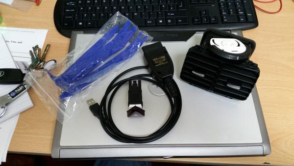

New rear AC vent as the one in the car is broken and although I can't see it I know it's broken and has bugged me right from day one, nice cherry hazard button to replace the horrible standard one, a set of trim removal tools I kept on putting off getting, and last but not least got myself a VCDS cable to play around with  :fighting2:, luckily had an old laptop sitting around so that has now become my 'car' laptop  :happy2:

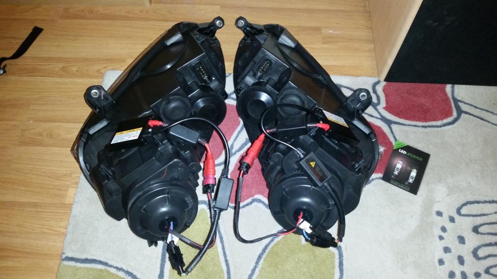

I also had a moment of weakness and bought myself some Depo Projector head lights and a 5000k H7 Xenon conversion kit for them. I've always preferred the look of the projector lights to the standard reflectors but the cost has always put me off doing the mod. After a lot of reading up on the Depo units I decided to just go for it, at the price they were including the conversion kit I just couldn't say no. Ed came over to give me a hand with this as I wasn't 100% with removing the bumper myself and we also had a few load resistors to put on my fog lights to see if it could get rid of the bulb out warning. The swap out was pretty painless really. Everything tested out ok, I'd already coded the Xenons with no shutters while I was waiting for Ed to arrive to stop them flickering. The fog light load resistors while they did get rid of the bulb out warning, they got so hot you could put your hand 2-3cm away from the resistor and feel the heat. While it was nice to be able to do that on that windy day, it wouldn't have been so good in summer while constantly running so I decided I'd just live with the warning light for the time being and work on a plan B.

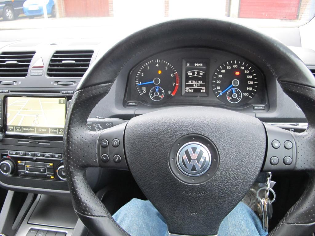

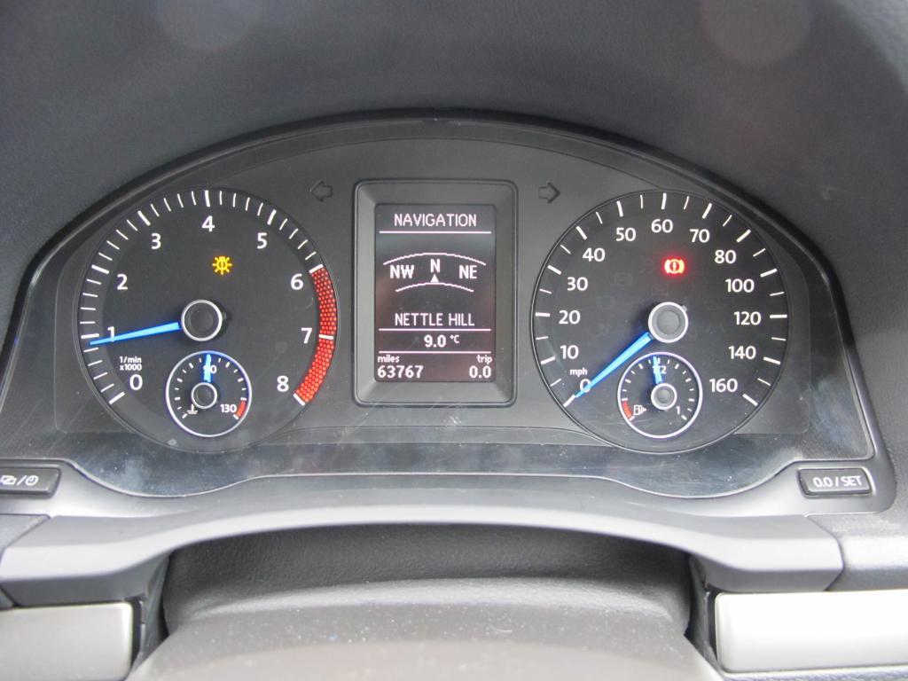

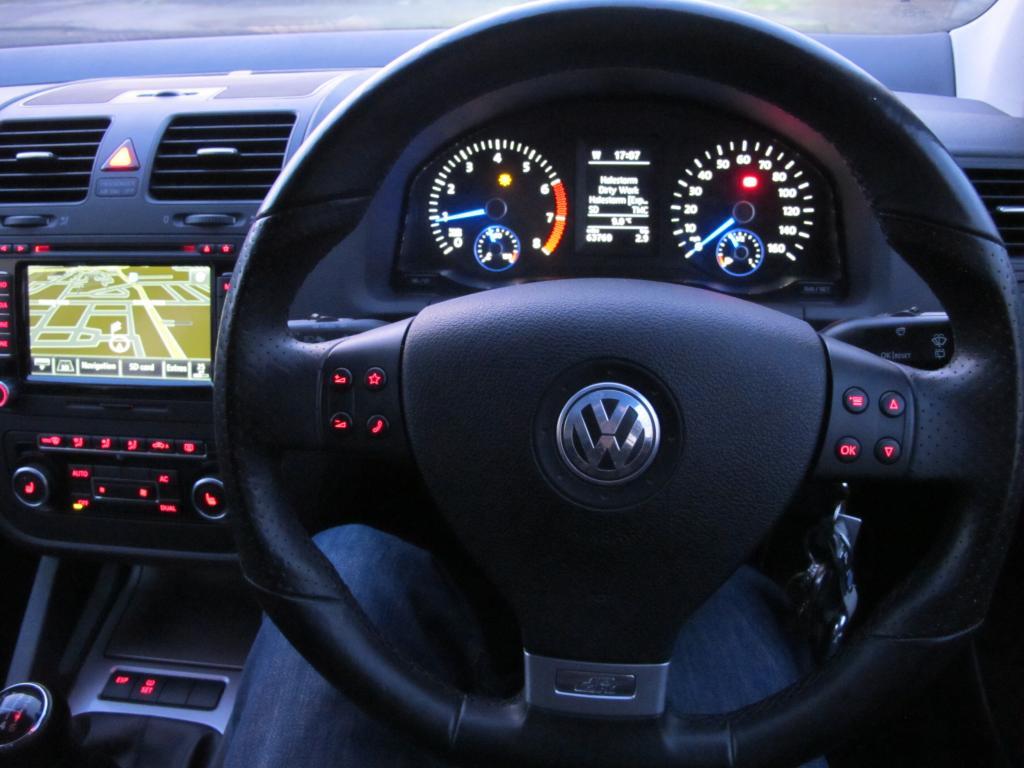

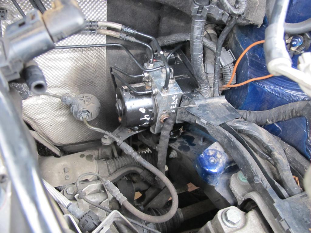

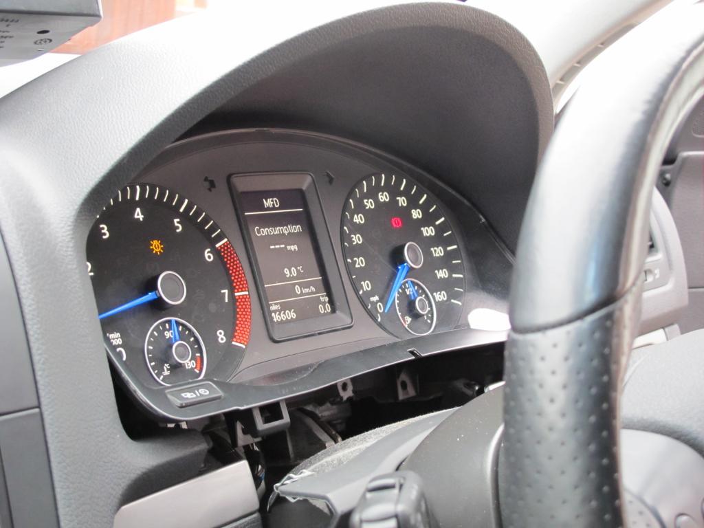

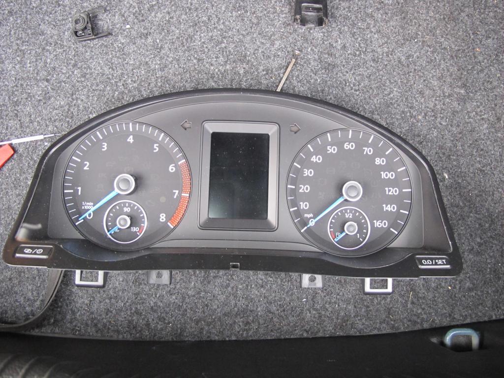

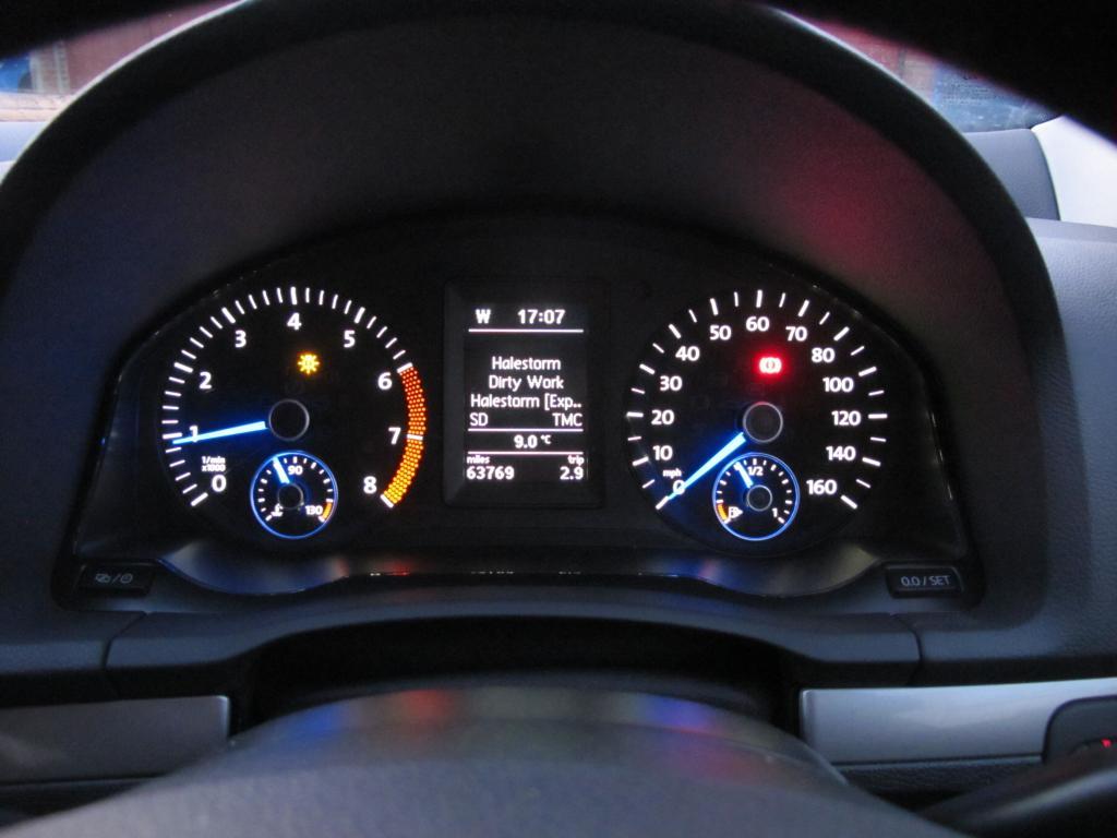

Had a big day yesterday, @Eddie-NL came over and worked his magic on my car once again. This time we tackled the biggest job so far, swapping out my Mk5 highline for a Mk6 white display highline with blue needles. This however also meant swapping out the ABS pump and doing a brake bleed as the ABS pump that was in my car was too old for the cluster.
First off Ed got going on the ABS swap while I attacked the keys to replace the transponders over for the immobiliser without damaging the original transponders for if the car goes back to standard. The actual pump swap went pretty painlessly, then we got to doing the brake bleed and that's where the fun really began. Got all the way around the car without much feeling in the brake pedal at all, on the last wheel I pumped the pedal some really manky nasty fluid came out of the bleed nipple. It was shocking how bad it was! Once that was cleared the pedal felt far better than it had before.
With the pump changed and the brakes bled it was time to code the new pump in and make sure everything was ok. We went for a quick test drive once the coding was done and all seemed good with the brakes, ABS certainly kicks in when you hammer the pedal to the floor (also scares posties on push bikes too  :signLOL:) so back we came for the cluster fitting.
The cluster was a nice and simple unplug the old one and plug in the new one via the loom Ed made and code it up. Ed had done a lot of the prep work on the cluster before getting to my place as we'd been talking about doing the swap for a few weeks and he already knew my car pretty well. Anyway, here's the pics from the day and the new cluster just looks amazing. I'd like thank Ed once again for all his help on all of this  :happy2:
New Mk6 cluster with blue needles!
New ABS pump in
Testing the new cluster
And it's in
Looks amazing...
...looks even better when it's darker!!
See what I mean!
Depo projectors all setup and ready to go in from last post

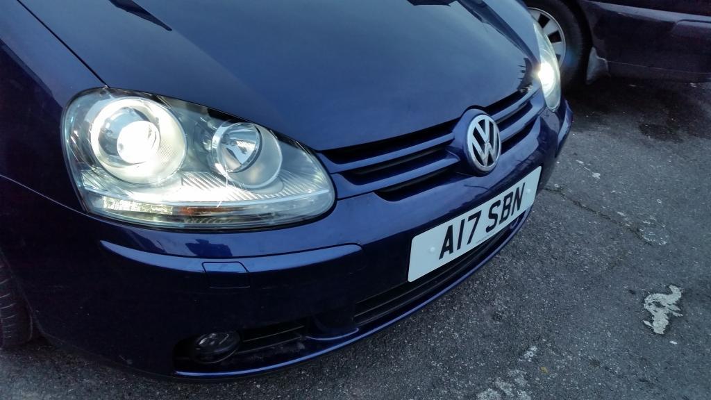

Depo projectors in, working and looking niice

That is one sweet cluster! Looks brilliant! :laugh: Does the backlit dimming still work on this?

The cluster looks awesome , i would really like to see a step by step tutorial about fitting these clusters on mk5. Tools needed ,looms ,oem codes for the cluster or abs pump. Headlights look great too. Cheers

Thanks all  :smiley: Every time I start the car the staging on the cluster still brings a massive grin to my face, looks so much cleaner now.
If I knew the step by step for the whole procedure I'd happily try and do a tutorial for it as it's such an amazing mod to get done, however as Ed knows my car pretty well he was able to do an awful lot of the prep work for things before coming round to actually fitting it in the car. You may not need to swap out the ABS pump depending on the year of the car and version running in your car at the moment, mine was an 04 plate and had a pretty old revision pump so I had no option but to replace it with a newer version if I wanted this cluster. As far as fitting it in the Mk5 the internals from the Mk6 were swapped out into a Scirocco housing so it would fit perfectly in the Mk5 (There's a Youtube video of this being done for a colour screen) and Ed made up a loom which means the unit doesn't stick out at all, basically it looks like it's standard kit and looks brilliant.
If you want this doing I really do recommend having a chat to @Eddie-NL, the amount he knows about this stuff is staggering and has always been a massive help to me even when I panicked due to a flat battery when coding my new CECM :signLOL:

Headlights look good, how do the compare for visibility over the standard units?

I think I'm going to have to get a set of the Depo headlights! What is the actual difference between the genuine Xenons and the Depo's?

The visibility is on another level to the standard units and I even had 130% XtremeVision bulbs in those which I thought were great! I can now drive on roads without using high beams that I used to need them and if I do kick the high beams on then it's like driving in daylight.
good work fella, should have come over for a look when I was over for my coding with ed.  :ashamed:
Yea same here, think I was fighting with getting the headlights out when you turned up if I remember right and then had to code Xenons in, by the time the swearing had stopped you were just leaving  :signLOL: Ah well, another time  :happy2:
Nice improvements, looks lovely!
In all honesty I'm not 100% sure what the difference is. There's a blue Mk5 TDI that sometimes parks near my house with Xenons and I can't tell if they are genuine units or not, they look exactly the same.
