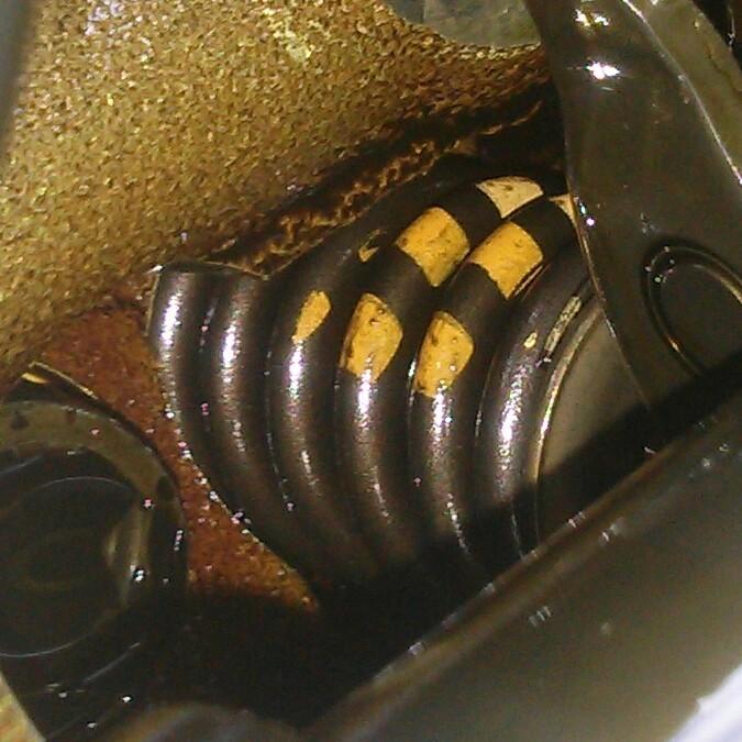

So I pulled my valve cover and found this:
Definite confirmation that my Ed30 (very late 2007) had the dodgy valve springs fitted from factory. The issue is normally made worse as a result of higher exhaust back pressure and the weak spring not being able to close the valve. This is only an issue on the exhaust side and technically the inlets probably don't need changing.

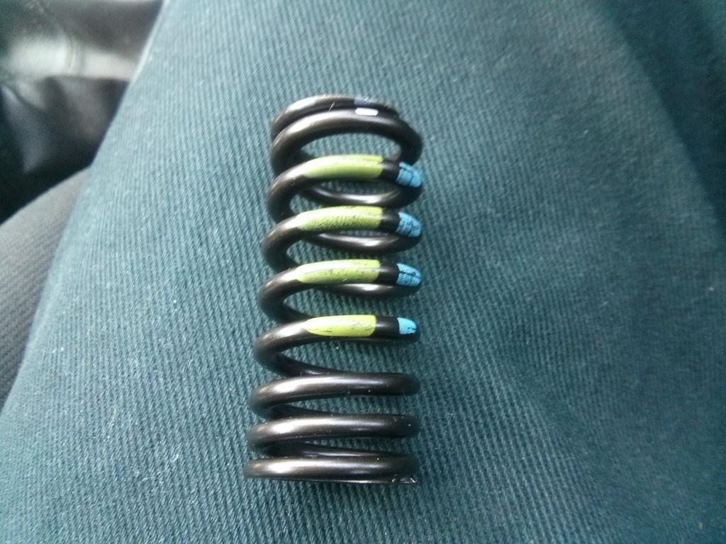

The correct springs are meant to have a single yellow and blue stripe, like the ones I bought here:

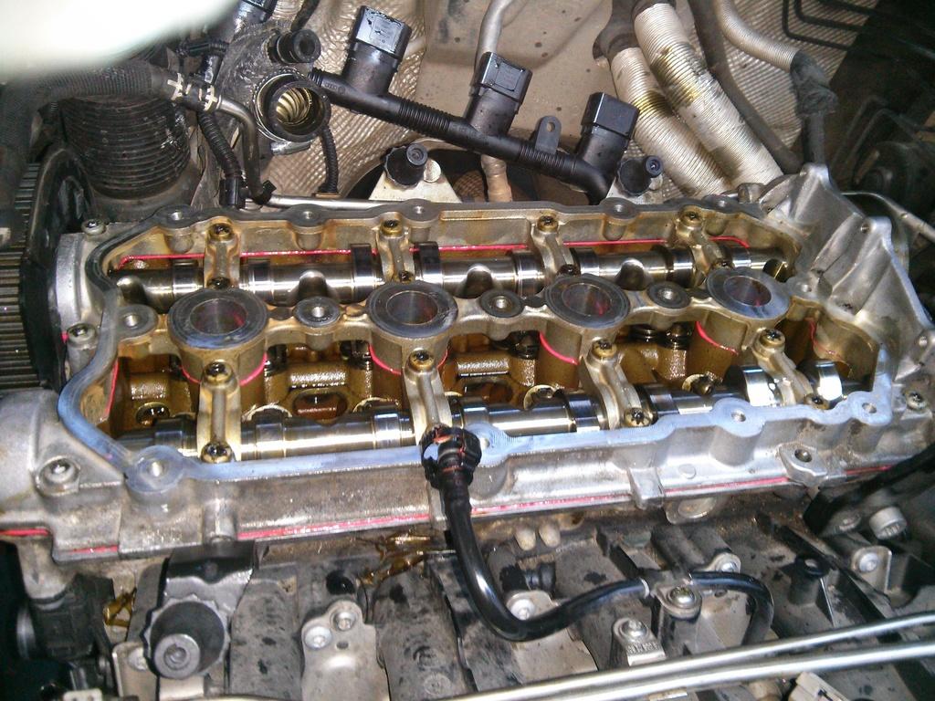

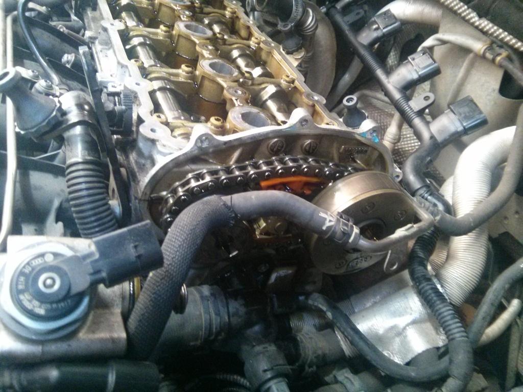

First, valve cover off and timing chain cover needs to come off:
Timing chain revealed:

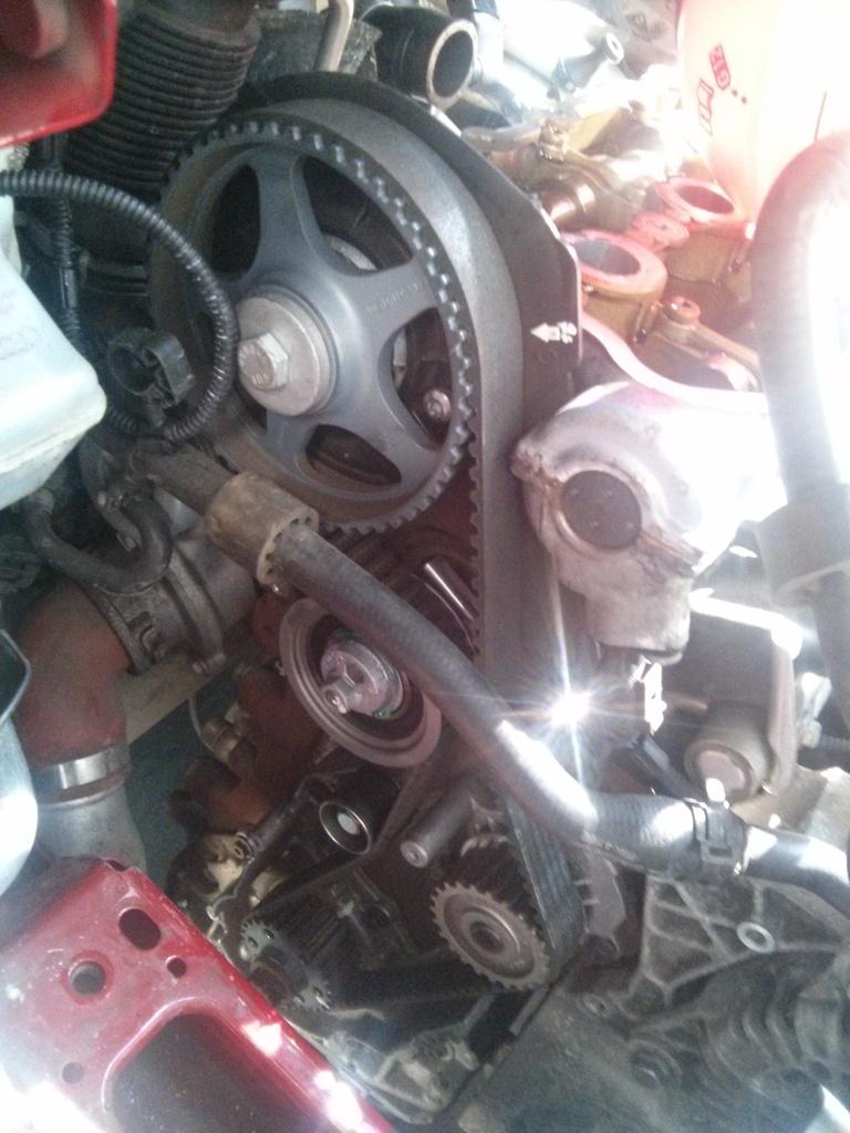

Then, timing belt cover off so we can mark up timing. Getting the side engine mount out was probably the hardest part of the job  :laugh:

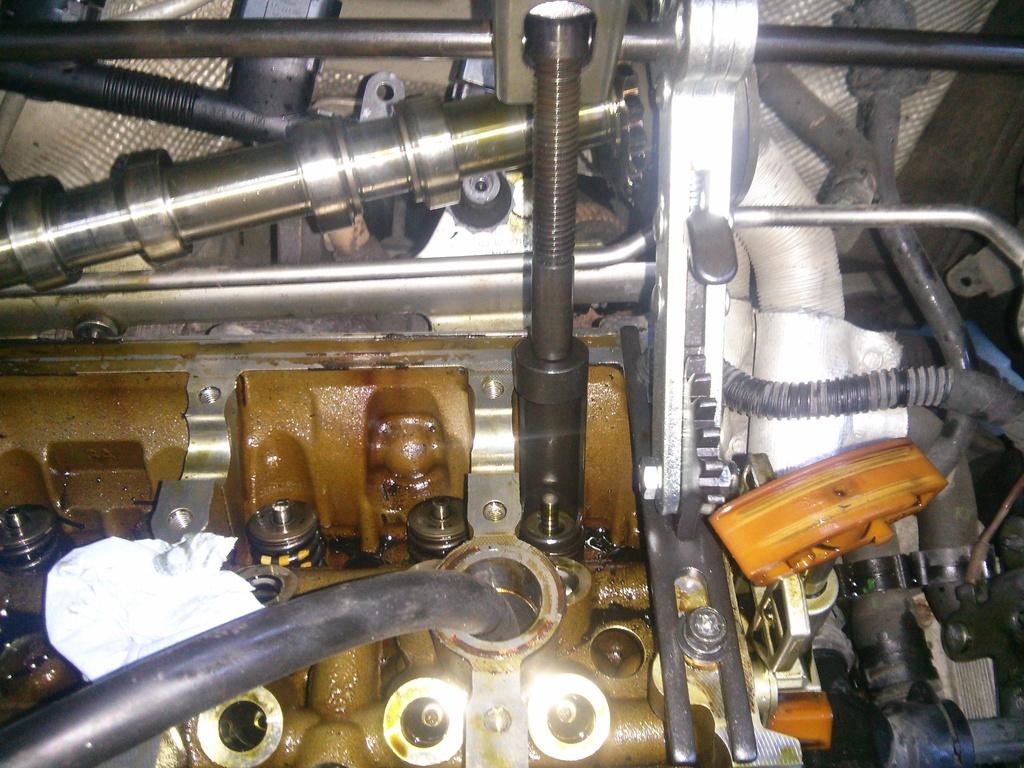

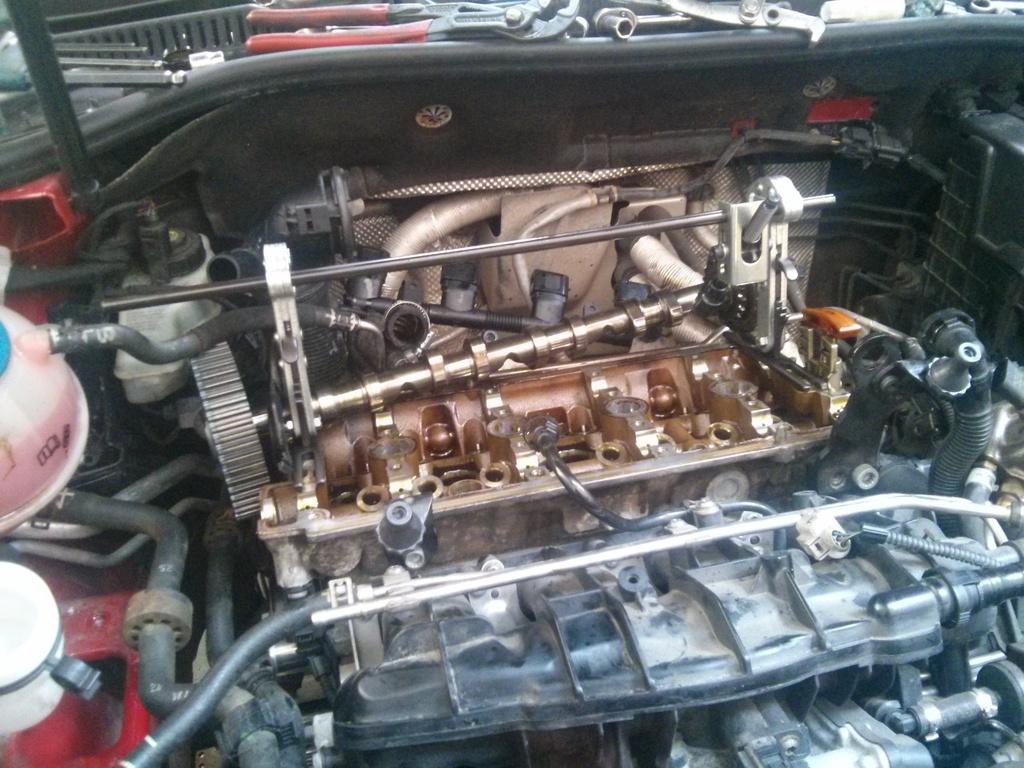

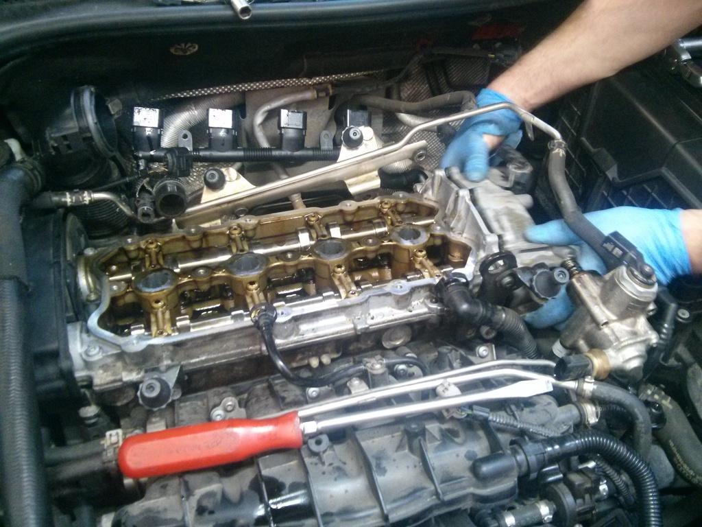

Next, camshafts out. We couldn't get the exhaust pulley off, so just placed it carefully to one side. After that, we installed the tool (http://www.amazon.co.uk/Laser-5258-Valve-Spring-Compressor/dp/B006IRIPD8):
The springs are then compressed and collets can be removed, and then the retainer. The spring can then be removed. Note that when doing this, compressed air must be fed into the spark plug hole of the cylinder that you're working on. This is to ensure the valve doesn't fall down the cylinder - it is also good practice to make sure that cylinder is at TDC too.

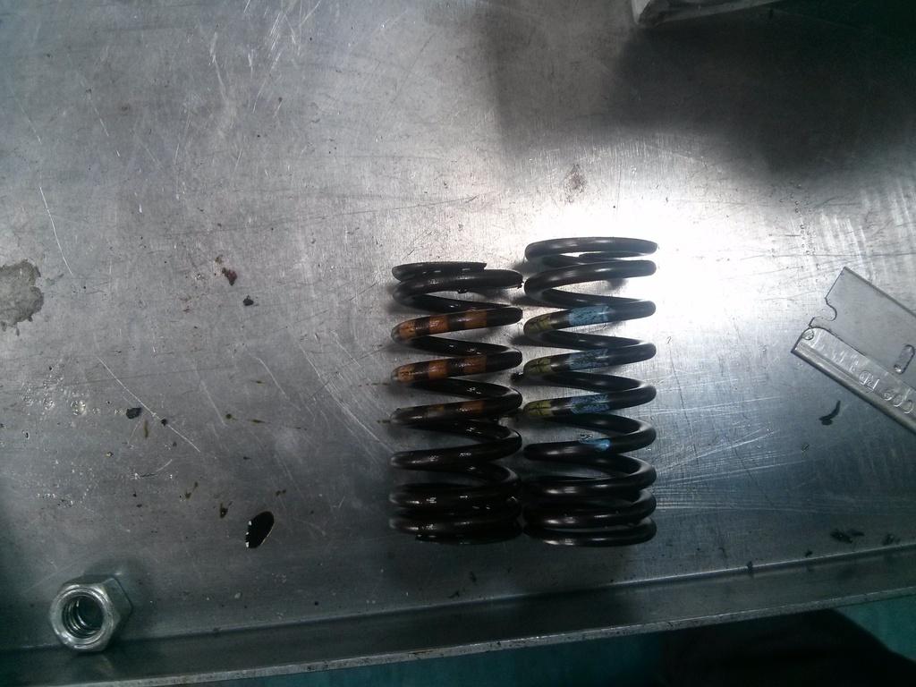

First spring out! Look at the difference between the two, just like the Audi TSB documented. Bad on one the left, correct one on the right:
