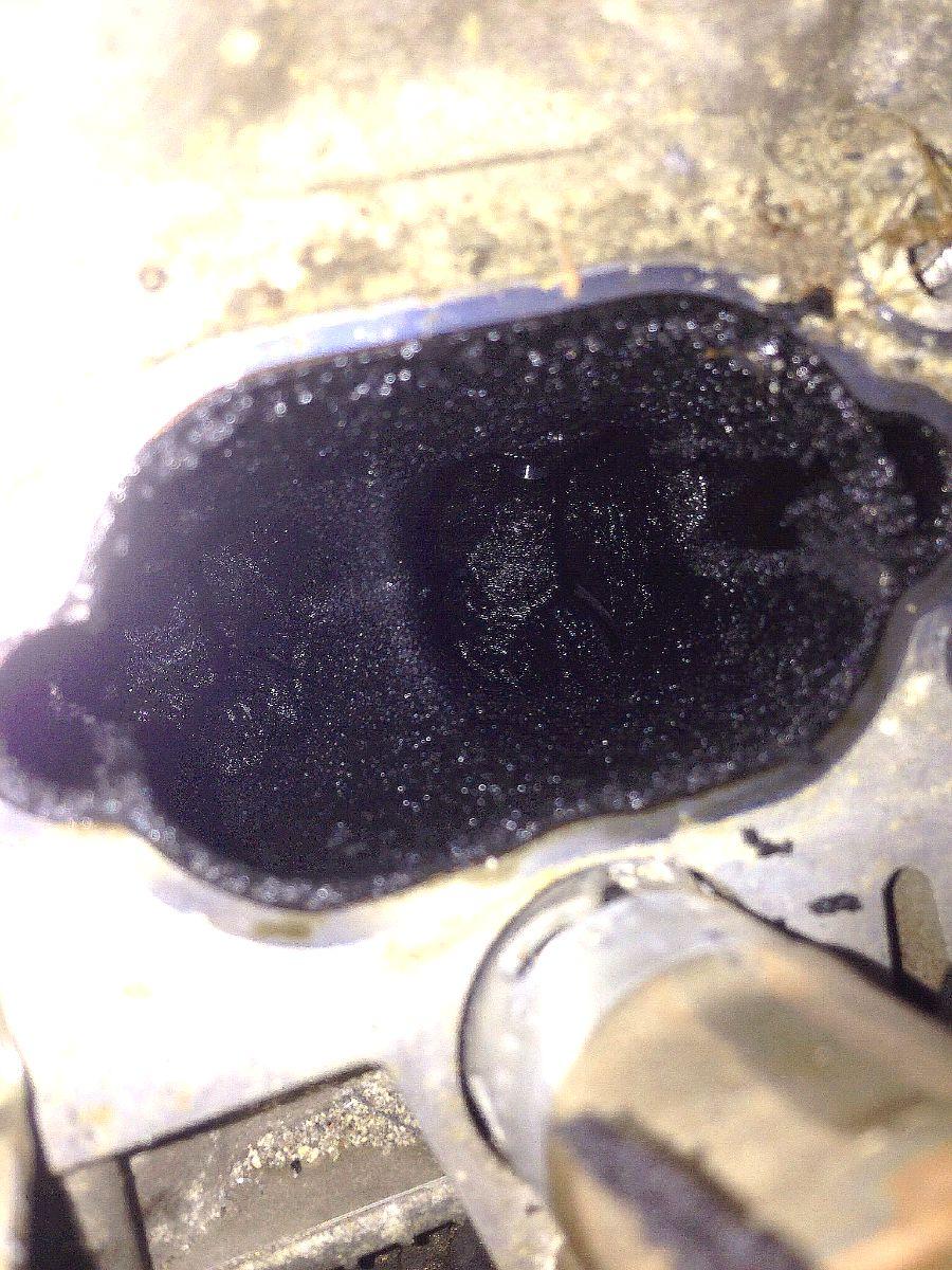

having spent several hours manually cleaning my rs4 ports i struggle to belive that any 'canned' spray in item will have much affect. i tested 3 ports, one with brake cleaner, one with petrol and one with neat track wash, all required scraping and scrubbing several times over to get clean.
i just don't think any liquid can penetrate the baked on sludge / carbon enough to dissolve it, i could be wrong but that's my impression, i'll be doing my 2.0T next week with RFD  :happy2:

Before
After
