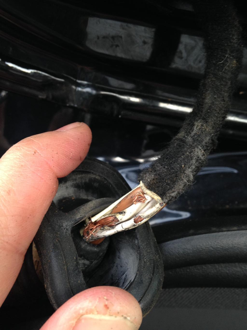

I have found that by squeezing the wiring that goes from the roof of the car to the boot, I can get the wiper working again. So I guess that means there must be a fault with the wiring somewhere? Is there any easy way to check?

It definately is the loom, I checked it last night and found this:
It's probably the reason why the high level brake light is dead too!
