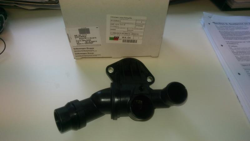

VW have supplied me with what I believe is the main thermostat for my 2005 manual GTI with AXX engine.
Does this look correct?

That looks correct. I found the front pipe the hardest its a hard line. There are two triple square screws holding it in place once you find these its easy.

Thank you!

No the alternator will have to come out. Not that difficult to get out just have a pry bar ready.
http://www.pelicanparts.com/techarticles/Volkswagen_Golf_GTI_Mk_V/31-WATER-Replacing_Your_Thermostat/31-WATER-Replacing_Your_Thermostat.htm

Thanks - yeah that's the guide I read. Wish it was an easy job!!!

About 45 quid,  not bad but less manufacturing than the dv for the same!

Going to get mine done aswell. Is this the most up to date part number and suitable for a 2008 car?
06F121111F
