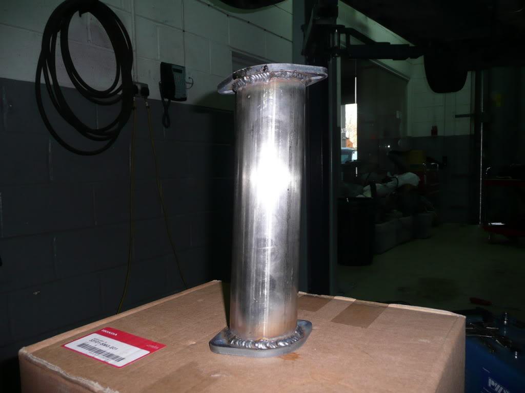

Decatting requires 6 x 3" diameter flanges
One piece of 3" diameter stainless pipe (2 feet/ 60cm is enough)

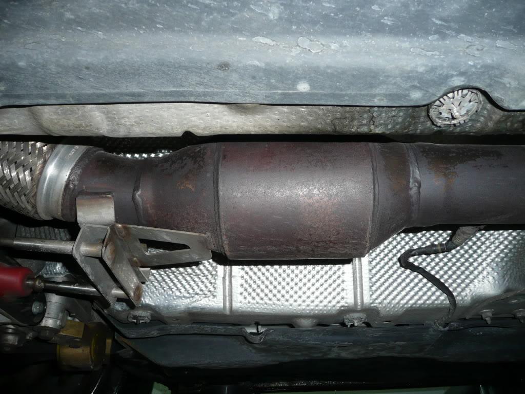

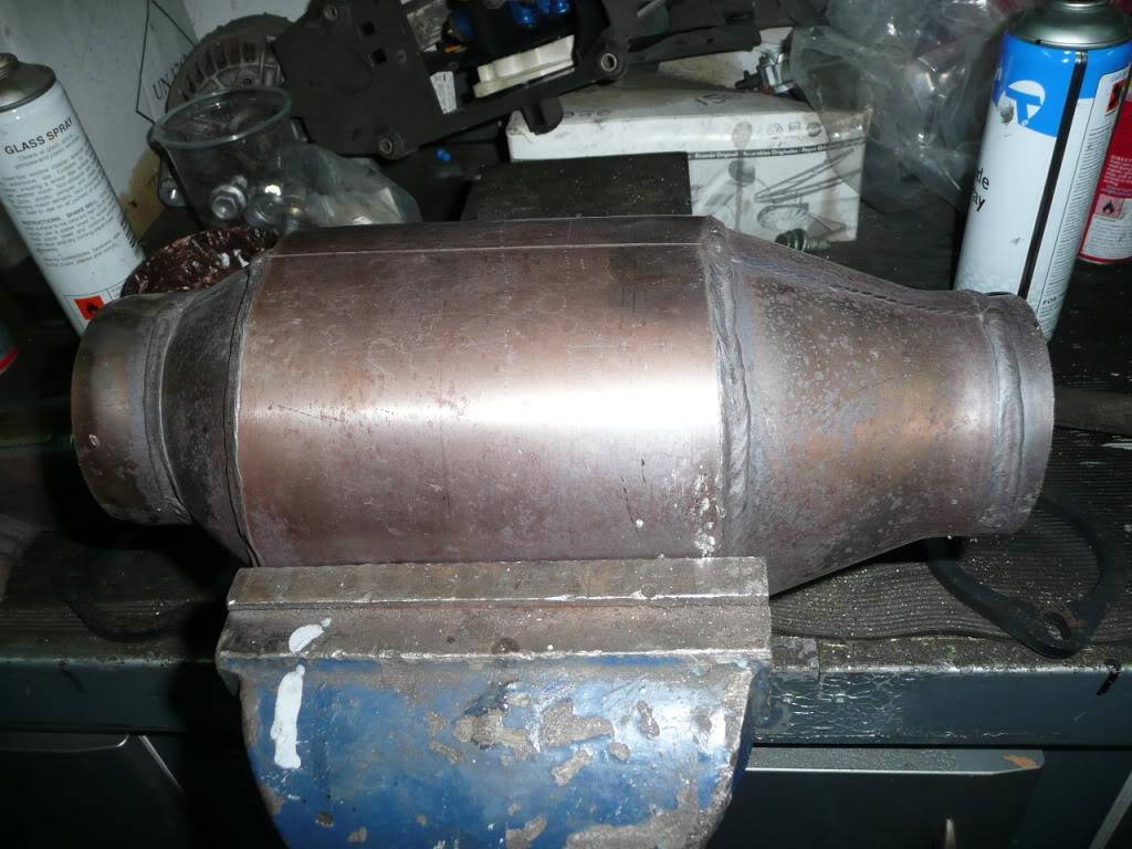

Now you know I'm going to say this, but things are never as simple as they seem. Initially the entire exhaust had to come off to get access to the cat to cut it up :scared:  Cutting a Milltek system up is never a clear decision and something you take a sharp intake of breath for just before the first cut is made.
Milltek before surgery.
After surgery

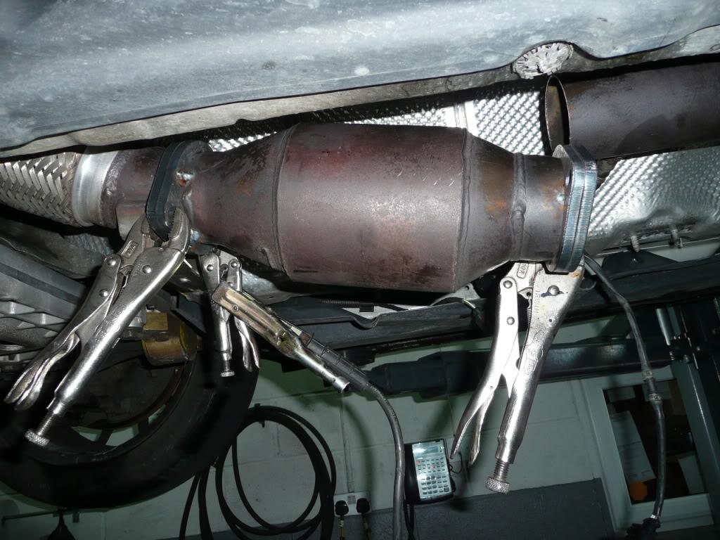

The next job was to replace the remaining parts of the exhaust back on to the car and start clamping up the cat section so that the flanges are mated up correctly. This is harder than it looks as the orientation of the flanges will dictate where the bolts will finally be for removal afterwards. Also, if you look at the "after surgery" pic you can clearly see that the two ends are offset. This means that the decat section will need to be angled correctly and yet still have the flanges in the same orientation as the cat section.
Clamping up
Whilst the flanges were clamped together, they were tack welded in place to ensure that they didn't move once located correctly. Once tacked, the entire exhaust system had to come off again and be fully seam welded on both the inside and outside to ensure that the welds would be strong and airtight. Many of Craig's fingerprints were sacrificed at this stage :laugh:

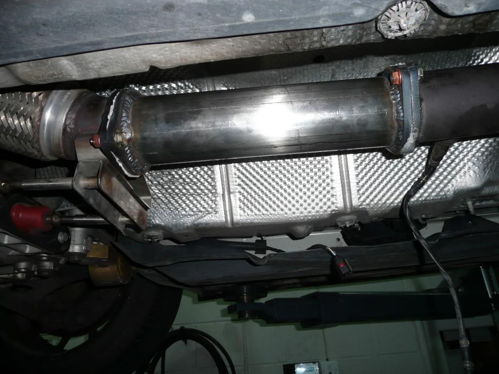

The system was then replaced and both the decat and cat sections tried out to see if the flanges were all aligned correctly.
The decat section had to be welded at an offset to ensure that the flanges mated up correctly. You can see in the pic below that the decat section is way off the vertical.

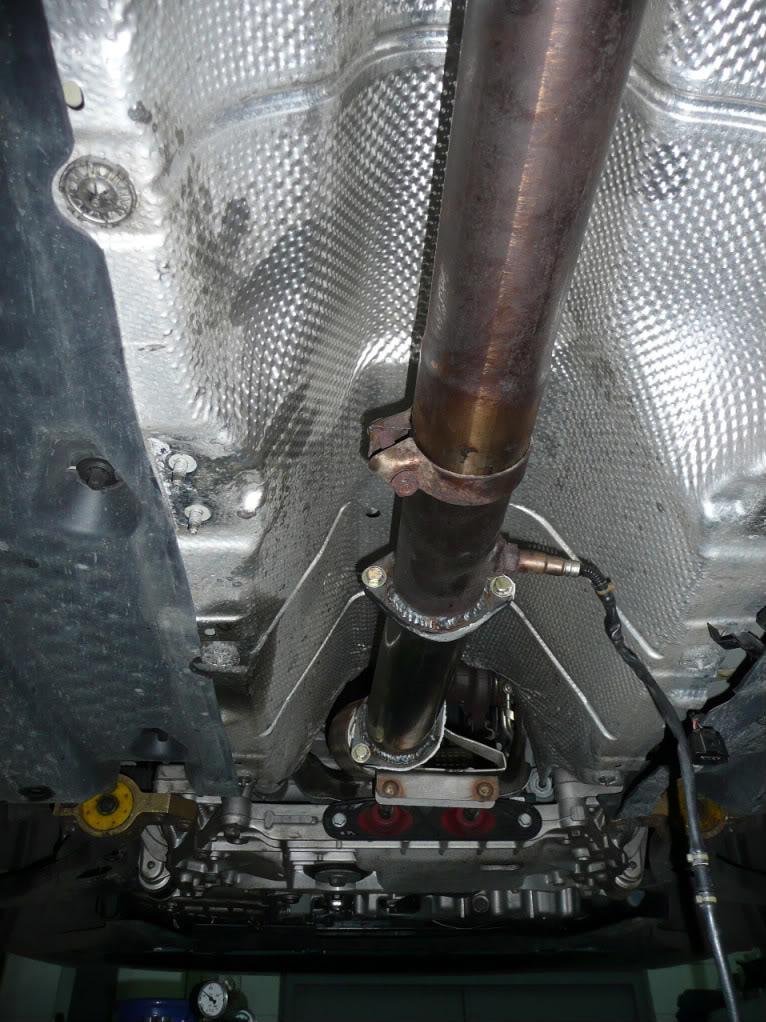

Finally, once all the parts had been welded and put back in place the decat section was silicon sealed and tested with the engine on for blowing. The pics below show the decat section in place with the sealant roughly put on to make the seal.
In the picture below you can also see the difference in the orientation of the flanges to ensure that my ham-fisted spanner access is in the best position possible.
