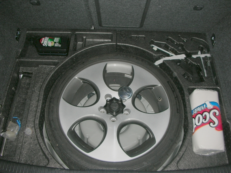

Re: Flat tyre and spacesavers
« Reply #4 on: September 29, 2015, 02:57:58 pm »
In the states they have a full size spare. They have foam inserts which fit in the boot.
« Reply #5 on: September 29, 2015, 03:03:41 pm »
Yup plan was to get a fullsized alloy but I then need the foam insert, which I don't have the part number for. I kept thinking I would do this and then haven't bothered all these years. Then it happens.
The spacesaver is too small to go over the front brakes on my car so it would only ever be fitted on the rear.
« Reply #6 on: September 29, 2015, 03:14:08 pm »
1K6-858-858-C   INSERT, RIGHT
1K6-858-857-B   INSERT, LEFT
