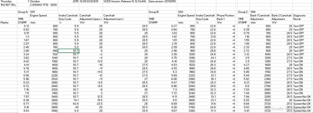

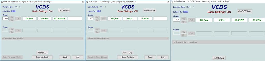

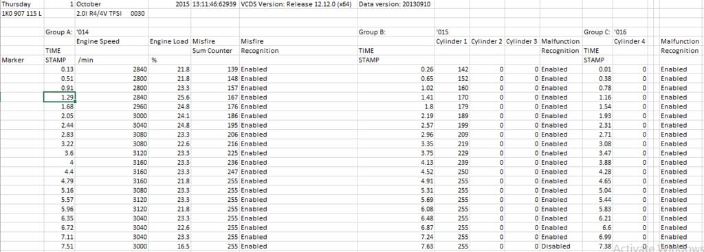

Screenshots attached of cylinder misfire and also the blocks that ran in the 90's
Explanation if you anyone cant see the screenshots
On 1st run where cylinder 2 was popping an error
Group 014 after a minute on idle started counting misfires in box 3
Group 015 after starting counting the misfires in box 2 for cylinder 2, others were fine
I swapped the cylinder 1 and 2 over and same results above but the misfires moved to cylinder 1 for Group 015
So for Group 90's it only found and ran 91,93 and 94 and results below
Group 91
Box 1 - Idle speed
Box 2 - 5.9%
Box 3 - 28.0*KW
Box 4 - 27.5*KW
Group 93
Box 1 - Idle speed
Box 2 - 22.6%
Box 3 - 4.0*KW
Box 4 - Blank
Group 94
Box 1 - Idle speed
Box 2 - 27.5*KW
Box 3 - TXT 000 235
Box 4 - Blank

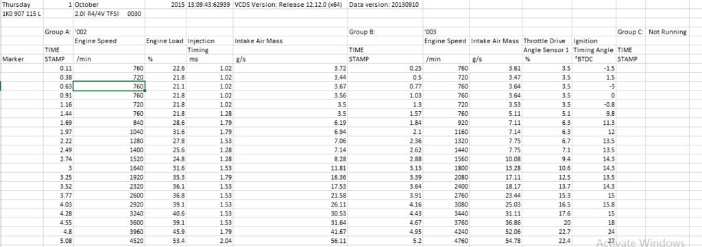

So sorted the software out as seems the code file was not installing properly so dropped one in and now works  :happy2:
Re-ran the measuring blocks correctly and got the below results
