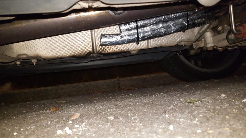

This is what i used, it is heavy and not very flexible though, but it is suitable for oil and is strong enough to not kink. The connectors just push on - tight fit so didn't need a clips. I'll find a pic i took of my trial fit (still had plastic cable ties while i waited for my order of metal ones to arrive)

« Reply #10 on: October 15, 2015, 09:13:57 am »

Cheers Dan, so you used a couple of pieces of pipe and joined them together then...  :happy2:
Good idea with the silver heat protective wrap !

Yeah i originally bought pipe, ran it to the rear of the gearbox area, experienced smoke/smells etc. Decided i didn't want to buy all new pipe and waste what i had, so bought another metre, two joiners, and extended each one half a metre down in to the tunnel and secured it to the side of the heatshield
To be honest i doubt the heat wrap is needed unless you get the car silly hot and sit there idling in traffic in the summer, but i thought better safe than sorry. It's been fine since the middle of August anyway
