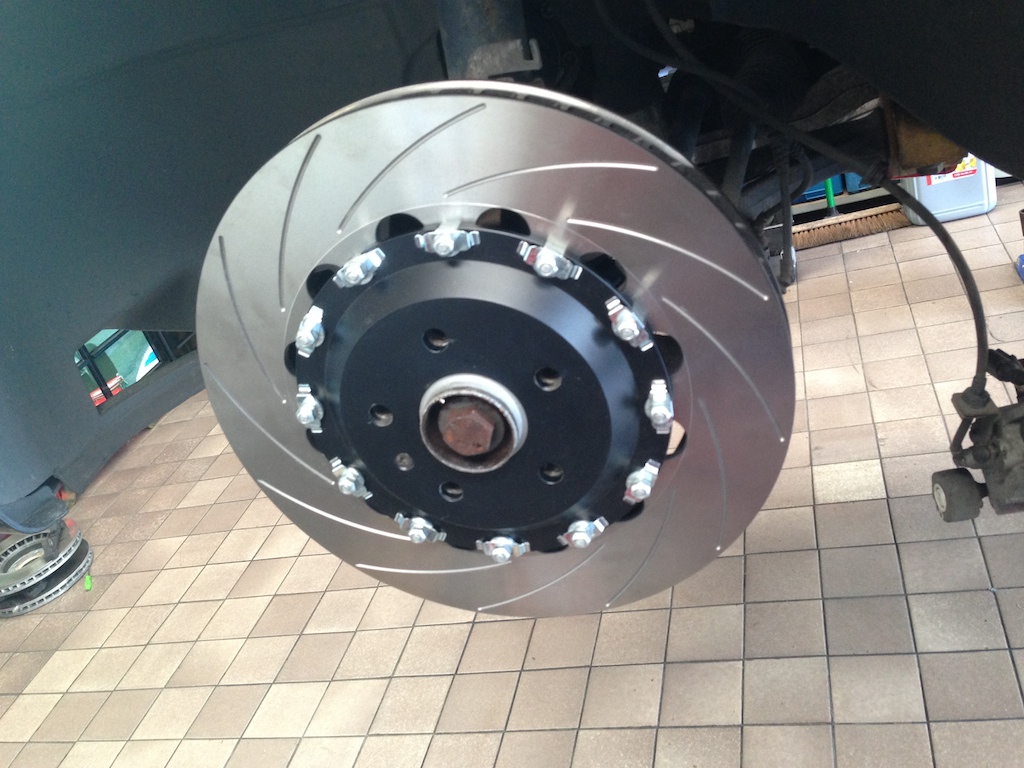

Rich, is the spacer part of the bell, or on top of it? I don't understand why two different metals would be butted up against each other in the first instance, they have conflicting properties when subjected to heat. If the latter, then it's ok.
To also note, as in the first post by the OP. J hooked, Slotted, Grooved or whatever pattern you like don't stop pads sh*tting themselves all over the disc and causing judder.
Sideways yo!
Re: Pagid RS4-2s pad build up / vibration
« Reply #81 on: January 09, 2016, 08:49:09 pm »
Without spacer
Better pic to show the spacer (ignore caliper... they were sh*te so came off)
As mentioned before... braking from 60-0, causes no vibration and the stop the car incredibly quickly. Its just when over 90-100 (which to be honest isnt very often)

Hi Rich can i ask what make and size of spacer thanks for reply
« Reply #83 on: January 09, 2016, 10:38:54 pm »
H&R 8mm Hubcentric

They wont have warped... 2 piece discs. Jay is on single piece discs, so as we have the exact same issue I'm 10000000% sure it defo the pads/pad deposit.
