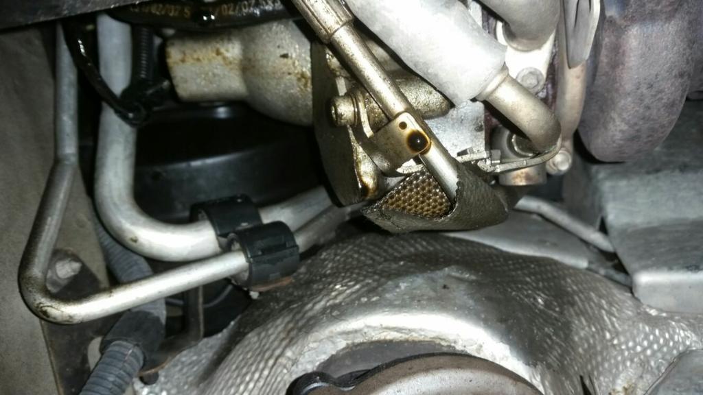

ko4 turbo oil leak
« on: November 03, 2015, 11:14:08 pm »
As above could anyone help or know where this will be coming from
Might be from rocker cover gasket or rear pcv valve have you changed your front pcv recently ?
No m8 I've not I was told by the garage it was fine when I was asking about it...... the valve that is not the oil

« Reply #5 on: November 05, 2015, 04:27:41 pm »
May worth sticking your hand down the back of the engine and feel just under the rear pcv valve if it's leaking out of there mine was
Will do cheers m8 fid you change your own

« Reply #7 on: November 05, 2015, 09:13:07 pm »
Yeah I changed mine myself simple job if your changing yours make sure you get one with the check valve in it I'm guessing you've got a edition 30 ?
Yer that's right m8 it's a fart on or easy job
