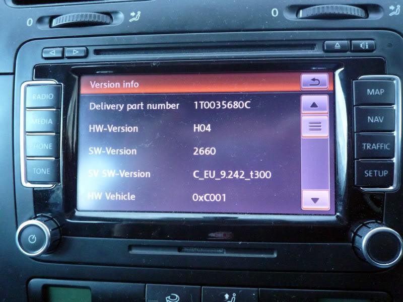

The only thing stopping me from upgrading mine is that its HW03 and uncertainty if the Skoda bluetooth will continue to function
Here's my originaly A unit at the moment with 2660 fw :happy2:
also my skoda bluetooth kit works just fine on the rns and the highline
scott.

Offline golfman
  • -Given: 17
  • Posts: 1088
Re: RNS510 Firmware Upgrade Dealer/Supplier
« Reply #53 on: January 03, 2010, 03:28:28 pm »
Scott that front needs a good polish :grin:
Darren
Yes i know darren i couldnt be bothered to clean it's too cold outside :grin: :grin:

This is my unit that Ive had for poss 3-4 months now after having to give my A-version to a customer.
Notice the Ho2 h/w but works with all SDHC cards,
Im using Pimp my Nav software to do the mapping discs now so it gives me this extended disc number :confused:
Darren

Offline pazz
  • Posts: 394
« Reply #56 on: January 03, 2010, 04:17:49 pm »
This is good reading!
Here's mine (crappy iPhone pic)
H03 on the go :(

Carl mine is a factory unit out of a mates car only thing I didn't get was the code card but he asked vw hudds for the code and then passed it on to me.
Darren
