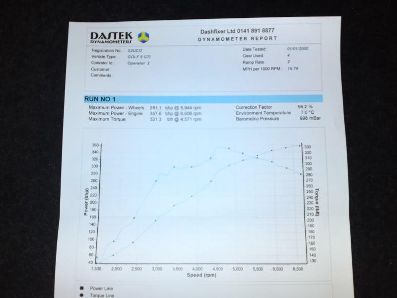

harry over on briskoda dyno'd his k04 converted vRS the other day @ awesome-GTI RR day, and made 348hp 358Ibft and also suffered misfires for the run.
his car made something like 324hp 310Ibft on jkms rollers straight after installation

Misfires are not what you want on a dyno run, most likely cause being a poor spark or timing issues especialy if the car is running a hpfp, it will highlight any weakness in spark plugs or coils. Idealiy after having things like a remap, intake, downpipe fitted ect.... you should have your readiness code reset by your main dealer, or sum1 who knows what there doing using VAGcom, this is a procedure that adapts all your engine management electronics such as throttle angle, coolant temp, air mass, manifold pressure and lamda readings. over the course of afew weeks your cars ECU will adapt to the modifications made so you may find this unnessasary, but i would not put to much faith in dyno readings takin directly after a remap, it makes sense that his hp increased and leveled out as the time passed :happy2:

Welldone mate cracking power :happy2: :driver:

still to get a cat back exhaust and intercooler so a reckon that should get it to the 360bhp mark.
k04, intake, downpipe, kmd hpfp, app dv spacer, revo stage 3, ed 30 rear lights, coilovers custom 3" downpipe. to do - s3 ic, ed30 splitters and miltek catback.

357...good stuff! looking great too¬

Jeez! They are good figures! I bet it's an animal  :laugh:

Very good results, i liked that dashfixer when i was there last year. Are you running standard clutch? Stevie.

cheerz guys! :happy2:
it does pull pretty well, looking forward to the dry weather for some more traction! :driver:
its a good setup theyve got a dashfixer and yeah still running a standard clutch, it seems to be ok, never had it slip yet.
what did u go to dashfixer in and how did it go stevie??

357bhp is bloody awesome. Love the car, the badge with red inners is something I'm not a fan of.

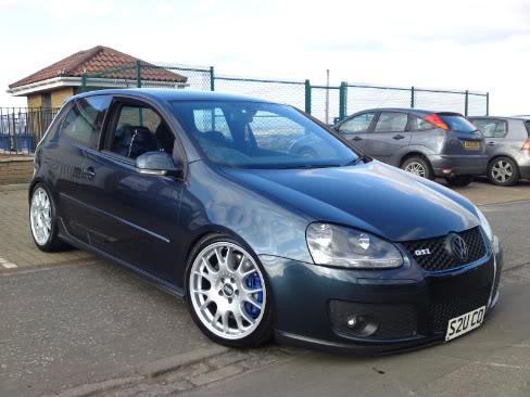

got me some more pics with the coilies and ed 30 rear lights on  :smiley:
fitted some s3 front wishbone arms and bushes.
swapped the reverse reflector from old lights, decided a fog light wasnt that important!  :signLOL:
s3 brakes on next week!!  :smiley:

 :congrats:
Offline Toast
  • Posts: 779
Re: big stu's gti
« Reply #44 on: February 14, 2010, 04:06:39 pm »
Looking Good Stu :happy2:
