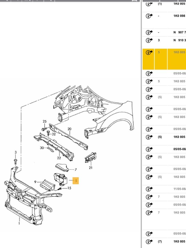

 :surprised: is the bumper support/crash bar missing??? or is the other part above that missing???
Offline Vwgtiking
  • Posts: 807
Re: Bumper removal
« Reply #16 on: December 22, 2015, 07:28:23 pm »
The crash bar is there it's the bit above it which also goes under headlights
Offline TAPPY
  • -Receive: 56
  • Posts: 485
  • My Ride: http://www.mk5golfgti.co.uk/forum/index.php/topic,103290.0.html
Re: Bumper removal
« Reply #17 on: December 22, 2015, 07:31:18 pm »
That bit is part of the front panel and you should have a bracket under each headlight
Offline r5gtt
  • -Given: 342
  • -Receive: 334
  • Posts: 5586
Re: Bumper removal
« Reply #18 on: December 22, 2015, 07:34:44 pm »
That's the lock and carrier @TAPPY looks like the parts you've described is missing.
From looking closer at your car picture Vwgtiking, the air con rad looks curved inward so maybe a crash damaged vehicle?.

It's the part that's on the slam front panel where the rads fit  :happy2:

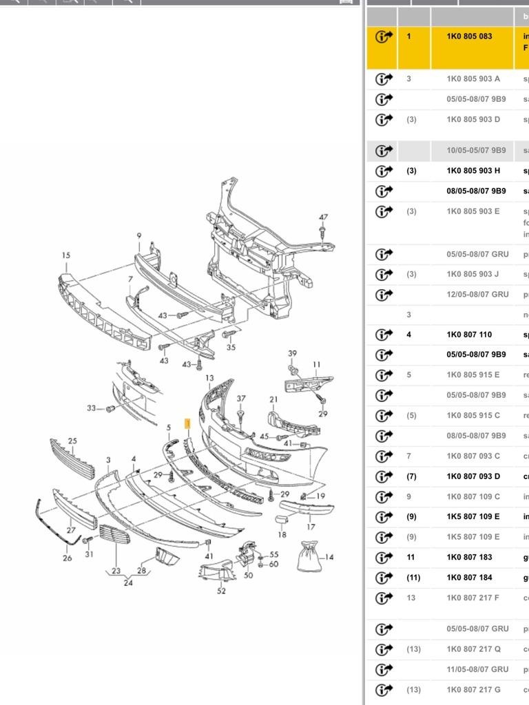

9 is the crash bar. I think I need 15??
Offline r5gtt
  • -Given: 342
  • -Receive: 334
  • Posts: 5586
Re: Bumper removal
« Reply #23 on: December 22, 2015, 08:49:48 pm »
15 is the foam sponge.
Offline TAPPY
  • -Receive: 56
  • Posts: 485
Re: Bumper removal
« Reply #24 on: December 22, 2015, 09:05:39 pm »
Gaea 15 is the foam impact damper
From what your saying you need number 1 (first picture)

Call me  :stupid: but the 2 screws your having difficulty in finding a mounting point are fixed into this point with the dark shaded circle/squares on the plastic bar below the bonnet lock. This is where the torx screws fit and from what I remember the bumper rests.
« Last Edit: December 22, 2015, 10:18:30 pm by r5gtt »
Offline Vwgtiking
  • Posts: 807
Re: Bumper removal
« Reply #29 on: December 22, 2015, 10:22:06 pm »
I will remove grill tomorrow as that takes 2 secs and try and get pics.
Found this pic which shows the 2 screws i don't have nor anything to screw into.
