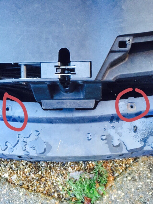

Forgot also ask. I don't have these 2 bolts here as pictured but there is nothing to secure it underneath. What is it suppose to bolt too?

« Reply #6 on: December 22, 2015, 05:49:31 pm »
There are meant to be fasteners where the bumper meets the panel but yours look like they're missing and someone's bodged it into the panel itself.

« Reply #7 on: December 22, 2015, 06:03:31 pm »
Do you know what they look like or know part number or their name? There is nothing under these holes. Apart from crash bar which is about 3in away from the bumper.

« Reply #8 on: December 22, 2015, 06:10:53 pm »
They are nut inserts you will need a tool to put them in

« Reply #11 on: December 22, 2015, 06:38:38 pm »
In fact I just noticed it runs all the way across including under the headlights. I think I am missing this all together!! Ffs.

« Reply #12 on: December 22, 2015, 06:57:38 pm »
oh crap that's some kind of support bar to bolt the bumper onto by the looks of it.
I'll have a look when I get home.

« Reply #14 on: December 22, 2015, 07:21:03 pm »
That's the crash bar. The bumper doesn't bolt to it the bumper bolts to the plastic part above the bar
