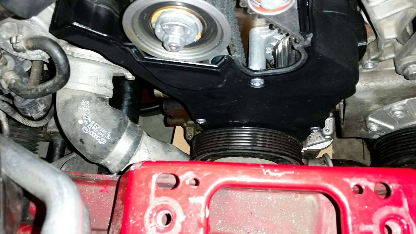

« Reply #9 on: January 18, 2016, 08:49:34 am »
The one piece has a window like this.
The two piece has no window and splits just below the tensioner.
