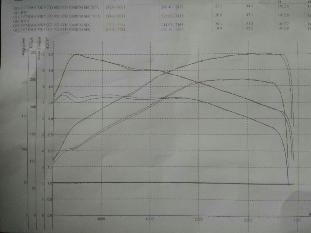

Which 3" DP did you use and do you have before and after dyno plots?  Not doubting you, I just want some data to work from as the decent pipes are expensive.
Powervalve. 200 cell cat.
Currently running that on Stage 1 R-Tech but I'm going down to see Niki to tweak the map in a couple of weeks.
Will get you an 'after' dyno once that's done, and there is a 'before' dyno knocking about somewhere... Bear with me.
Offline AJP
  • -Given: 392
  • -Receive: 317
  • Posts: 3212
Re: 3.5" downpipe
« Reply #9 on: February 11, 2016, 06:21:46 pm »
Here you go.
That's Stage 1, stock hardware.
Remind me in a fortnight and I'll get you a pic of the next graph. This should show Stage 1 map + exhaust as well as Stage 2 map + exhaust. So you should be able to get the info you need from all the graphs.
Hope that's helpful mate
