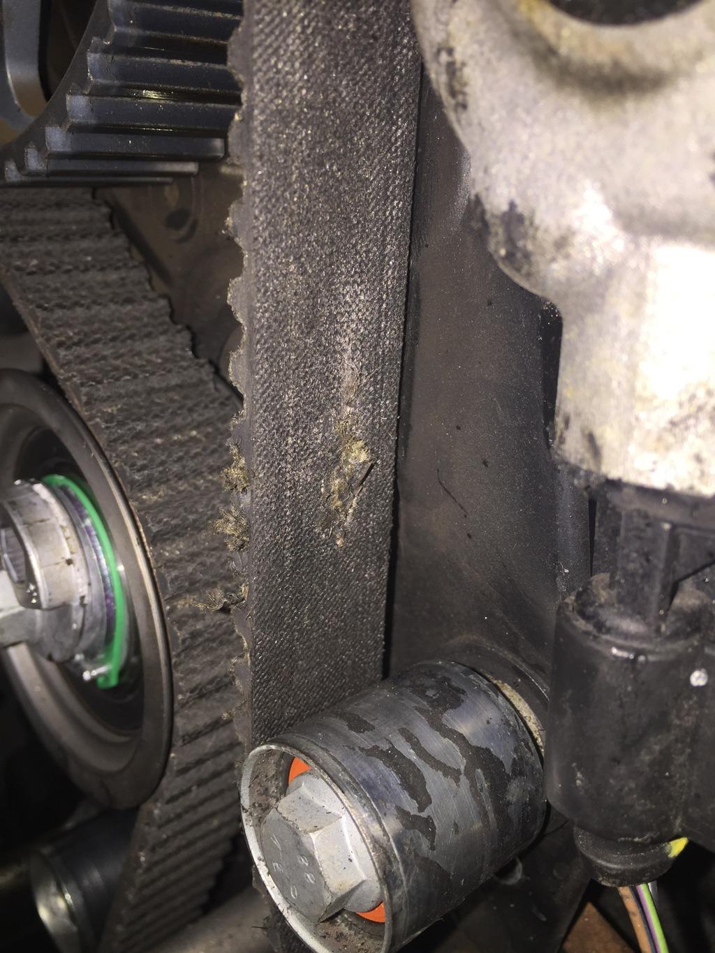

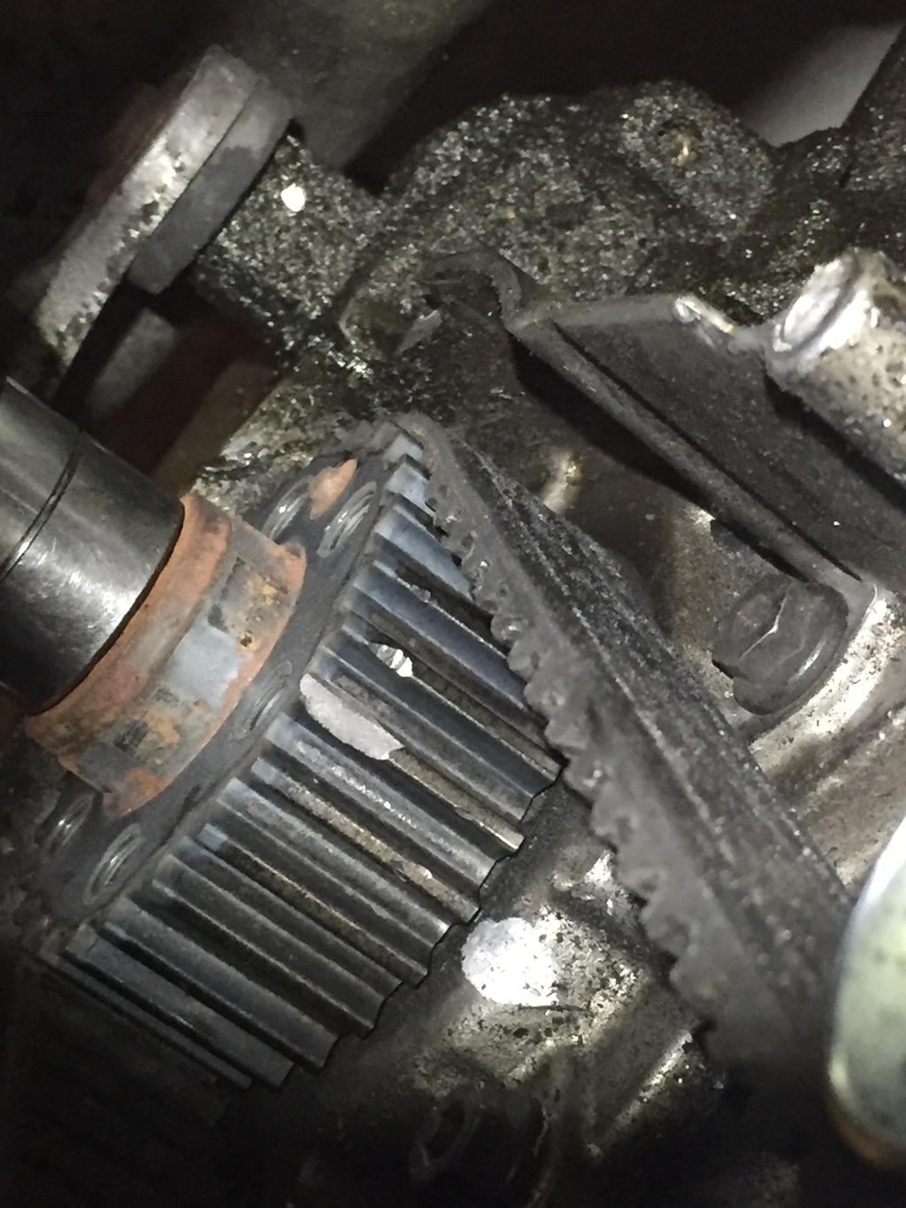

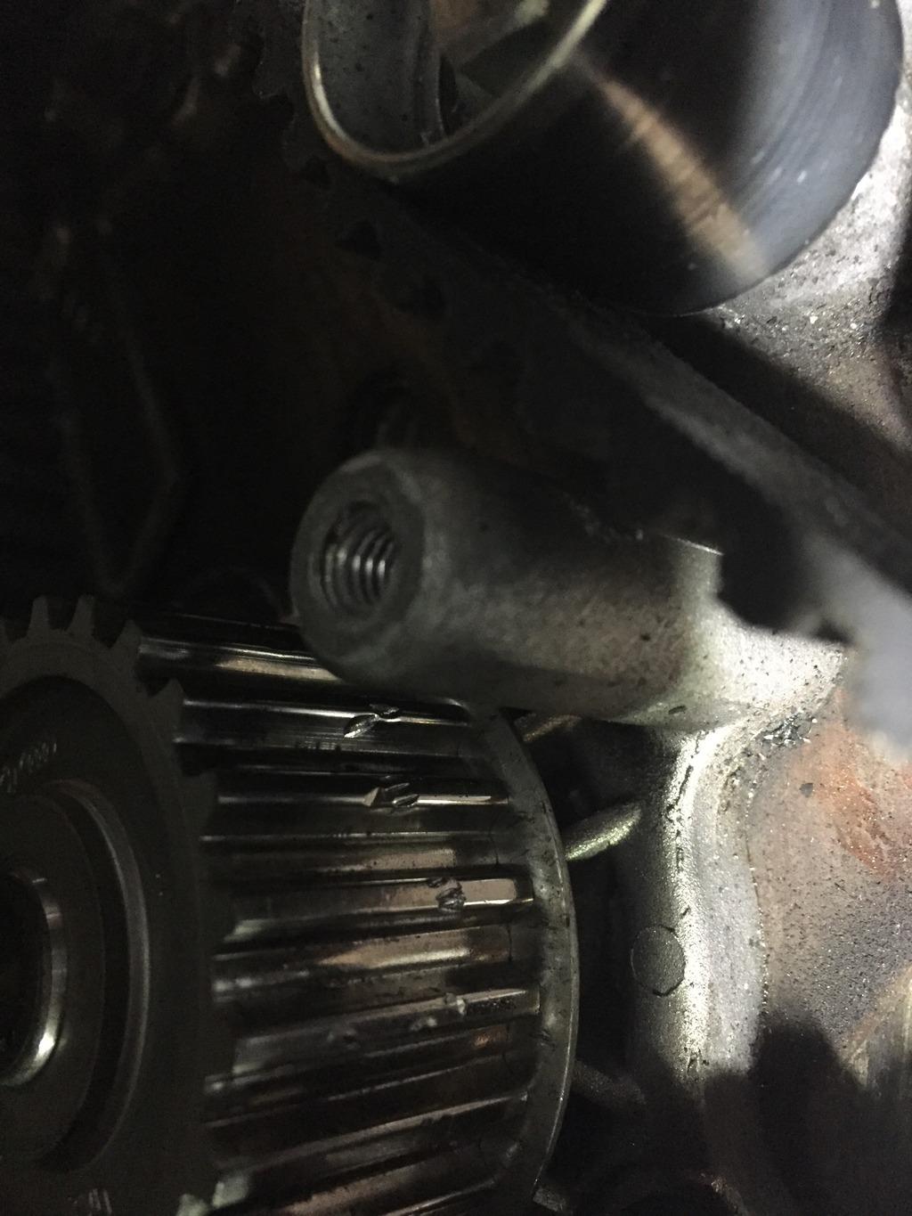

After an inspection i had an convo with Mark with pictures of exactly what had happened.
A bolt had come free and got wedged in the plastic trim at the top of the pulley and was rubbing on the belt. Lady luck was on my side it seems. Seems like an almost impossible stroke of luck that it got wedge where it did without occurring catastrophic engine fail.
Mark recommended a cambelt change just to be sure that the bolt hadnt caused any damage to the belt.
Just after lunch yesterday the tech at Awesome started the fix, a flurry of txts and picture msgs arrived from Mark.
At that point realisation of how the cambelt didnt snap and how im not now looking at a new engine or rebuild at this point is beyond me.
Essentially what has happened is the bolt had come loose. Bounced around the near the cambelt and pulleys and then got wedged in the plastic trim. Damage was some how limited to the cambelt, 2 pulleys which had missing teeth and gouges in and finally the water pump. I picked it up 3 hours later and is proudly sat cleaned and sparkling outside my house. Ive had some really challenging times recently but it seems that lady luck had her arse planted on my nappa leather on Thursday night.
