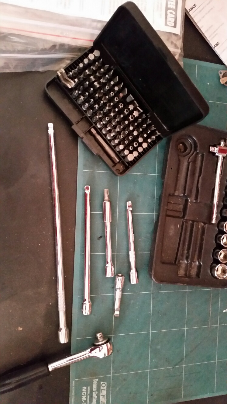

get something like this with a 1/4 inch ratchet adaptor.
http://www.ebay.co.uk/itm/Halfords-Advanced-30-Bit-set-C-W-1-4-Drive-Handle-Adaptor-Bit-New-/162006057609?hash=item25b8504289:g:oEwAAMXQyY1TWBp8
Here is mine with some wobble extensions etc.
05 | Tornado Red | DSG

Ive already got something like that daz, problem being the socket for the bit is too thick too fit through.
My 1/4 racteht set is good its got loads of entensions etc but it all uses the socket thats too thick
