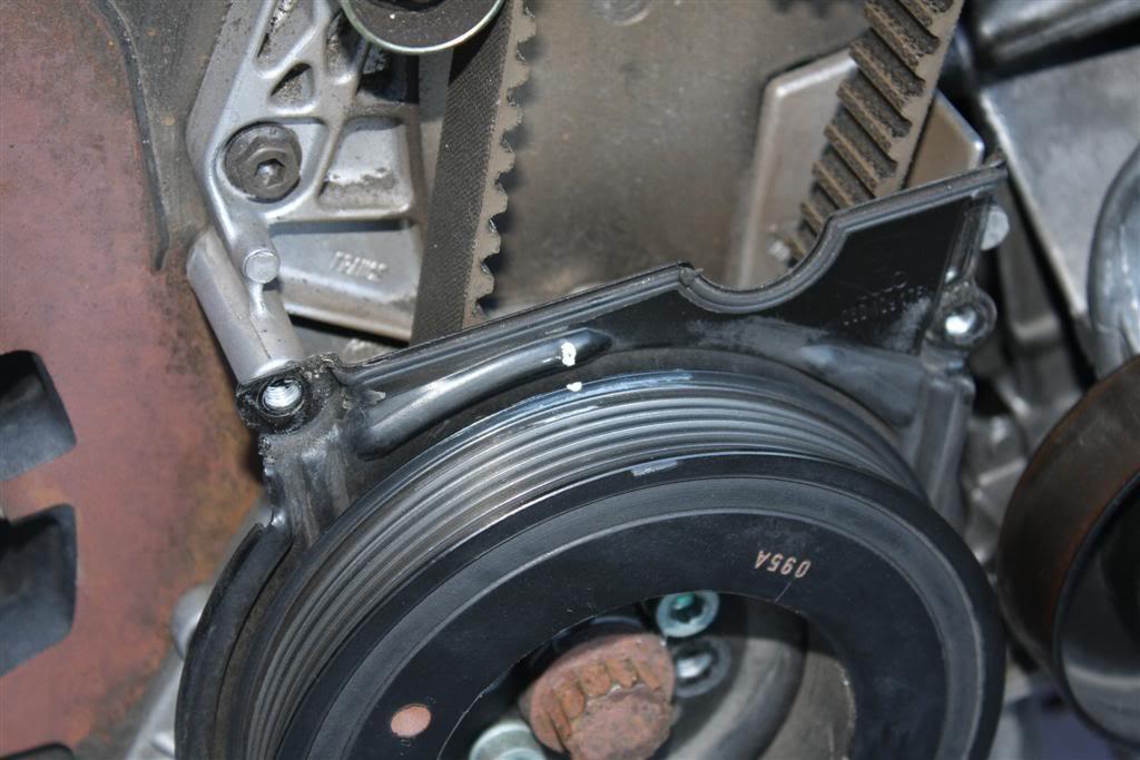

You turn the crank to get it to TDC.
I think you have the old style cam belt cover with the window so remove the window.
Find the indent in the black metal plate behind the crank pulley add some tipex to it and the indent in the pulley like pic below.
Turn the crank until they line up.

My plan tonight is to rotate the crankshaft to TDC using marks. Remove cambelt cover, check if it is now at TDC by checking notches on cambelt pulley line up. Remove valve cover. Remove cam cover. Are there any timing indications at this end of the head? and finally fit locking tool to ensure that timing is correct. Check cam chain for play, damage, wear etc.
