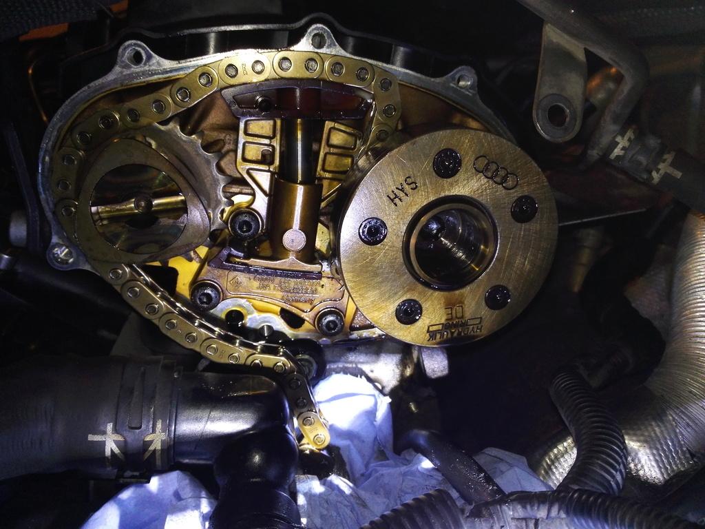

Chain snapped.

Chain snapped.
Nice.  At least we know what happened now.

Firstly have you located the broken bits off the chain before you get distracted?
What's your game plan now Pesky?

Ive made a video to explain everything as it will be easier to show what the situation is, but its taking an,age to upload.
 In the cover I found one part of the broken chain, couldn't find the other bit so its lost somewhere. I also found bits of the broken tensioner.
The tensioner had a few bits snapped off and was completely loose, I dont know if you can see in the photo but its lopsided. When you push it down oil seeps out around the seal, so this might explain the oil oressure message.
When I tried turning the inlet cam it would turn slowly, and then suddenly "snap" round with a load of force. Doesnt feel right at all.
Yeah dazza youre right it was in my do to list  :sad1: should have trusted my instinct and done it asap.

Judging by the state of the tensioner, can anyone tell me if that would explain the oil pressure message on the dash?
What do people make of the turning action of the inlet camshaft?
