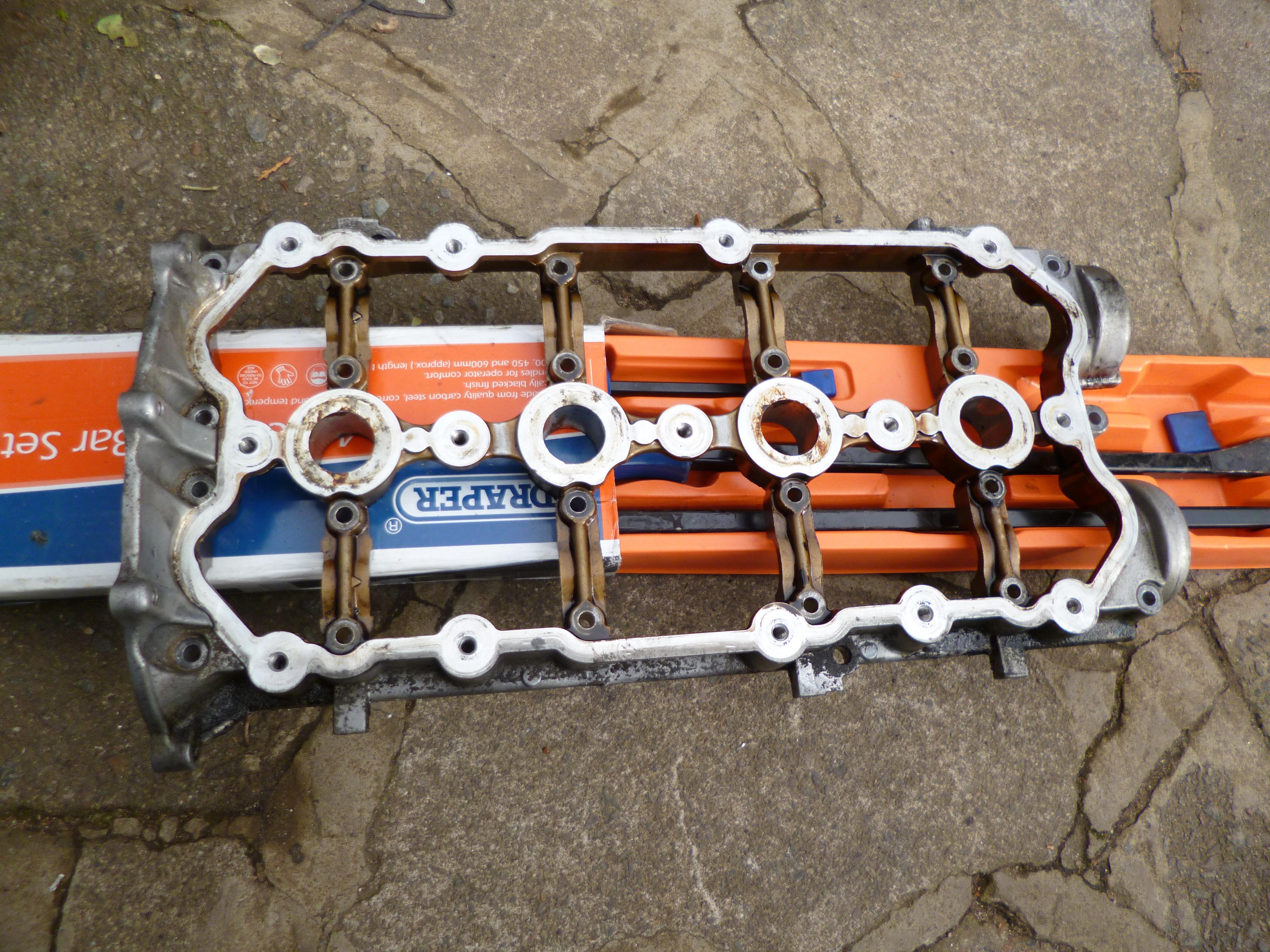

Cam girdle is plate the rocker cover bolts to, it's a separate piece to the head casting.  Undo that and the cams will lift right out.

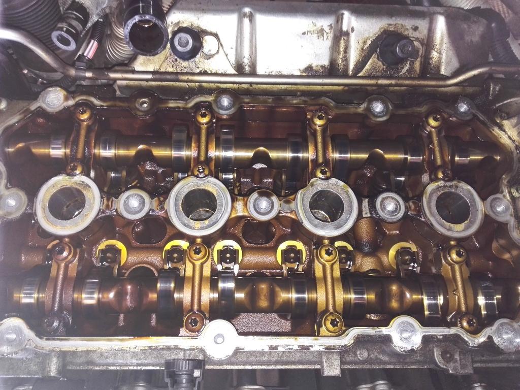

Can you get me a photo of the head with the cam cover removed?
Normally you mark the cam caps (if they're not already marked) so that you know where each one went and their orientation and remove them carefully. Once they are removed you should be able to lift the cams out of the head. Being a tfsi engine that I'm not familiar with you may have to remove a few other bits and pieces.

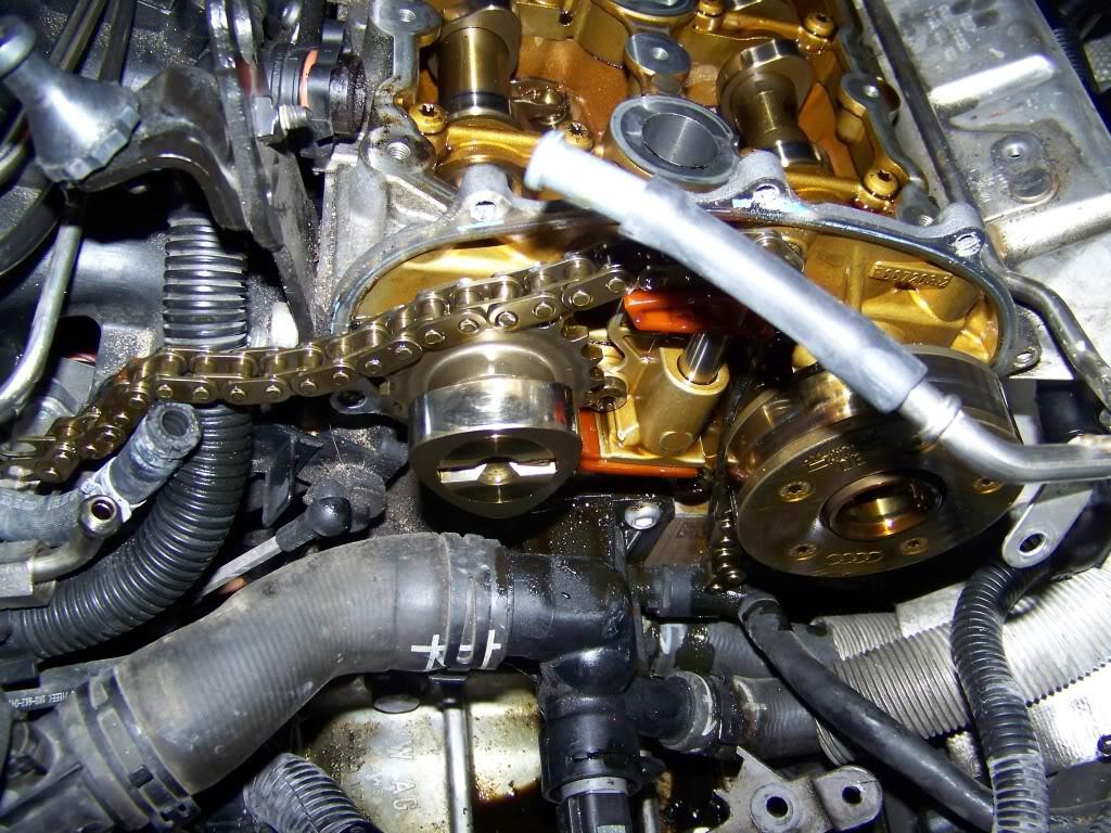

« Reply #355 on: March 22, 2016, 02:26:03 pm »
In this pic you can see some torx head screws near the cam lobes and if you look ever so carefully, a thin join line in the chain cover section.   Undo all of those screws and that whole chunk comes off.
Like so.....

As per my post before yours, the bearing caps are part of the cam 'girdle'.  Easier / quicker assembly at the factory and all that.
