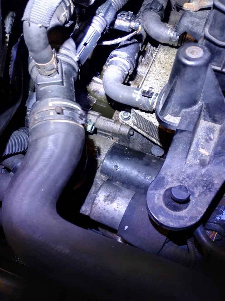

Heres the oil pool on the gearbox. Prettt sure its coming from directyl above as the wiring loom is covered and there isnt oil beneath the cam chain cover. Hopefully it isn't coming from the metal plate that attached to the vacuum pump. I had a go at taking the vacuum pump off to look for the tensioner plastic. Struggled to get it off completely, but I will do this time. I've also just remembered that I think it was missing one of its three bolts  :surprised: I bet its this causing the leak. I guess I need a new bolt as well.
Hoepfully the vaccum pump gasket will solve this.
I don't need to remove the valve cover to remove just the cam chain cover do I? Just HPFP...
