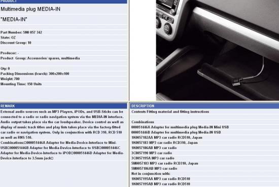

« Reply #8 on: January 09, 2010, 10:58:03 am »
Why don't you just buy the Volkswagen MDI kit. Cheaper and works perfectly. I have it fitted with my RNS510.
The MDI part no. is 5N0 057 342.
The ipod cable is 000 051 446C.
You can also get other cables with USB connectors for other MP3 players.

« Reply #13 on: January 11, 2010, 08:15:29 pm »
Not the largest of pictures
Headunit displays Artist, Song Name & Album
Highline shows Artist and Song Name (only the first few characters and doesn't scroll)
You have full access to play any mp3 from your ipod (no video) - songs, playlists, albums, artists, using the HU to navigate (sorry) around your ipod or usb stick
