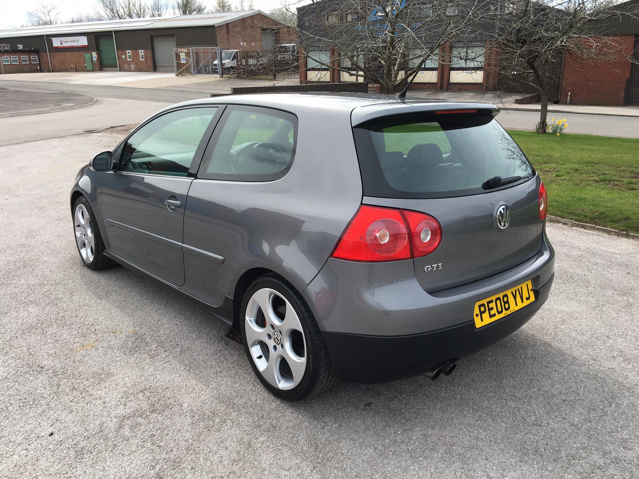

Well after getting a company vehicle last year my daily became unused and thought I better get me a toy to play with.

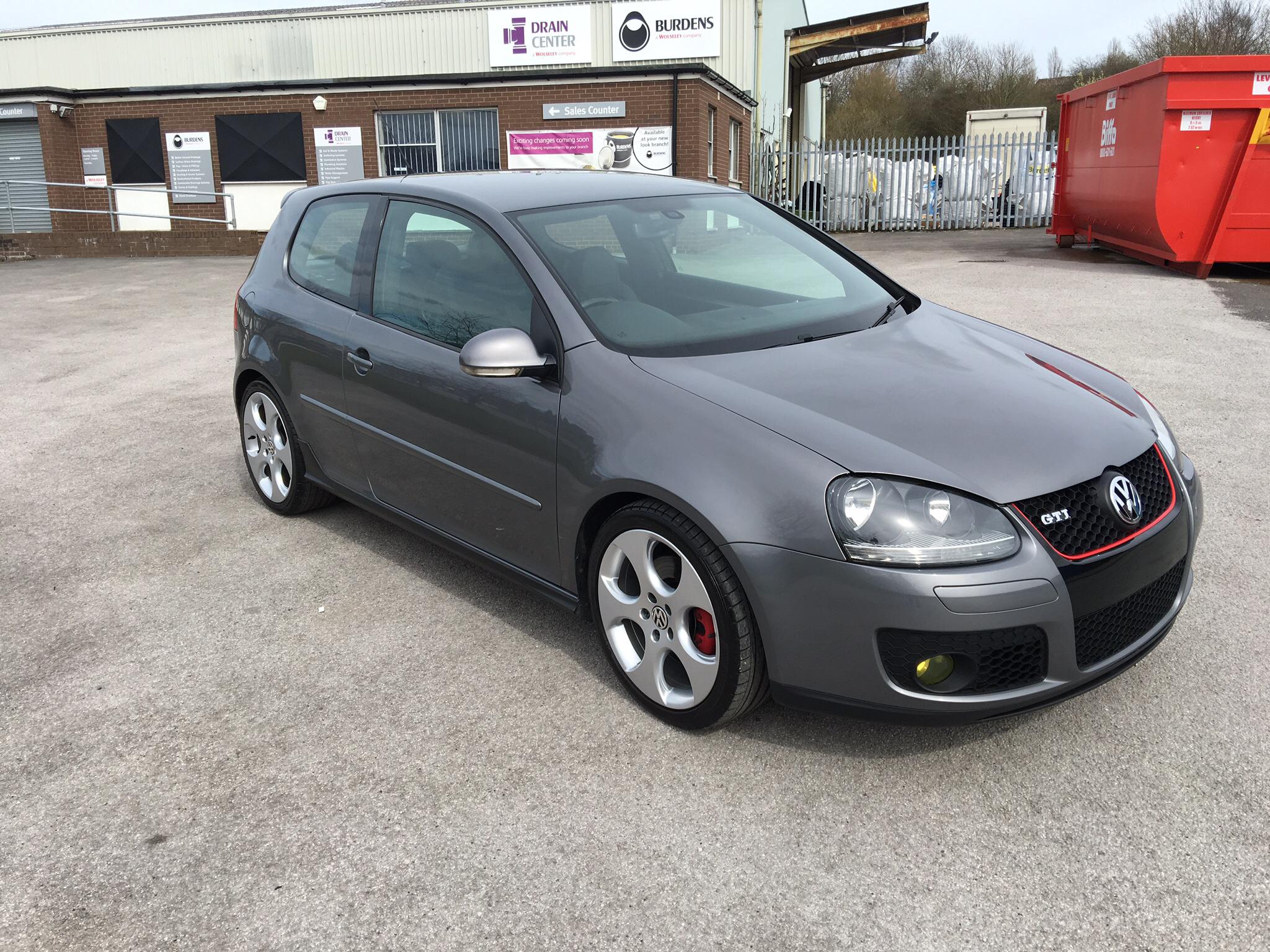

Roll up this little unloved GTI. One owner from new and 80k miles. Interior is ok but leather has suffered a little and some interior trim. Exterior wheels have just been sprayed but bodywork needs a lot of work but looks ok from 5m away but managed to get it for 6k.

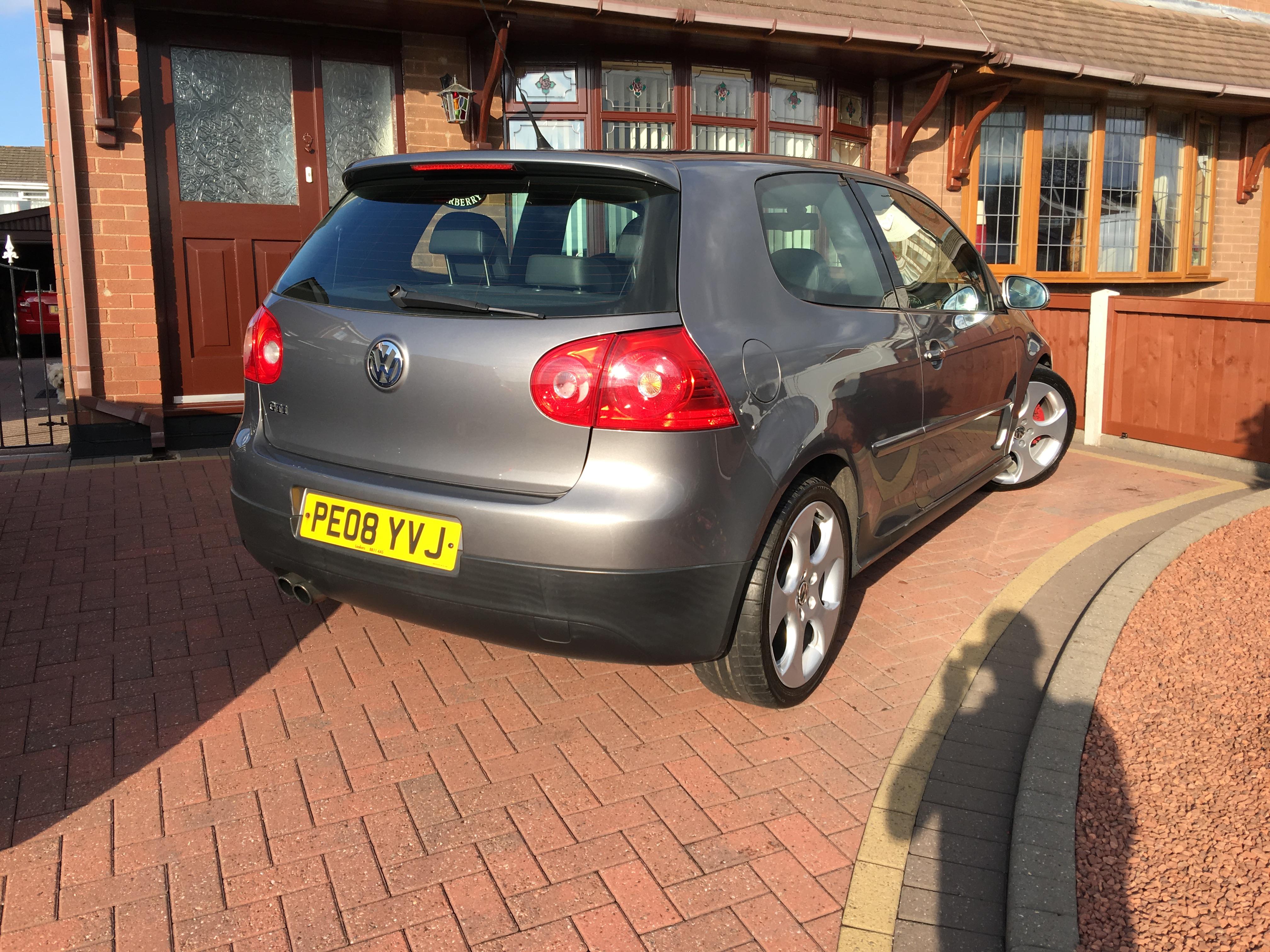

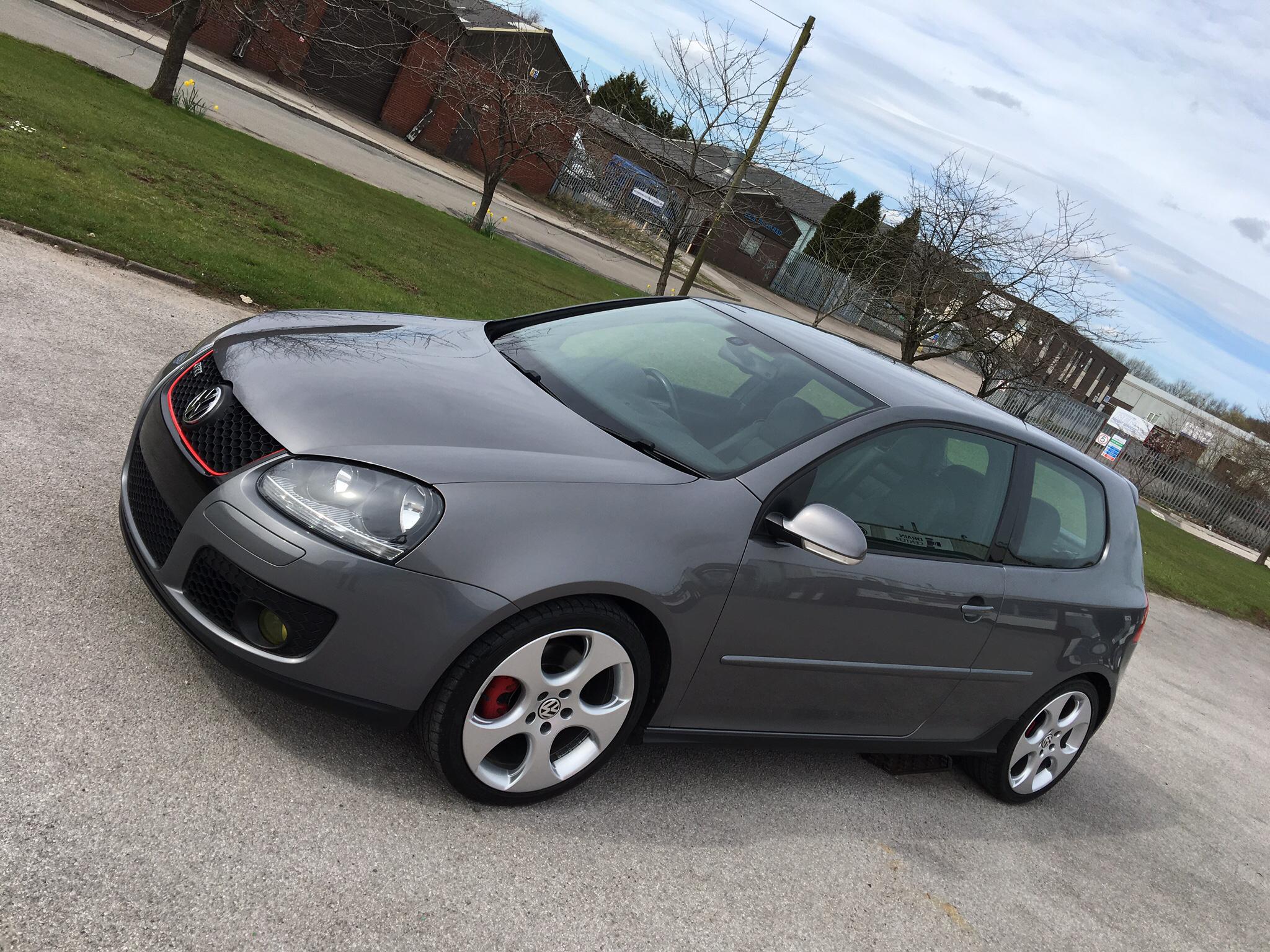

Pic of car as I got it tonight.
Initial jobs to do.
Rust on front wings is only just starting but also a little on the drivers sill just under the wing.
Dents in drivers door.
Damage to passenger rear arch plus dent.
Rust on boot lid under glass.
Couple of rusty stone chips need treating.
Bit of mould in the interior as not moved since September.
Look at getting leather on drivers seat sorted.
Crack in passenger side rear quarter card.
Sunglasses holder does not shut as clip broken.
Rear bumper damaged and paint missing.
Paint needs a good going over as a number of scratches and moss.

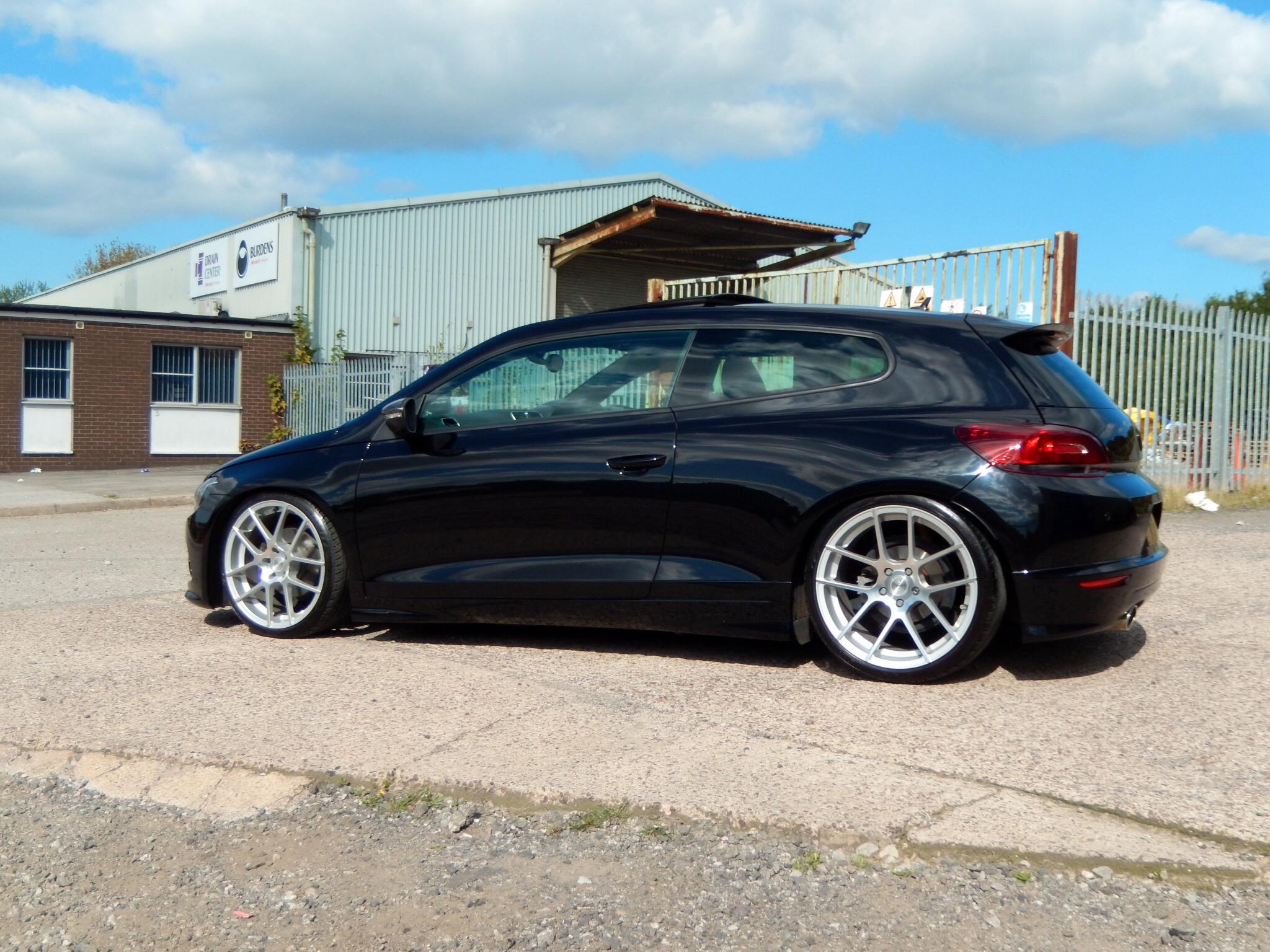

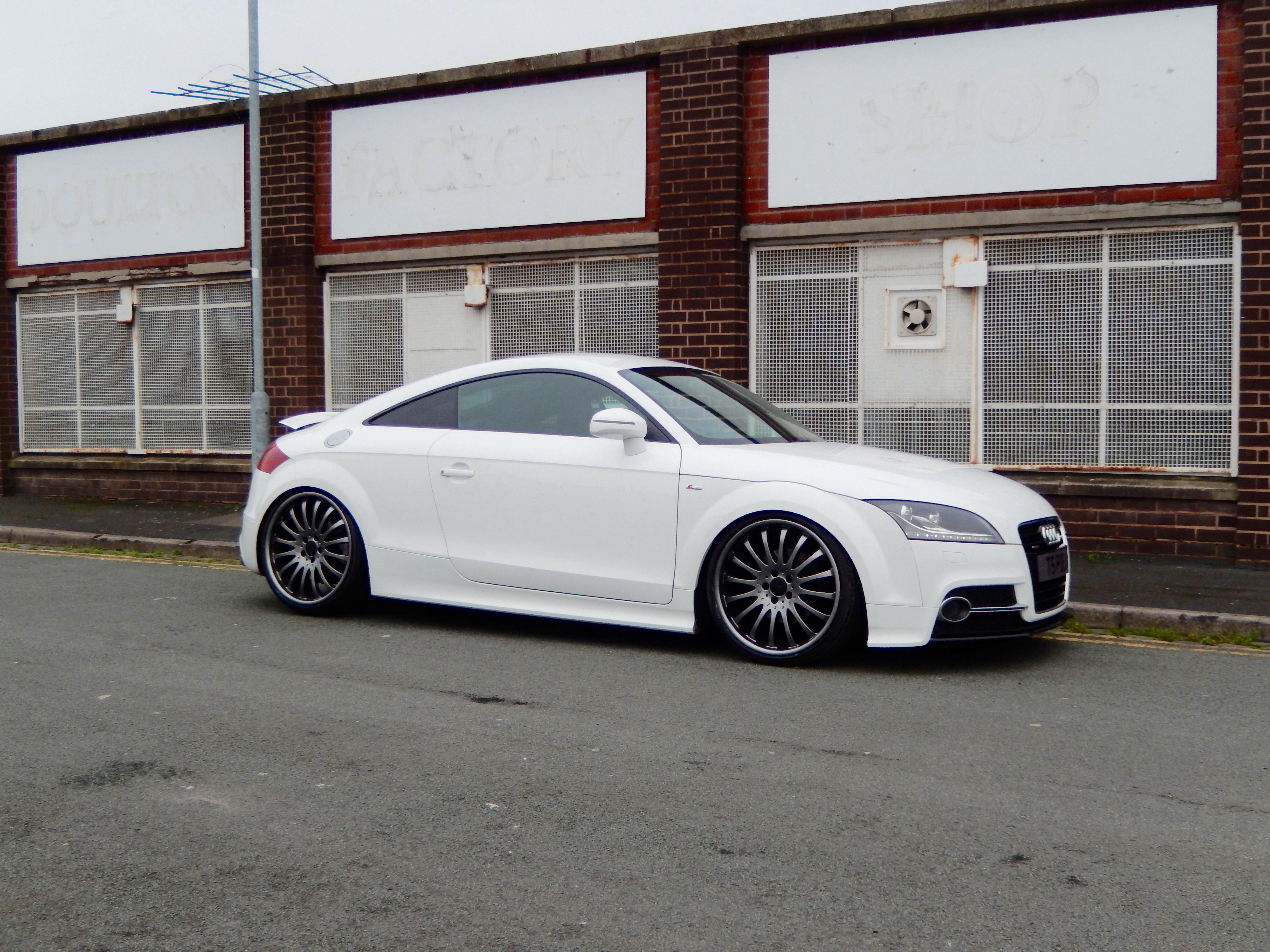

Picture of the old daily that I will miss for its uniqueness.
Couple of my previous projects.

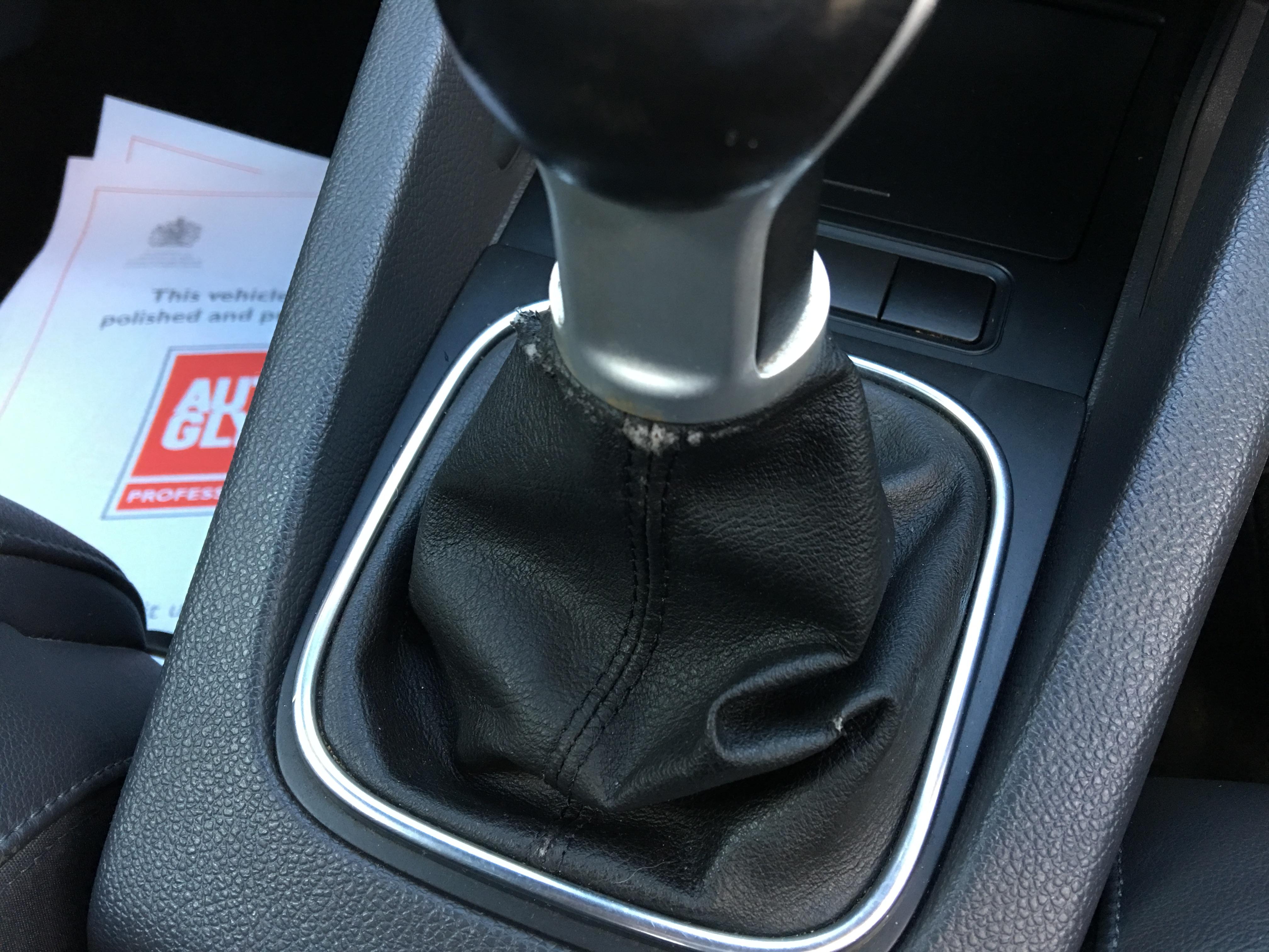

Gear gaitor looking a bit worn out so ordered a replacement.

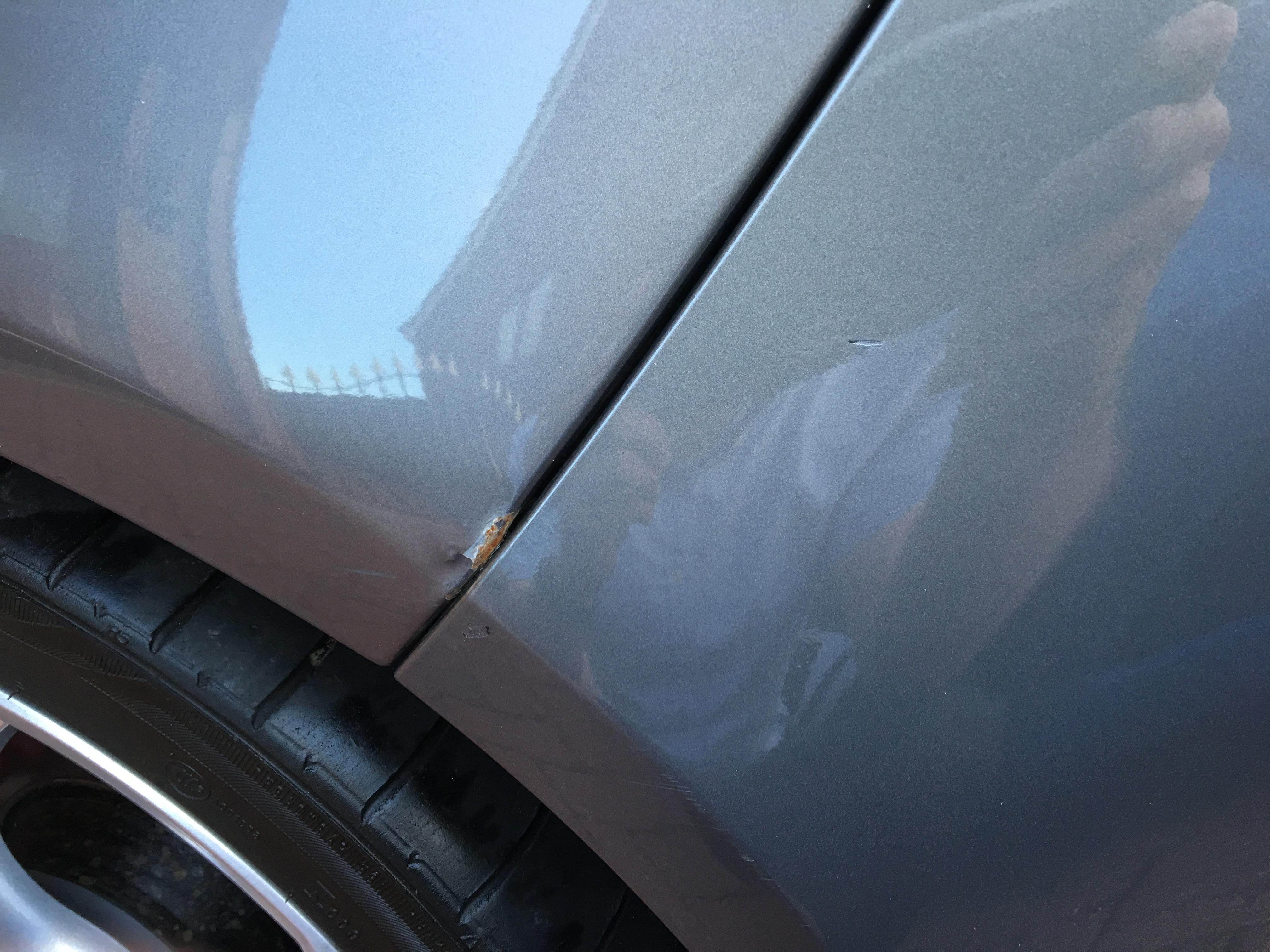

Picture of damage on the rear arch and bumper. Ordered a touch up paint for the moment.
Also found some rust under the lower edge of the rear window of the tailgate.

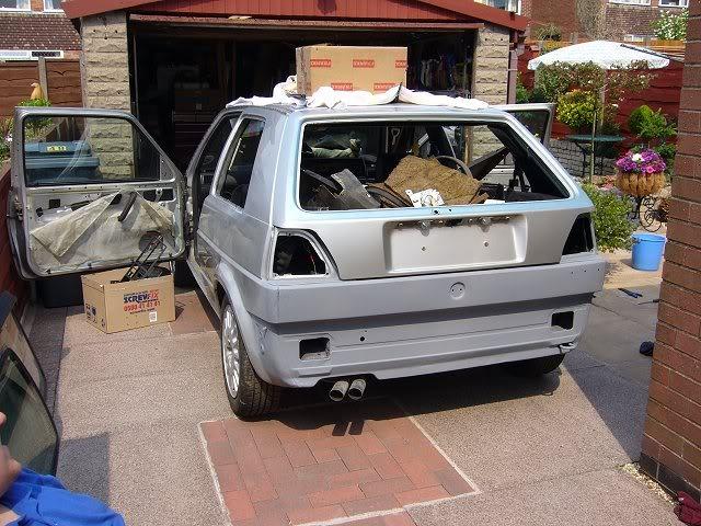

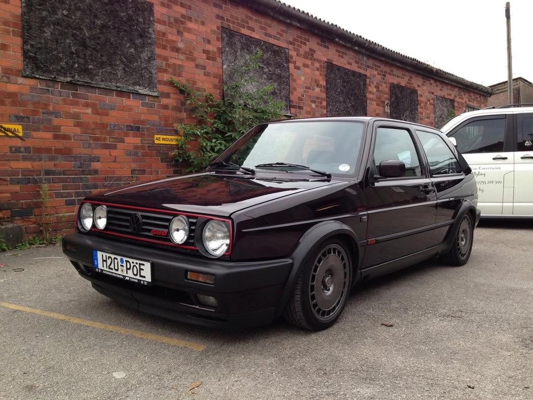

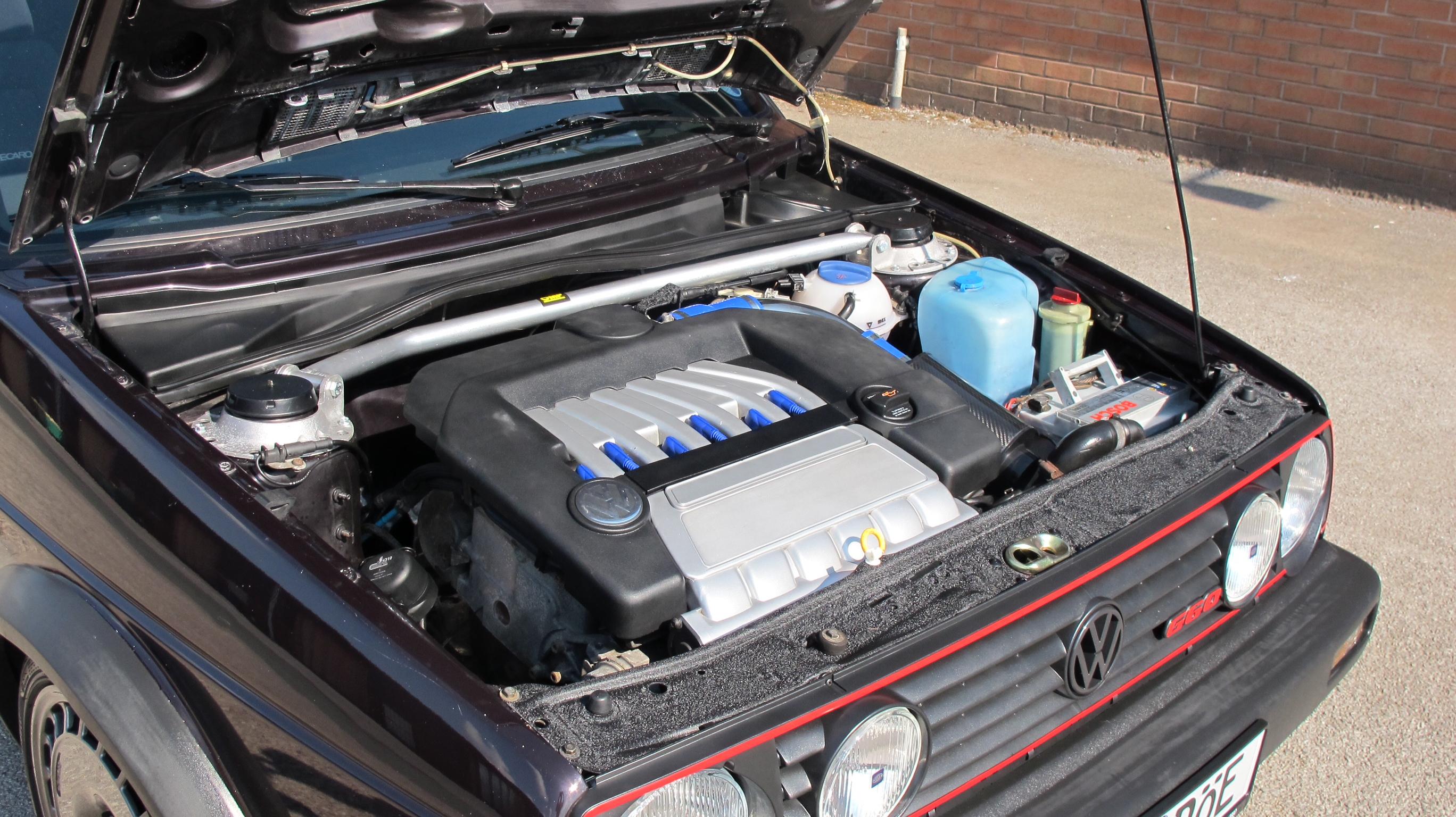

Couple of my previous golfs that i have built.
Late mk2 GTI 16v
Mk2 16v converter to 20v
mk2 G60 Edition one converted to R32
I do have a liking for mk2 golfs
Can see me stripping the mk5 and doing the same  :laugh:

Thanks for the comments I have had a lot of cars as I get bored once they are finished. I do enjoy doing things myself and making things. Kind of like different looking cars. Used to get a lot of questions on the Allroad.
Did a lot of research on the silver mk2 as did the 20v conversion myself when they were not that common. Purple golf had the R32 already fitted but never run properly. Took me a while to find out how the conversion was done to be able to sort out the issues but was worth it.

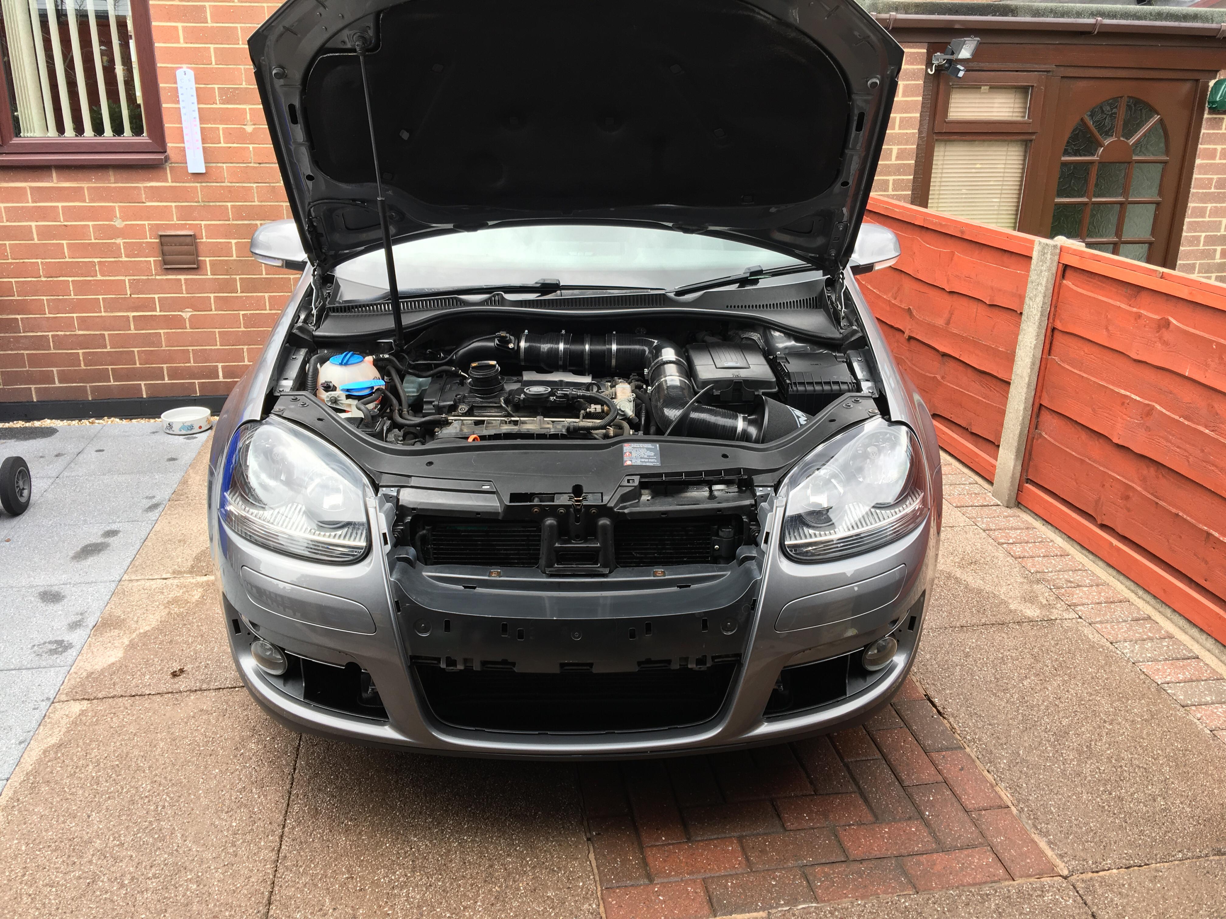

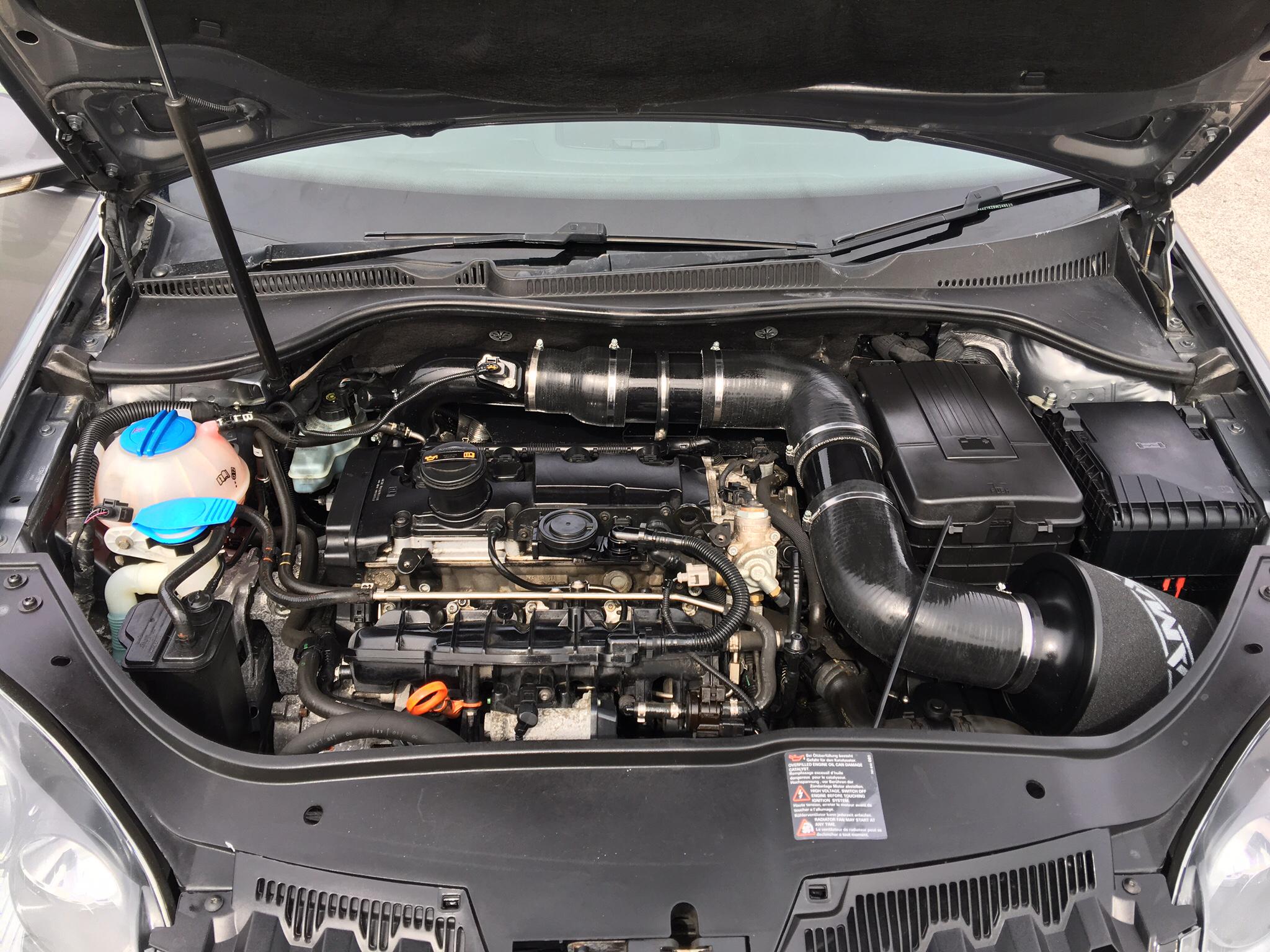

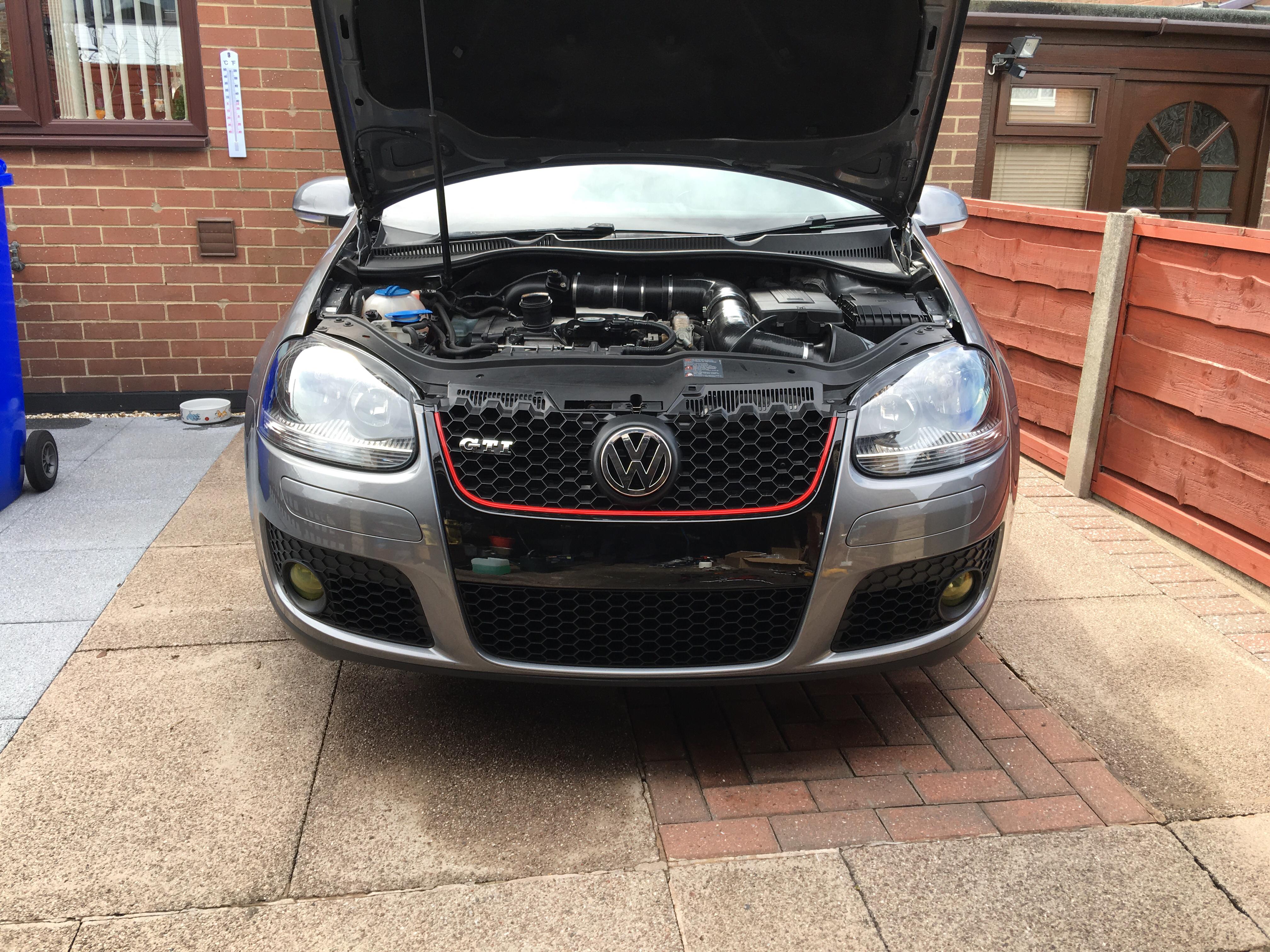

Got my car back on Friday after having a new thermostat fitted. No overheating now just the fans run all the time. Did a quick vagcom scan and resistance to high on radiator coolant sensor so going back in next week for that but no other fault codes.
Managed to get quite a bit done today.
Firstly replaced the diverted valve. Reg G fitted and old one was a G but fell apart when removed.
Removed a lot of dirt from behind the front arch liners.

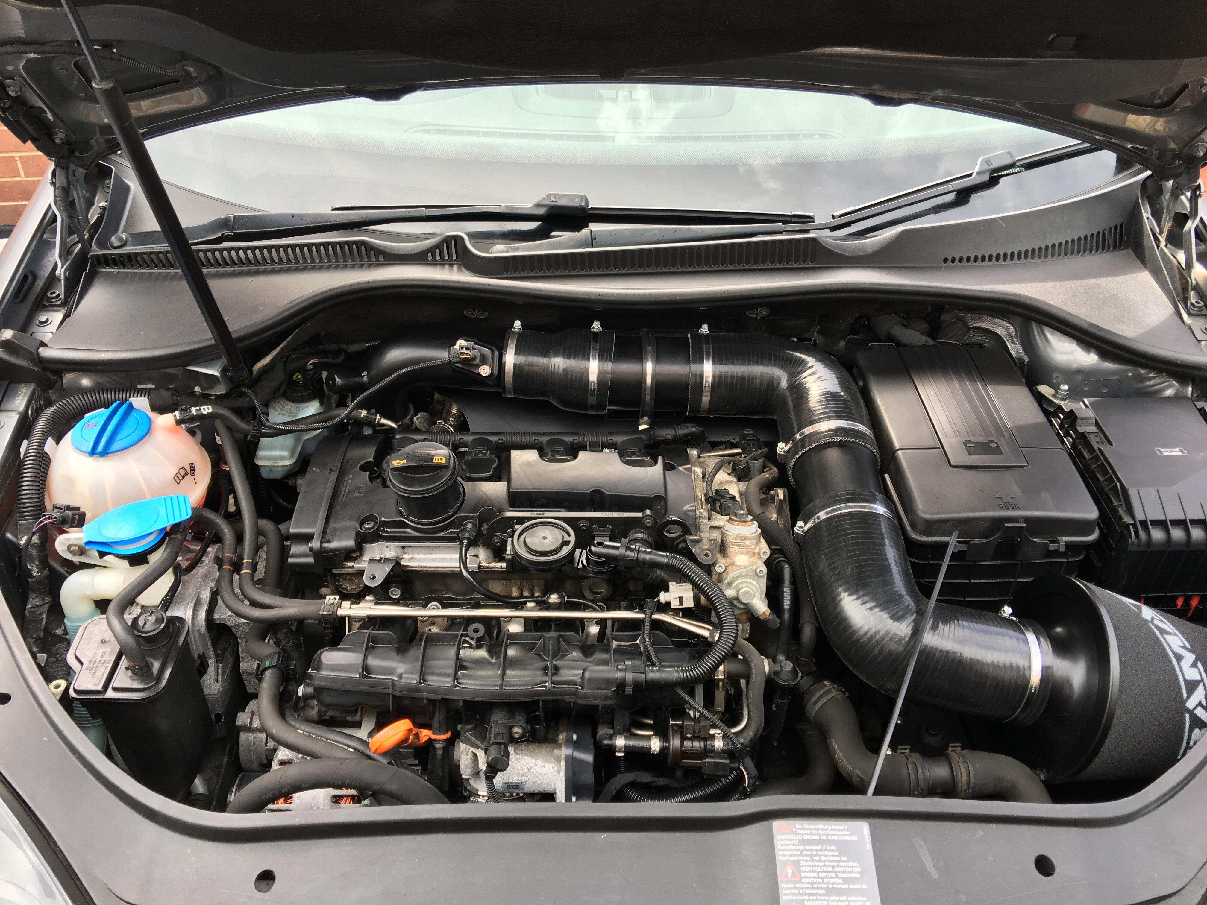

Stripped the front and fitted a Ramair intake.
Gave the engine bay a quick clean but finish it off tomorrow.

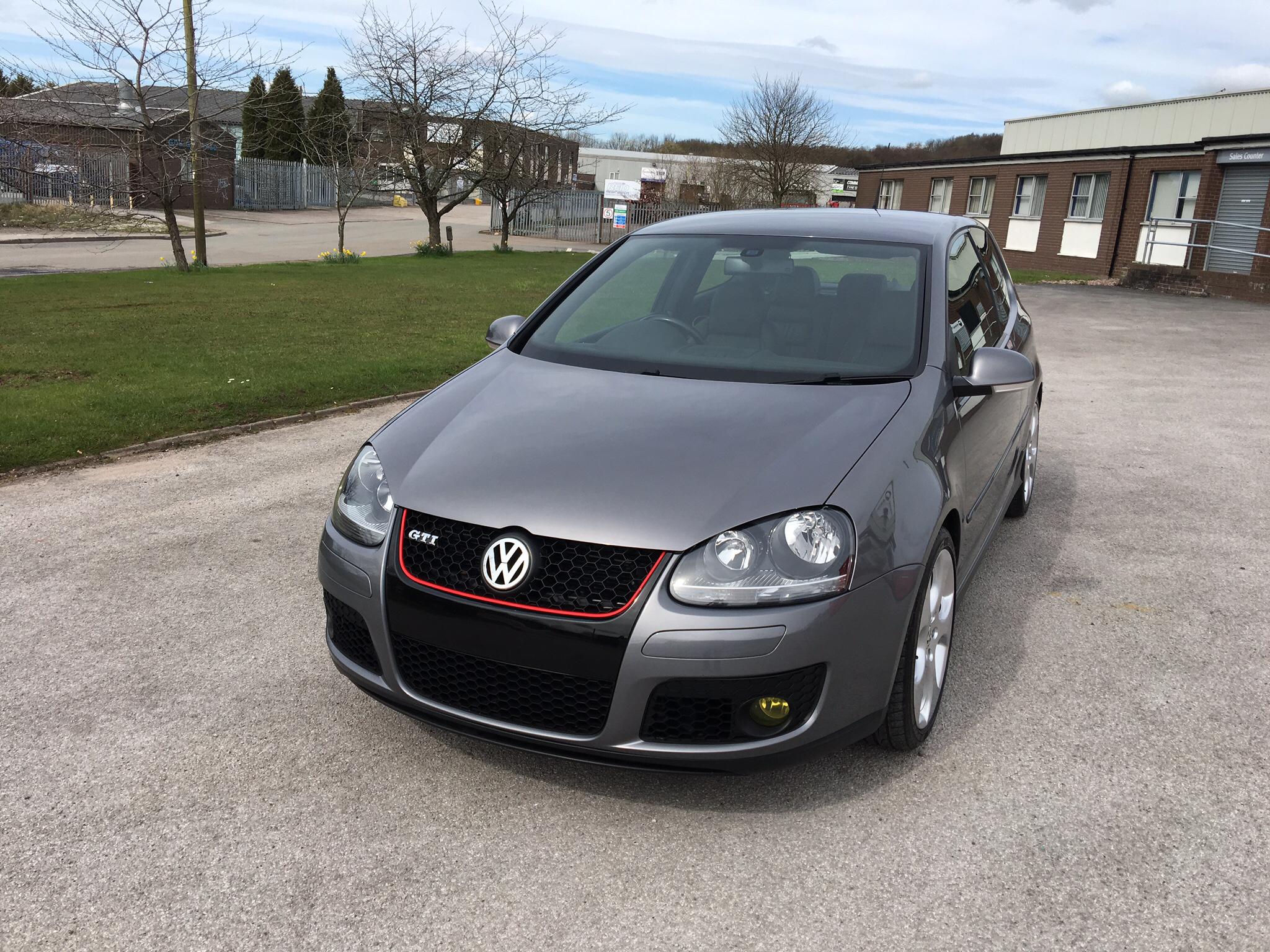

Tinted my fogs yellow.New open grilles along with upper and lower grille.

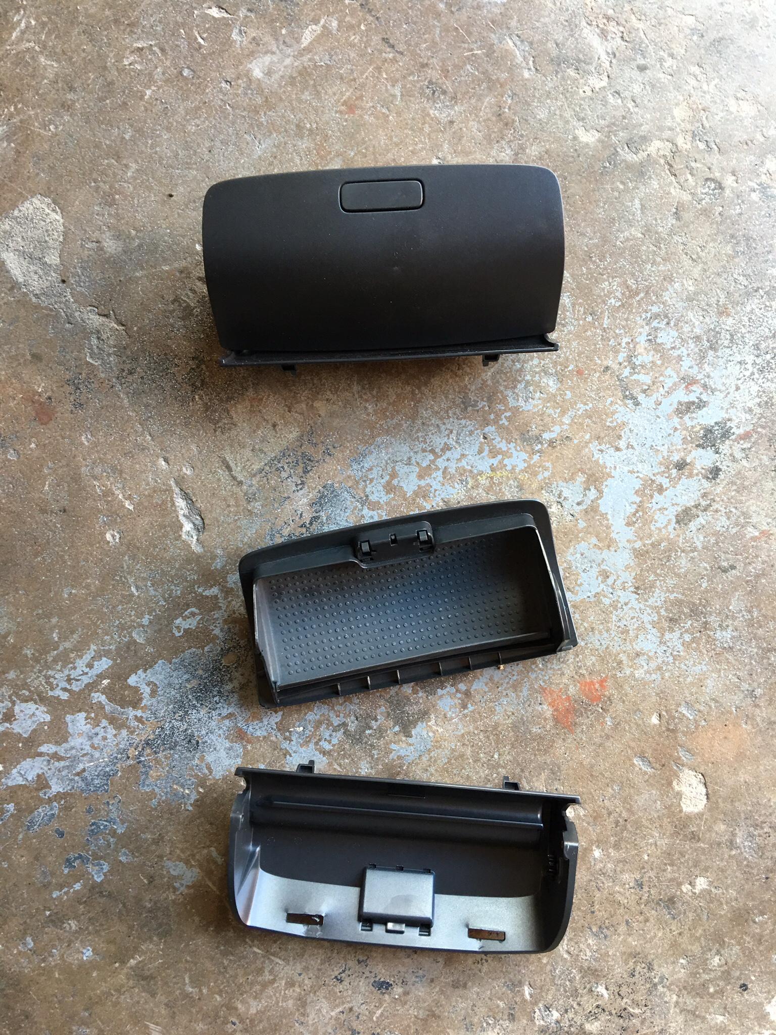

Removed my broken sunglasses holder in installed my replacement. Led's fitted in interior lights as well.
New matts fitted along with new wheel centre caps and wheel nut covers.

How tricky is the ram air to fit? Thinking that's my next upgrade.
Personally I love my H&Rs, a great choice.
Offline dubvrs
  • Posts: 153
Re: Project unloved. 2008 GTI
« Reply #13 on: April 10, 2016, 03:08:07 pm »
Very easy to fit the Ramair just get some silicone spray on the inside of the hoses as it makes it so much easier to get on.

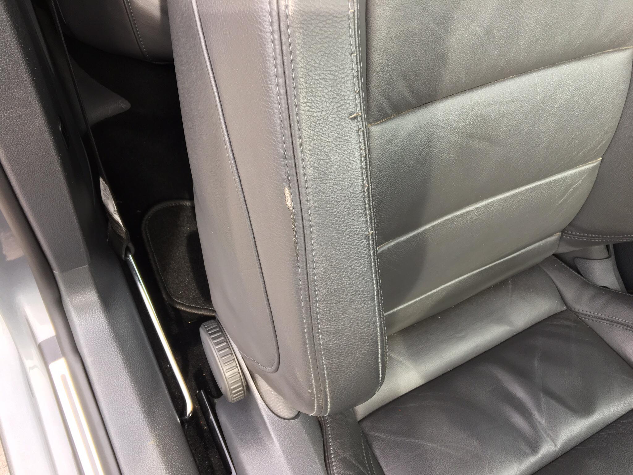

Going to find out if anything can be done with the drivers seat as bit of the leather missing and bit below it has come off the backing. May try to glue it back down.
