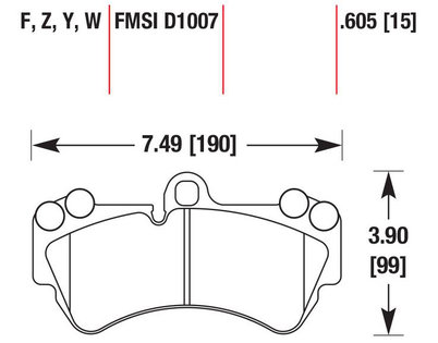

They are 4 pot calipers. The way you can modulate and press the brake pedal is much easier and they'll have more area applied to the pad and that will give them more strength to brake the disc than the one pot sliding OEM caliper.
I'm sure my 6 pot calipers are more powerful than the NQSBBK but the added weight might not be worth it for road use only. You don't brake as hard and as frequently as on a track, so I'm sure the NQSBBK can handle a fast road car without fading easily with good pads.
Pads size:
OEM front GTI:
NQSBBK:
Brembo 17Z for Brembo 18Z calipers retrofit:
OEM
