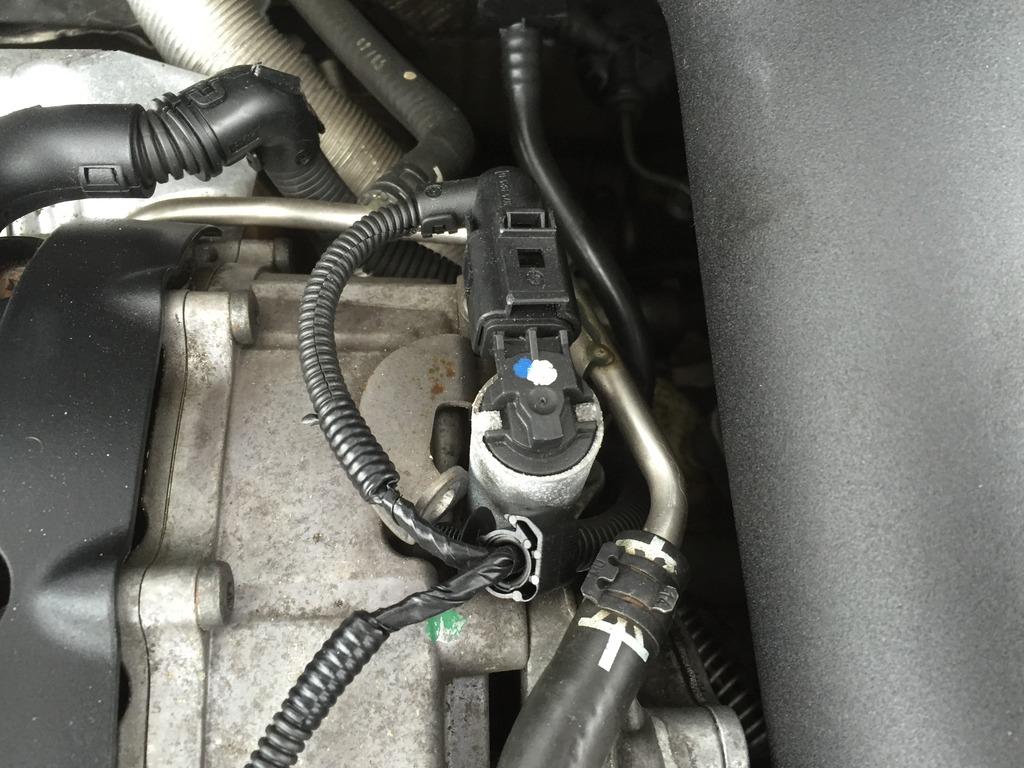

I've got engine light on and found sensor broke at connection,but don't know what it is?with the blue and white dots.

N205 valve for adjusting your timing - read Pesky's thread around page 40 he quotes the current price http://www.mk5golfgti.co.uk/forum/index.php/topic,104662.720.html
Look at this thread http://www.mk5golfgti.co.uk/forum/index.php/topic,106158.0.html
In the images it's shows and labels the item in question it may help you if you thinking of putting a request in the wanted section!

That's it thank you will order Monday. :happy2:

Before parting with your money get the vehicle scanned with VCDS to confirm your fault code as you've not quoted a great deal in your post :happy2:
