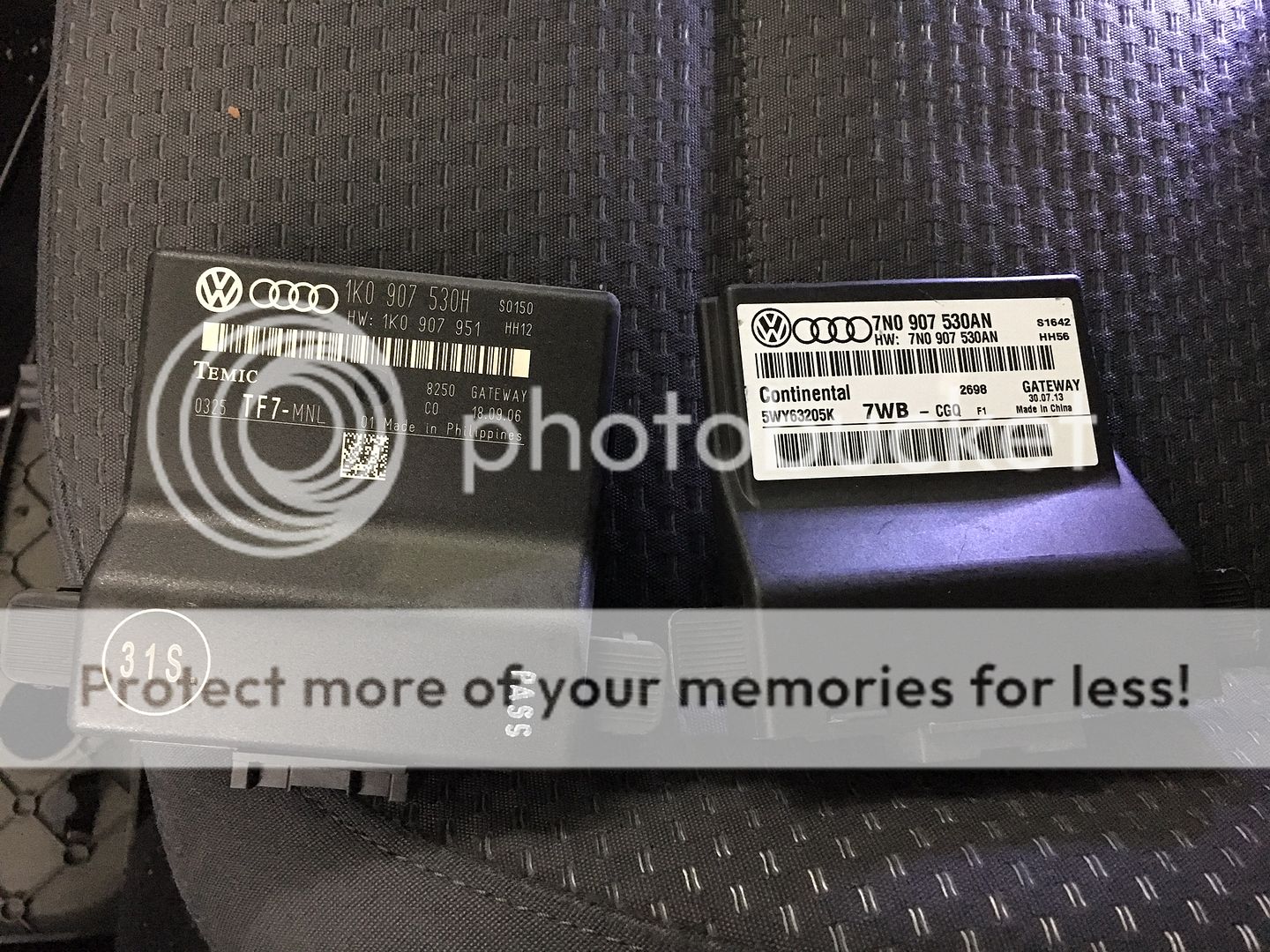

Offline otremontiram
  • Posts: 23
Re: Canbus Version for Mk5 Headunit Swap
« Reply #10 on: April 27, 2016, 09:43:36 pm »
so, my number is 1K0 907 530H, it has to be changed?
i replaced it when i upgraded ro RNS, with 7N0 907 530AN
but was thinking of putting it back
Offline Pashka
  • Posts: 624
« Reply #11 on: April 28, 2016, 12:54:09 pm »
Yeap, unless you are going to put 2nd generation unit like RCD300, but if keeping RNS - you must change it.
