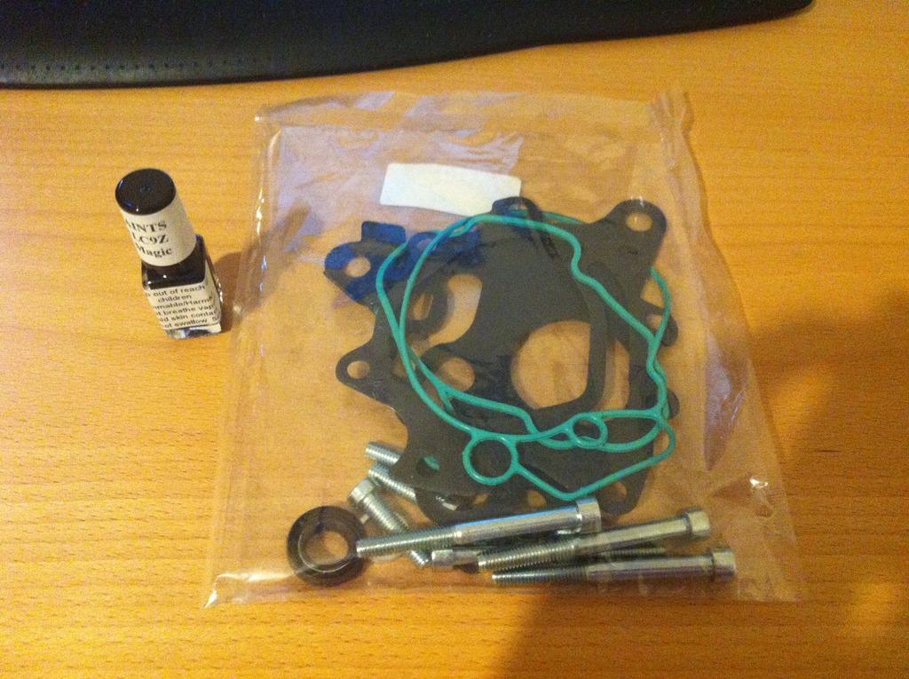

Tandem fuel pump seal kit arrived today so will hopefully get that changed over in the next couple of weeks and then run a couple of tanks of fuel through the car and if it's still contaminated then will replace the injector seals.
Also got a little thing of touch up paint as there are a couple of bad stone chips on the bonnet and a scratch on the rear driver side wing.

My friend Matt came over today and we got the tandem pump seals changed. The oil seal for the shaft inside the pump was definitely not creating a good seal and pretty much fell apart so will run a few tanks of fuel through the car and see how the fuel in the fuel filter canister looks after that, if it's clearer then I'll change the filter again and if it's still black then I'll change the injector seals. Got a couple of pictures but really not much interesting to see and didn't really get any pics of the pump when disassembled.
While taking the pump off then we noticed a coolant pipe that was very perished and it started leaking as soon as it was moved very slightly to get access to the pump bolts. So, replaced with a new piece of pipe and topped up the coolant, good as new. Not sure why the garage that replaced the radiator didn't even notice/replce/mention about this pipe but it's changed now anyway.
