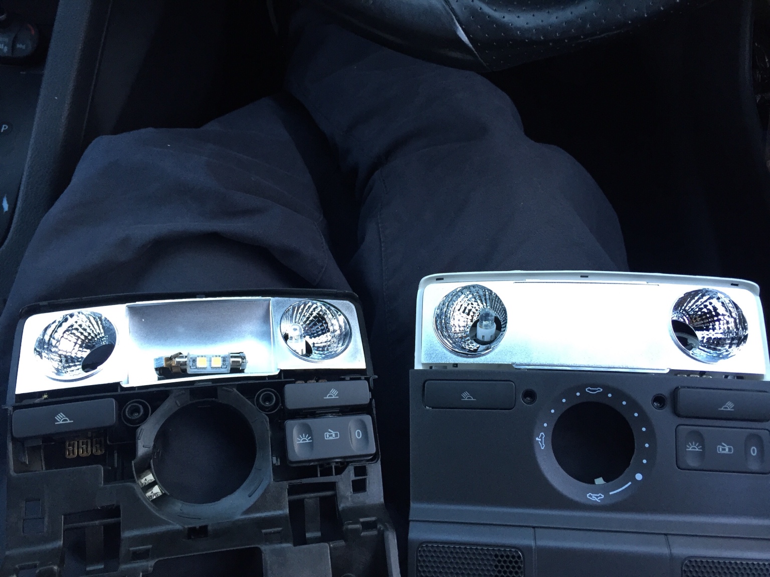

So I recently purchase a new genuine overhead light console, as the rocker switch for the door on mine was fd and kept blowing fuses. I have a 5 door.
Had a lil trouble finding the right part code for the item as they changed the number, but with a little help from your knowledgeable blokes got it sorted i think.

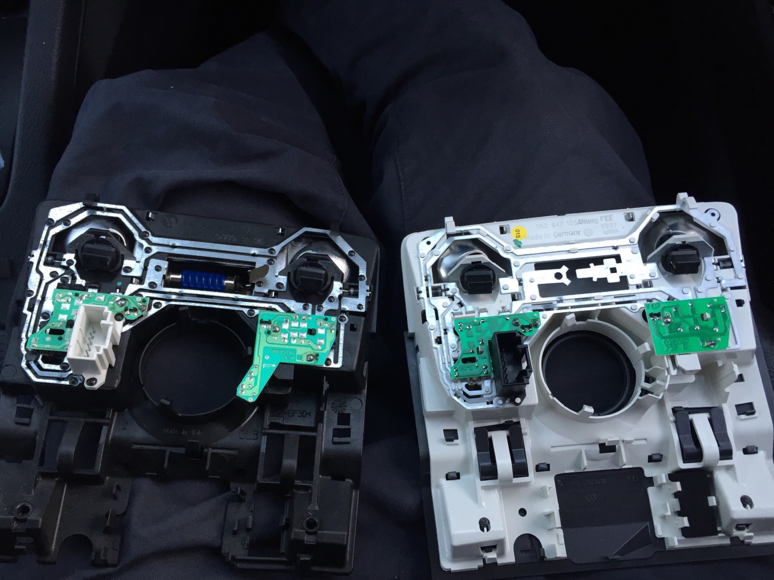

I received the new part yesterday and everything looks fine, except when i took the dome light plastic cover off. This mofo only has 2 501 bulbs and not the centre license plate one, like the original.
I dont know whether i can blame the supplier  as they have ordered it using the vin and so i guess correct part number. Theres no reason a 3 door (or any car with black interior witha sunroof) wouldn't have the middle bulb that only turns on when the doors open so why is it missing? I'll probably try and mod the new part to look like the old as the connectors are all still there but would like to take some advice before i do irreversible damage to the new expensive part.
Also it seems the white plastic is a little weaker then the black i had.
What do you guys reckon i should do?

Think it was part of VW 2006 cost cutting. Hence 1 less bulb and thinner plastic.

Yeah my 07 plate golf only has 2 bulbs, not 3.
Re: Should i be as mad as i want to be?
« Reply #3 on: May 05, 2016, 01:18:07 pm »
Yep... later revision. my 05 had 3.... my 07 has 2

You've got the correct part..... they superseded it with two bulb version.
Apparently the reason was that three bulbs drew too much current and burnt the switch out over time.
I don't like the two bulb style and had to replace mine....already doing my research I bought a good second hand unit from ebay.
Fitted all LED bulbs so won't draw the current of incandescent bulbs so should be good :D

Aghh ohhh. Thanks Ady, that makes alot of sense and explains why i had to get a new one in the first place.
I only use led bulbs, but don't think the previous owner did.
I tried second hand but they were the same price as this.
Just thinking and so i should probably downrate my fuses for this item again, as i went upto 15 from 7.5 to get some use out of the old unit.

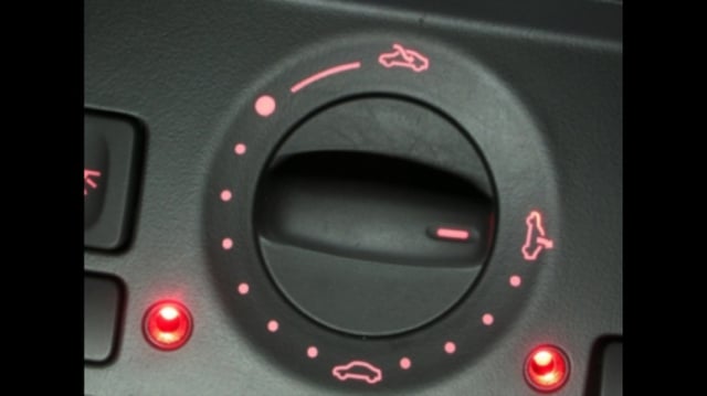

As said it is totally normal. The challenge for me was finding a new old stock one that has the lit up dial and switch. My '08 didn't have that, now it does. Doesn't look like yours doesn't either.
Lots of searching and waiting. Mine is grey as it's the GT but this is the original set up. The dial IMO is much better and matches the air con and light switch better.
