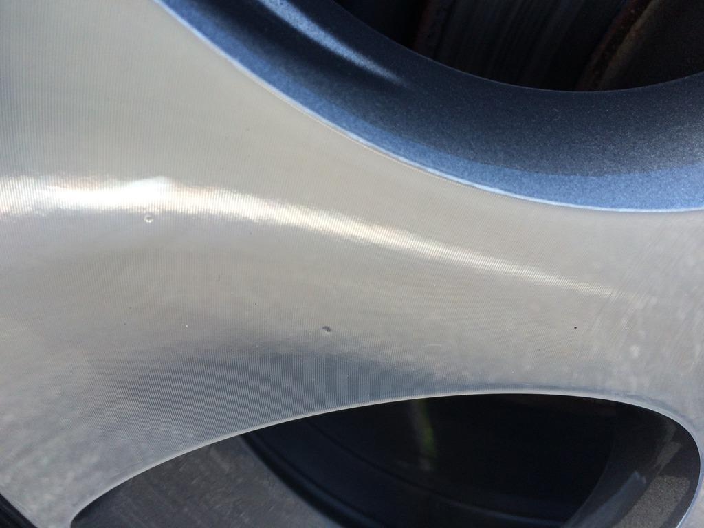

7) The wheels the second time around although are the correct colour have minor flaws from dust getting onto the diamond face before the lacquer went on
Here is the final result:
You can see three minor specs under the lacquer in this photo. Two look to be air bubbles and the third a bit of black dirt.

Yay, glad you got them and they're the right colour... What a journey! The actual diamond cut looks pretty good quality apart from the dust you already pointed out. What a shame they failed at so many other points.

Looks like they have used a high feed rate when doing the diamond cutting although could be the magnification,I'd be worried about those air bubbles,any trapped moisture and it's only a matter of time before the whiteworm returns.
